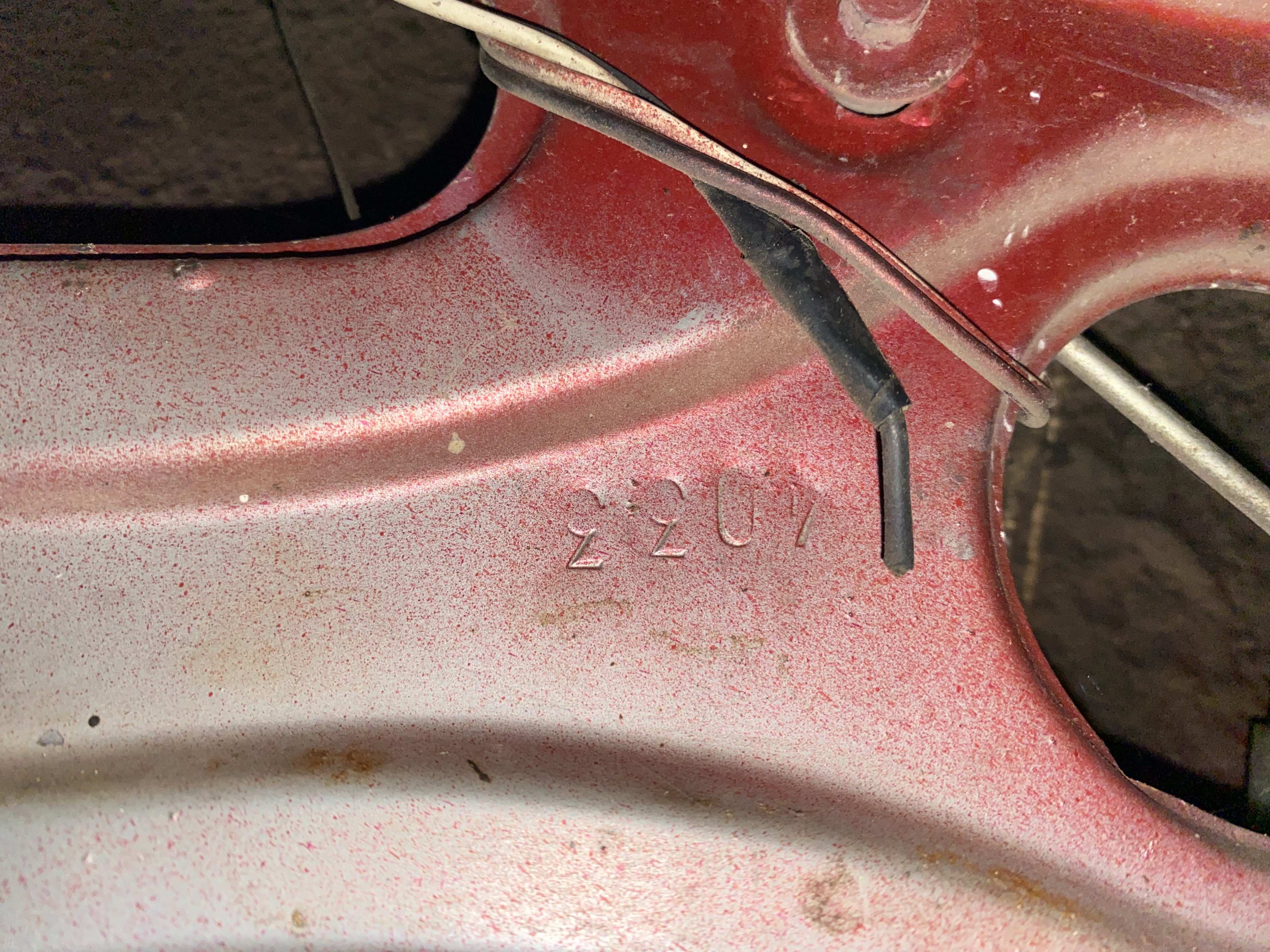

I have been able to locate stampings within both doors, indicating the number 4033. This is right in the range you estimated, extrapolating form the engine number ( Well done!). I have attached a pic of the one side, just to prove the accuracy of your guess!
BTW, no number stamping in the bonnet on this car, although it is present on the 2000.
I am still at a complete loss to explain why the chassis stamping in the engine bay is not in agreement. It really does not look as if this section has been cut and a different chassis stamping welded in. Anything is possible of course, especially many moons ago, but it is difficult to figure the rationale.
Anyway, thanks for the guidance and for the moment, comfortable for you to link the engine number with the VIN ending 4033.

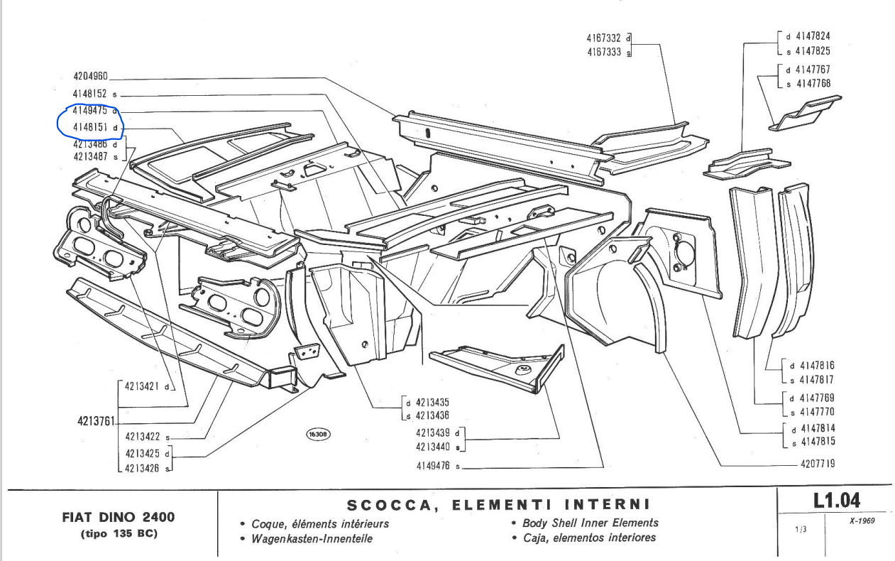

BTW, can it be confirmed that the elements 4148151 and 4149475 are interchangeable between 2.0 and 2.4 ? I don't have access to the 2.0 body part catalogue and don't find it on the forum downloads?

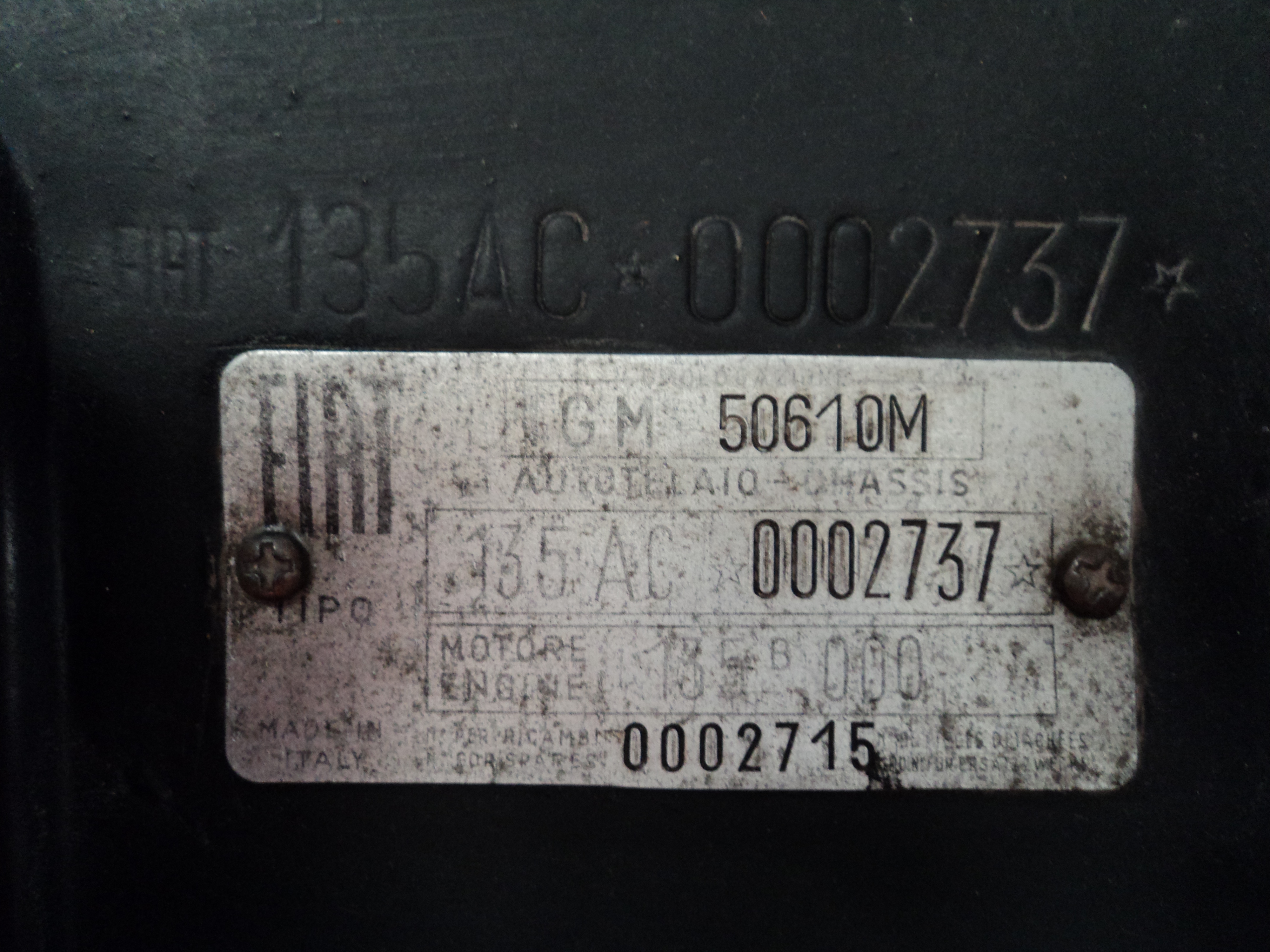

Here's the details of my 1968 2000 Coupe to add to your list.
It was imported from Italy to Australia in 1974.
Posts: 158
Good evening
Thank`s for the picture, new to me.
If there is anyone else that want to share, but don`t want to uploade here on the forum, PM me so we can excahnge e-mail.

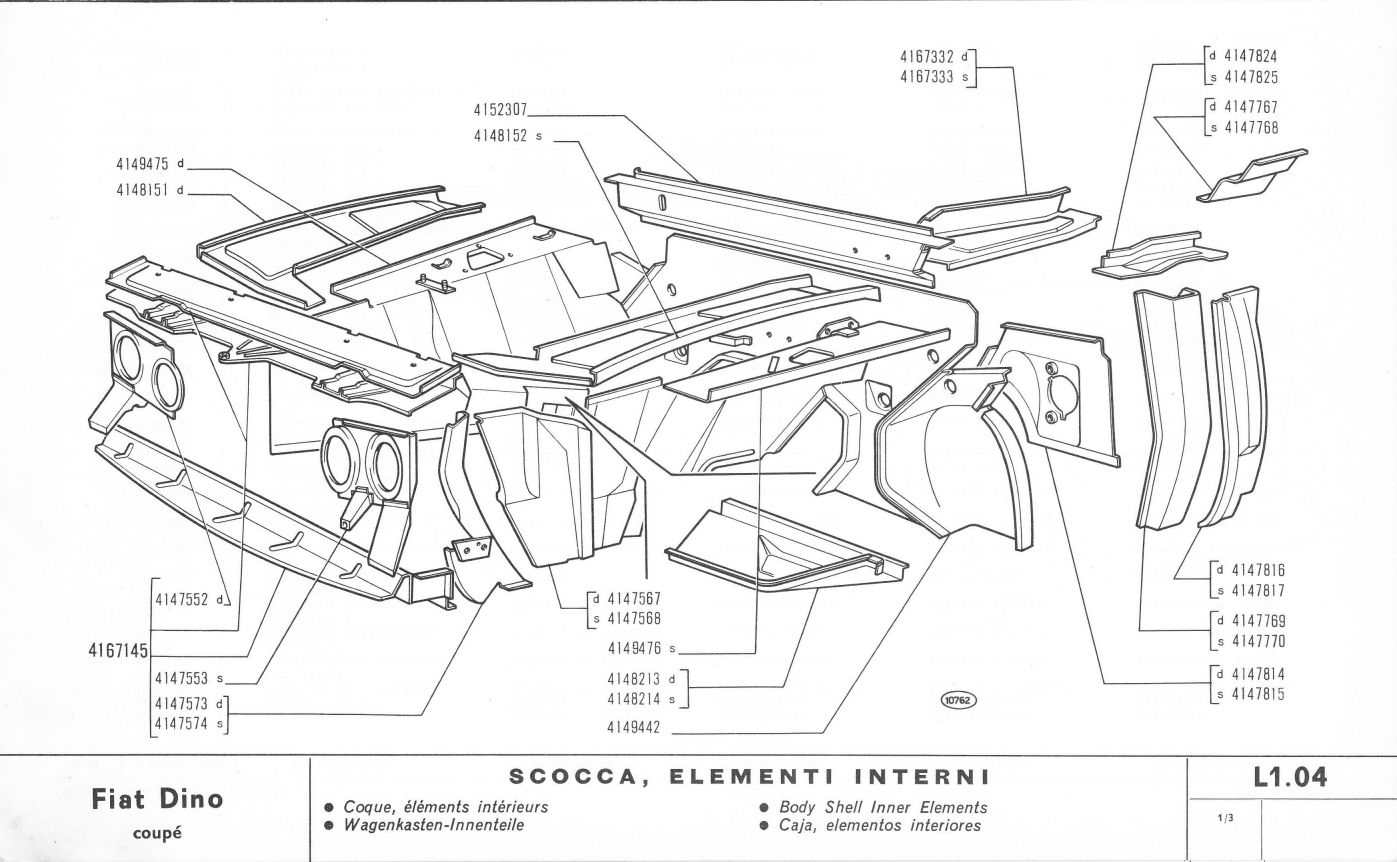

The Body parts Catalogue page for 2,0 Litre Coupe below confirms the 2,0 and 2,4 Litre Coupes
share the same inner front wing section parts. It is probably the explanation how your 2,4 Coupe
got it´s AC 0878 identity. The welded fastening bolts for a Dinoplex are somewhat confusing, but
these perhaps were added, with the damaged original BC 4033 inner front wing section used as a
pattern?
