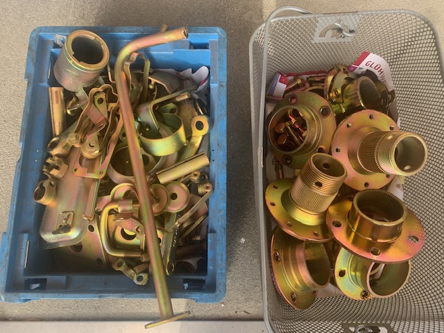

and I am a regular customer at a local electroplating company and have had most of the metal parts of my Dino either yellow galvanized or re-chromed

I believe all unpainted metal parts on the vehicle were delivered from the factory with a silver (light blue) galvanized coating...
However, it has become common practice for restorations to generally galvanize metal parts yellow... you probably mean gold CAD plating...
For example, I had my sandblasted metal parts yellow galvanized by a local company...
It looks a little more elegant...

Since the use of cadmium, a (highly) toxic heavy metal, is now banned by law in many countries (including the EU), galvanization is now used.. yellow, blue, silver or black galvanization

Instead of cadmium plating, they'll likely use yellow galvanizing.
This is a two-stage zinc-based coating. First, a zinc coating is applied by electrogalvanizing, and then it is treated with a chemical passivation that gives it its yellow color.
I had most of my metal parts (brake calipers, bolts, nuts, wheel hubs, etc.) yellow galvanized. Many of my friends have also had this done on their classic cars, and some of the spare parts for the Dino Spider that I've bought from people were or are yellow galvanized.
