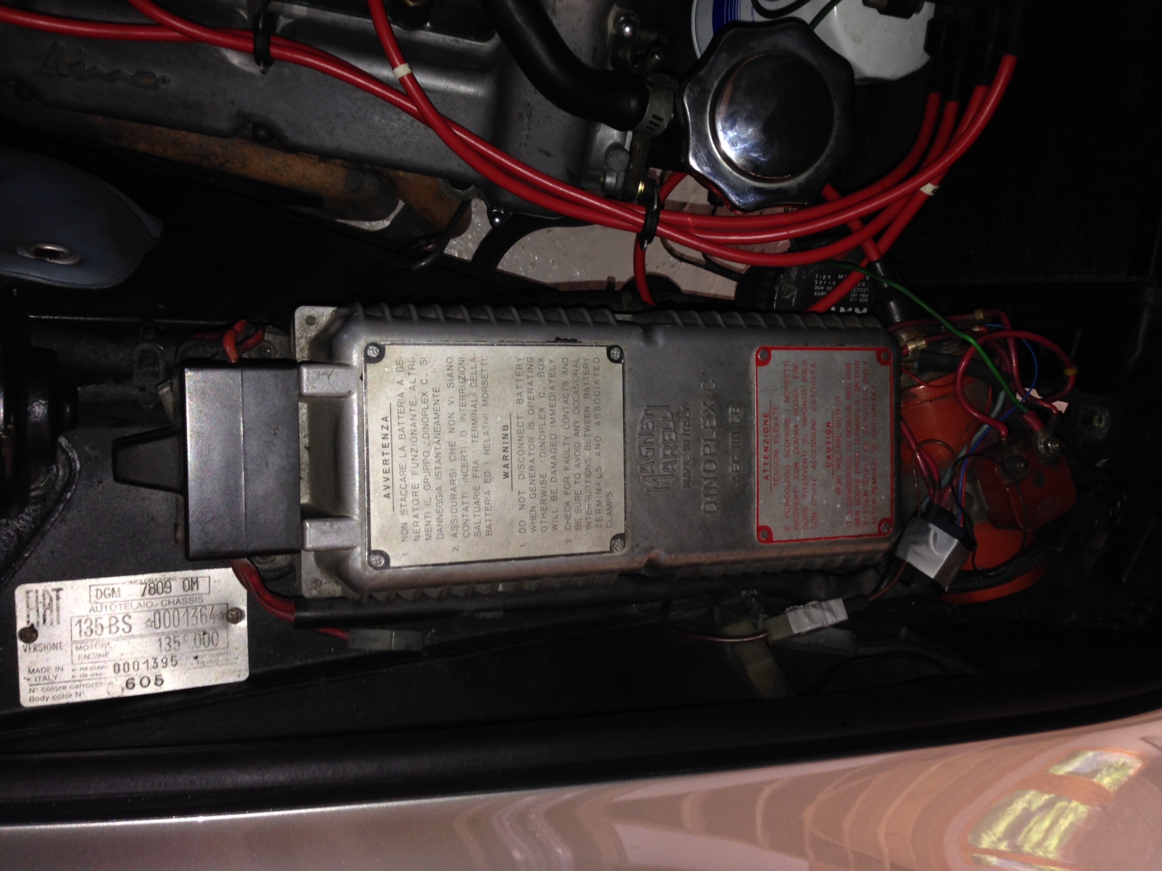

My Spider is a '67 with chassis 0000456,at first I thought my dinoplex was just missing or had been replaced but after reading this article it seems that the factory installed
dinoplex were fitted from 0833 on…Just wondering if I should replace the old unit or start looking to install a dinoplex…Any thoughts ?
Also does anyone know if the other number 0000466 is in relation to the paint code and if so what colour would it be…
Any help would be much appreciated.

Does your Spider have any other kind of ignition system now or still no ignition as delivered? Many early cars have been equipped with a Dinoplex later by the dealers upon introduction in the series, so a Dinoplex can still be considered as original even if the car came without one. It's kind of a works upgrade. As already discussed above, you should strive for a Dinoplex in any case. If you already have another working ignition system, be happy and try to get one somewhen. If you have no ignition system at all, try to get a Dinoplex and get an MSA or something similar in the meantime.
Regarding the number, I don't know about a color #466, maybe it's the motor number.
Re: Dinoplex - restore or replace?
Dino John; Your chassis number plate with number 0466 stamped - it is not a colour code - it is the Fiat spare parts number (according to the description of the chassis number plate in the original Fiat Dino spare parts catalogues). The third number 4954 should be a homologation number, but I guess you have figured that out, already.
