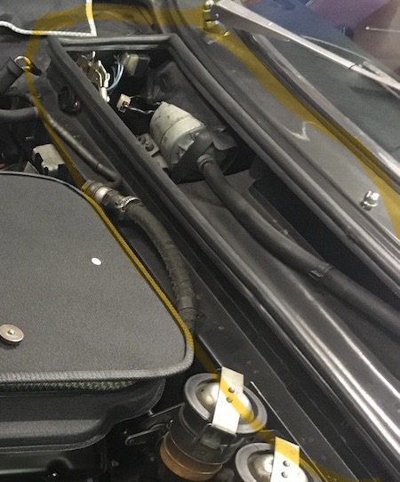

My coupe doues not smell inside (not much ;) ):
Modern fuel is unfortunately more poisonous than 1970 super, and it is very aggressive towards old ruber and fuel hoses.
I replaced all my hose with modern FPM-ECO DIN 73379 material.
Final step was to replace the old rubber part for the fuel filler:

BTW: it is really a PITA to install the Bertone rubber boot. Works only when you heat it up in the sun or in hot water. On alfabb, I found an assembly procedure (thanks to Scott!)
Re: Overwhelming Petrol/Exhaust Fumes
Posted: Thu Jul 30, 2026 8:21 pm
by Ribolla_67
Next project is the replacement of the old air intake sealing:
