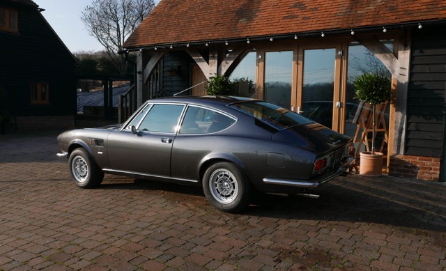

Hi, Grigio Silverstone is still a current Ferrari colour, (FER 430 GRIGIO SILVERSTONE), the OEM paint code is 159650, manufacturer PPG have it as FER 159650. There are water based equivalents, OEM code is 266613, PPG have it as 912517. The colour is a little darker than 661 but this may be because the original examples I"ve seen have bleached out a bit. Anyway, here's my 2400 Coupe, finished in the water based version:

Re: Colour code Silverstone Grey
Posted: Tue Jun 27, 2017 5:27 pm
by Ribolla_67
Beautiful car! Could you please post some more pictures?

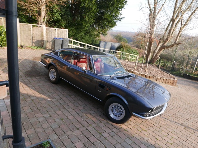

Glad you like it. When I rebuilt the car I installed throttle body fuel injection...if anyone's interested.
Posted: Fri Jun 30, 2017 8:16 pm
by Fanalone
Hi Tomasir
This is at least for me, very interesting. Not to "hijack" this tread, but maybe you could post some info in the "Tuning tread"http://fiatdinoforum.org/viewtopic.php? ... 8&start=10?
I suppose you have installed Jenvey throttle bodies, but huh ave you used 40, 42 or 45mm? And what kind of management have you installed? Could you post some pictures of the installation?
Posted: Mon Jul 03, 2017 3:29 pm
by Tomasir
OK, I"ll post a bit of information about the fuel injection on the thread you mention. I'll post photos when I've had the chance to take decent ones, those I took during the rebuild were for my reference and are not very interesting.
