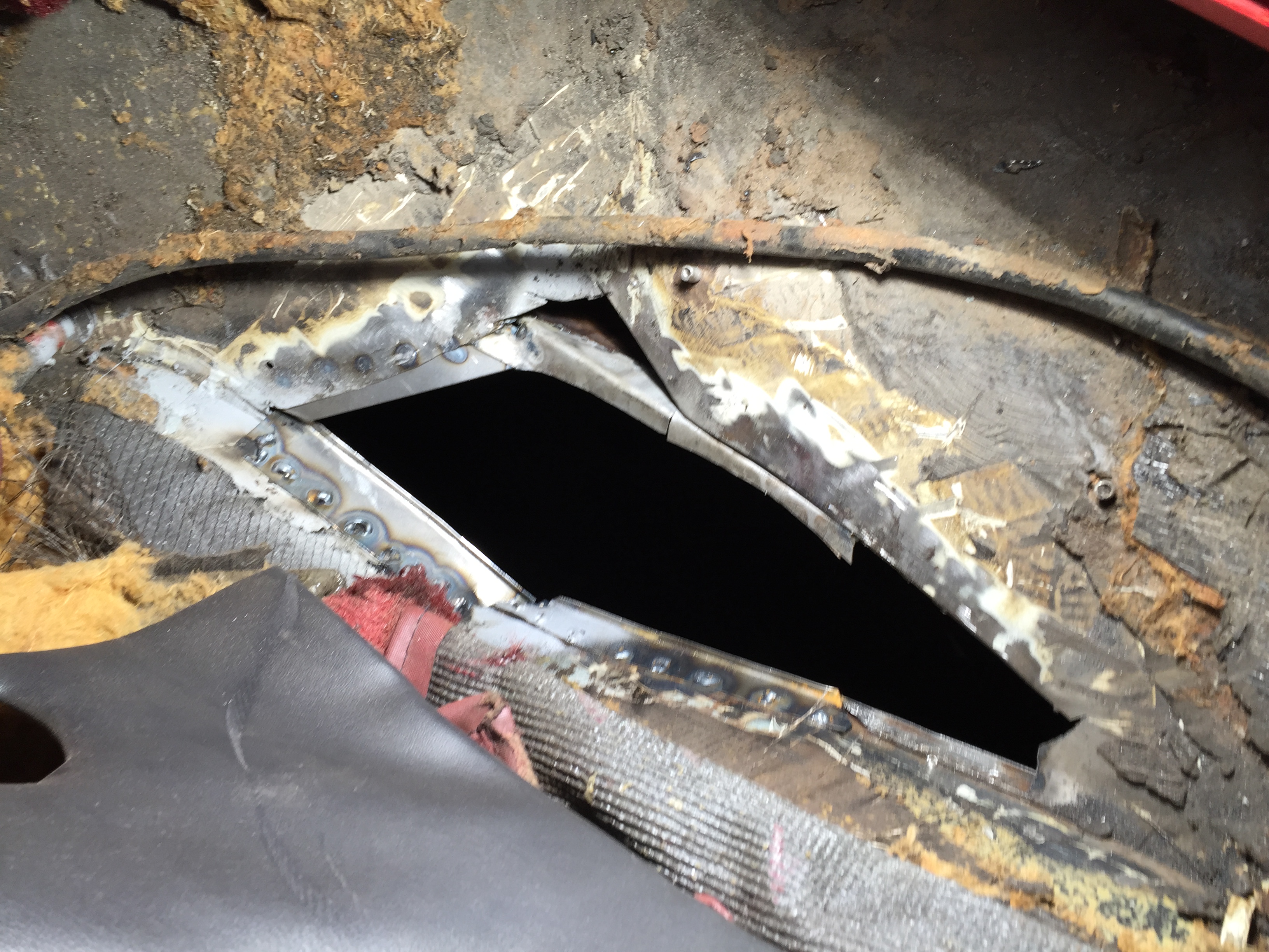

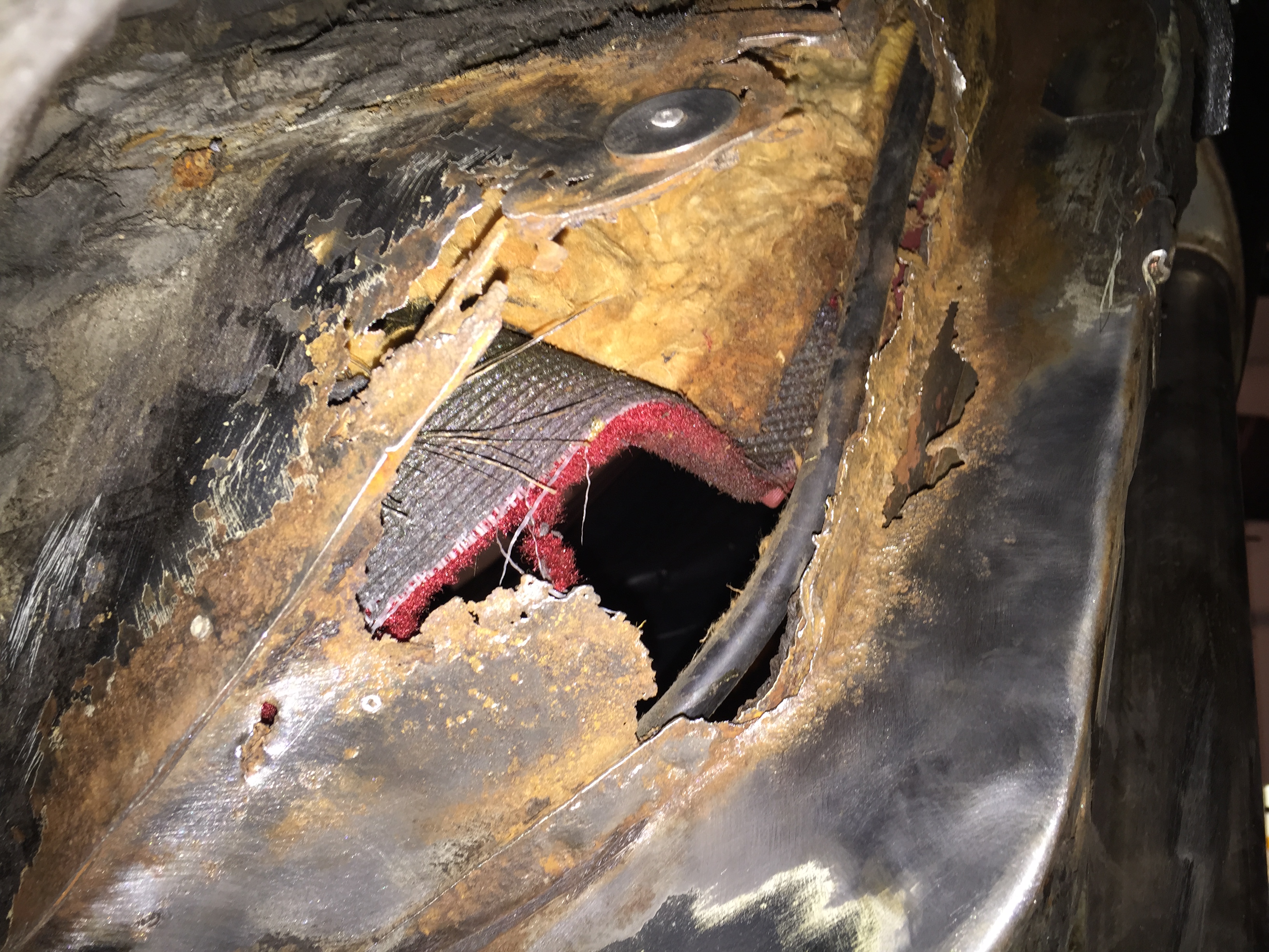

Today (actually all last week) I welded up the passenger floor of my 2400 Coupe. The rot was pretty bad - and had got into the box section that runs diagonally under the floor. This was all underneath the sound-deadening material attached to the underside - this stuff must have got wet, retained the moisture and rusted out the sheetmetal beneath - all when this car lived in worse climates (central Canada).
Big hole from underneath - also some nasty rust in the box section that runs under the floor

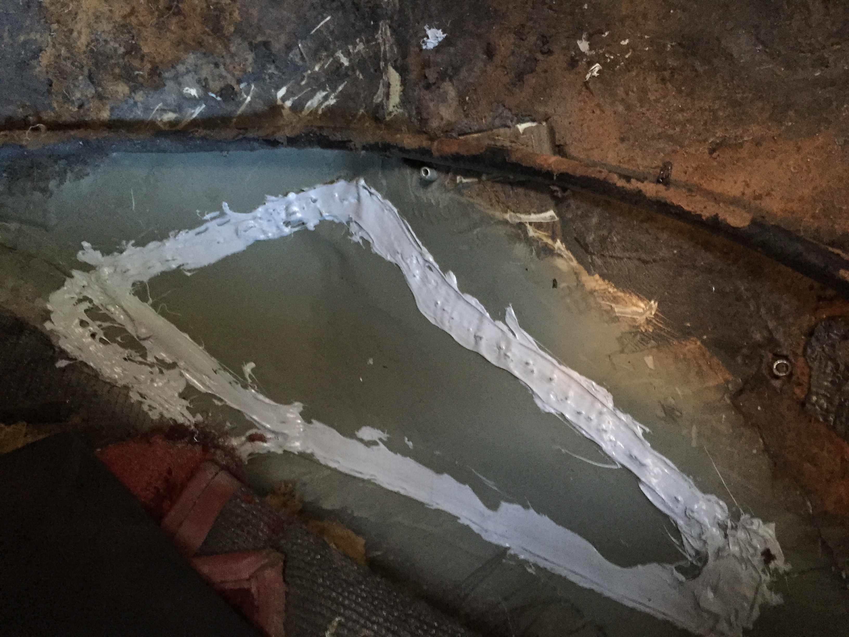

cut out all the bad metal - welded in some backers to replace the lower edges of the transmission tunnel that used to support the floor-edges
Made a patch and welded it in.  It didn't go that well, difficult to weld 40+ year old degraded steel - but good enough - seam sealer covers the worst in this picture

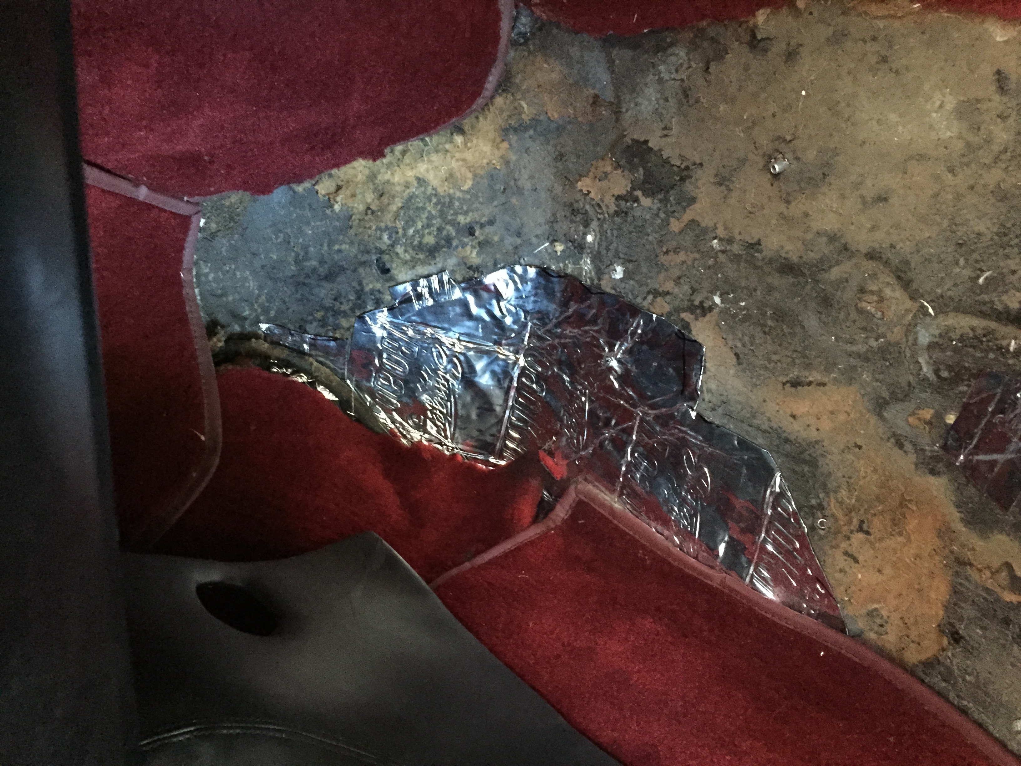

Then had to replace the rubbery stuff that's bonded to the inside surface of the floor - some sort of bitumen/rubber/tar, needs heat gun and scraper to remove - stinks when you weld near it

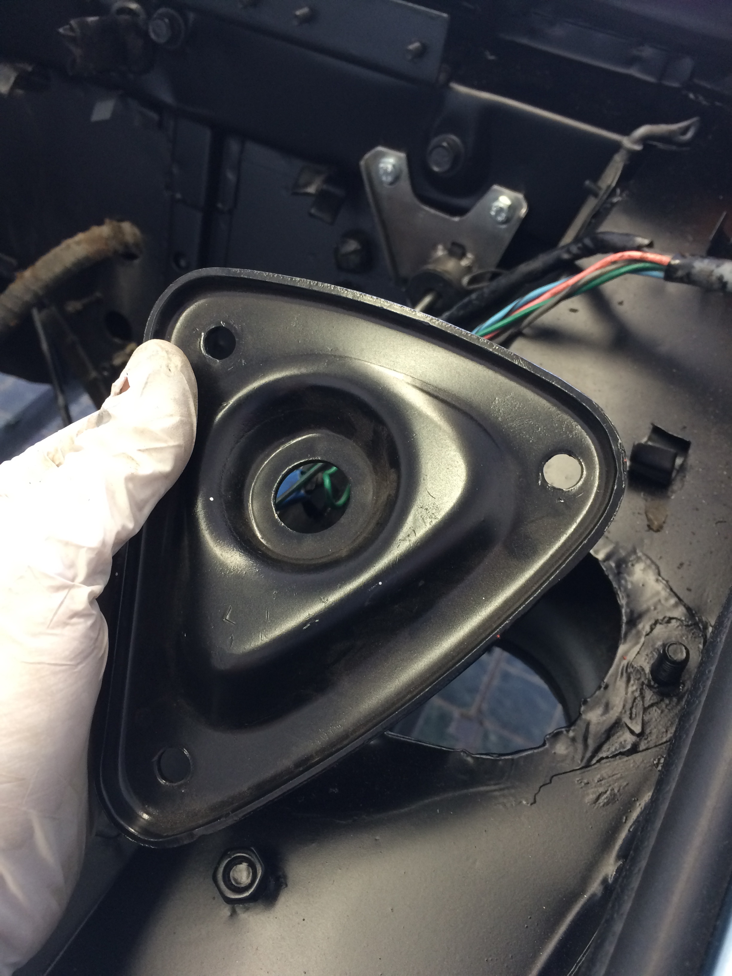

Today I removed, cleaned, polished, painted and changed bushes to the vacuum pump and pressure swith, and in the way, I managed to break one stud in the strut plate while removing the pump. Made a quick fix drilling, tapping and bolting another stud. I also changed all the door rubbers for a new ones (only one today)

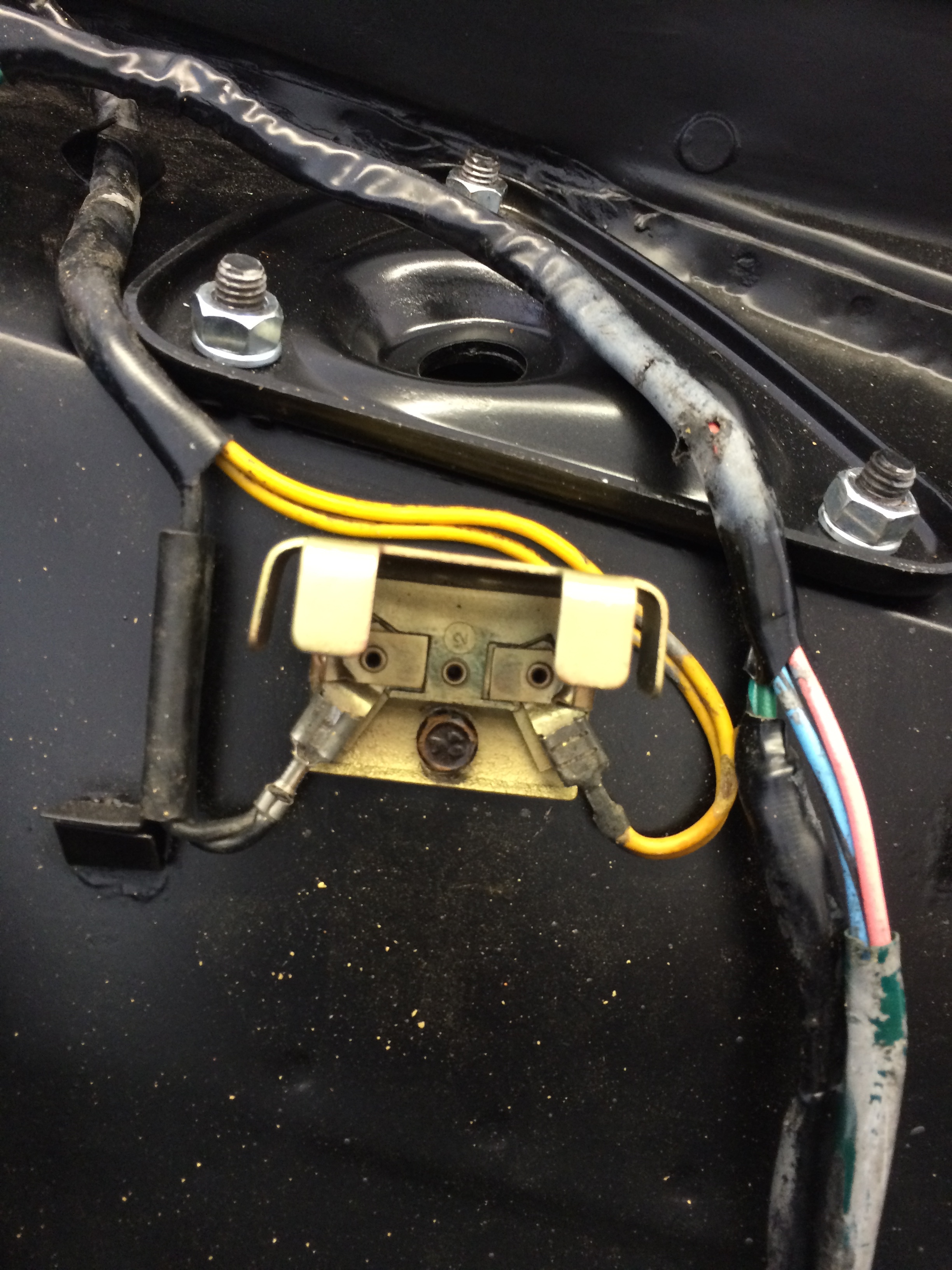

Thes week I have also changed both exhausts, fixed the wippers issue (they did not return to the stop position) by bolting to the plate a microswith, as the original system was completely destroyed... Slowly moving forward. Next week I want to start, adjust timing ignition, adjust CO, fit the new plugs, airbox and new air filter, and finally drive it (Really short trip, it is not registered yet)

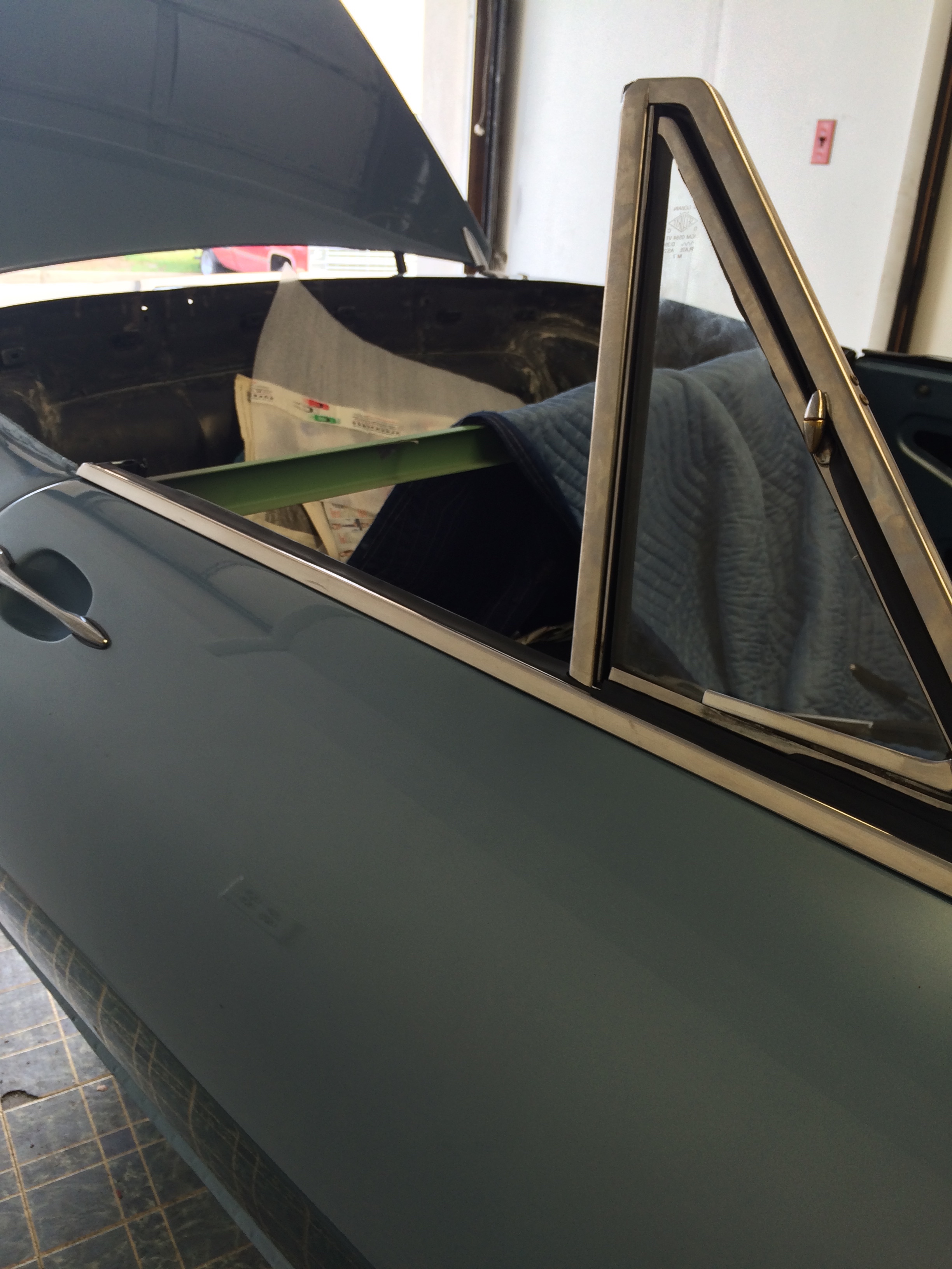

Post by iceblue »
I added my shock plates, windows, trims and electrical light in the engine.
Moving along with my restoration.
