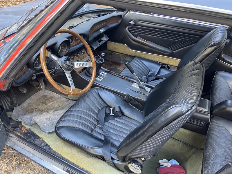

I am about to replace my interior carpet set on my '67 2.0 Coupe.
I have a set to use as patterns [non-original I am sure] but they are a nice fit and seem quite correct.
What I am questioning is that there is no carpet under the front seats, is this normal?
There is a front footwell piece and a rear footwell piece but when I remove the seats, there is no carpet there. This does not have any visual effect, as the 'bare' section is not seen but I could easily get another piece made now.
Can anyone look under their seats and let me know please?

Hi Graham,
I replaced my original orange carpets a few years ago, and can confirm that there is no extra carpeting under the front seats, just the sound deadener.

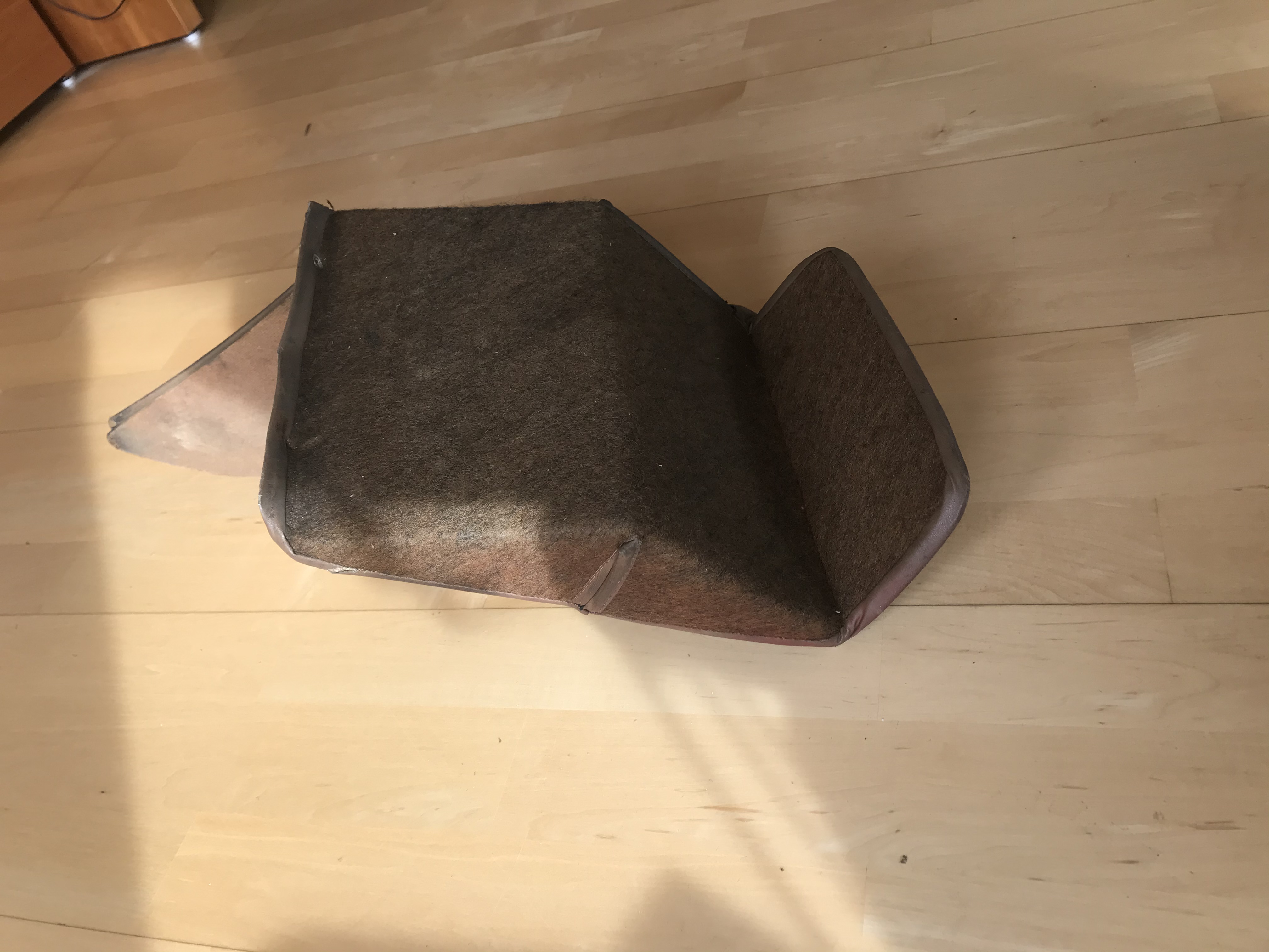

On the boot carpet, may I ask a question please? I can see the mats needed on the parts list but are all of these attached to a wooden board? If not, which ones do I need to get them to attach the binding so that I can wrap the binding around the boards? I have only 2 of boot carpet, the wheel arch and the right angle wood mounted piece above the wheel arch and no idea what's needed I attach a diagram.
If anybody has photos of the boot carpets and mounting board it'd be so useful please.

To my knowledge there are only three pieces mounted on boards: 167239 in the diagram on right and left side. They are then attached with two screws each to the body, at the rear side. Unfortunately I have no picture right now. Then there is a box around the gas tank intake. That is not on the diagram, but I made pictured as they were not part of the carpet set I received. I ordered then additional material to make this.
On the last picture the new carpets are loosely placed in the car but you can see the mentioned two screws.
