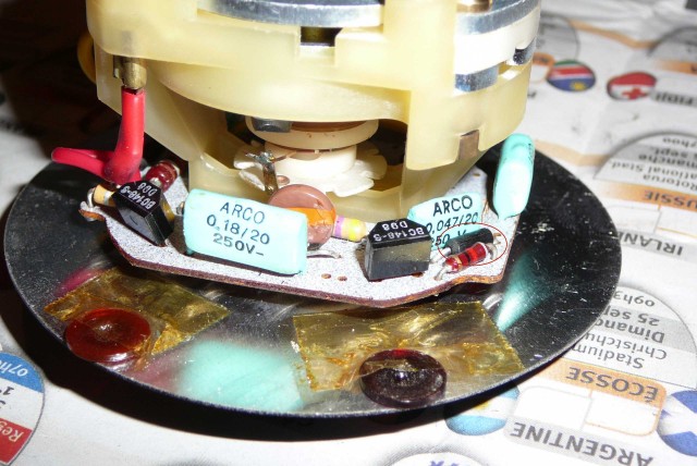

Concerning the tacho, you should double check the dinoplex and make sure you have the right ignition coil. The tacho is electronic, so no damper, just transistors, resistors, and capacitors. If you have access to an oscilloscope, you can check the signal going into the tacho.
fwiw, here is a picture of the insides.
