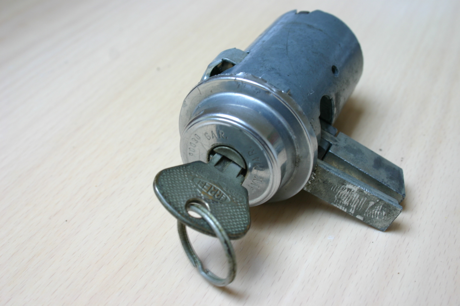

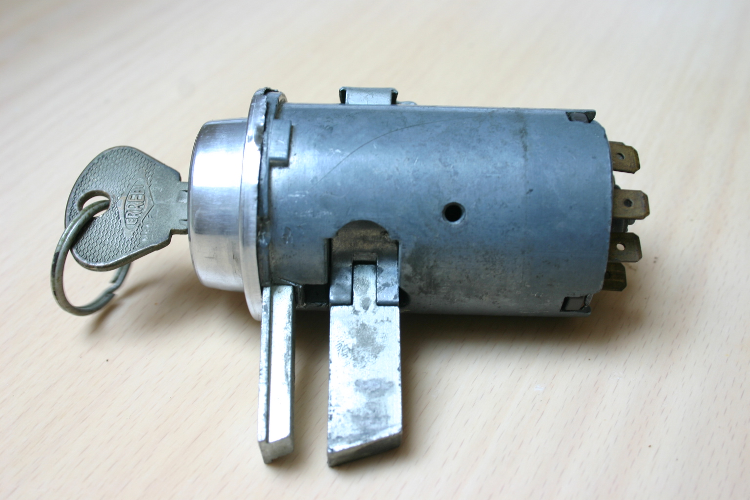

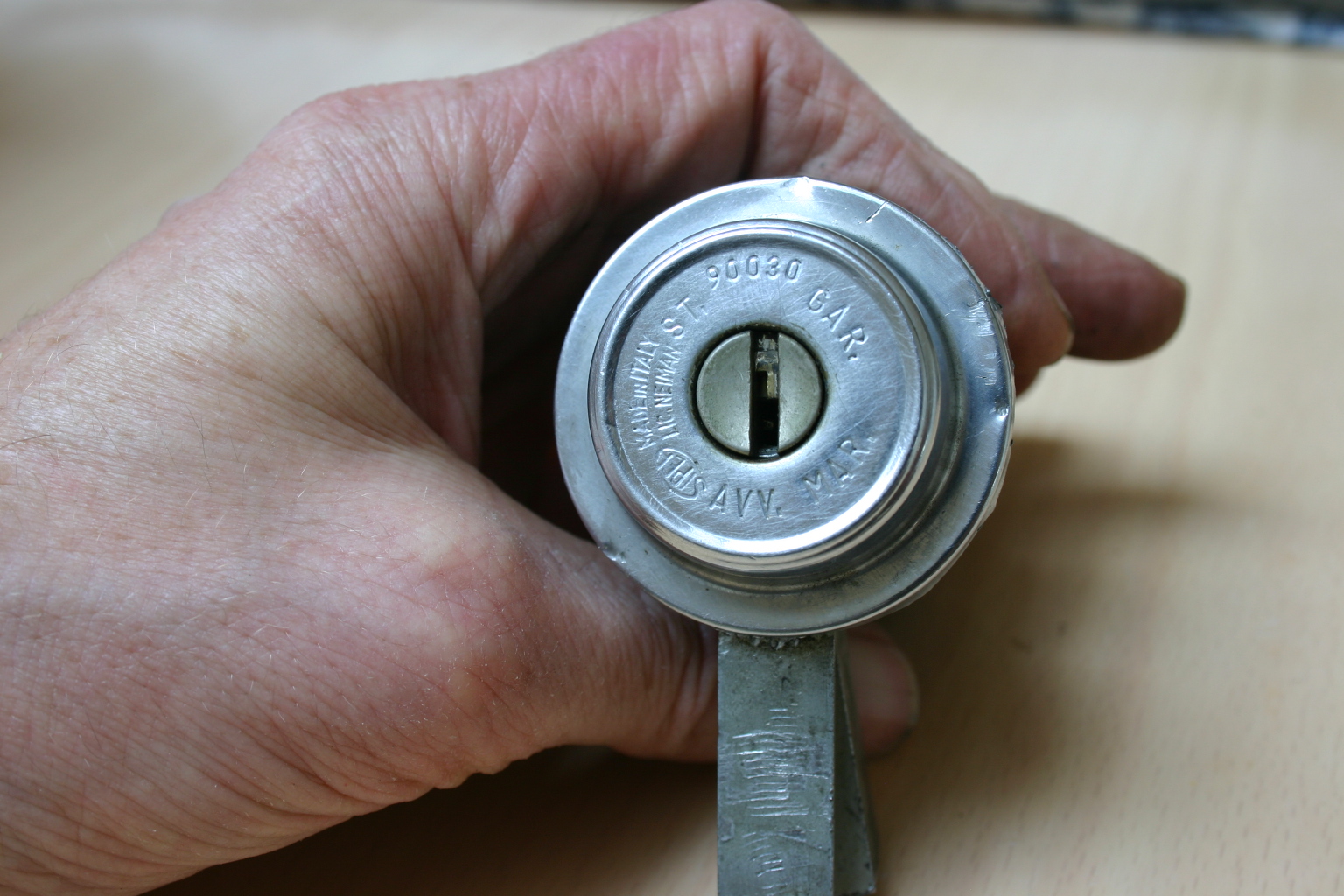

Hi Peter, please check the photos below if this is what you are looking for. At least the # 90030 is stamped on the front side. If you are interested kindly send me a PM to agree on price and clear sending the item to you (in which country do you live?). Alternatively, if you do not have access to send a PM, let me know your mail address.

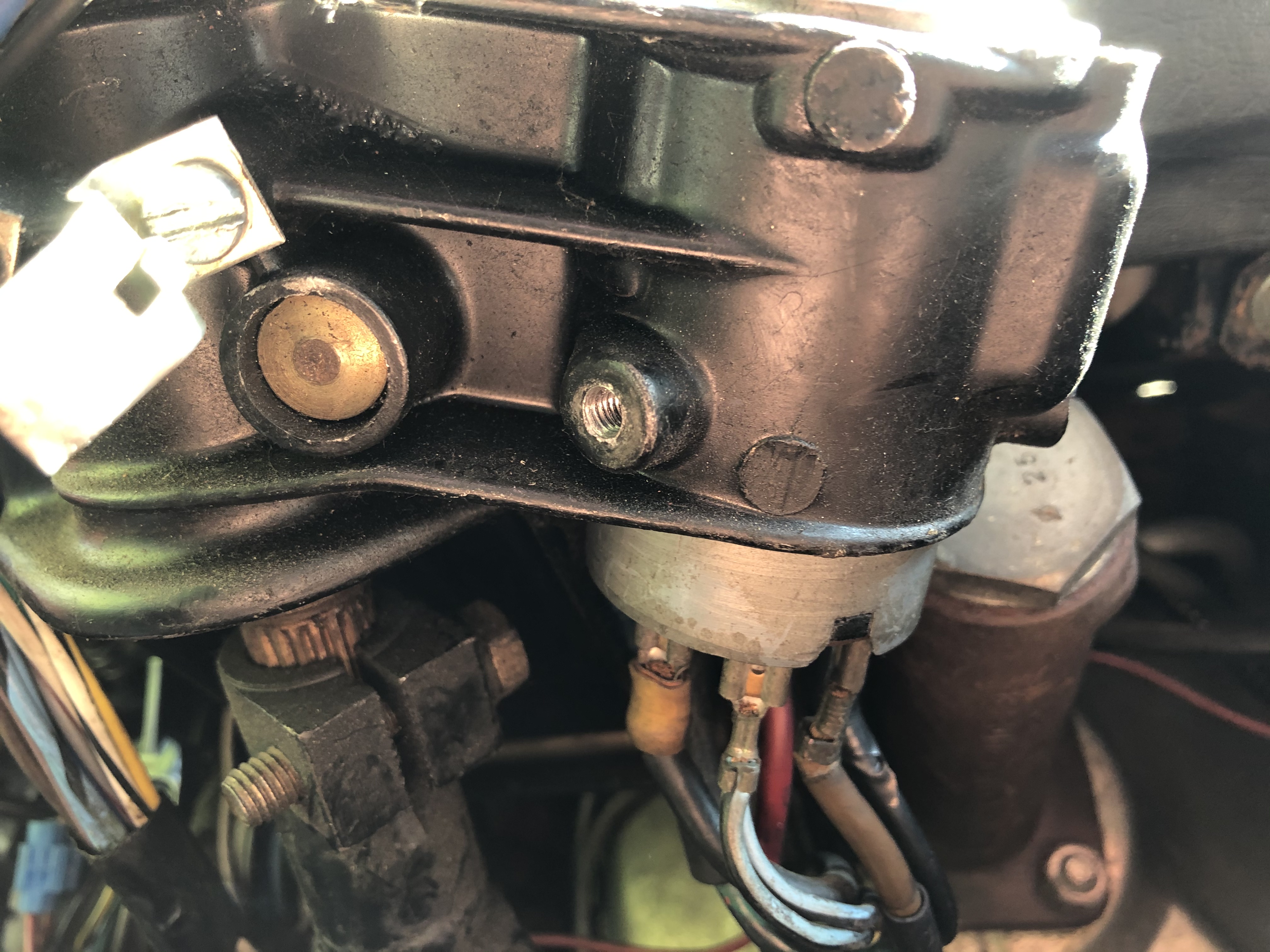

I'm having similar (not exactly the same) issues as the OP. I want to take the ignition switch out and see what's going on and try to repair it using this tutorial: https://www.mirafiori.com/faq/content/switch/index.html
Not exactly the same switch I believe, but I guess the procedure is the same and worth the shot before buying a new one.
I however can't seem to get the damn thing out. I know you have to push the spring inside the small hole on the first picture, but it seems stuck on the side of the steering column.
I've read on some Lamborghini forum that there are two screws and one bolt. I've taken out one bolt and one screw. Could someone enlighten me wether I've missed a screw/bolt?

Scalino, yes, take out the screws (one or two, cannot remember), then take a small screwdriver, press in the pin, and then turn the ignition key. At some point you will feel the pin moving deeper. I believe it is the ignition position 15, not the starting position. Only then you can press in the pin that much that it releases the lock and you can pull it out.
