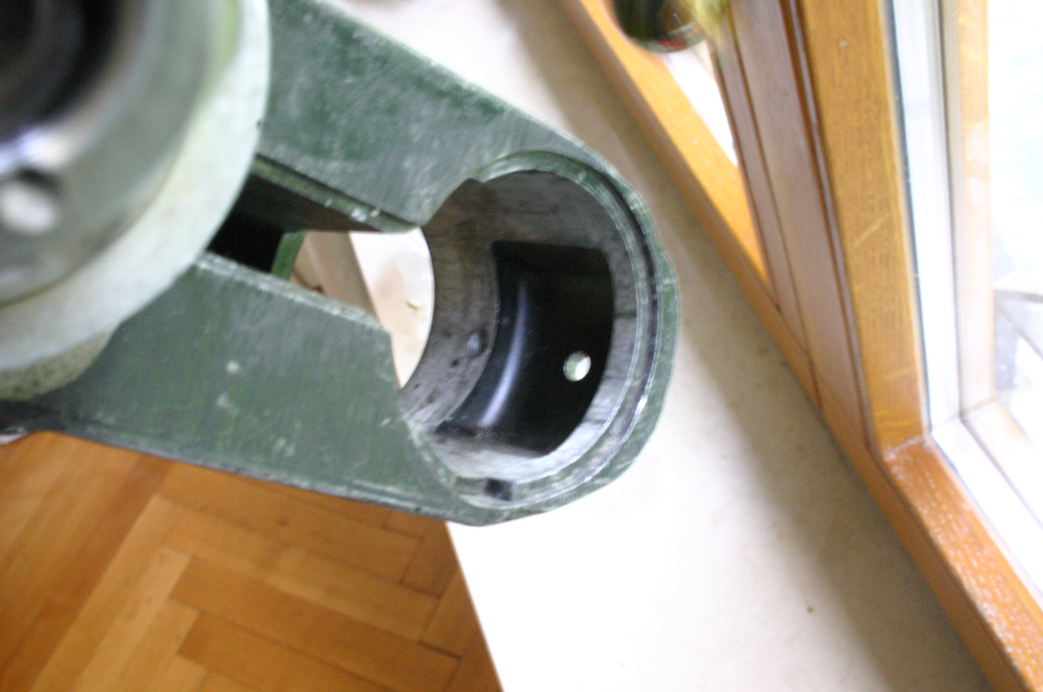

Perhaps these photos can help.

Thanks for the photos Georg and for the advice Thomas. I’ll try with an extra pair of hands and report back. It really feels like you need at least three for this job! :lol:

Georg, might I ask for a picture of the other side of the ignition switch?

Your pictures show I indeed got every screw and the key is definitely in the right position. I’ll try some penetrating oil and see if I got some tube or take a socket to apply pressure from the back.
