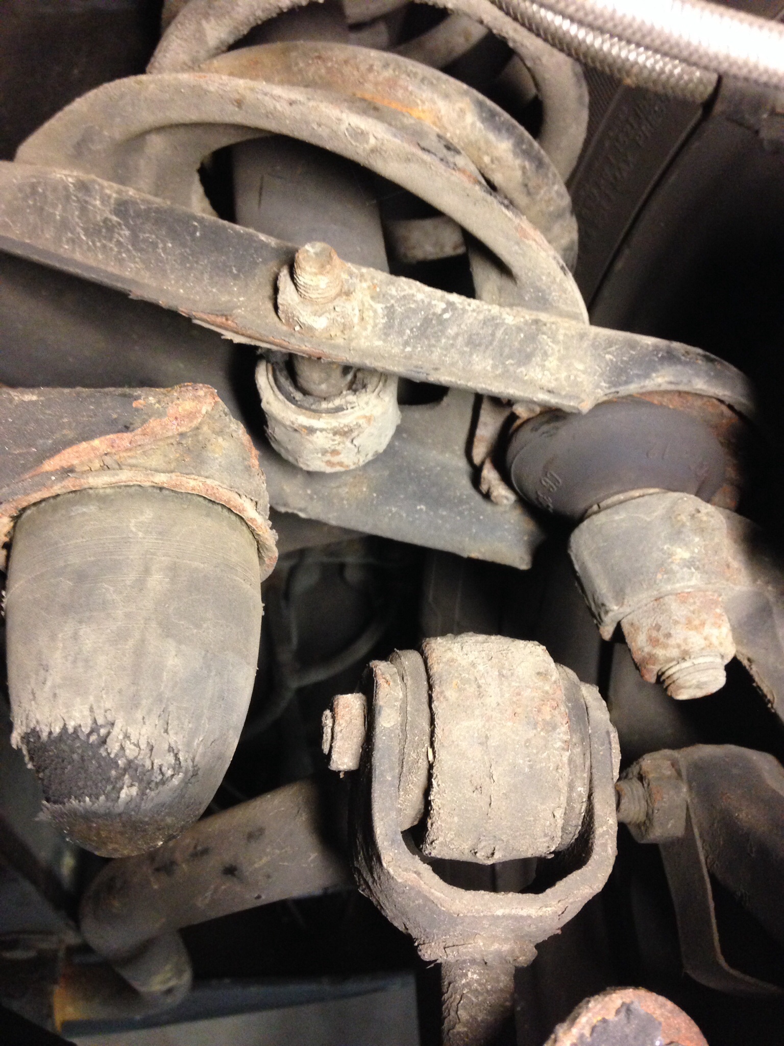

MIne are curving out too..and one was rubbing the tyre when I jacked it up...then I noticed the bottom ball joint is knackered and there is so much play that I can make the tyre touch the spring.

I think I found my problem: bushes are bad... The rubber is old. I will replace these. This should explain also why it got progressively worse. Also on balljoint rubber is leaking, so indeed that adds to the effect...
