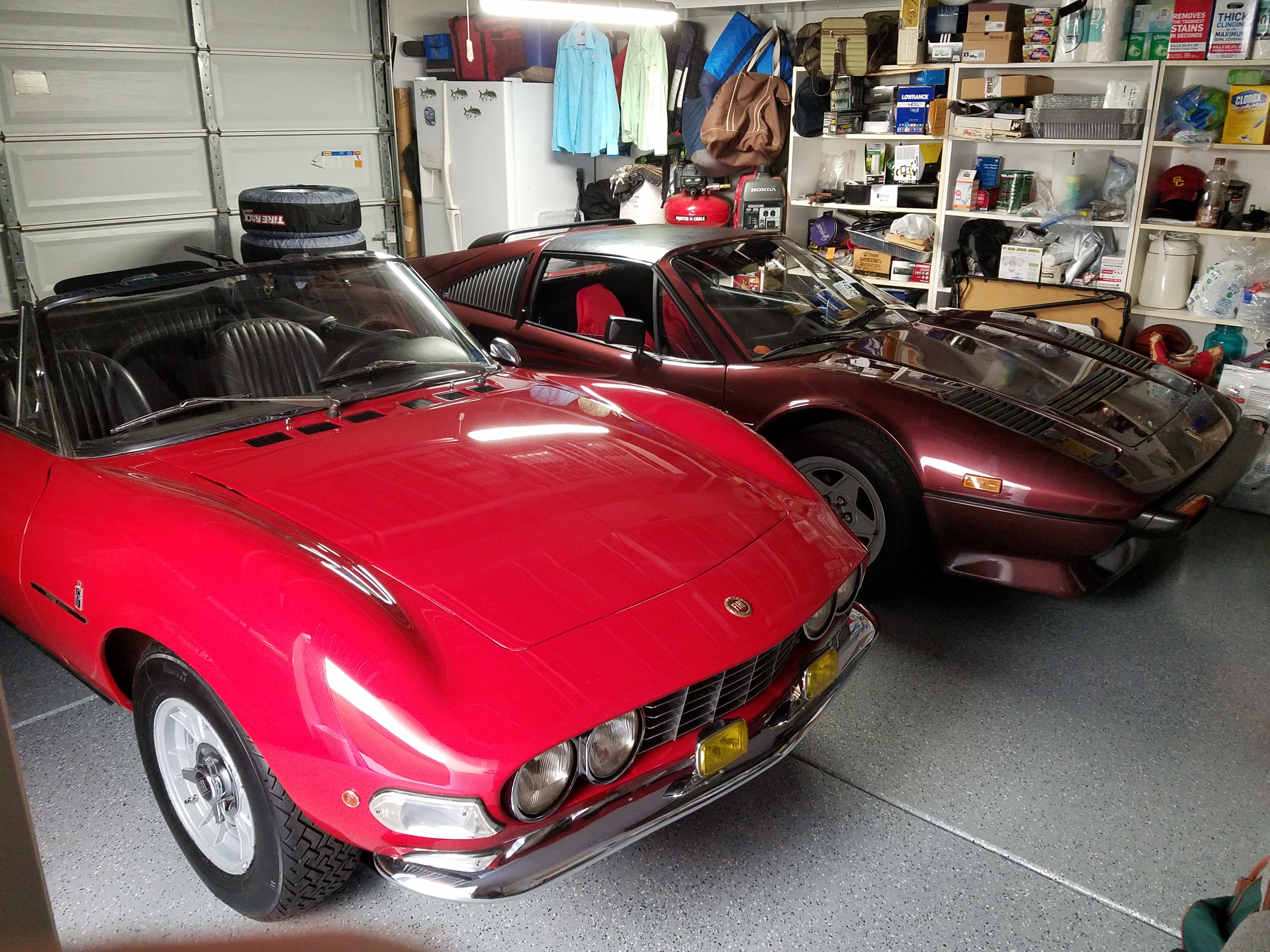

This is 205 looks like on the spider. Pirelli CN36. I really like the classic look of these tires.

Looks great. Just put the same on mine.

That’s a nice looking car! Is that Cinnamon Red?
BTW my car is not restored or running, parked for 32 yrs. but the tyres are 205 70. 14’s. They look like the old Michelin’s. I don’t see any scuffing on the tyres.
