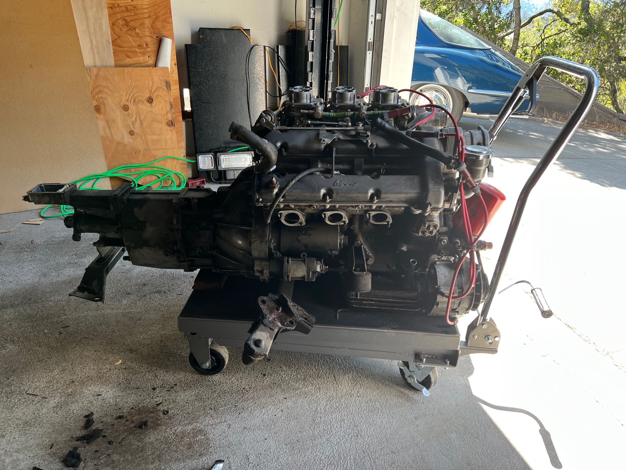

As was recommended by most here - I dropped engine and gearbox down from the car as a single unit. It worked out well with a 4-post lift to raise the car and a hydraulic cart to lower the engine.
I took the exhaust manifolds off first - without really looking to see whether the engine drops with them attached. It's a tricky job with all the manifold nuts hidden by the 'overhang' of the heads. How tricky? I think this video illustrates it.
https://www.youtube.com/watch?v=VTCRlvX-d48
First question then.. does the engine fit back in with the manifolds attached?

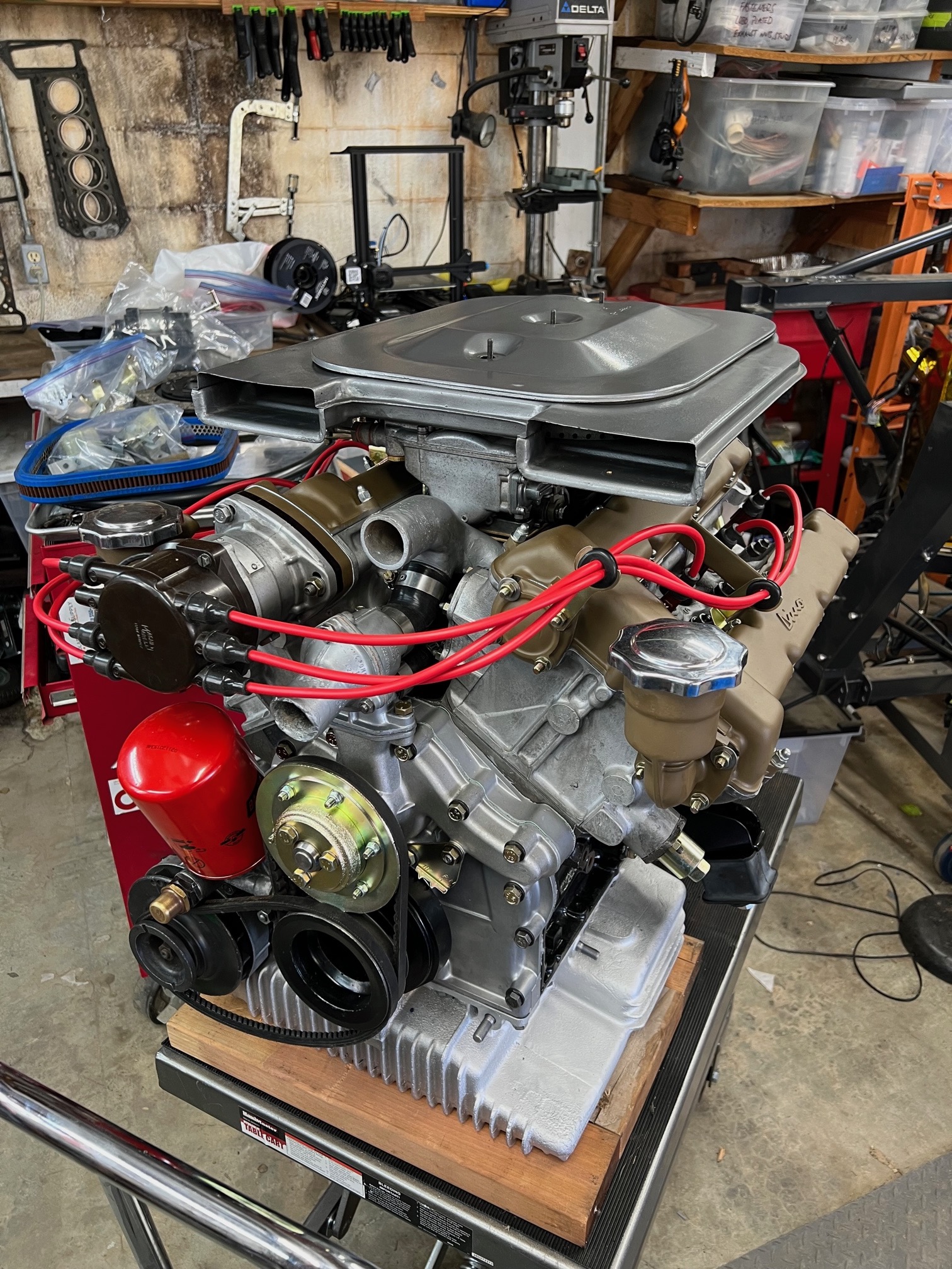

Rebuild is now complete but with a few remaining concerns. A few problems along the way - notably:
* oil-pump - bought new gears from Superformance because old ones seemed noisy rotating by hand. But... new ones equally noisy
* rod bearings - i had to go one oversize pistons after cleaning up the bores - therefore new set of pistons/pins from Superformance (made by Cosworth and very nice) but new pins were loose inside rod-bearings - ordered a set of bearings from Superformance and they didn't fit, completely loose inside conrod housing - bought some Maranello (UK Ferrari importer/parts business) and they were perfect, and cheap enough too. (Superformance also sent me a set which looked like got them from the same place..)
* valve timing - not too hard, had to make a tool to slide-hammer the vernier pins out. Despite best efforts to make everything it kept being one whole tooth out before I realised any slack in the 'tight' side of the chain makes the chain slip one tooth around the drive sprocket. After that..easy.
before and after shots: The remaining concern is the clutch. I asked questions about it here a while back.
