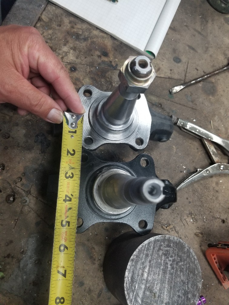

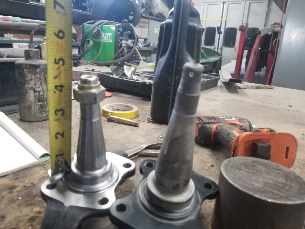

We are currently restoring a 1967 Fiat Dino 2000 Cabriolet. As to be expected, there are a number of parts that were required. A pair of front Axle Spindles were ordered from Mr. Fiat with fitment confirmed before hand. Regrettably, when we attempted to install them, there was 1/2" difference between the mounting holes and the spindles were shorter as well. Mr. Fiat's representative offered us a store credit as a resolution which we found acceptable.

can you please post apicture of the wrong spindle and the original part nr.?
I have a hunch what could be wrong...

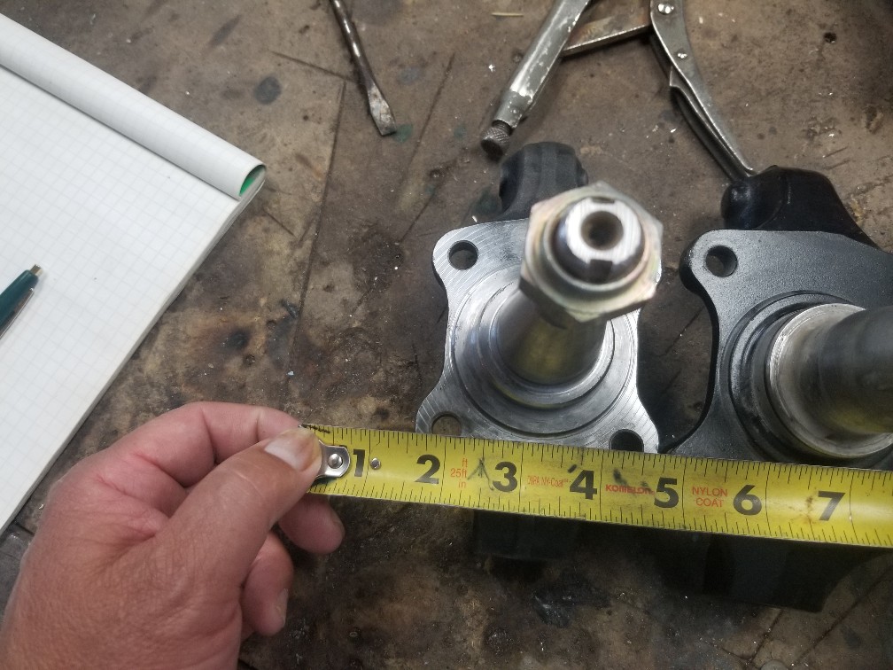

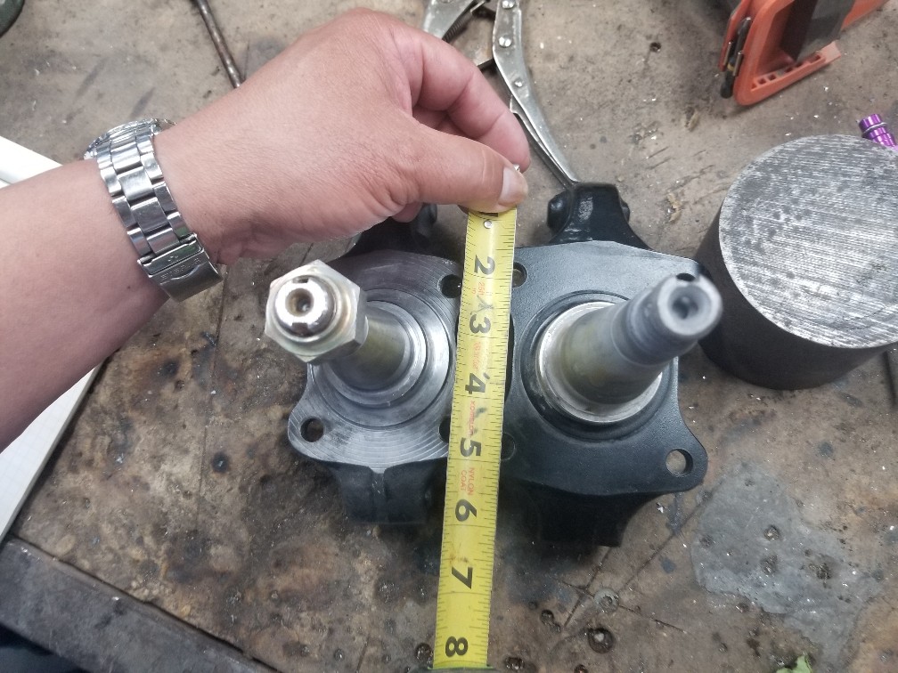

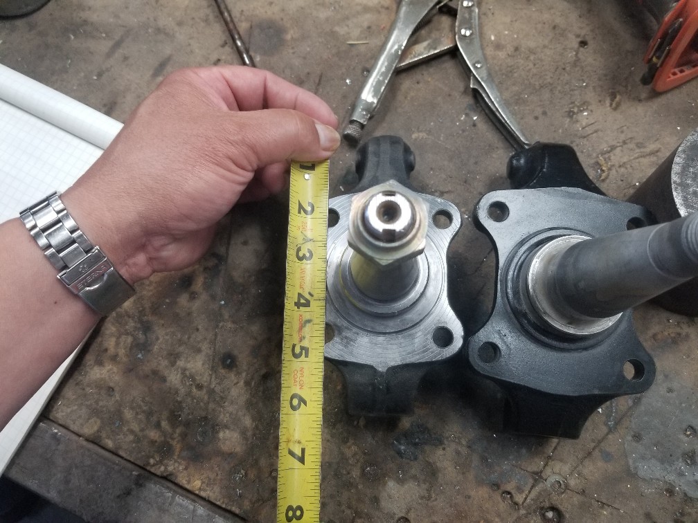

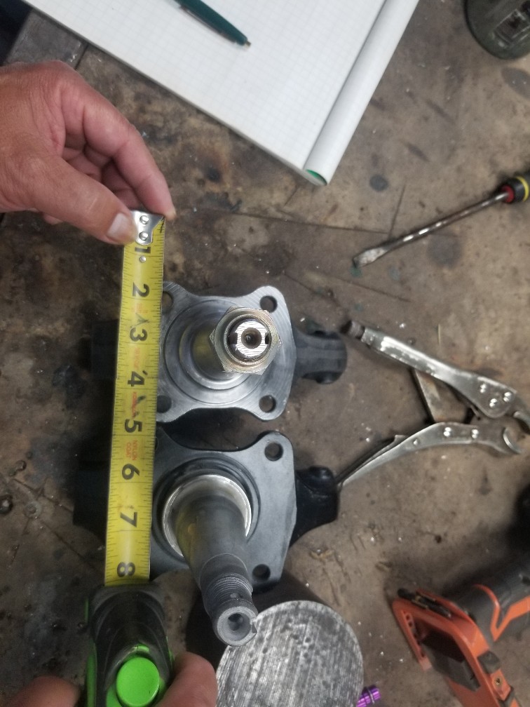

Please find attached pictures of the spindles that's pretty request. As you can see, there is approximately half an inch difference between the mounting holes both horizontally and vertically. As well the spindle itself is noticeably longer. The black colored one being the original. It was suggested by Mr. Fiat that the could be modified. However, when it involves critical suspension components, we believe they should never be tampered with as their integrity would be compromised....many thanks for the responses...
Re: Fiat Dino 2000 Parts Suppliers
I neglected to include the part numbers which are 4104944 / 4104945. As well, i have attached better pictures of the horizontal mounting holes and their distance for review. Many thanks.
No way in the world could/should this be "modified to fit" My opinion.

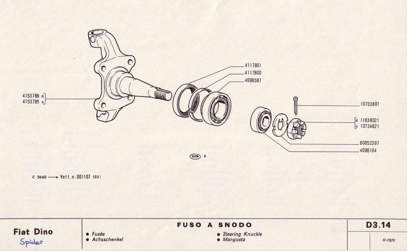

Keen,
from your pics, I am pretty sure your Spider has knock-off wheels, and -if so - you
are not looking for the correct spare part numbers. See D3.14, below:
These front axle spindles are longer than the corresponding ones used for all Fiat
Dinos with bolt-on wheels (both Coupes and Spiders).
