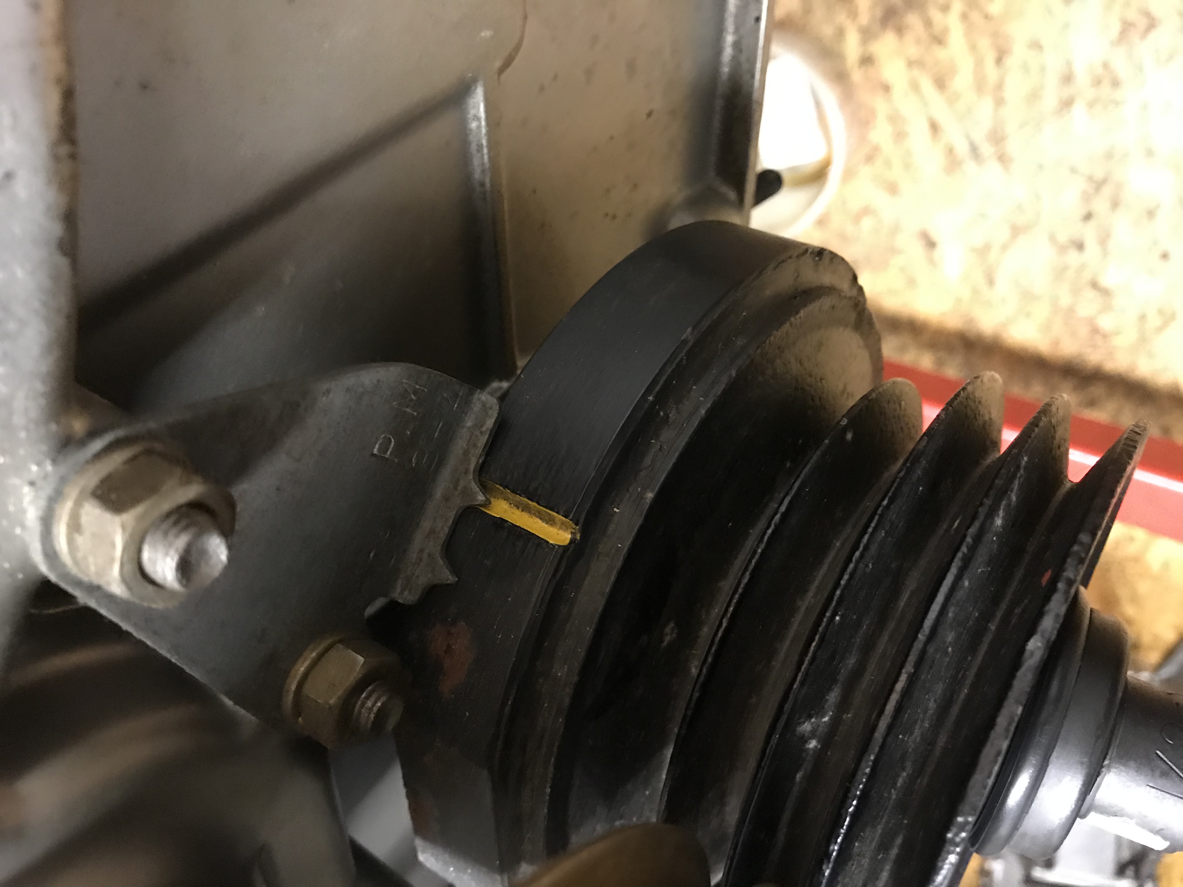

Posts: 232
Re: IGNITION TIMING. HOW TO WITH STROBE LIGHT.
not exactly what I meant:
the ignition advance at idle speed is 10 degrees before TDC.
The 10 degree marker is for setting this advance with the strobe light. This is the left marker on the small plate with the two marks/peaks. I hope you have this original plate with the two marks.
On the pulley you have a Marker/white line that must match with the 10 degree mark at idle speed with the strobe light, to adjust it, loosen the distributor a bit to move/turn it gently to influence the ignition advance.
On the picture the marker matches with TDC. For idle advance with the strobe light it must match the other/the left marker.
…strange: the picture looks being mirrored but when being opened correctly….

Thank you Thomas.
Now I understand. 1st marker on the indicator plate is 10º BTDC and the line on the pulley must coincide with that at idle, using my strobe light. Currently, that pulley line is about 10-15º to the left of that 1st marker, so I have some adjustments to do.
The second marker on the plate, marked PM, is TDC. In Spanish, we say Punto Muerto, so I suppose it's very similar in Italian.
It all makes sense now. Thank you.
