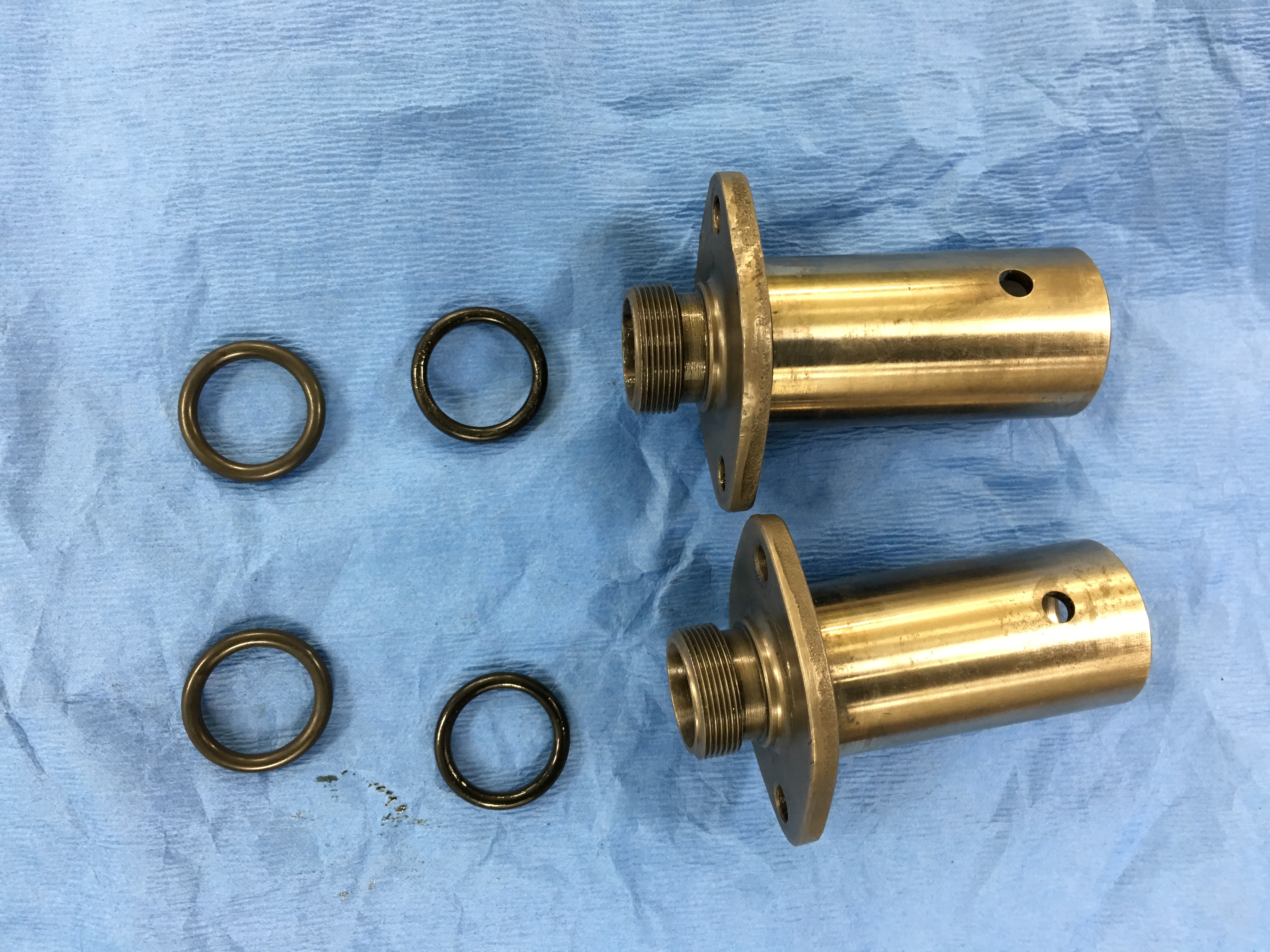

There are two seals:
- one paper seal between head and tensioner
- an O-Ring under the tensioner cap.
While you can unscrew the cap and then see and can exchange the o-ring, the paper seal can only be replaced when the head is disassembled.

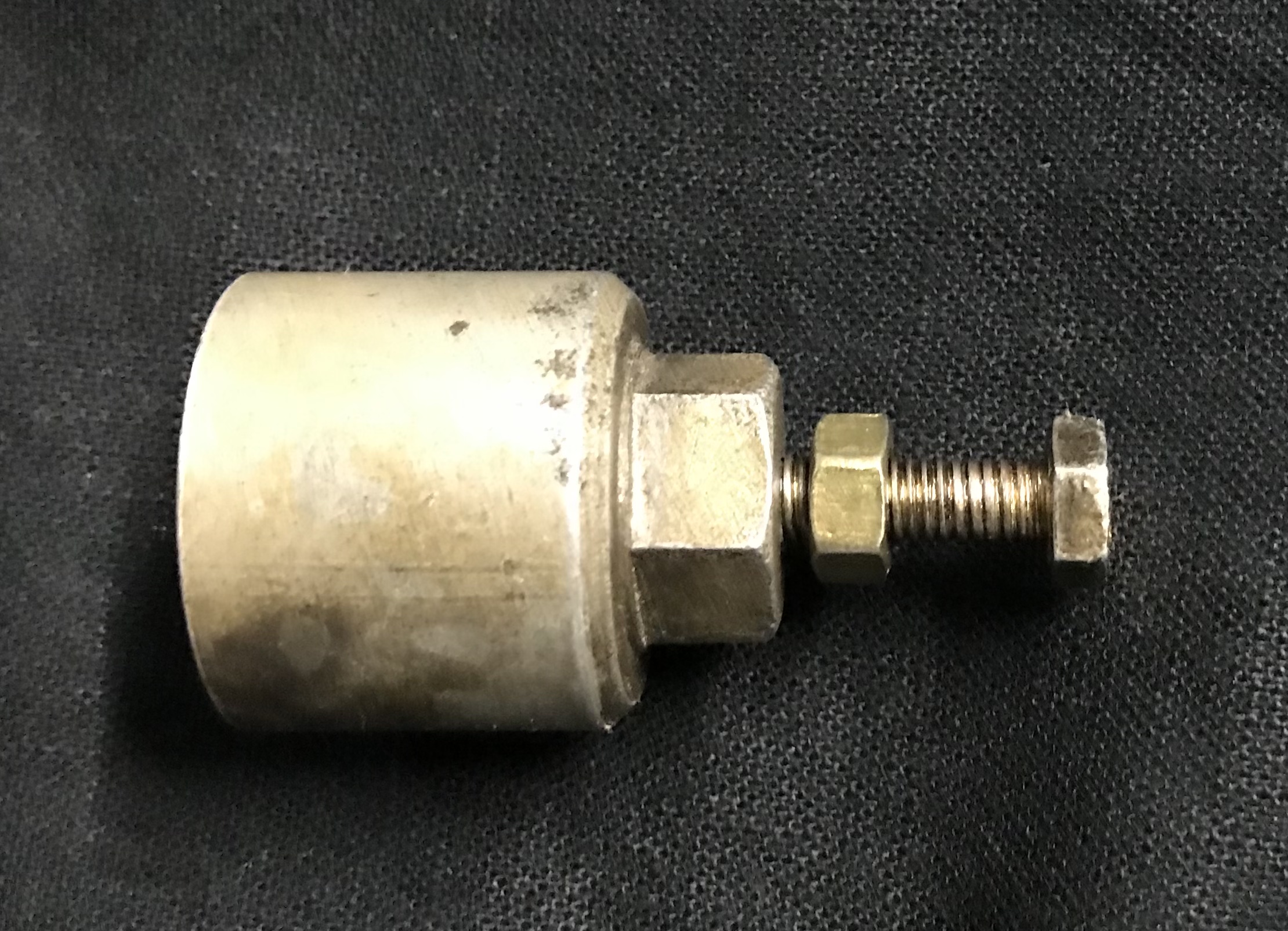

There is another thing: you still have the old version of the cap without counter screw. As this version can cause that the chain looses tension as the tensioner can move into the cap, already in early days this wa upgraded by a counter screw.Highly recommended to avoid problems and damage.

Well, you made me look. I thought I had done this without having the head off so I looked at my photo record and indeed I did take out the assembly to carry out the additional bolt modification, re-gasket it and replace the O-ring. I don't recall the details of how I did it but there were no extraordinary means such as removing the head...

If I remember right, you assemble the tensioner on your bench and compress the spring before tightening it. Then, you bolt the pre-loaded tensioner on the head and release tension once it's on. Good tip on the counter-bolt, it was a Ferrari "upgrade" for the 246 at the time. Concerning the oil leak, I confess to a small dab of silicone to help the o-ring on the one tensioner that it upside-down. Since it is always full of oil, it is easy for it to drip on the exhaust manifold.
Posts: 260
Re: Chain tensioner leaking
I do not have the tensioners with the added set screw/bolt. Is this an after market part you can buy or is it something that can be “ homemade” I didn’t see it in the parts books. But the I only have the 2.0 manuals.
