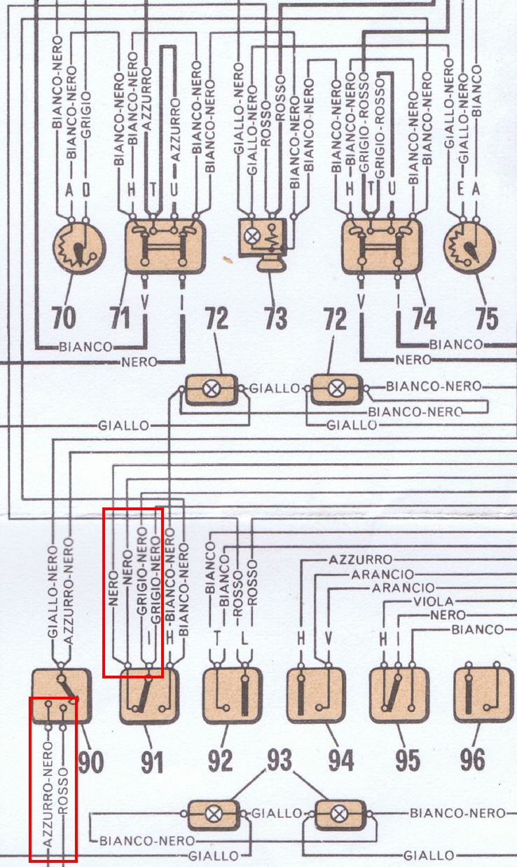

I disconnected the wire's switch from the dashboard without noting the wiring order

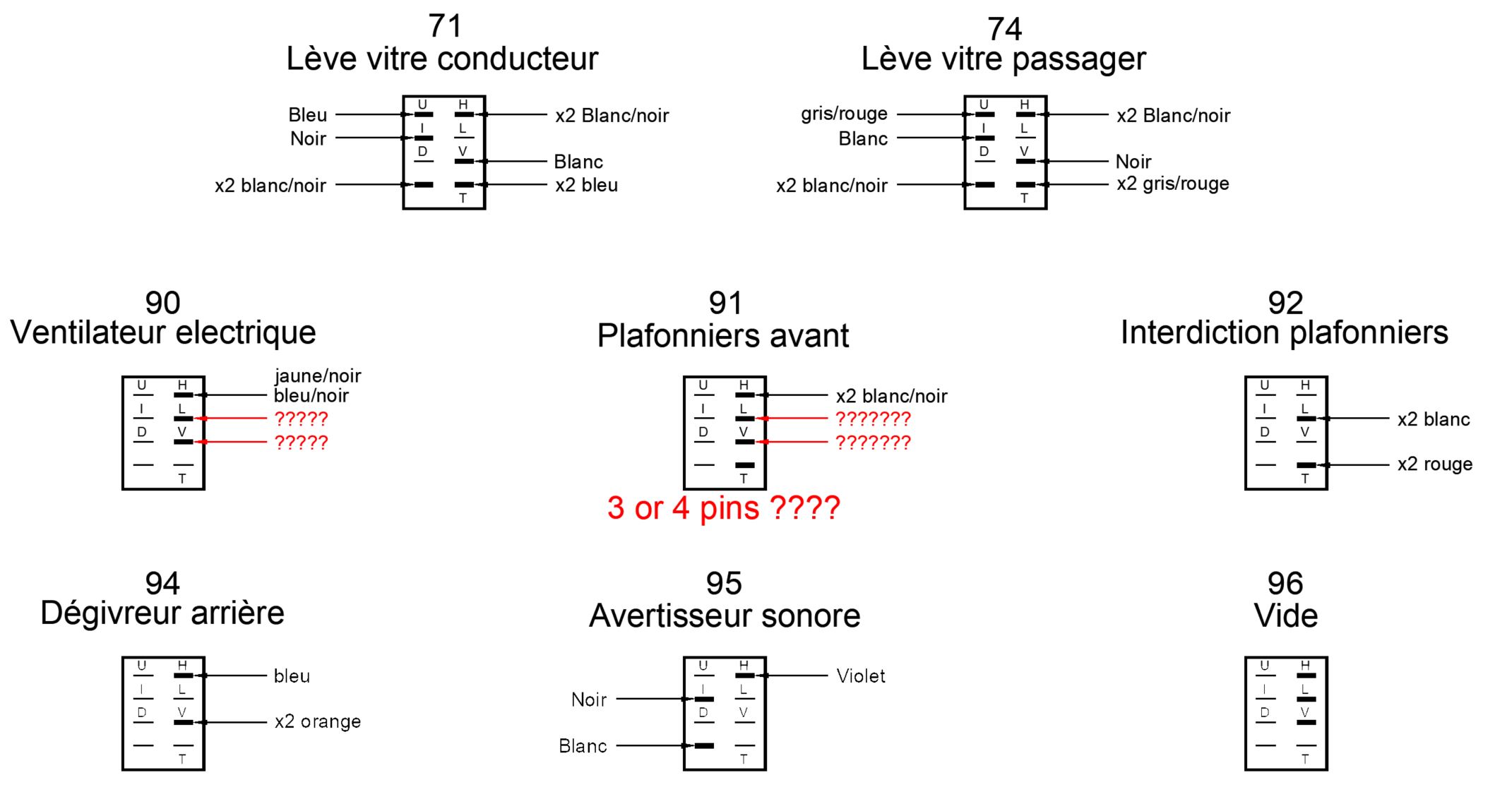

Using the wiring diagram, I tried to remake a plan for the switch command connections (sorry it's in french
I'm certain for the 71, 74, 92, 94 and 95.
For the 90 (Fan switch), I have a doubt with 2 wires (black/blue and red). Can you tell me where to connect these 2 wires ? on "L" pins or V "pins" ?
For the 91 (Inner lights), first do you have a 3 or 4 pins switch ?
second, where to connect these 2 wires (double black and double grey/black) ? on "L" pins or V "pins" ?
