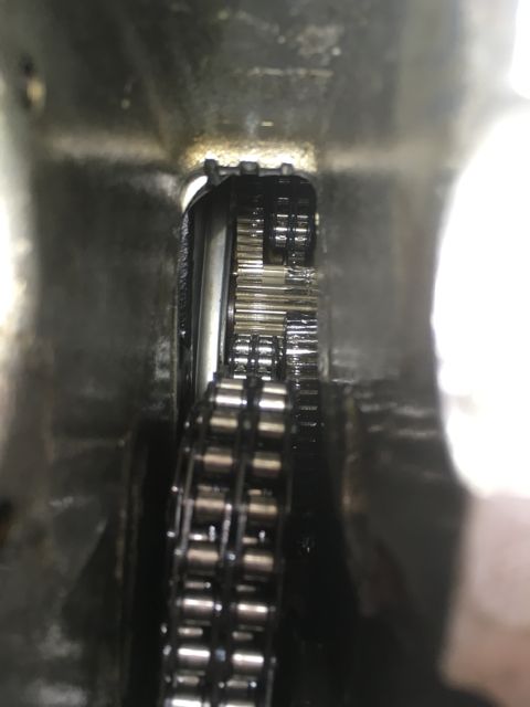

So, as I drained the slush (oil/coolant) I decided to remove the left bank camshafts to get a better view of the sprockets at the bottom of the engine, and there are also signs of damage, furthermore I noticed a pretty nonchalant use of liquid sealant...
Good news after all, I have decided to ship the engine to Nose2Tail, in Holland, they will do their magic..

Wow, looks like the roller bearing of the left cam drive gear just totally disintegrated causing the shaft to get out of line. And that caused the gear to jump until the piston hit your valves.
Makes me very sad to see this, such a nice and original engine and car.
But i'm sure these guys in Holland will do a good job, they have so much experience with these engines and they made all special tools to rebuild them so i'm sure it will be in good hands.

Yes, there is a bit of damage... But now I´m a bit more cheerful, finding the right workshop for the job, thank you for that lead, Stefan..Stefan2000 wrote:Wow, looks like the roller bearing of the left cam drive gear just totally disintegrated causing the shaft to get out of line. And that caused the gear to jump until the piston hit your valves.
This proves, that it´s not always a benefit to find a car that have driven no more than 1100 km per year the last 48 years....
So, next up, are to drop the engine, cradle it and ship it to Holland, and wait for springtime next year...
