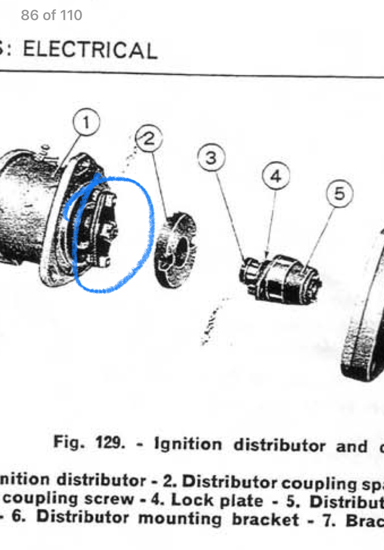

Hi, no need to take the cap away although it is not difficult and to clean it from inside would not be a Bad Thing. But to your question: i think you have moved/turned the distributor unintended a bit and assembled it back in by 180 degrees turned. In the picture I marked blue the drive at the back of the Distributor. You can put this back in in two positions - I suppose you have done the wrong one. So get the Distributor out again, turn the blue marked Drive by 180 degrees and put it turn back in - my assumption is that then the Engine will start as then the Distributor sends the spark at the right time.

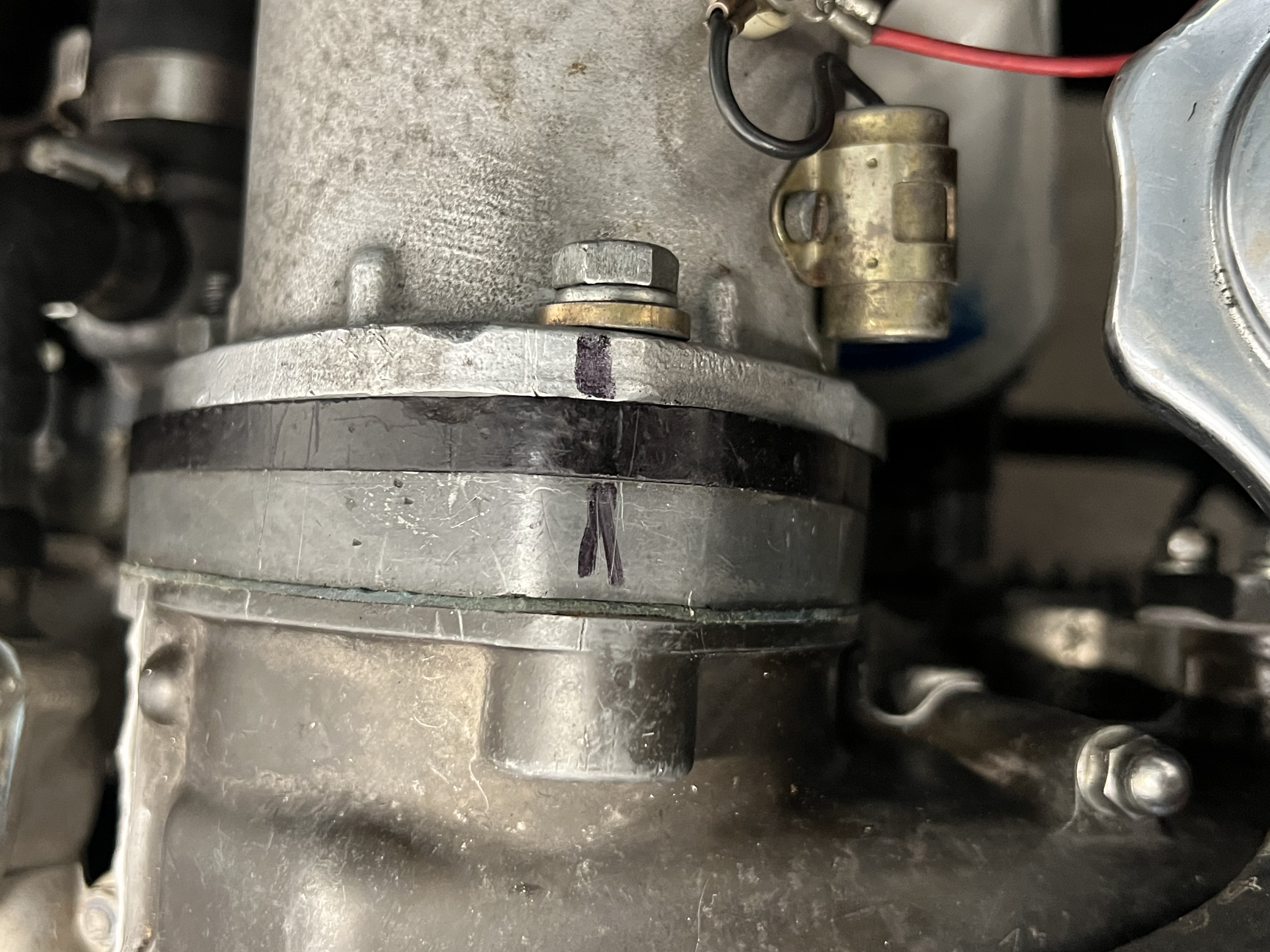

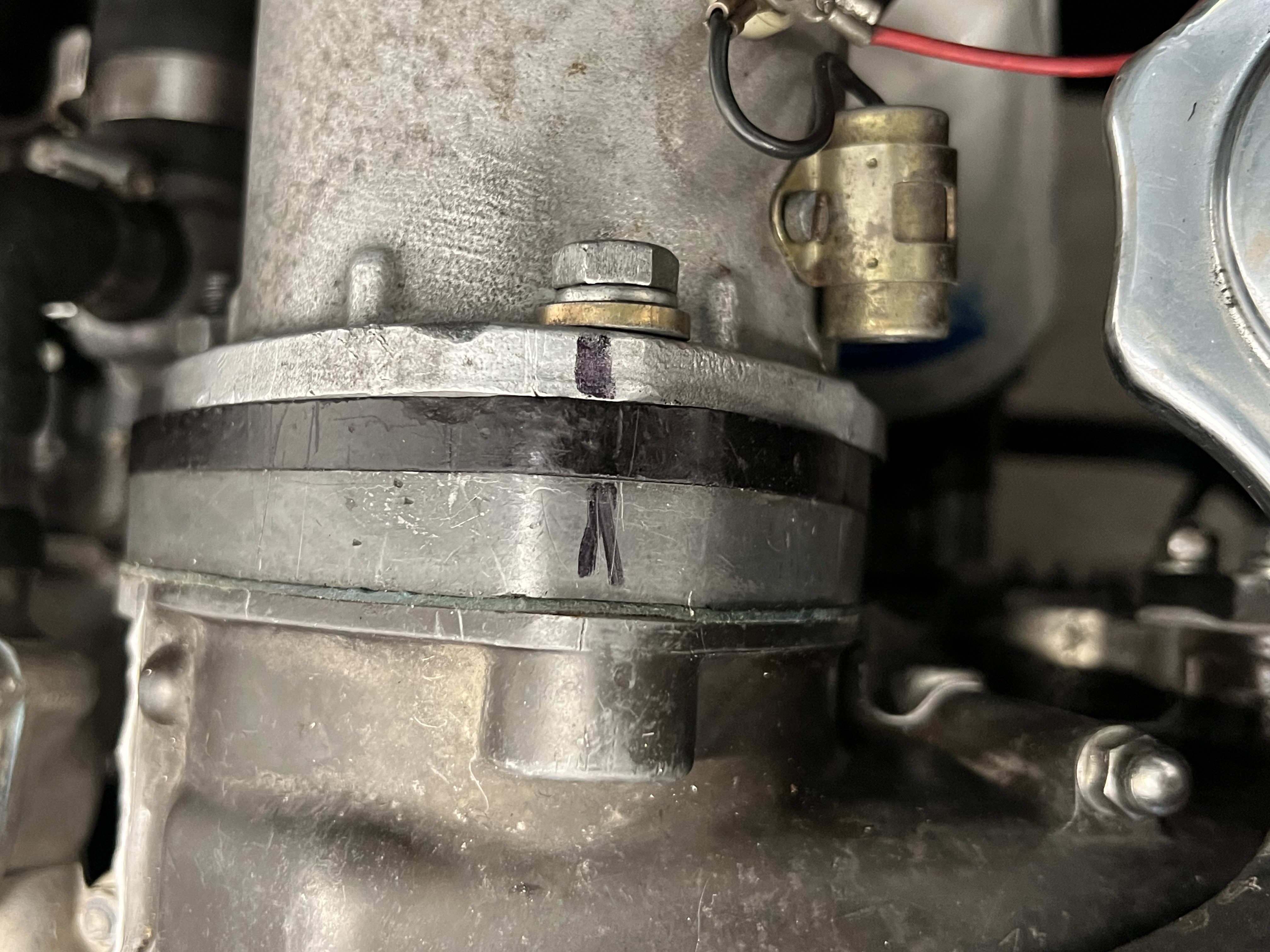

I marked the distributor location against the camshaft as shown before I started the repair. I’ve moved the distributor a few degrees above that mark and a few degrees below that mark with no luck. See picture. How do I connect a strobe? Do I connect it to the first cylinder spark plug cable to see if the light pulses?

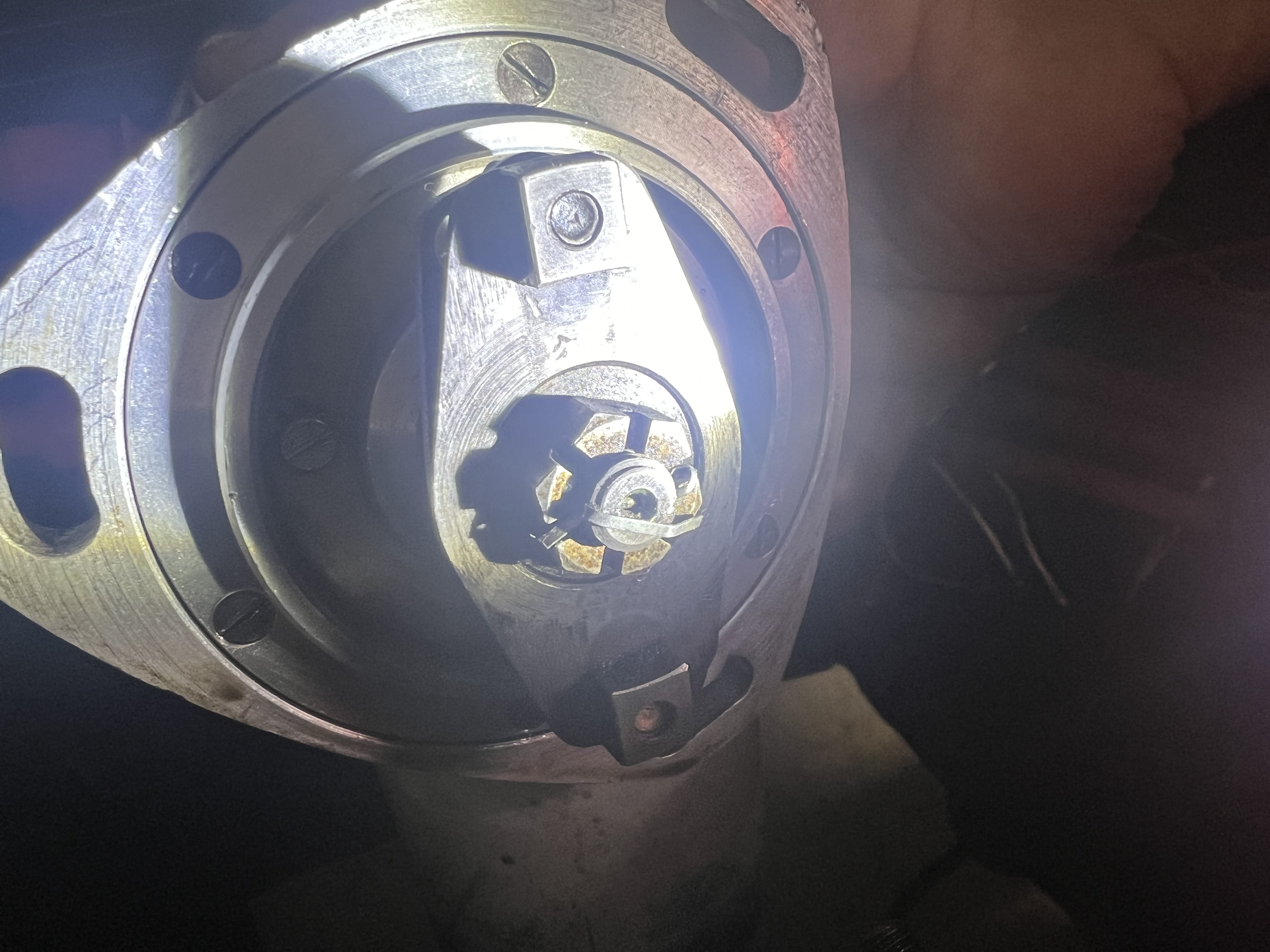

The distributor’s rotor has this odd thin metal sliver across the center nut, doesn’t look like it belongs. Any idea why it’s there?
Posts: 230
Re: Replacing valve cover gaskets
It belongs there, its the security pin for the „castle nut“.

We discovered that the Marelli distributor was not properly grounded - on the outside of the distributor there is a small condenser / capacitor and there is a screw that connects to the car’s ground. If you don’t have the proper washer then you can short the capacitor and the car won’t start. Sometimes it’s the smallest thing!!!
