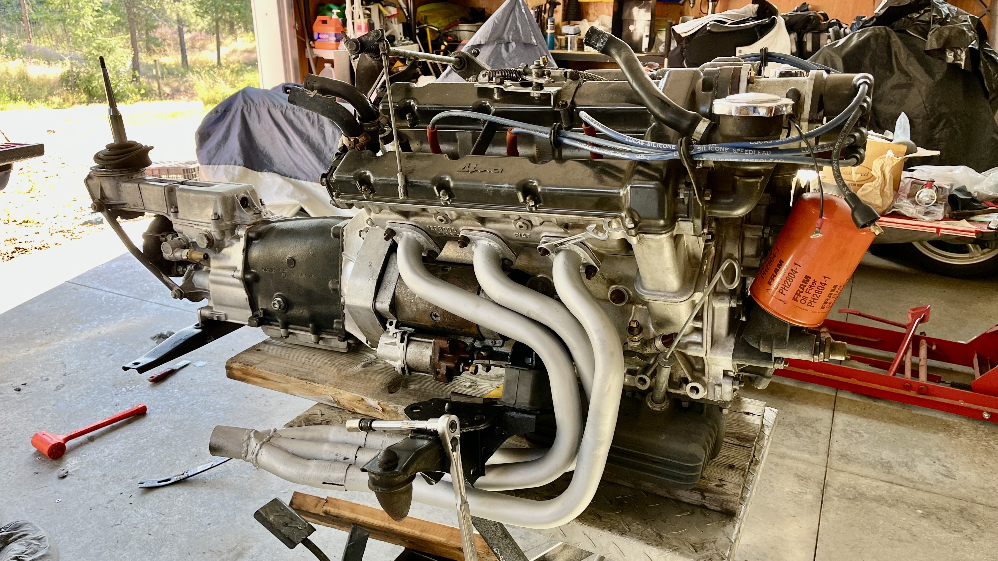

First off, thanks Tobi for the link regarding valve covers. Very informative. I’m attaching a pic of my car which has 53k on it. Chassis #665. This car was stored from 1987 to when I recovered it in 2022. It’s unlikely they were ever off based on the dried oil and perfect nuts.
I have to agree, the covers were probably gold pacified. I’ve had lots of motos with exotic metals and this colour of pacification always ends up a dull grey/ brown colour.

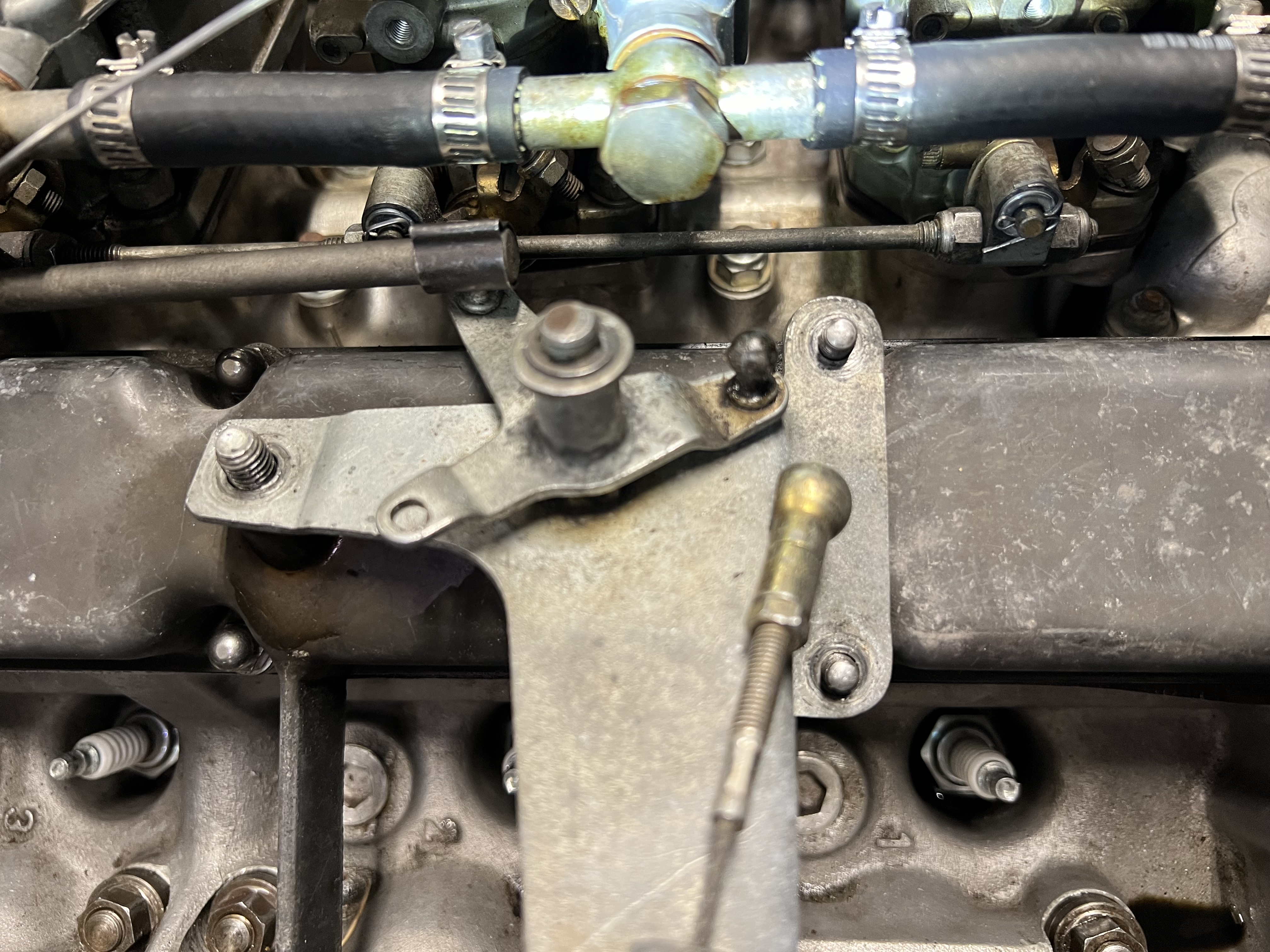

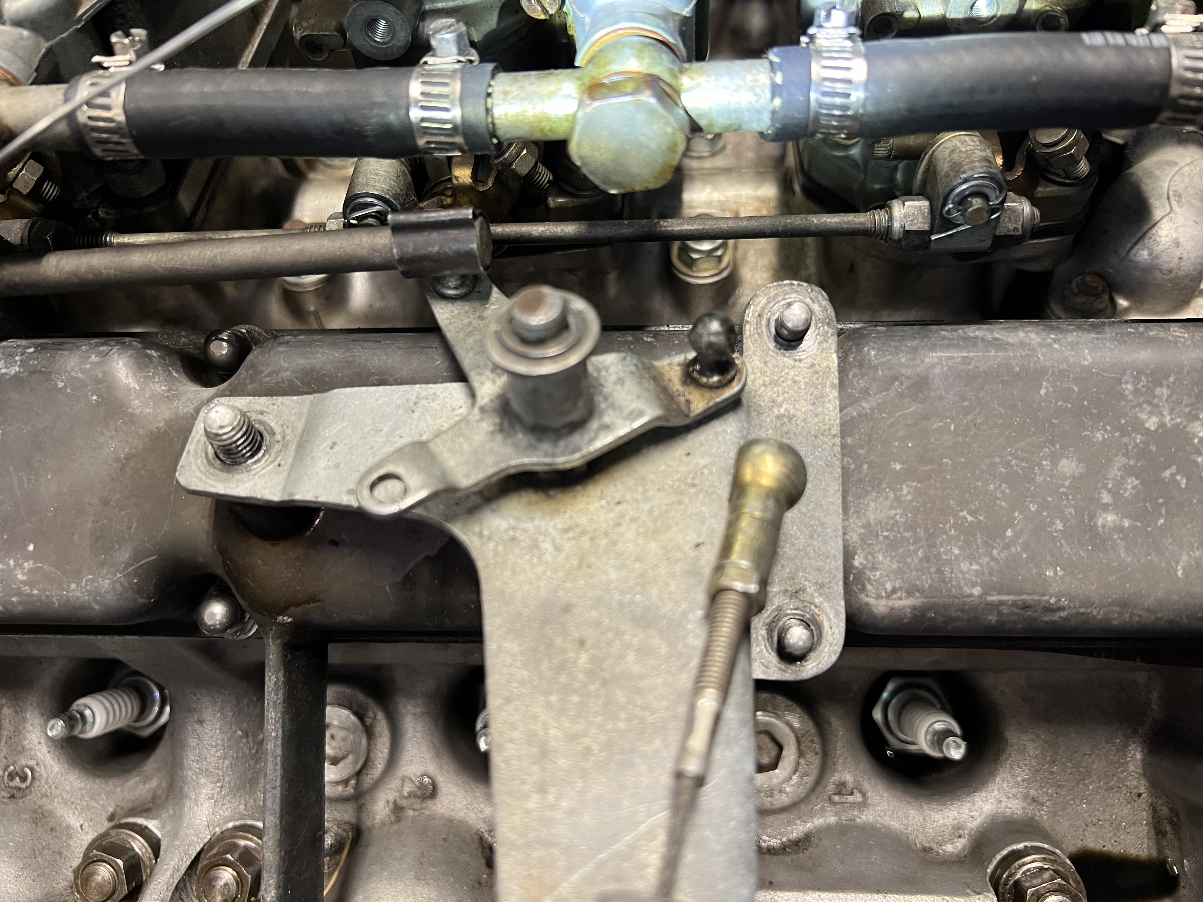

What’s the best way to disconnect the throttle linkage from the rod that revs the carbs?

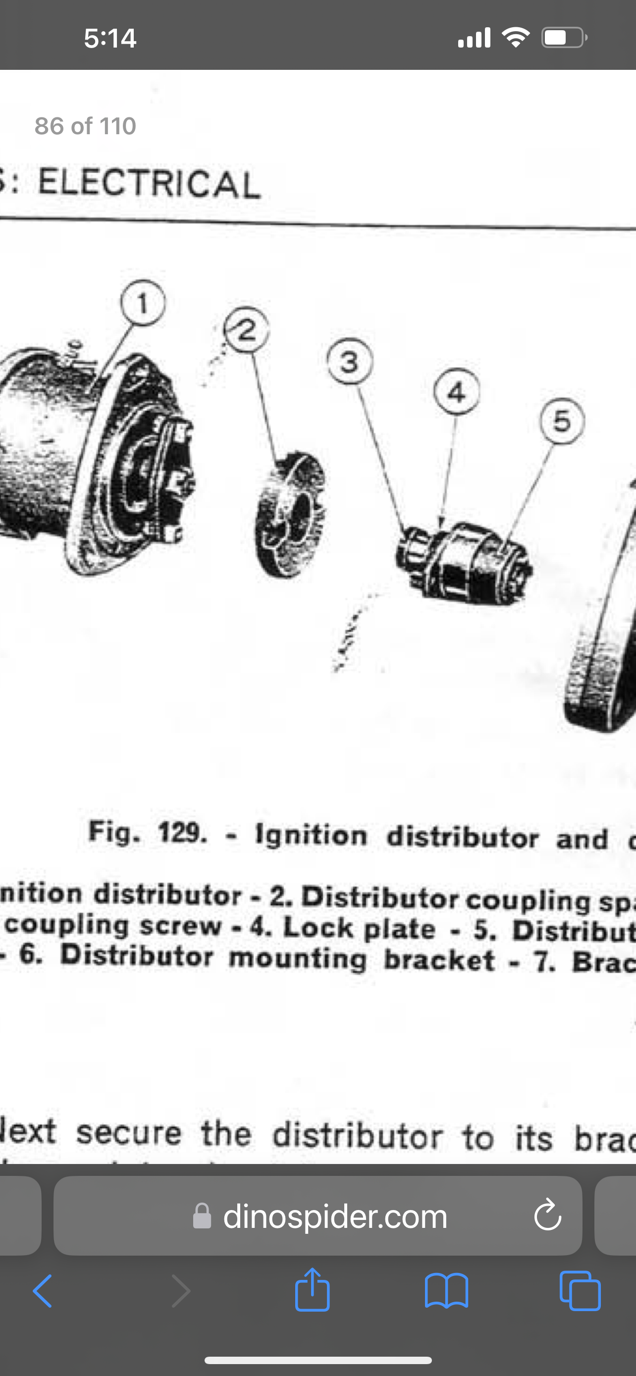

Proud to share that the job is complete, I put everything back together and now the car won’t start. I’m guessing there is an issue with the distributor which I had to remove from the engine to remove the valve cover. To be clear. I didn’t remove the distributor cap or the plugs but rather I disconnected the distributor housing from the engine. I had to reset the distributor coupler spacer (#2 in picture) when I reattached so perhaps that the distributor isn’t in the correct setting? The car tries to start but won’t turn over. Any advice? I’m confident all the plug wires are attached properly.
Re: Replacing valve cover gaskets
Try: Distributor out, Turn Distributor Drive at back of Distributor 180 degrees, back in and start. If you are Lucky that was it, if not you have mounted Nr. 5 by 90 degrees wrong. Look and understand how the Distributor Drive Works. In your picture, number 5 can be mounted in four positions, 2 of them are correct, 2 of them wrong. Must be correct positioned related to crankshaft. If you have Not removed number 5 it can only be the 180 degree thing if Engine ran before…
Thats why Michael advised in his earlier thread to mark the Position of the things you disassemble before
