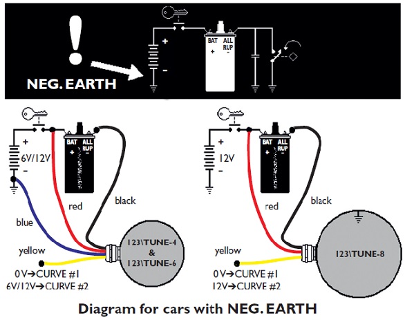

As far as you know, would i have any problems using a 123 just for triggering? From the MSD box do i need to use the magnetic pickup wires or the white wire that is normally used for the points? And from the 123 Ignition do i need to keep the blue one attached to earth and the black one attached to the white one from the msd, or the black and red one from the 123 to the magnetic pickup from the MSD?
Thanks for pointing me on the diffences between inductive and capacitive concerning the coils, after studying it makes a lot of sense that for inductive you need the right dwell to charge the coil enough but i did not think about the fact that with capacitive discharge the capaciter in the ignition itself is charged and blast around 500V right onto the primary side of the coil.

Hmm, the 123 PCB i know has a STGB20NB37LZ IGBT in place, that one can handle 40A at 25ºC and 20A at 100º, pulsed 80A. A 0.8Ω could would be run at a max of 6-8A to avoid running it into saturation, so the IGBT should have no problem driving it even continuously.
For the MSD 6A please use the Blaster 2 coil (#8200 or #8202), the Bosch 334 coil is designed for a high power inductive ignition.
Connect the MSD white wire (points) to the 123 black wire, the 123 blue wire to earth and the 123 red wire to battery plus.
Connect the Dino Veglia tacho to the MSD grey wire (Tacho output).
Also source a 80Ω 5W resistor and connect it between the 123 black wire and 123 red wire, so there is some switching load for the IGBT.
That setup should work nicely together.
Good luck,
Adrian
