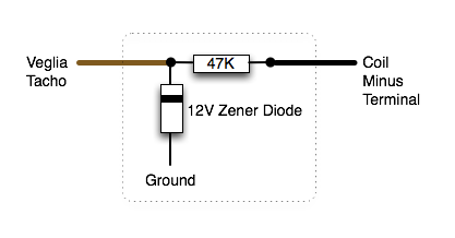

The electronic Veglia tach expects a square wave 12V signal, as coming from the distributor in a Dinoplex factory setup, it won't work with a high voltage pulse when connected to a coil minus terminal. What you could try as a work around is to put a 10K-47K resistor in-between the tacho wire and the coil minus terminal, and a 12V Zener diode between the tach wire (after the resistor) and ground.

Thanks Adrian, i will definitly try. If i use a potentiometer instead of a 47k resistor, am i able to finetune the reading on the tacho?

You could try a 100K potentiometer for finding the best resistance as long as you don't go below 5K to avoid too much load on the Zener. I would just try a 10K, 33K, 47K or 68K resistor and keep the one which works best.

Do i need a special zener diode, i see that for a 12V you can have 0W to 5W
