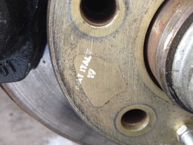

Brakes in gold anodized with "Fiat Italy" stamped on them.  Black calipers.

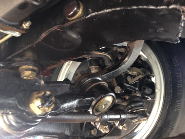

Original hardware, un-restored, note plating colors

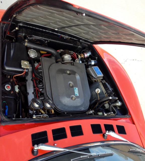

Un-restored engine compartment.  What it should look like.
