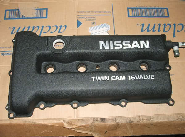

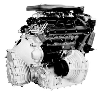

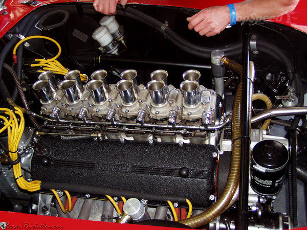

[quote="Dinofanwim"]Hey Dinoswede,
You are absolutely right about the engine number. Sorry! (I think it should be 0001540)
However my postings as regard to the finish, are 100% right!
Now, it might be possible that during production of the 2.0 l engines, there have been 2 different types of paint treatment.
Or perhaps, as Patrizio and I are suggesting, that it was an update to be carried out by the Fiat dealers!
In any case, a very good protection to any kind of magnesium item, is to first get ridd off all oxydised material (= the white powder) and give it a first treatment with an epoxy primer. This will seal your precious covers well.
And as for the finish, I suggest to either use the black heat resistant wrinkle paint or if you prefer, a semi gloss dark grey paint. (It should be noted that in general the wrinkle paint is prefered, like on an old V12 Colombo Ferrari engine!) ( VHT plus is a good product at affordable prices!)
Now, if you are looking to modify your Dino to your own ideas, you can also finish them in another colour, but once again, I would go for a heat resistant wrinkle paint. (On black the dirt doesn´t show up so quickly!)
Just to show to all of you, it is with reason that many car manufacturers have been using, and some still use this heat resistant paint!
Furthermore, if it was indeed an up-date to be carried out by the dealers, Fiat has informed their dealers not for the fun!
Of course, everybody is free to do what they want, but IMHO if you paint them like I suggest, it cannot be considered as a fault!
As far as the 2.4 l engine is concerned, please note that mine also has the satin gloss dark grey finish!

original photo taken from a manual car production period (primary source)
The cylinder head covers not seem painted with wrinkle black.
