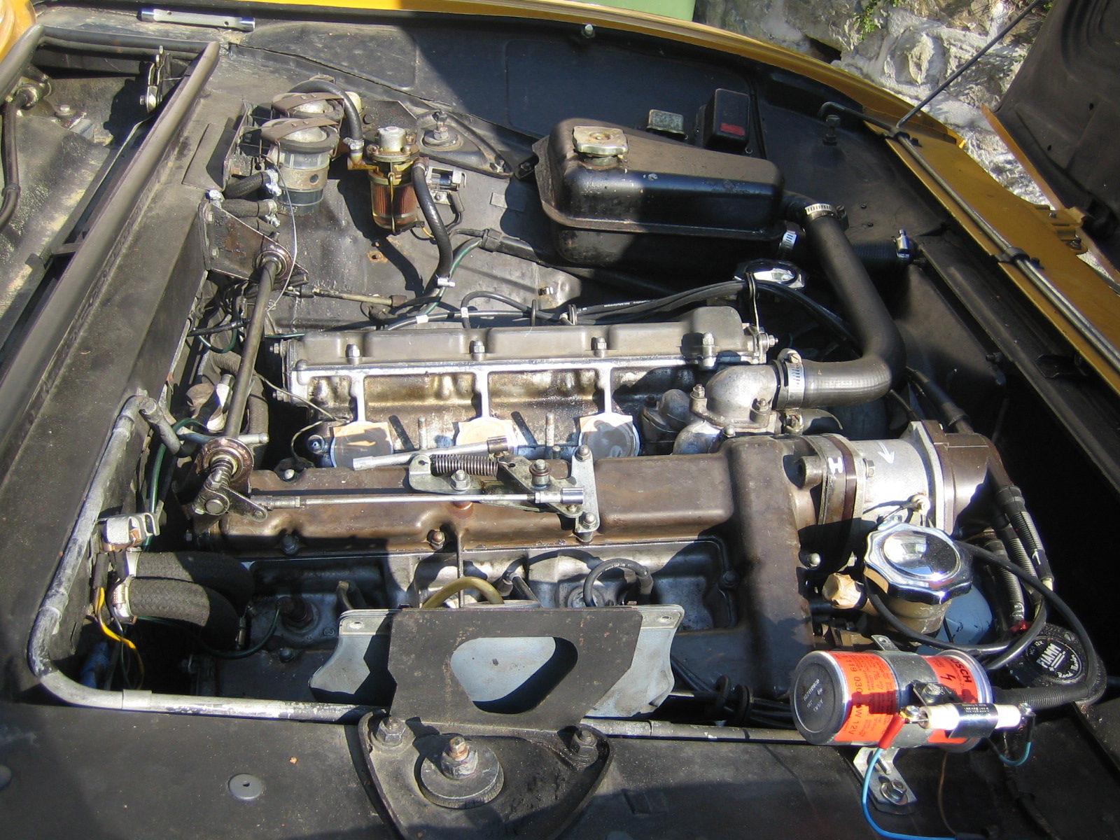

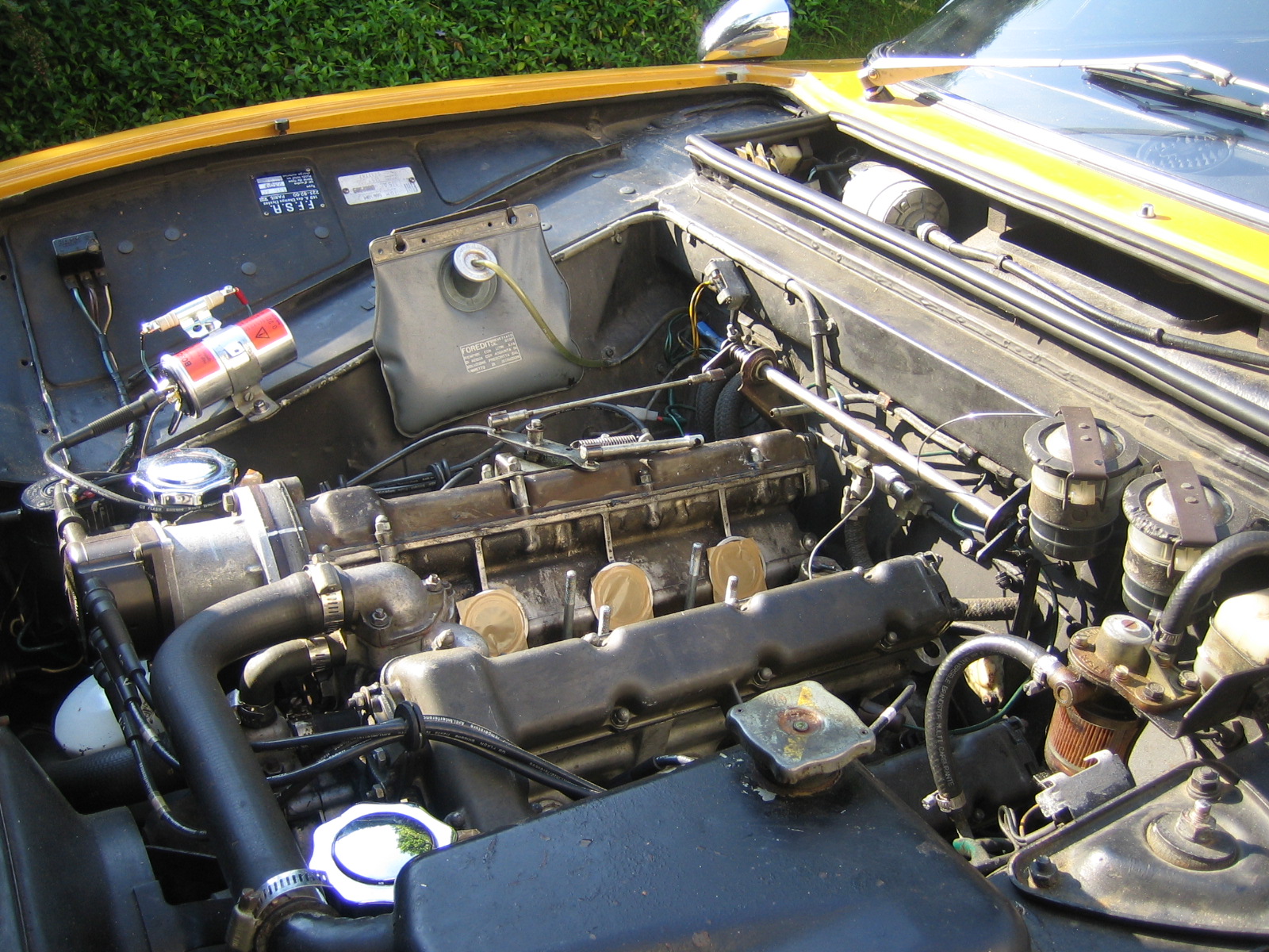

I'm also quite sure the valve covers were originally gray'ish (at least on 2000)
My car has original 58.000km and is as far as I could figure out so far untouched, I think I was the first one to lift the valve covers because the nuts looked untouched, it had all the original washers (and valves clearance was way out of spec
) all original hose clamps etc.etc.
One thing I'm still wondering about is the white dot on the valve cover, could that be some kind of a 'passed the test mark'? I wouldn't be surprised.
Also the original ignition leads are kind of funny, I saw them on an old picture from a test in a 60's magazine somewhere as well. I think on original 2000's with the early distributorcap the ignition leads were like this. But again this could be speculation and not a proven fact.

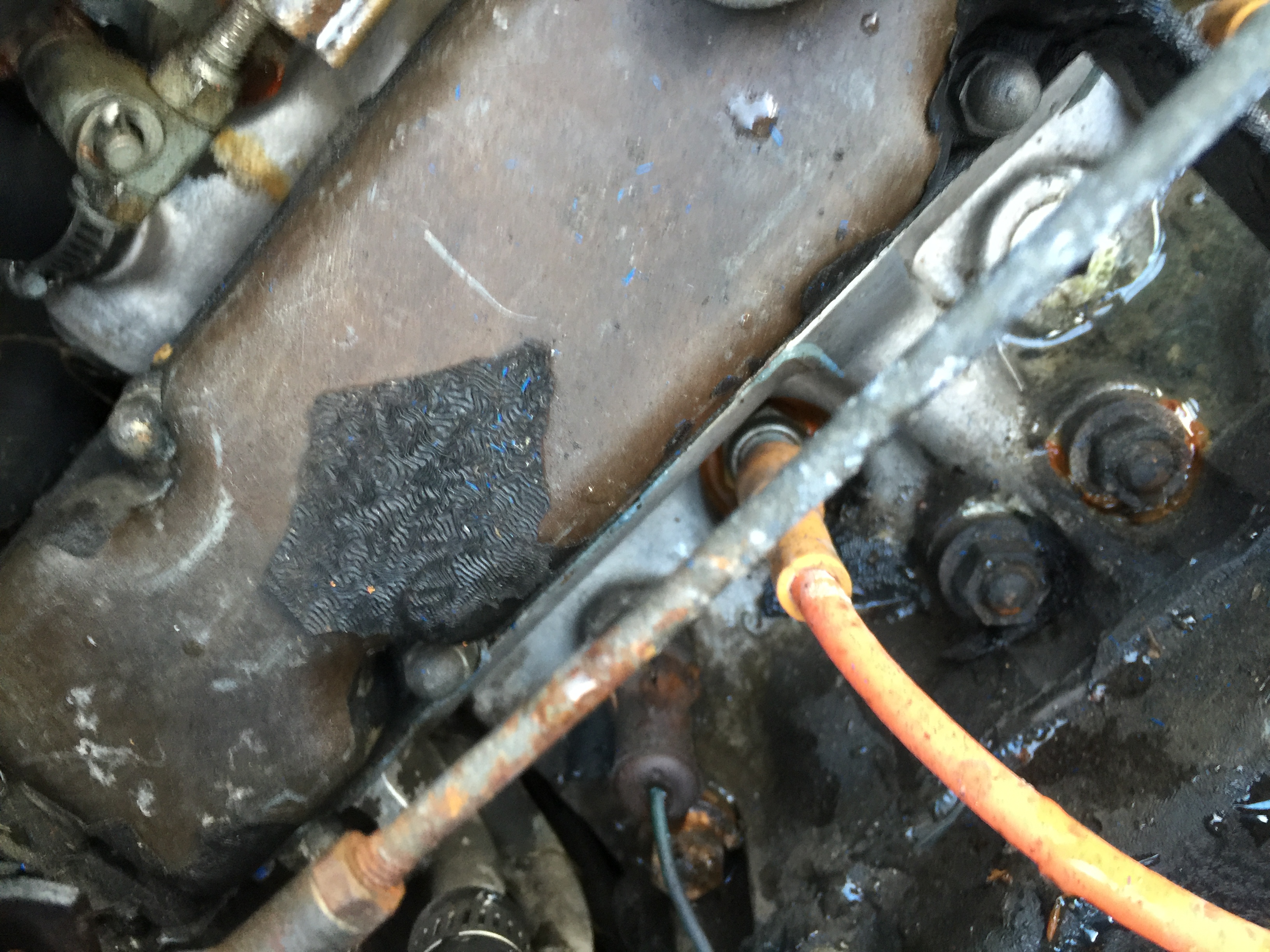

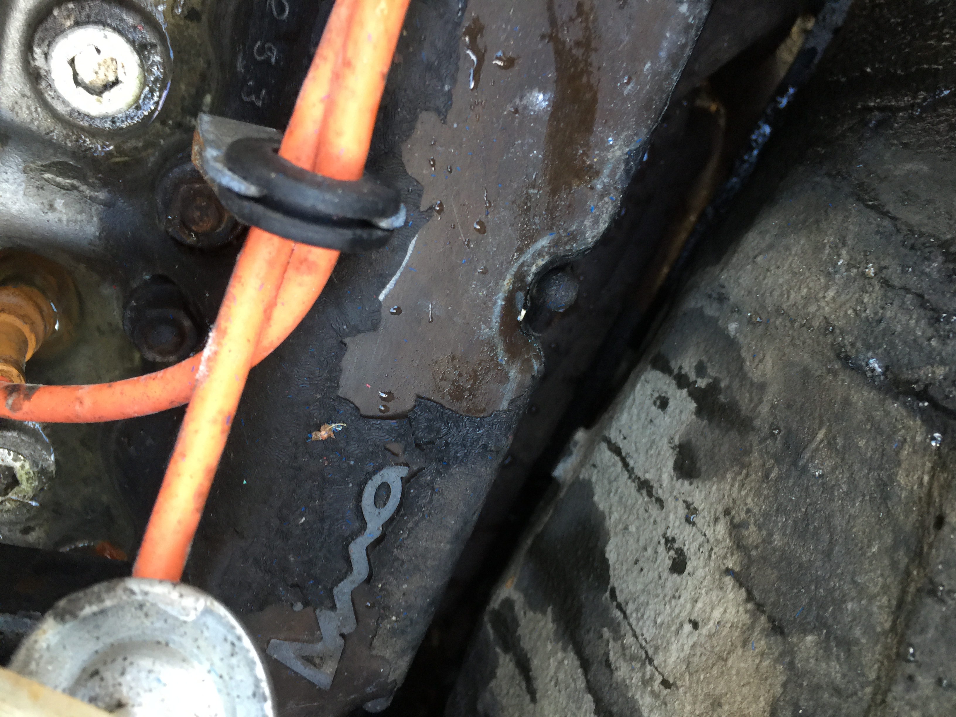

Hi, these picture show the valve covers of my '68 2000 Coupe.
It's the original passivation which has turned dark braun.
Alain.
Alain.

As promised, please see the valve covers on my 2.0 l. It was identical on my Fathers Dino. You can also see the brownish colour underneath. You can even see the white magnesium oxyde powder appearing!

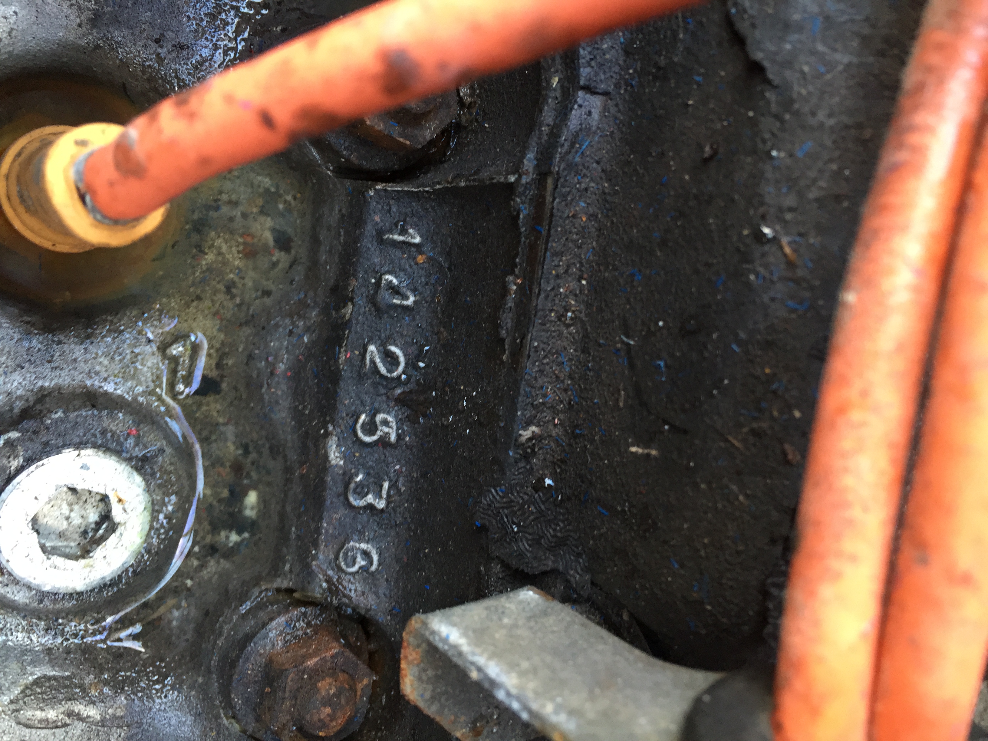

Re: Magnesium valve covers protection and finish (2.0 l engi
Interesting pictures, but the picture labeled "engine number" is actually showing the engine´s ignition firing order: 1-4-2-5-3-6 !
Your engine´s serial number (135 B. 000 xxxx) is found at the right front area of the engine block, below the distributor, close to
the oil filter.
Re the valve cover finish, my experience from different Fiat Dinos is, the magnesium covers were made in the grey-ish finish as
they - probably because of the engine heat - tend to become very oxidized and ugly, if used in " bare metal". The aluminium
covers seem to have been used without any treatment, at all.
the oil filter.
