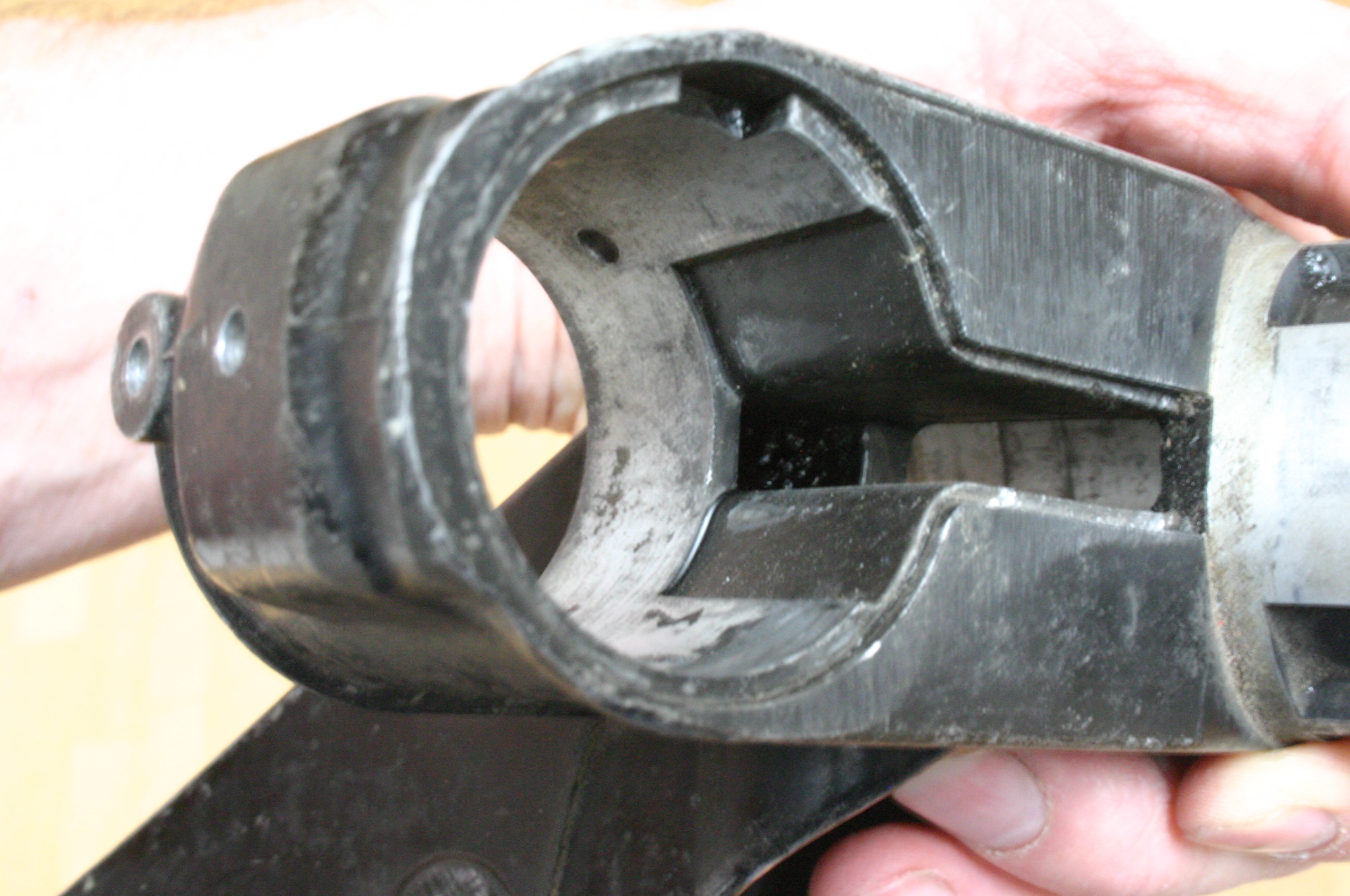

Thanks for the reply Georg! I can feel the key is in the right position and push down the pin. Still it won’t come out, it will move a tiny bit. This makes me believe I have taken out all of the screws, but I think it somehow catches on the steeringwheel lock mechanism. I’ll try again later this week with an extra pair of hands.

I Think you are in the right Way. Play a bit around with the Key, the Lock and the pushdown of the mechanism and it will come put towards you!

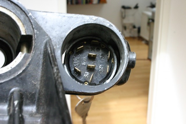

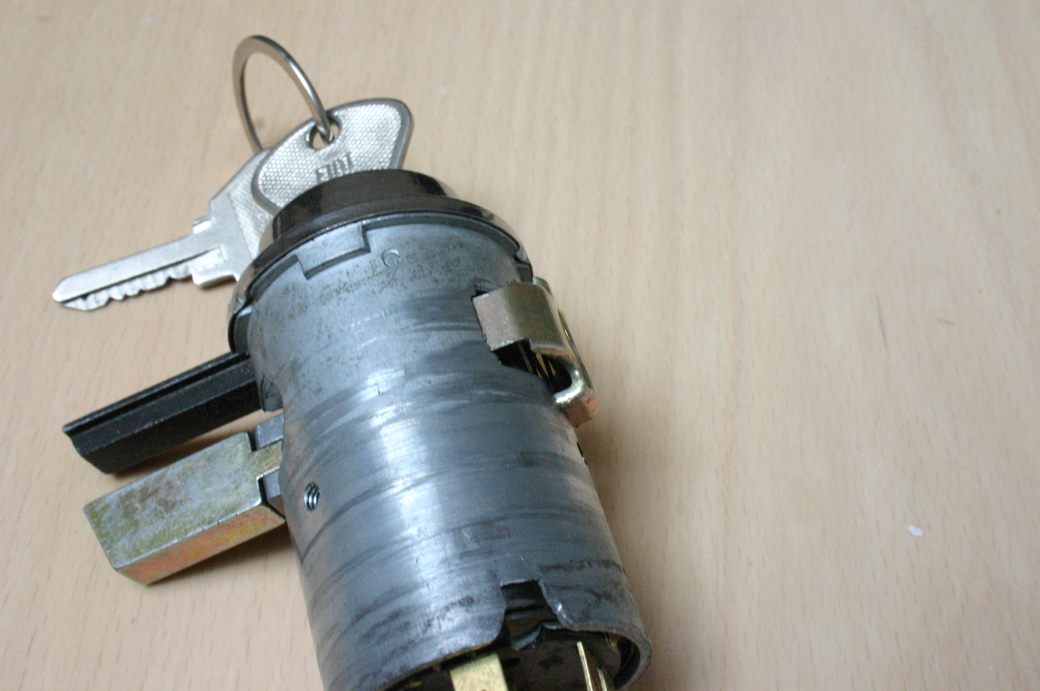

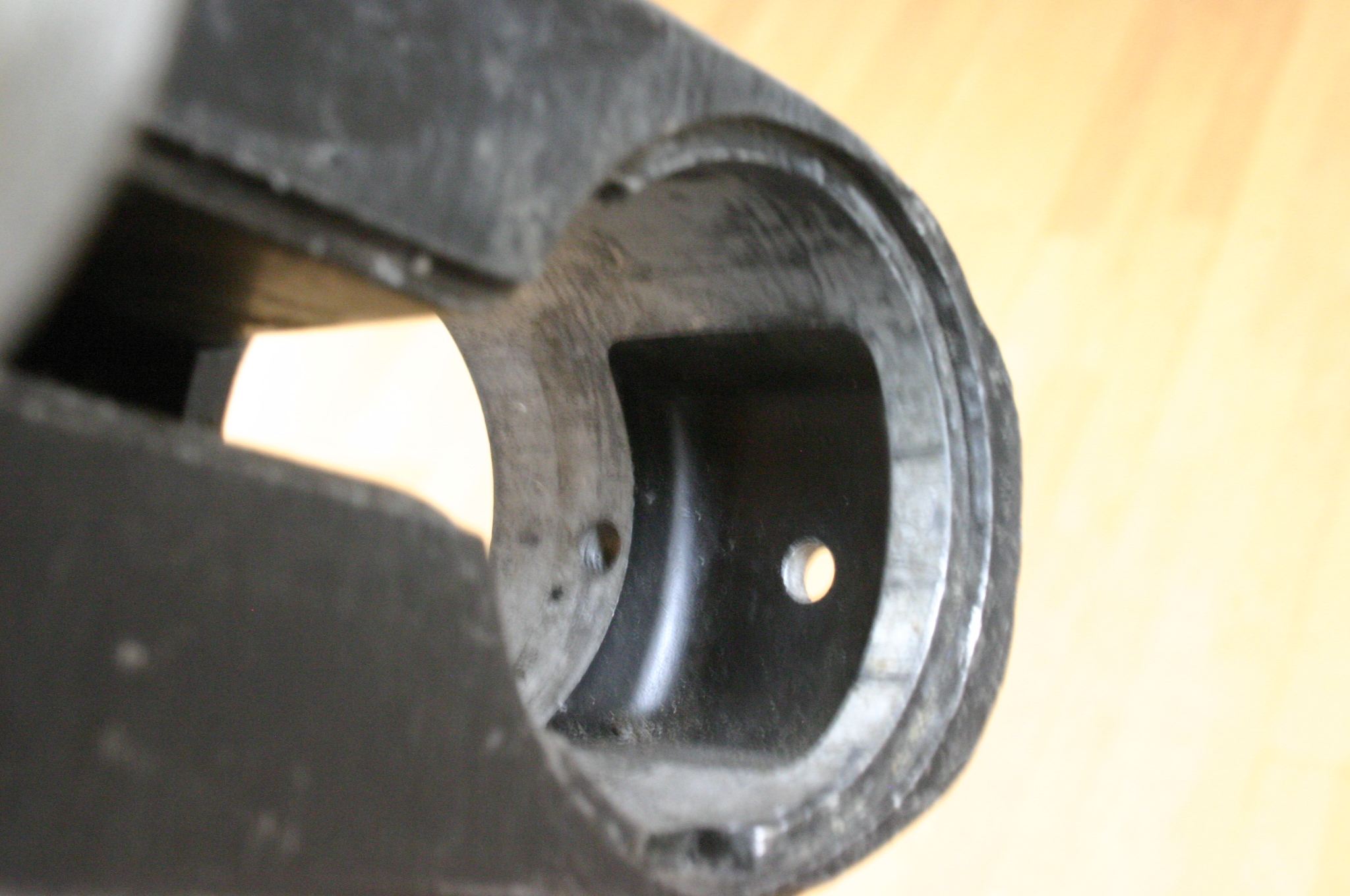

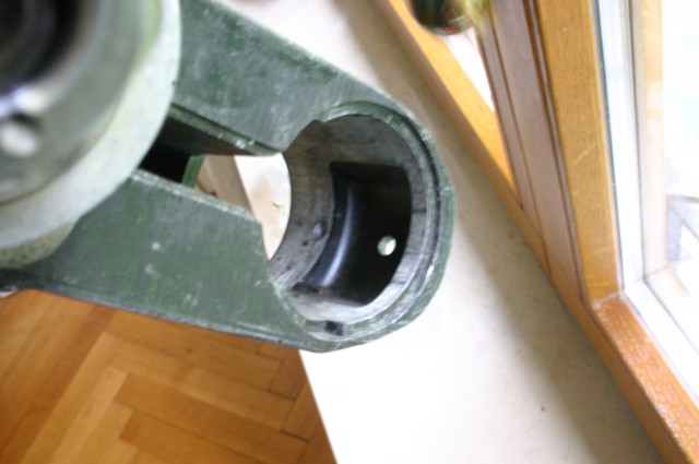

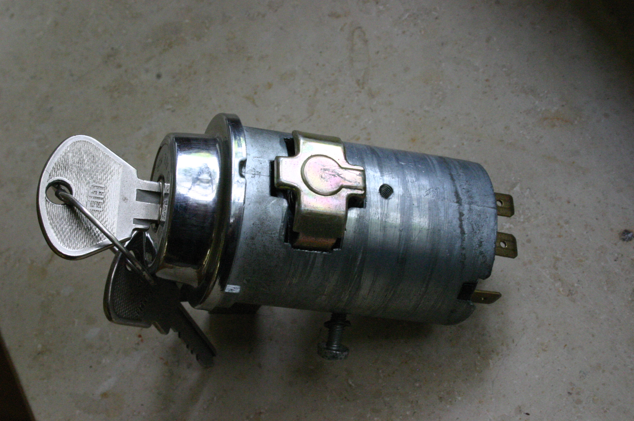

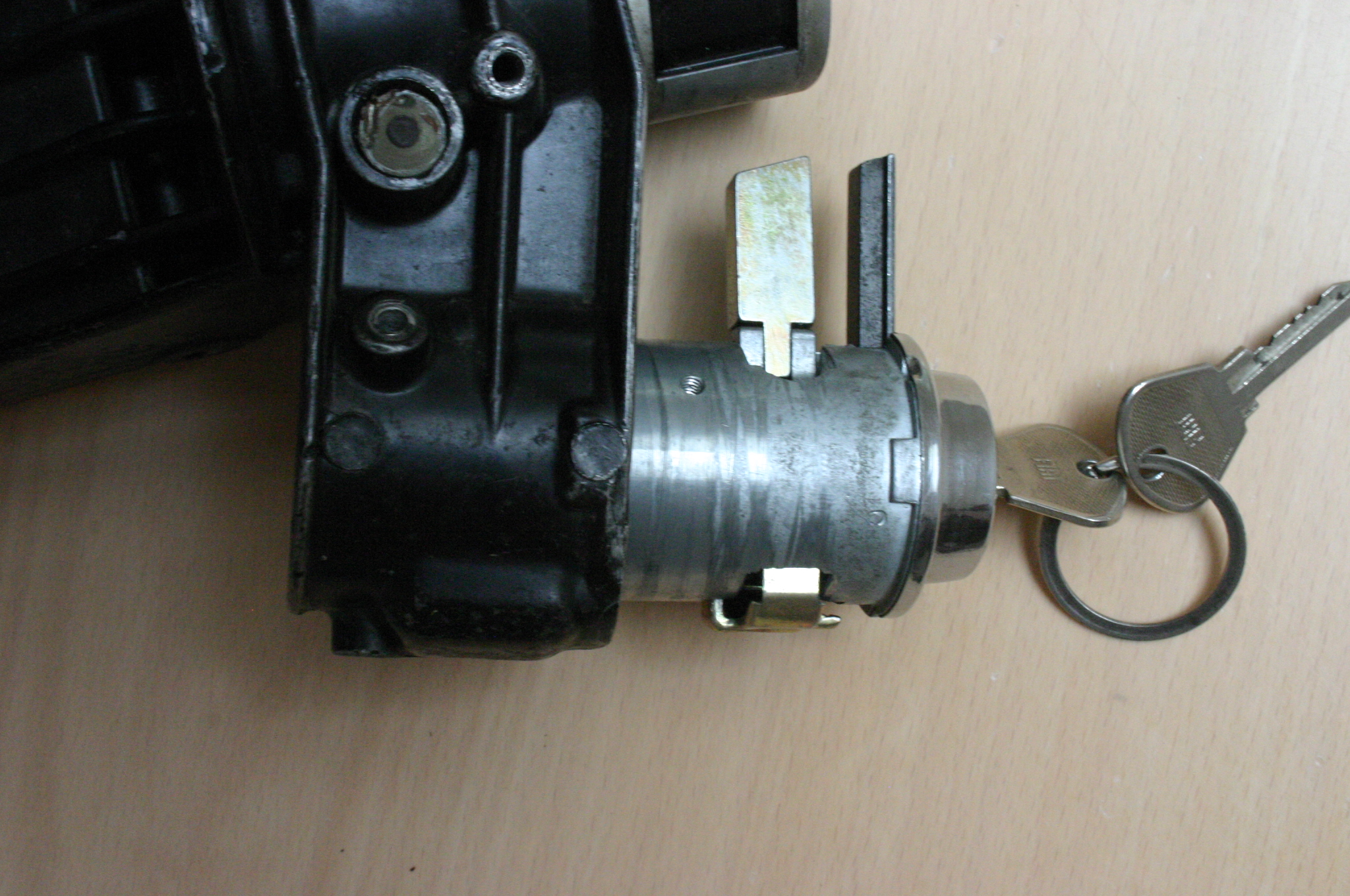

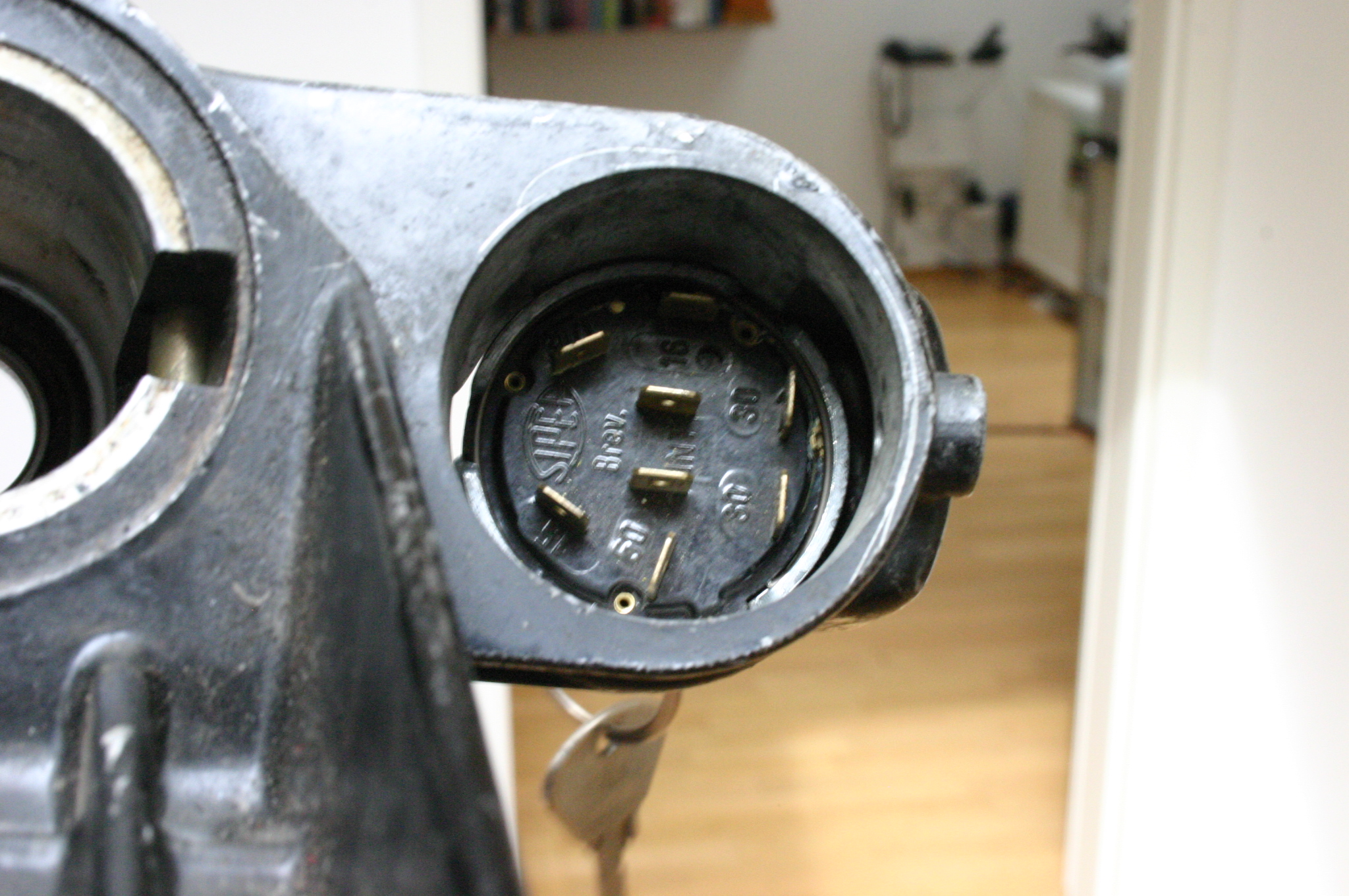

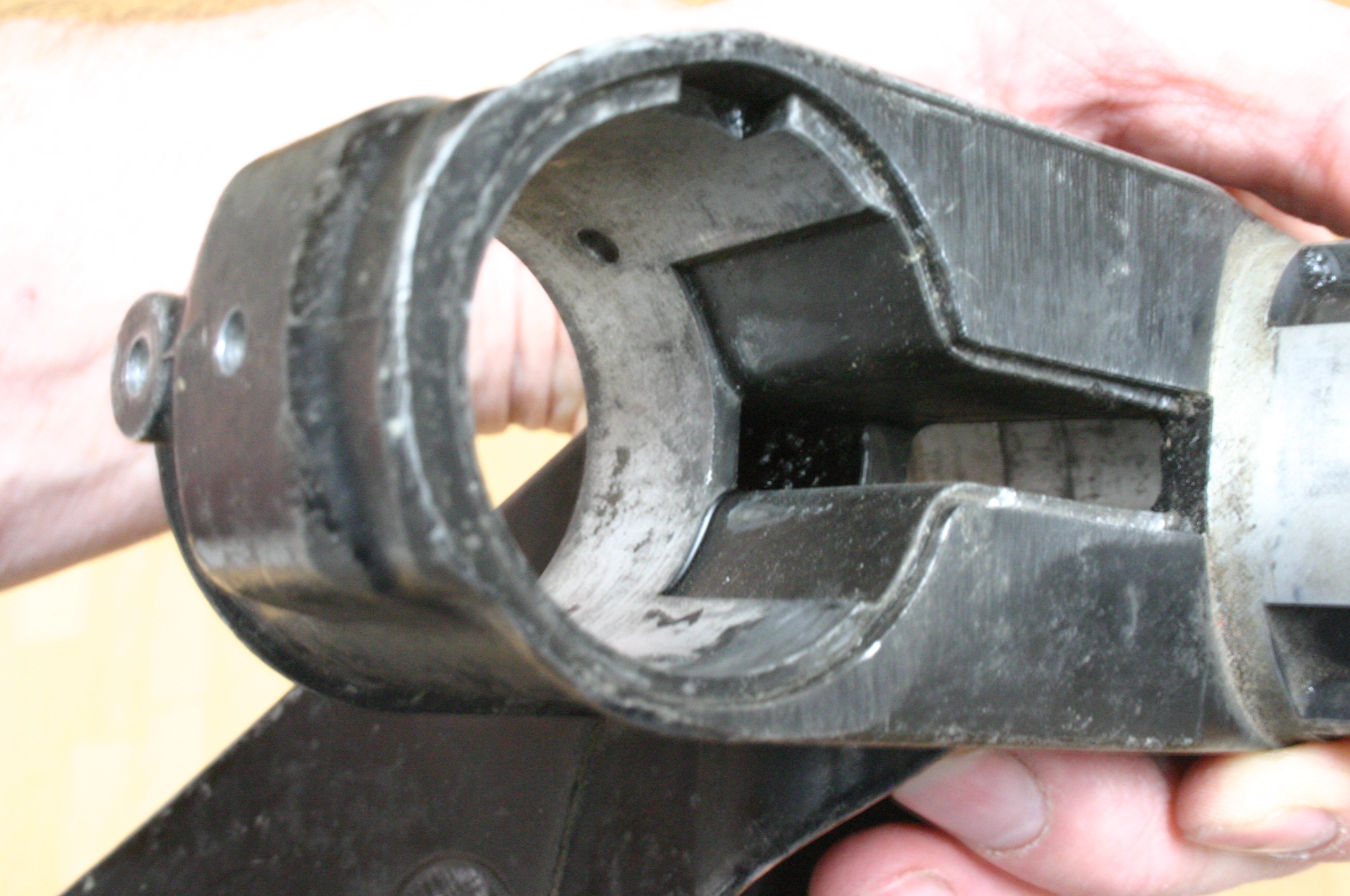

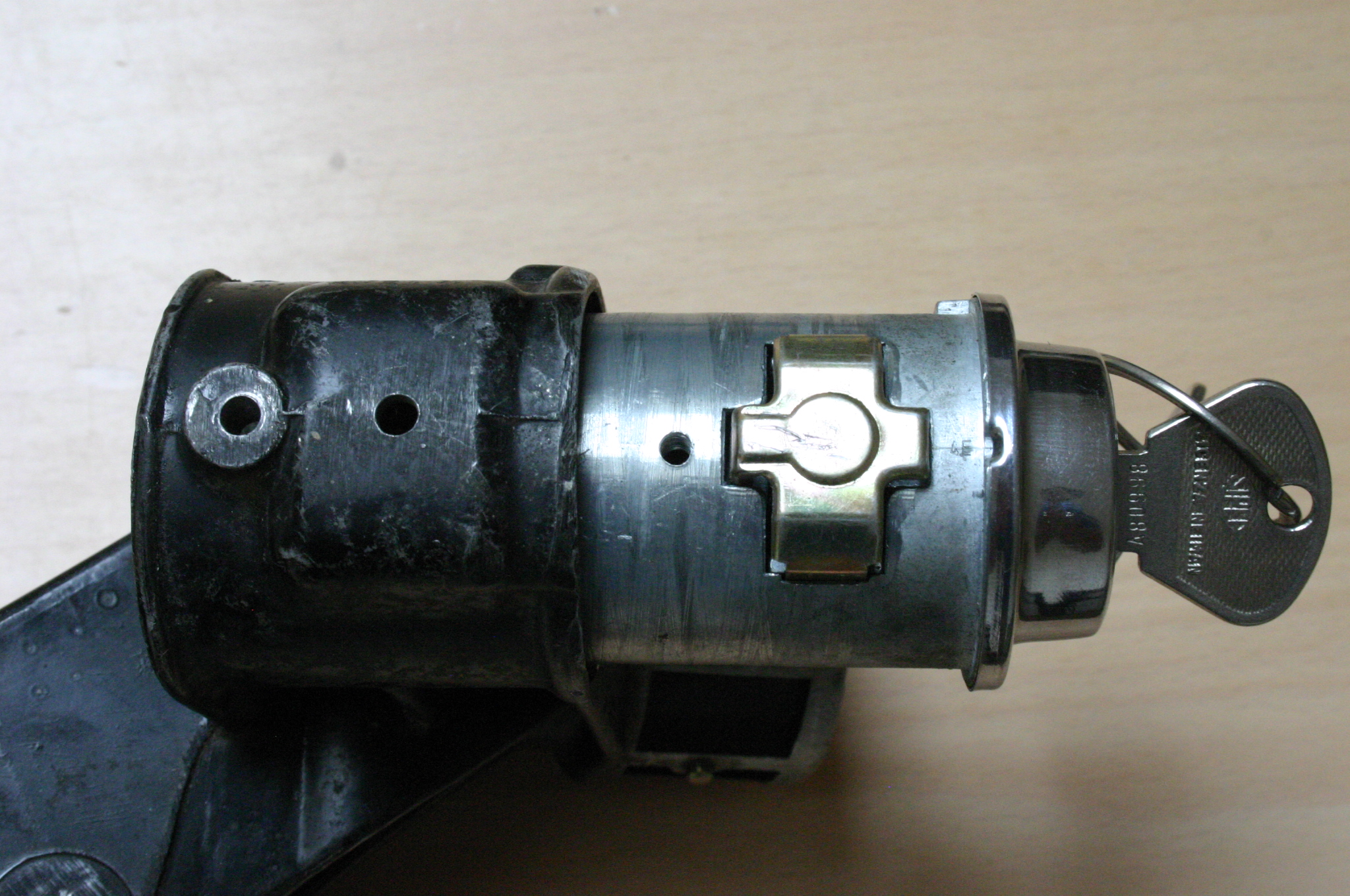

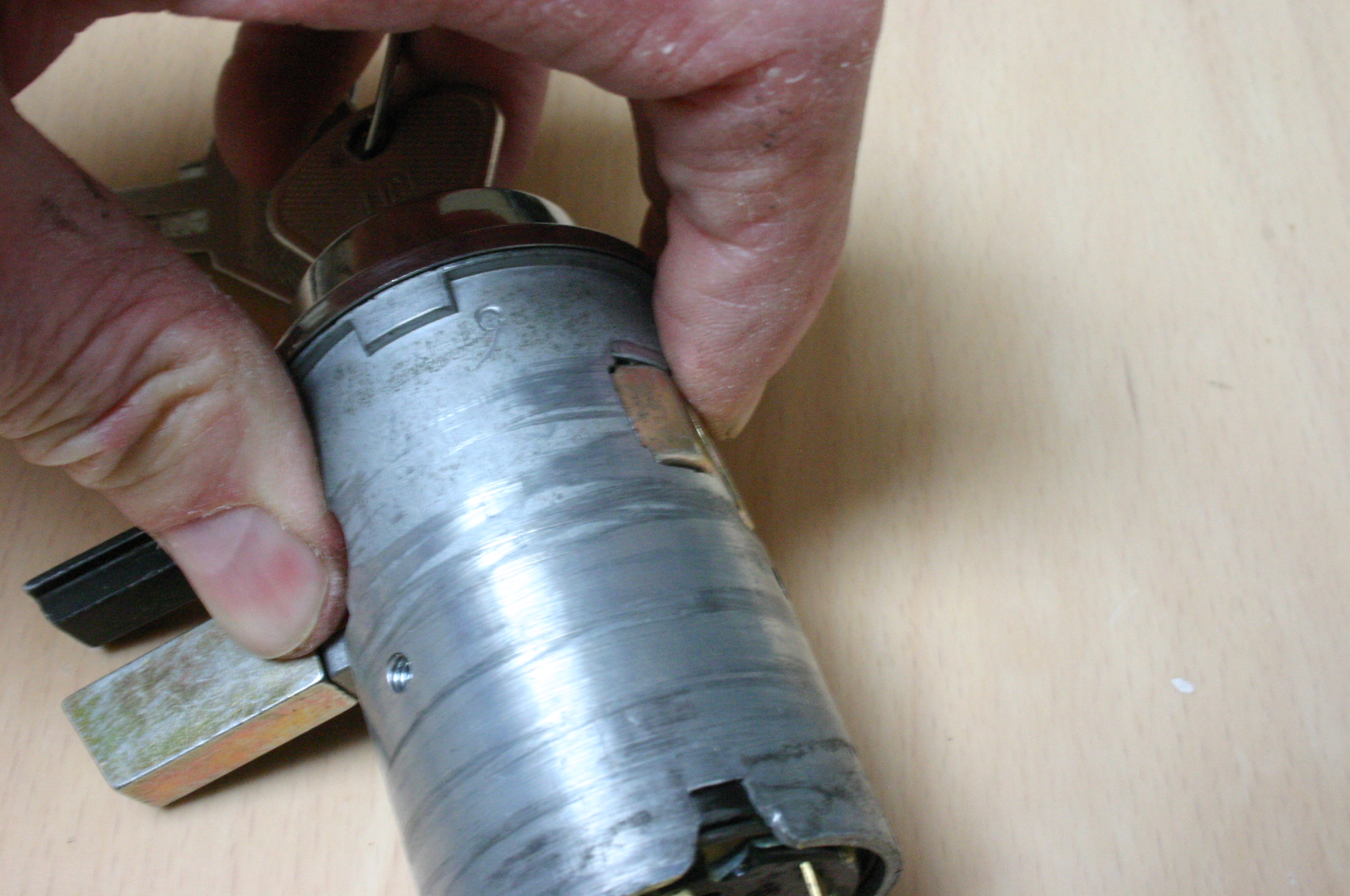

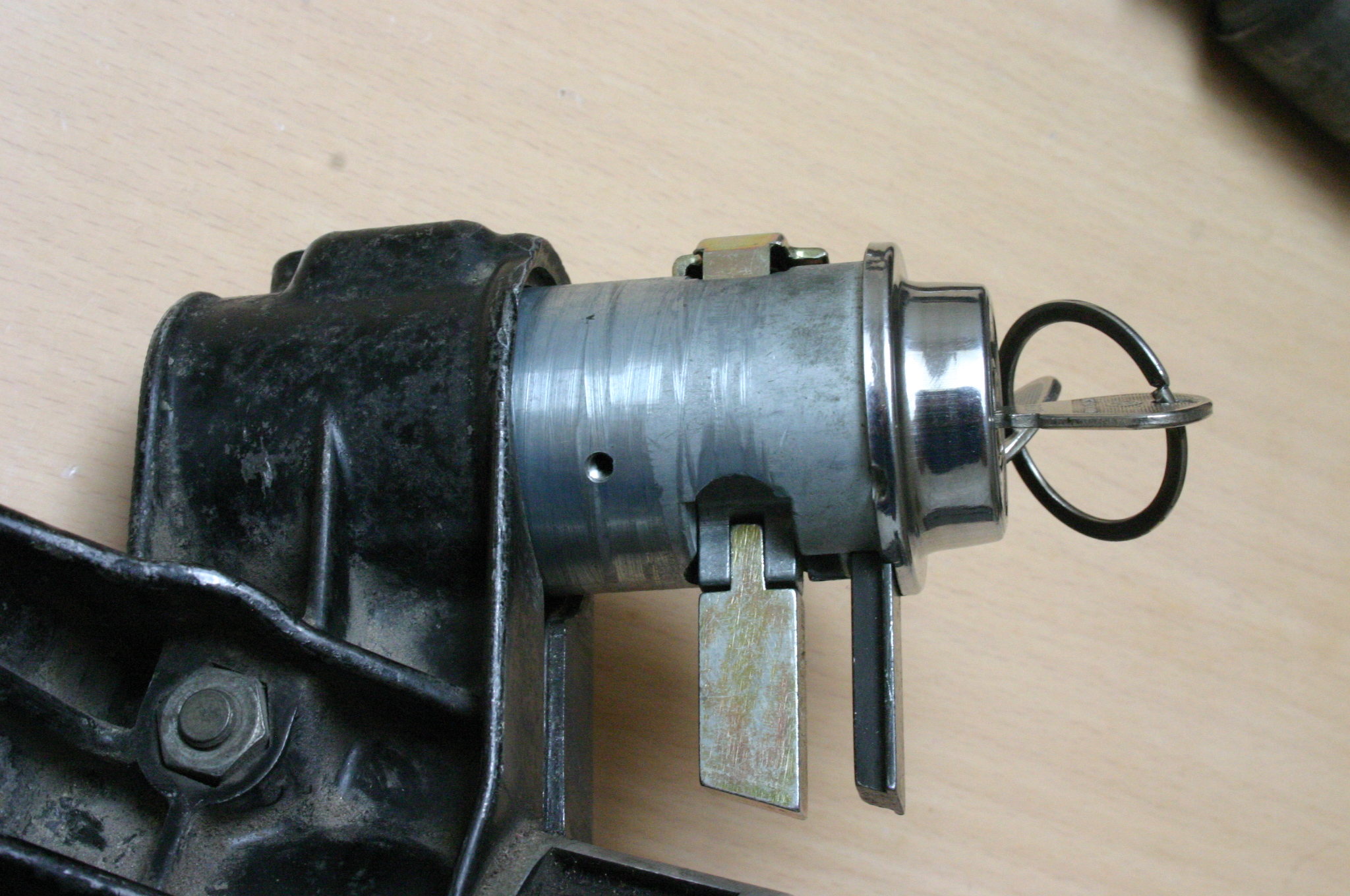

Perhaps these photos can help.

Thanks for the photos Georg and for the advice Thomas. I’ll try with an extra pair of hands and report back. It really feels like you need at least three for this job! :lol:

Georg, might I ask for a picture of the other side of the ignition switch?

My lock sits very, very, very tight in the steering column housing and it needs al LOT of effort to press it in and tear it out again.
Perhaps you grease the lock cylinder by pouring in WD40 or equivalent between lock cylinder and housing and then you gently press carefully with kind of a metal tube from the backside. Be careful not to bend any of the electrical pins.
You can only unlock t blocking when the key is in line the GAR sign on the front of the lock.

Your pictures show I indeed got every screw and the key is definitely in the right position. I’ll try some penetrating oil and see if I got some tube or take a socket to apply pressure from the back.

I realised the crew that I took out on the bottom was looking a bit short, crawled underneath the steering column. Low and behold, there was another screw in there...
