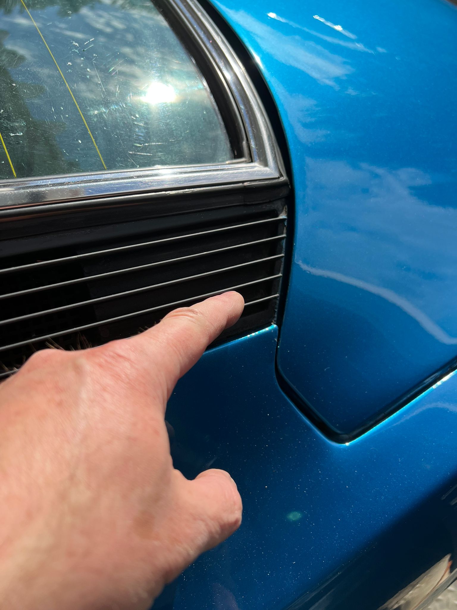

Hi Andrew,
I just tried about 15 times to get a good picture of this ground stud, total failure, the ones I have would only confuse you.
It's sort of "on top of" the hinge bracket - run your finger around the bend of the hinge part that's on the lid, then jump across to the body's bracket - and the stud is right on top of that - completely impossible to get to (or undo) because the bodywork folds around it.  In fact the only way in I could see would be through the left side wing vent - here's a picture of where the stud is - right inside behind there.
Different vents on your 2000 car I think but you get the idea.
