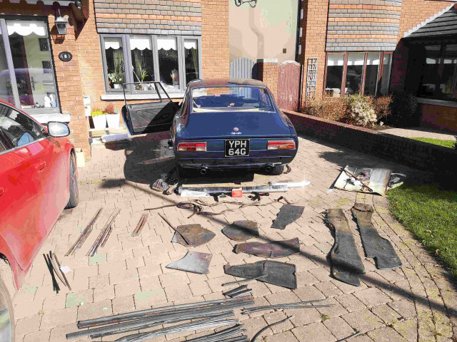

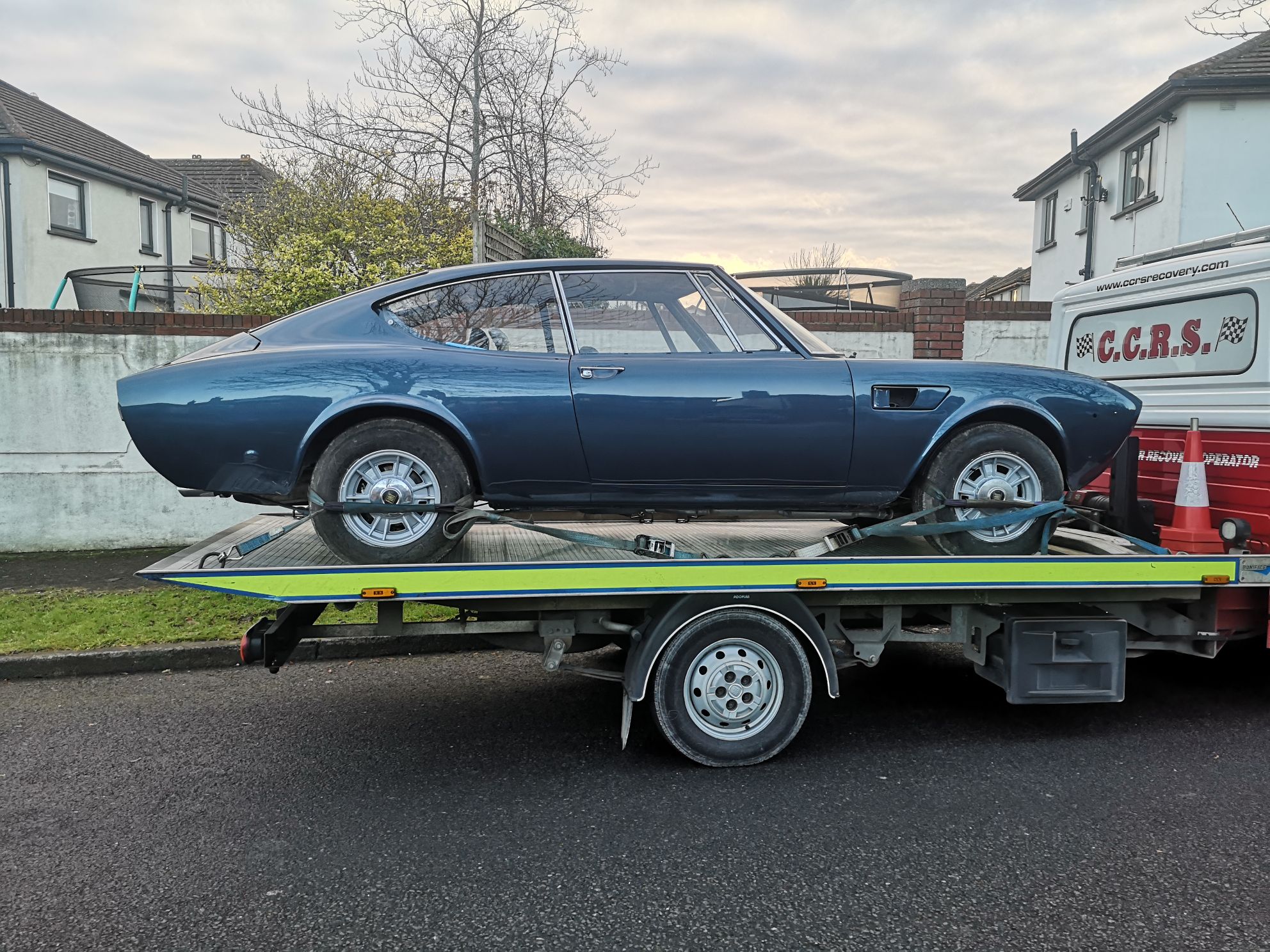

This is my first post on these pages and I shall be documenting my story of my Dino which I have just received.  Hopefully I'll be giving some information that will help other owners and along the way be able to call on the help of others too.   This is her arriving at home on the 30th December.

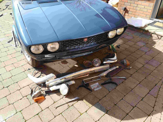

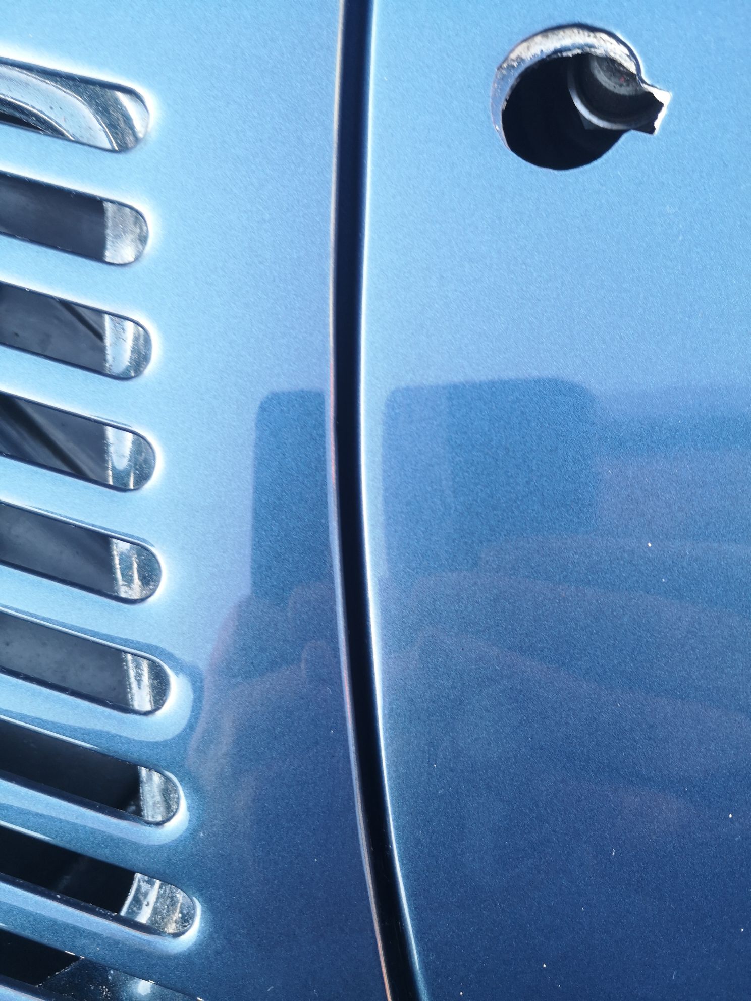

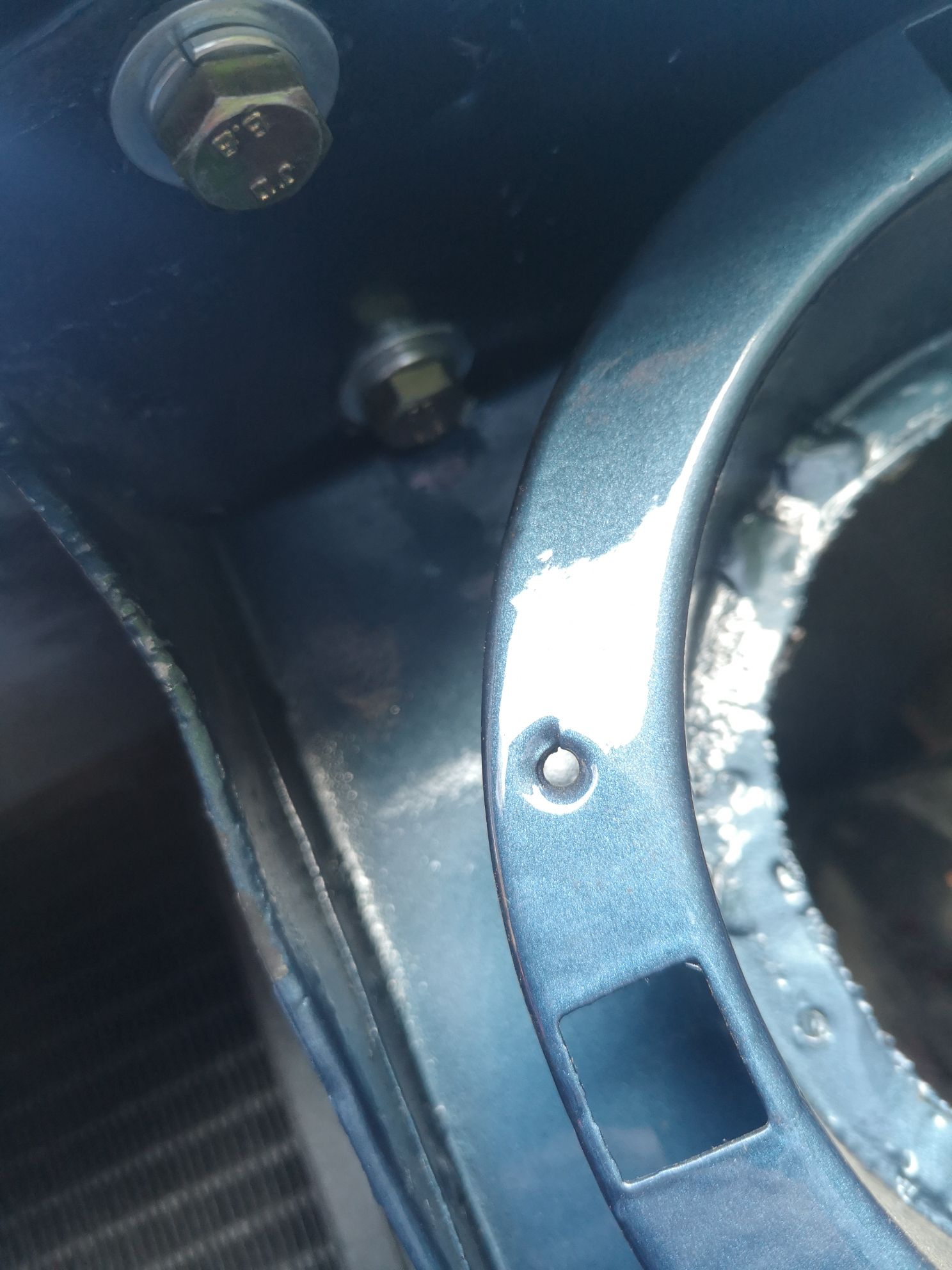

Bonnet Alignment:  First job for me today was to align the bonnet a bit better as it was a little close to the scuttle panel for me, and my perfectionism.  I wanted about an extra 1.5mm gap on left corner.
Firstly the bolts are inserted from underneath behind the grill so grill needs to come off. Having removed the three clamp bolts at the top surface of the grill I then discovered the light surrounds need to be removed. Three self tappers, one inside wing near the top and two close to the inner light housing allowed these to be pulled out. Right side was very tight causing me trouble.
The removal of the grill by pulling upwards then allowed me access the two bolts.
I then measured the gap (with bonnet open) from the bonnet to the front panel at 18.3mm with a calipers. Loosened the bolts and with a few taps with the palm of my hand increased the gap to 19.7 (close enough). Tightened the bolts and checked the gap on the closed bonnet. Looks good. Next job will be to get two lights in so I can drive to my nearest NCT centre (national car test) who are contracted by Revenue to collect our Vehicle Registration Tax. Lots of paperwork too

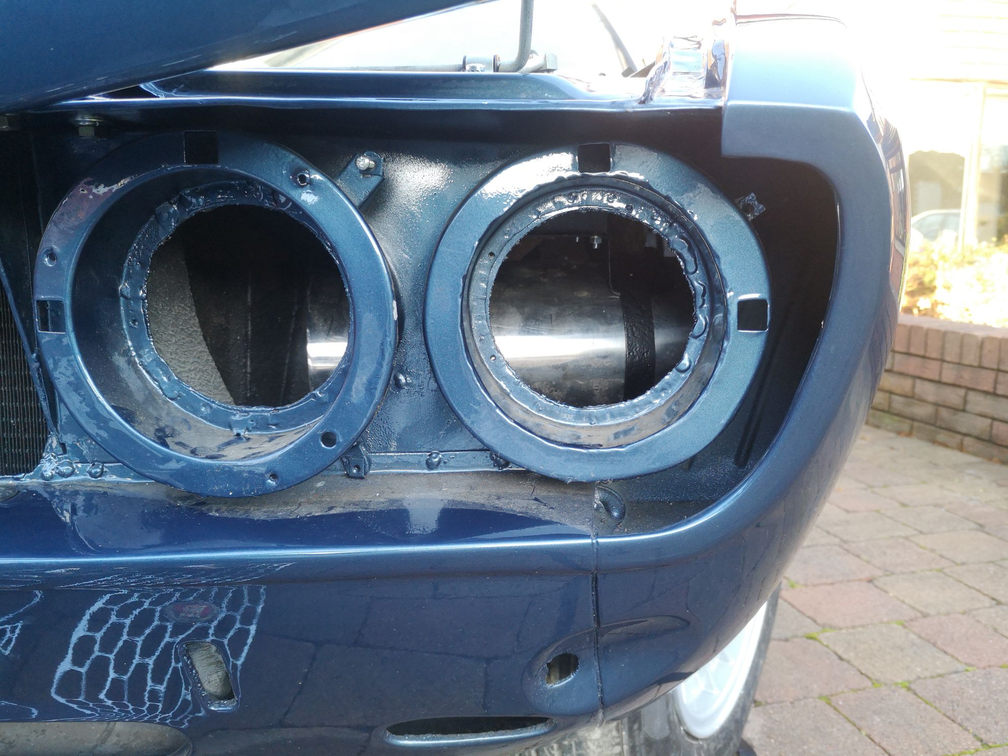

Thank you Scalino,   It's a good question,  for an expert maybe not a lot to do.  But for an amateur who has never put together a Dino before it's all a learning curve.   Inside needs a full refurb,  lot of parts are there but all need reupholstery and most likely a lot of little bits.
As an example today I removed the rust from the headlight bowls and currently am treating with rust chemicals prior to prime and repaint. I will need new lights as there's reflector corrosion but the big problem is knowing which are heads and which are dips, are the lights rhd or lhd? Which parts go where as every light is a different design. I need to figure out how to attach the headlights as that outer ring has no holes for screws. I also need to figure out why I can't find parking lights. Maybe there were none. You see what I mean?
