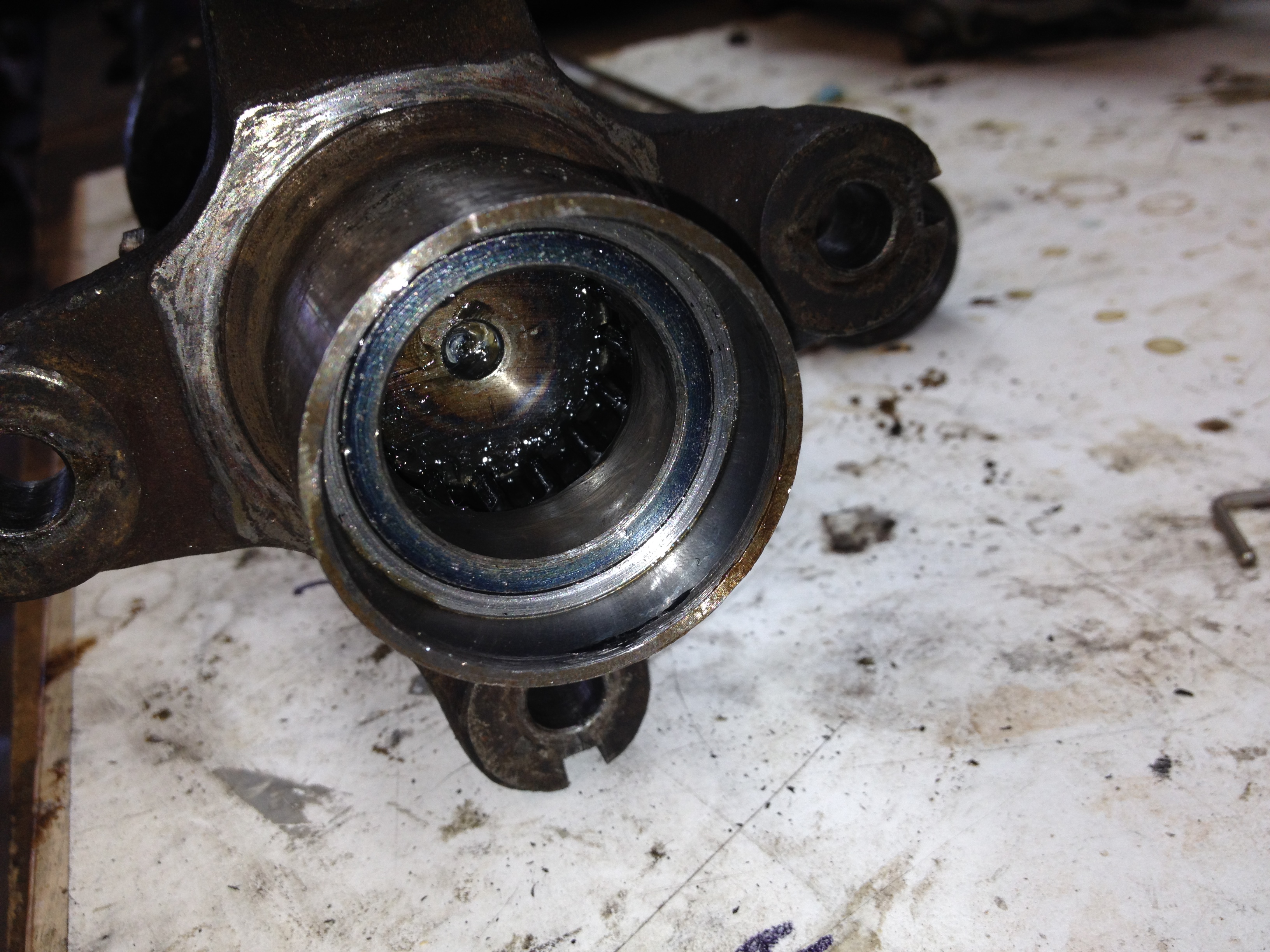

Here is one picture that worries me - on the far back end of the shaft, on the coupler that couples the splines of the shaft to the splines of the differential - there's is this balance weight - does that look right (doesn't to me).
