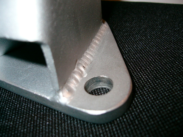

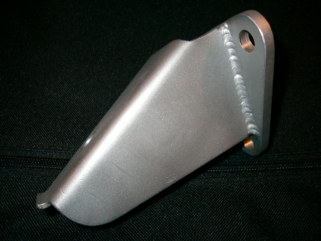

However, take a good look at your motor mount brackets. They are made out of fabricated sheet metal that is folded and spot welded. They are the same part on both the 2.0 and 2.4 liter cars, but I have found that on the 2.4 they can fatigue and start to crack. Maybe because the 2.4 engine is heavier? At any rate, I had mine cut and refabricated which kept the engine from dropping (slightly) and putting the driveshaft out of alignment. Hope this helps.

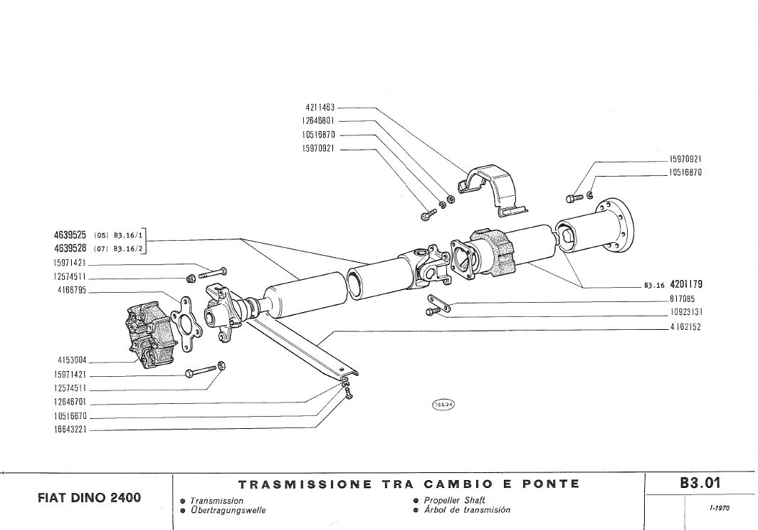

I'm trying to visualize the part that you mean by "the short driveshaft that is between the rubber flex disc and the torque tube". Looking at the parts-book drawing here: I think you mean the very short section behind the flex-disc, the narrow section right behind the flex-disc flange - before it widens out to the main driveshaft tube - interesting if so! That's a very short section therefore not one I would imagine that could be out of balance - but of course it could just be bent. I would hope the balancer-guy would find such a problem, but perhaps, as you say, I should take it somewhere else.

OK, trying again! Here are a couple of pictures of the motor mount brackets. The triangular portion has been refabricated and welded to the original sheet metal portion.

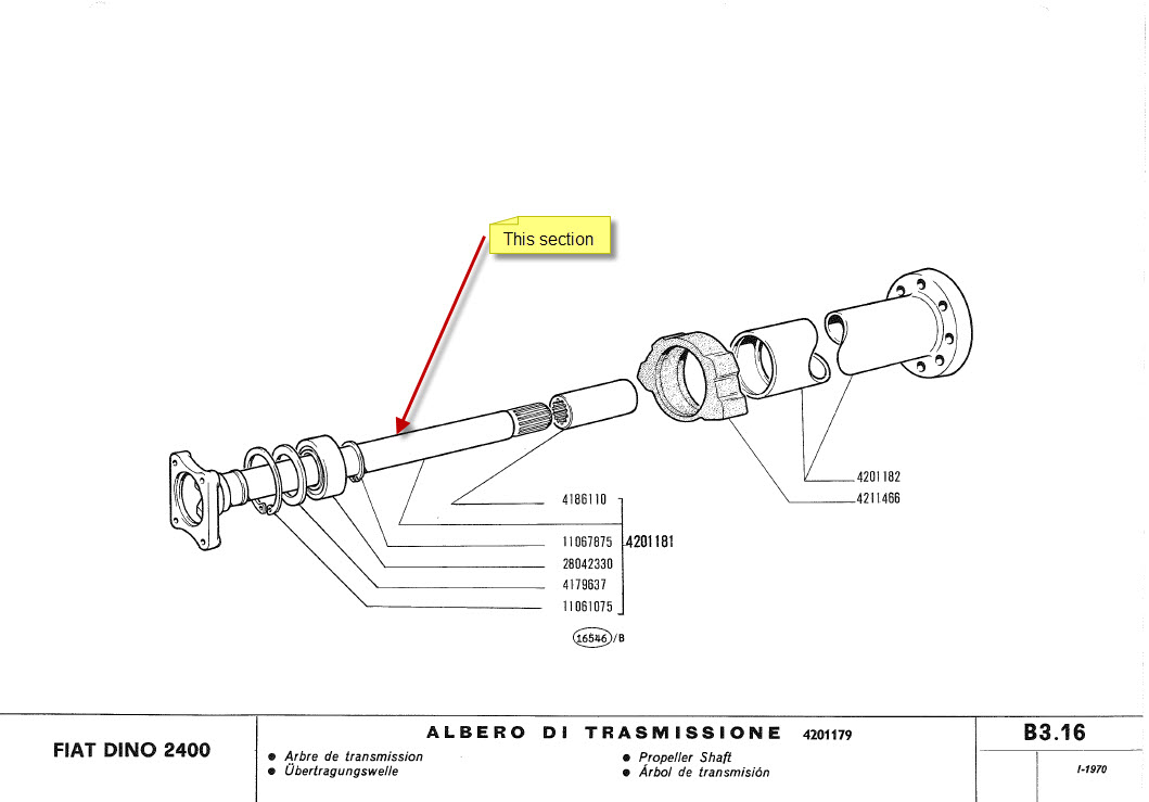

Thanks for the pictures and for your article. The fabricator did a nice job on the motor mount brackets!. I had mine out of the car to change the rubber mounts just this month. They were rusty but I'm pretty sure they weren't cracked. I blasted them and painted them and put them back on. The Motor isn't dropped onto the cross-member as far as I can tell, but I'll get it back up into the air to check that again.
I'm most interested in your driveshaft balancing - can you confirm where on the shaft they actually welded a weight? As you know there are three sections:
- slim section right at the fornt, just behind the flex-disc - which widens out into
- the main section that has most of the length, and ends at the UJ
- the rear section, behind the UJ, hidden inside the torque tube - quite thin (20mm diameter? can't remember)
I've had all that assembly apart - and the section I've arrowed has a very ugly looking weight attached to it - doesn't look 'factory', but might be. Maybe you remember how yours looked when you took it apart? I wish I had photographed mine.
So is that the section that your balacer fixed that improved things? Or somewhere else on the shaft?

The balance weight was on the part number callout 4639525/4639528 in the driveshaft drawing. Hope this helps!
