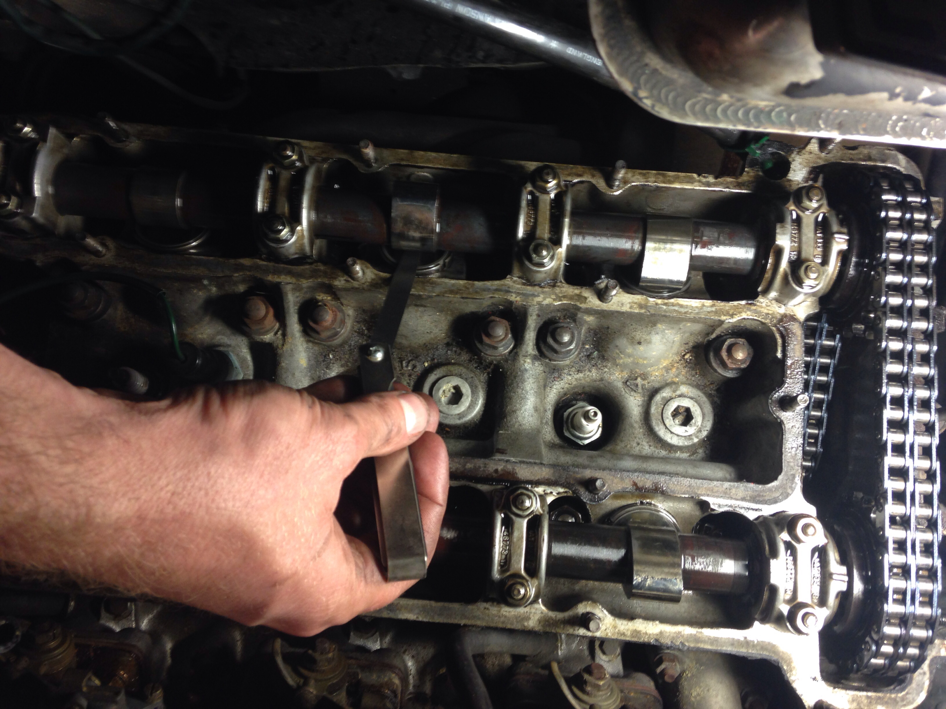

Checking valve clearances

So I checked the chain tension and valve clearances today. The chains were slack. The r/h chain when moved up and down turned the outlet camshaft.
I think I have corrected the tensions. Then I check the valve clearances with the following results..
cyl in out
1 .12 .35
2 .11 .40
3 .11 .27
4 .25 .35
5 .15 .30
6 .15 .40
Cylinder 3 was the lower compression cylinder.
What do you make of this?

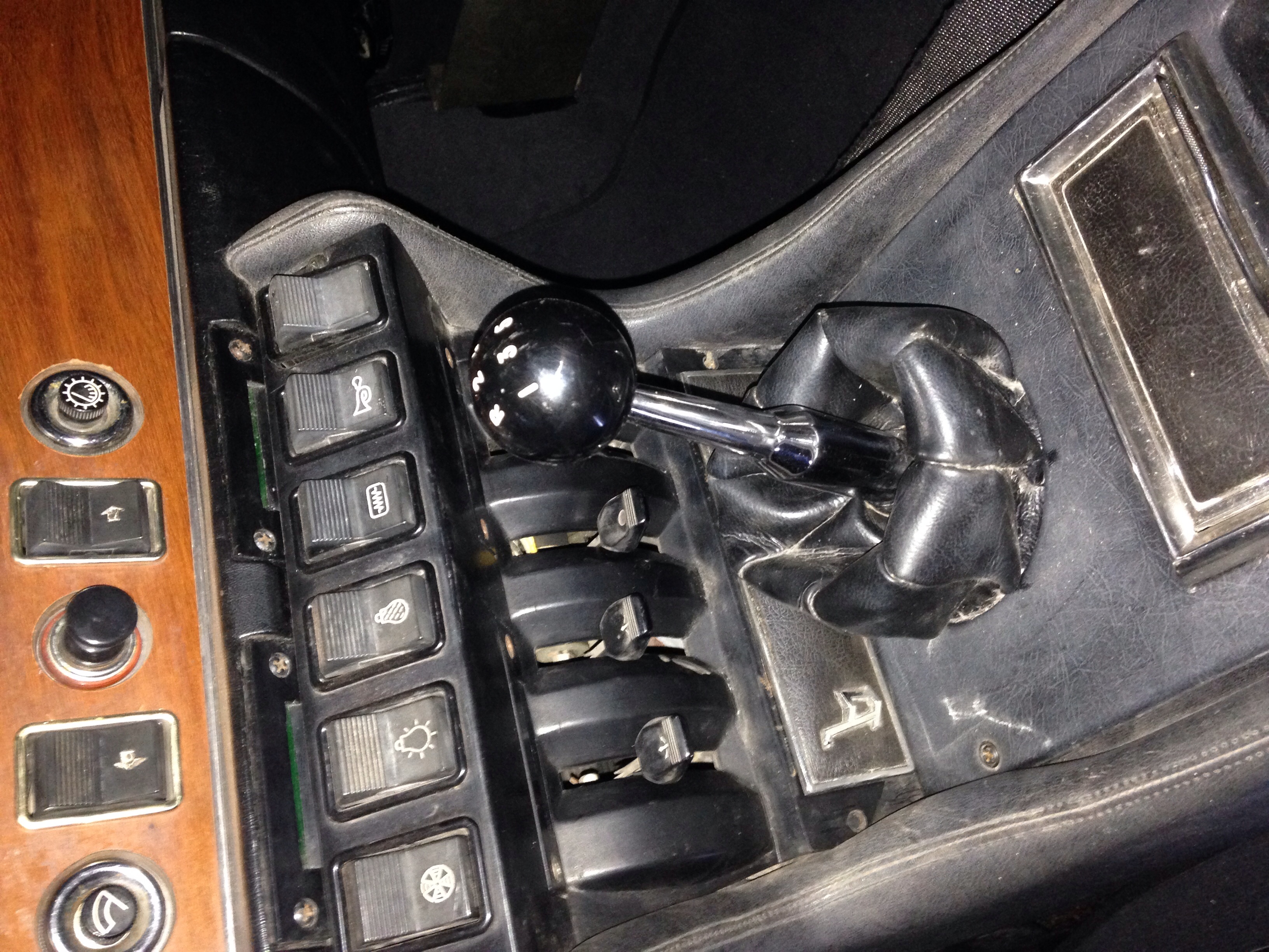

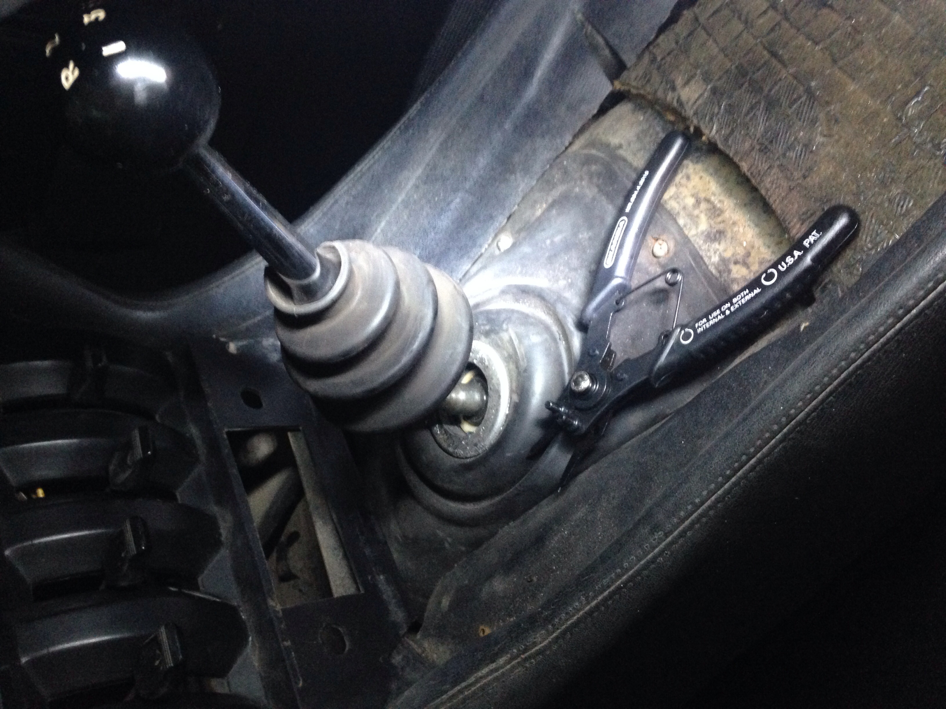

My little story for today is that I put in my gear leaver.
Thanks for sharing.

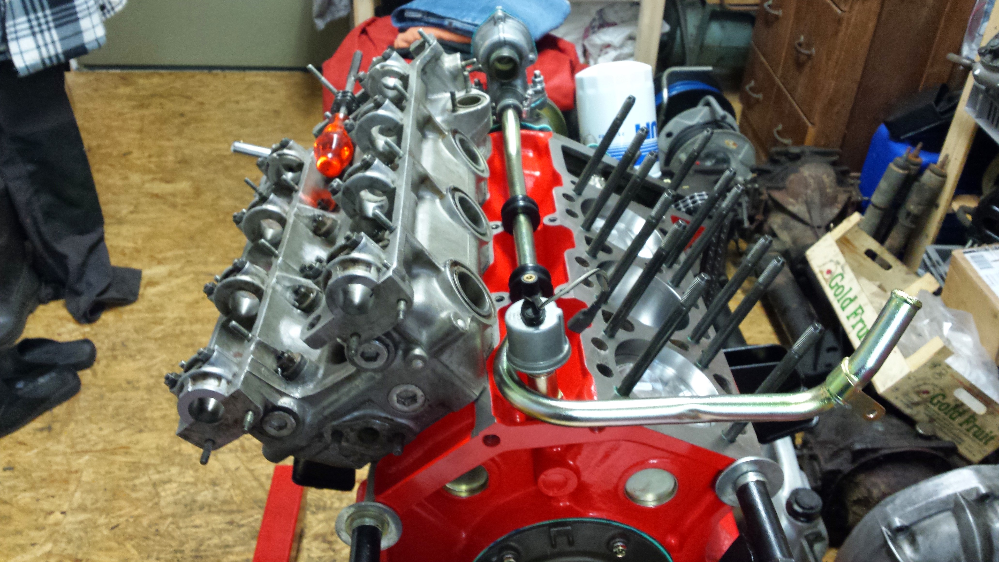

To be honest not today but last weekend I mounted my left cylinderhead as a part of my complete engine rebuild.
This weekend I start to put the right one together - my hands will hurt for shure after grinding in the next 6 valves...
...but hopefully I can drive my Dino again next spring...

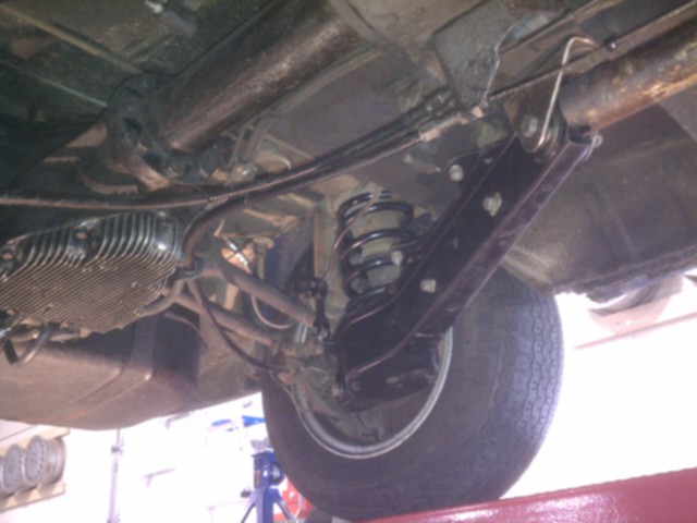

Wrapping up full rebuild of suspension and brake system...rear is done, need to install sway bar. Had to fabricate a couple of mandrels from tool steel for pulling hub bushings. New brake hoses, stainless lined caliper bores, etc. New gear oil + additive (need 2 small bottles!) for diff and trans as well.
Front end is waiting on bushings.
