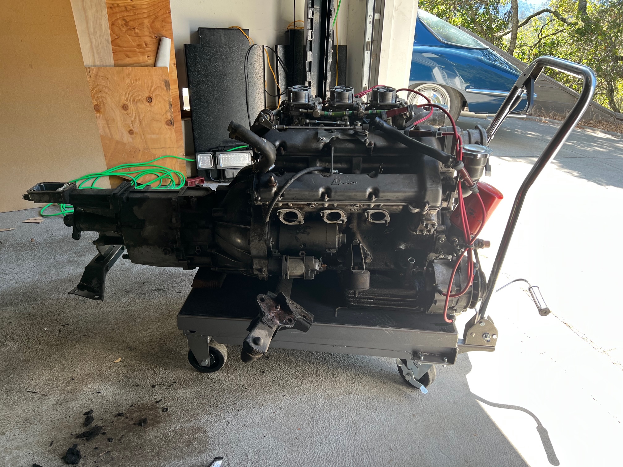

As was recommended by most here - I dropped engine and gearbox down from the car as a single unit. It worked out well with a 4-post lift to raise the car and a hydraulic cart to lower the engine.
I took the exhaust manifolds off first - without really looking to see whether the engine drops with them attached. It's a tricky job with all the manifold nuts hidden by the 'overhang' of the heads. How tricky? I think this video illustrates it.

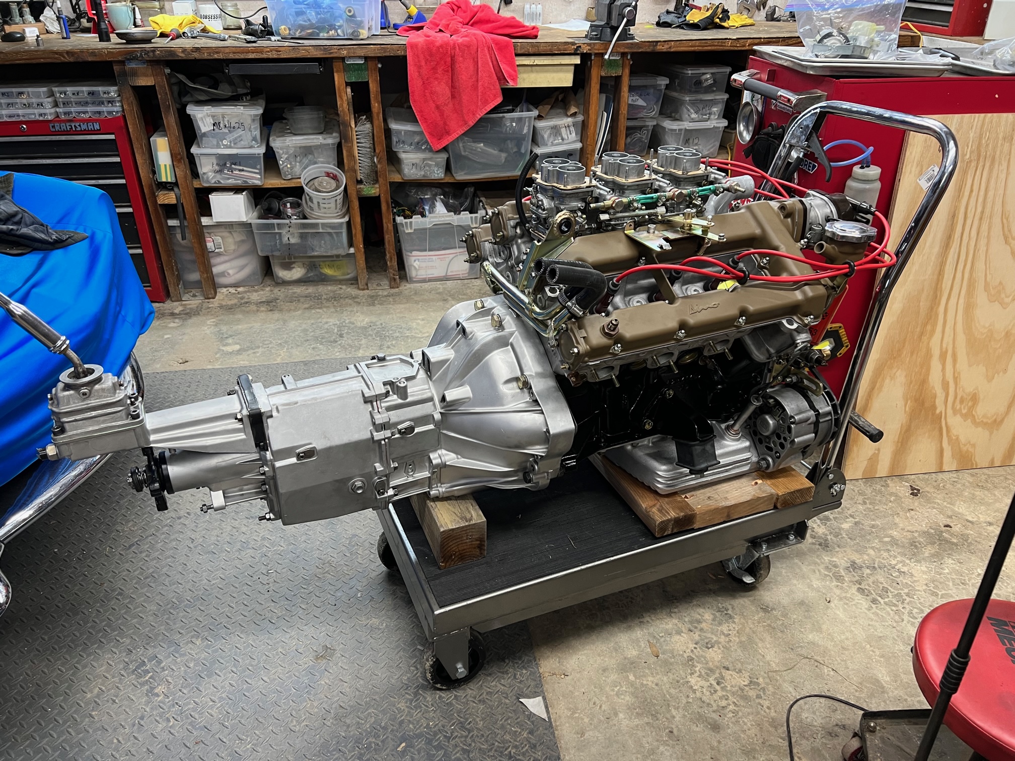

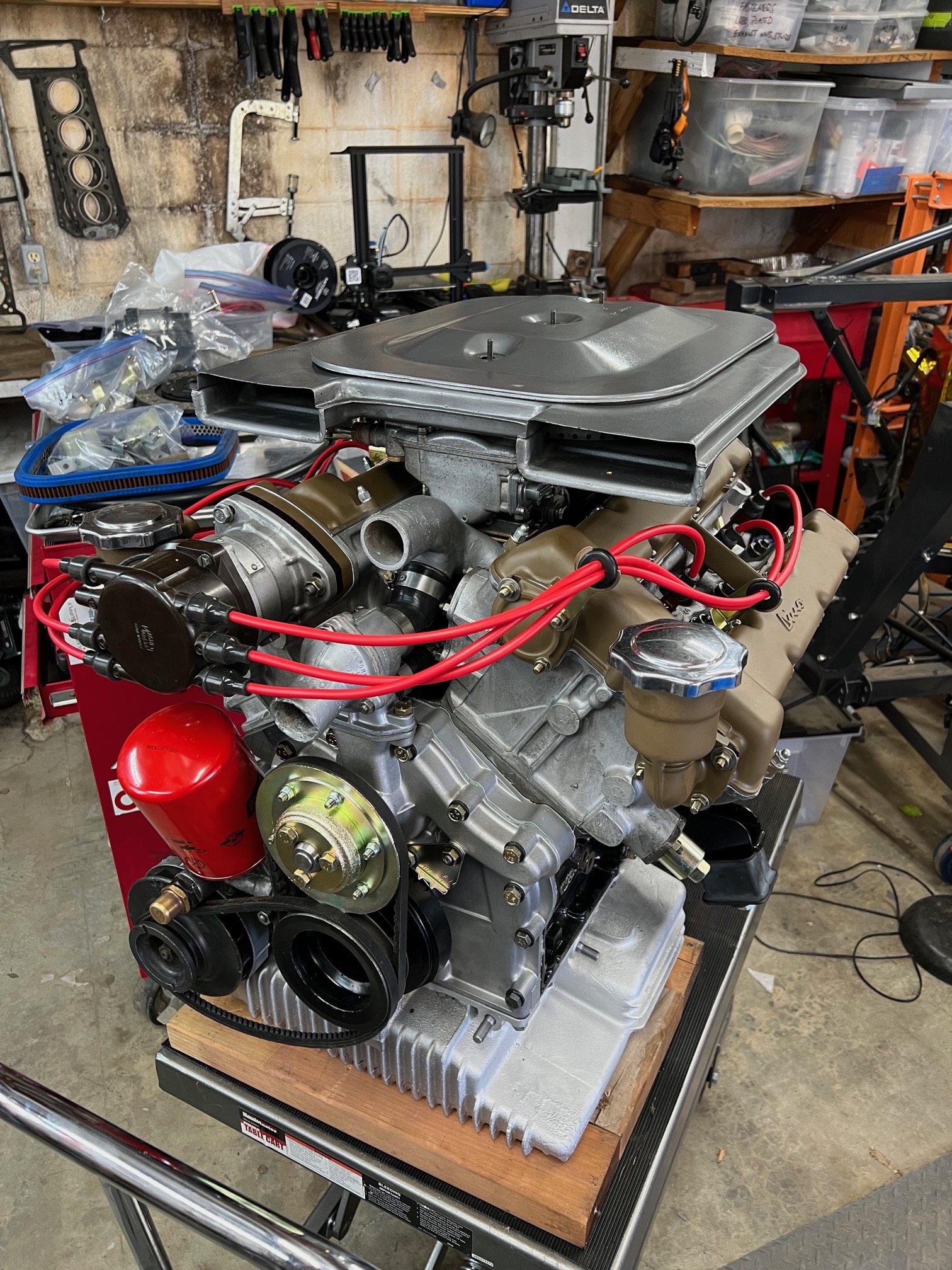

before and after shots:
