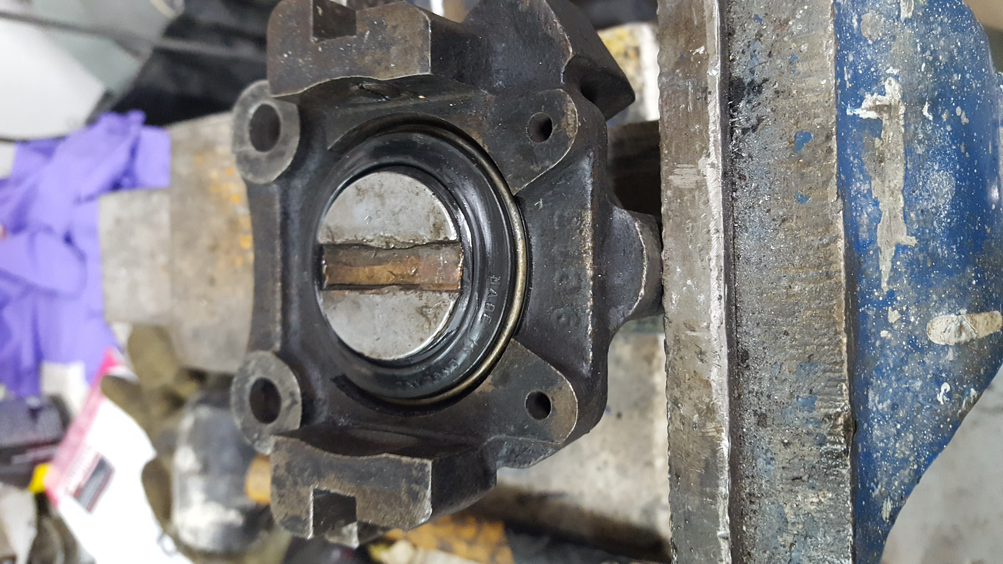

There have been many posts regarding how to refurbish the rear brake callipers on the 2400 Dino. The difficulty is that these callipers incorporate a floating two-piston setup that also serves for the handbrake. Often (like me, the first time), one takes it appart and only changes the front piston seal and boots. Unfortunately, this will not correct a sticky handbrake problem.

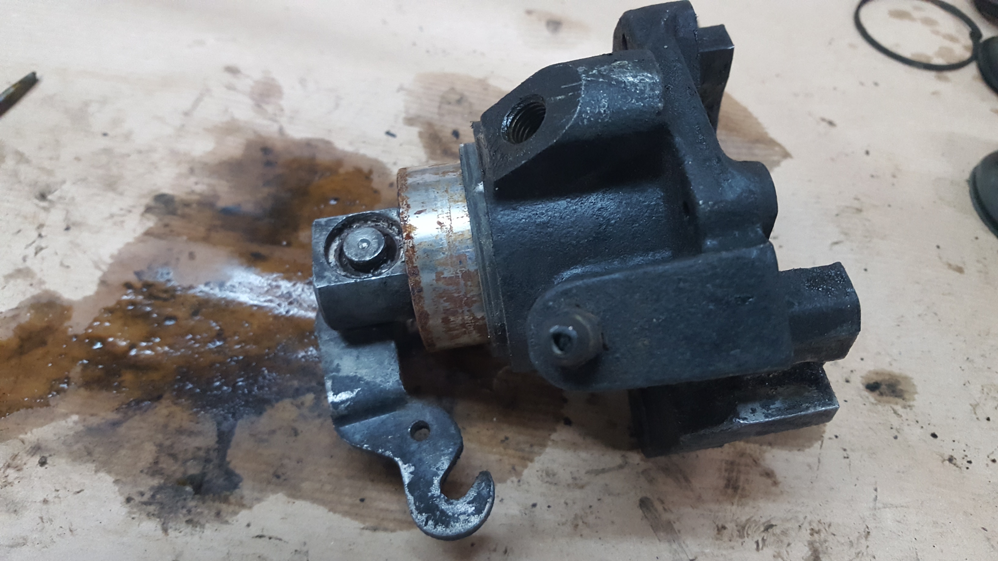

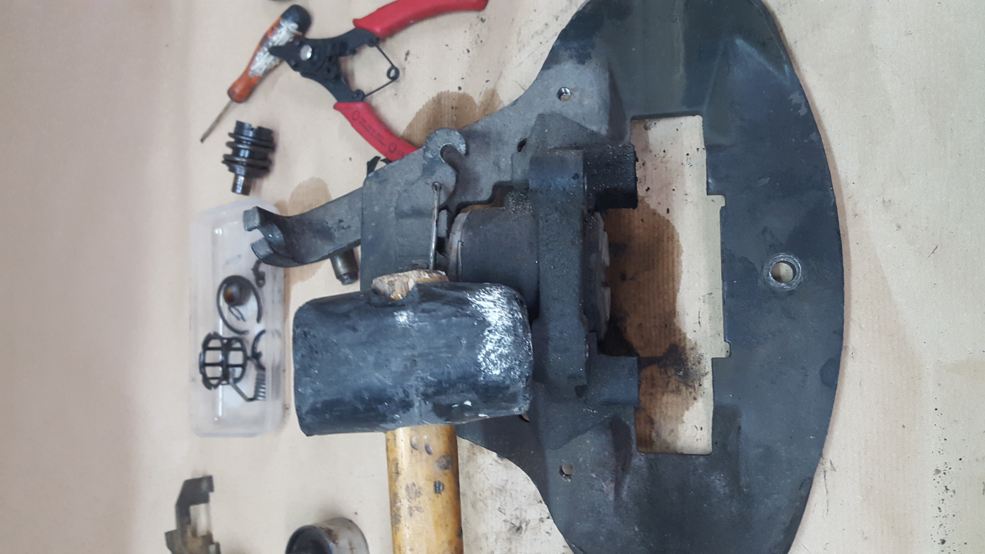

To fix the handbrake, you need to disassemble the rear piston and lever mechanism, which is a bit of a PITA. Since I had done mine, and a friend asked to help with his, I though I could document the process while it's fresh in my head. Here goes:

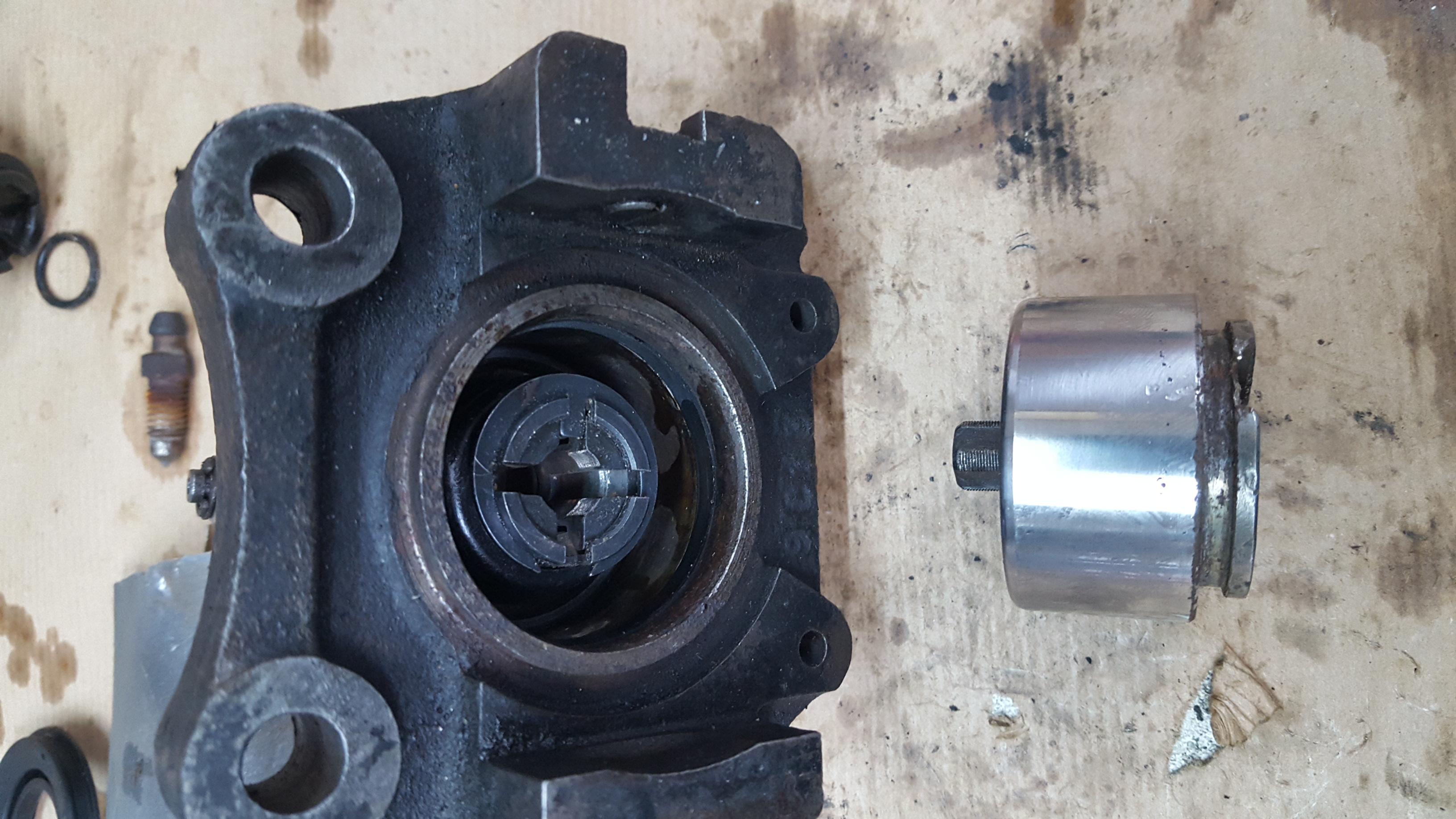

Remove the calliper from the car, disconnect the handbrake cable and use a soft mallet to drive out the piston assembly from the curved housing:
Then, remove the rubber boot protecting the piston

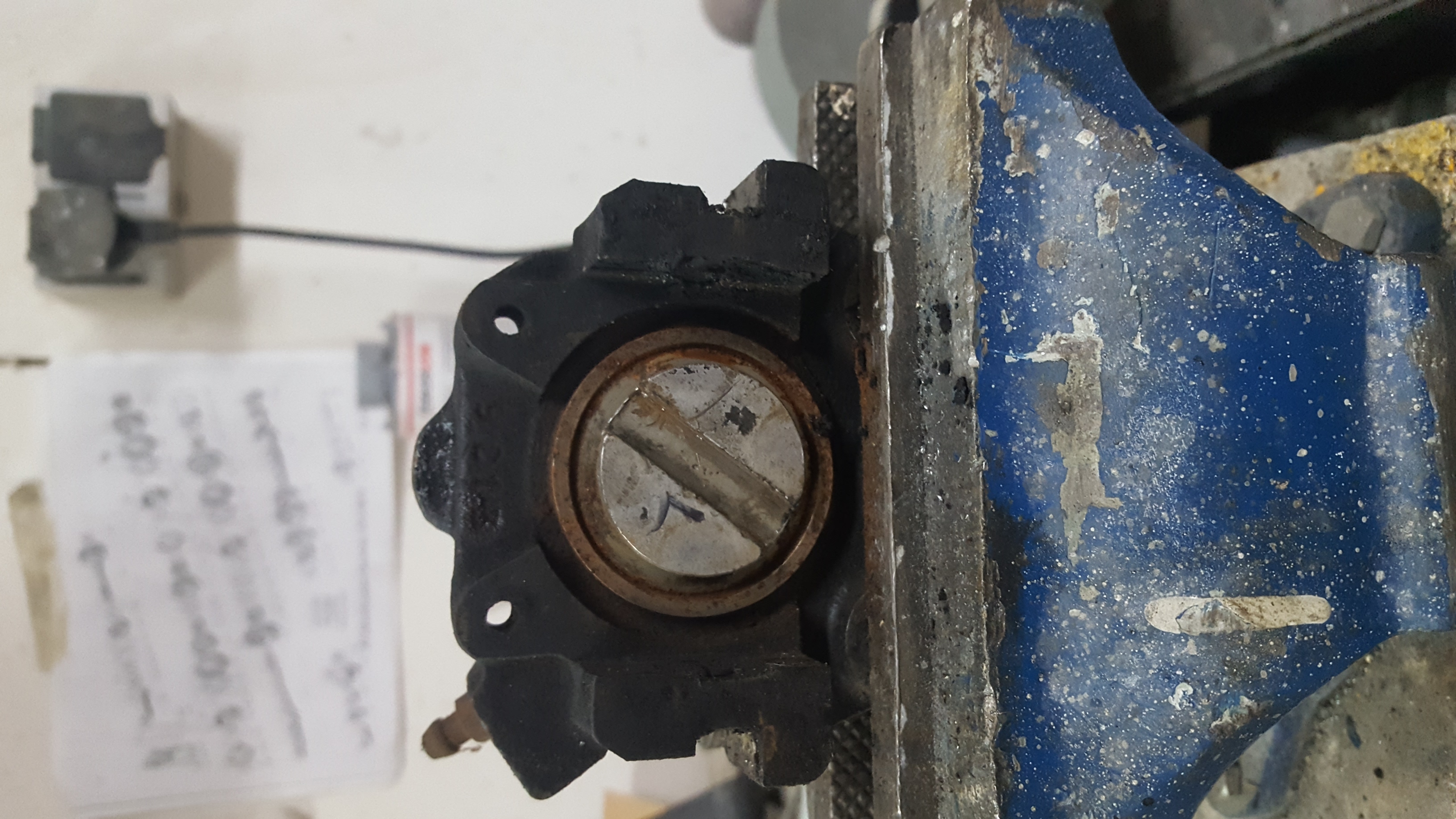

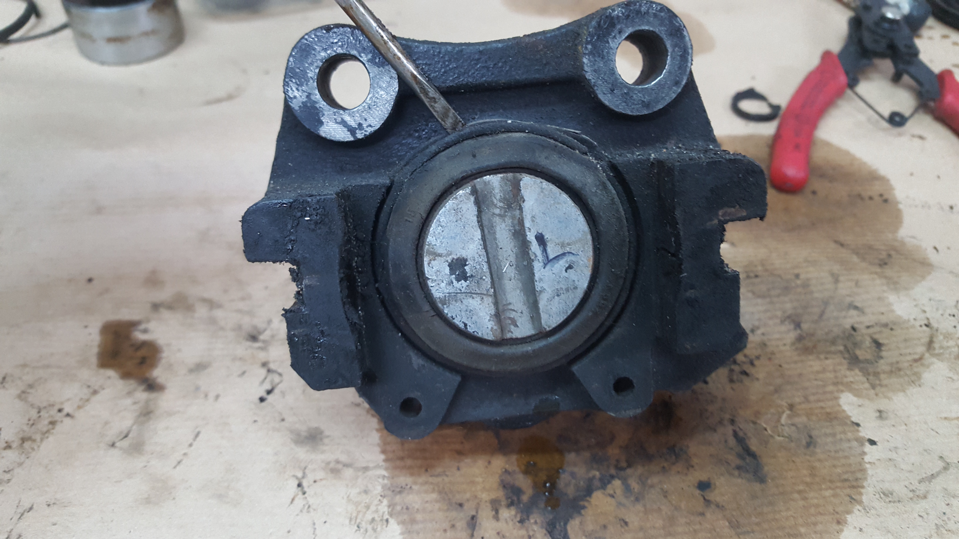

You will notice that the notch on the piston is pointing up (or maybe horizontal). You will need to turn it 45° so that it is diagonal. This allows the teeth from the piston insert to disengage. NB: I have heard of new pistons that were manufactured with an incorrect position of the insert, so beware!

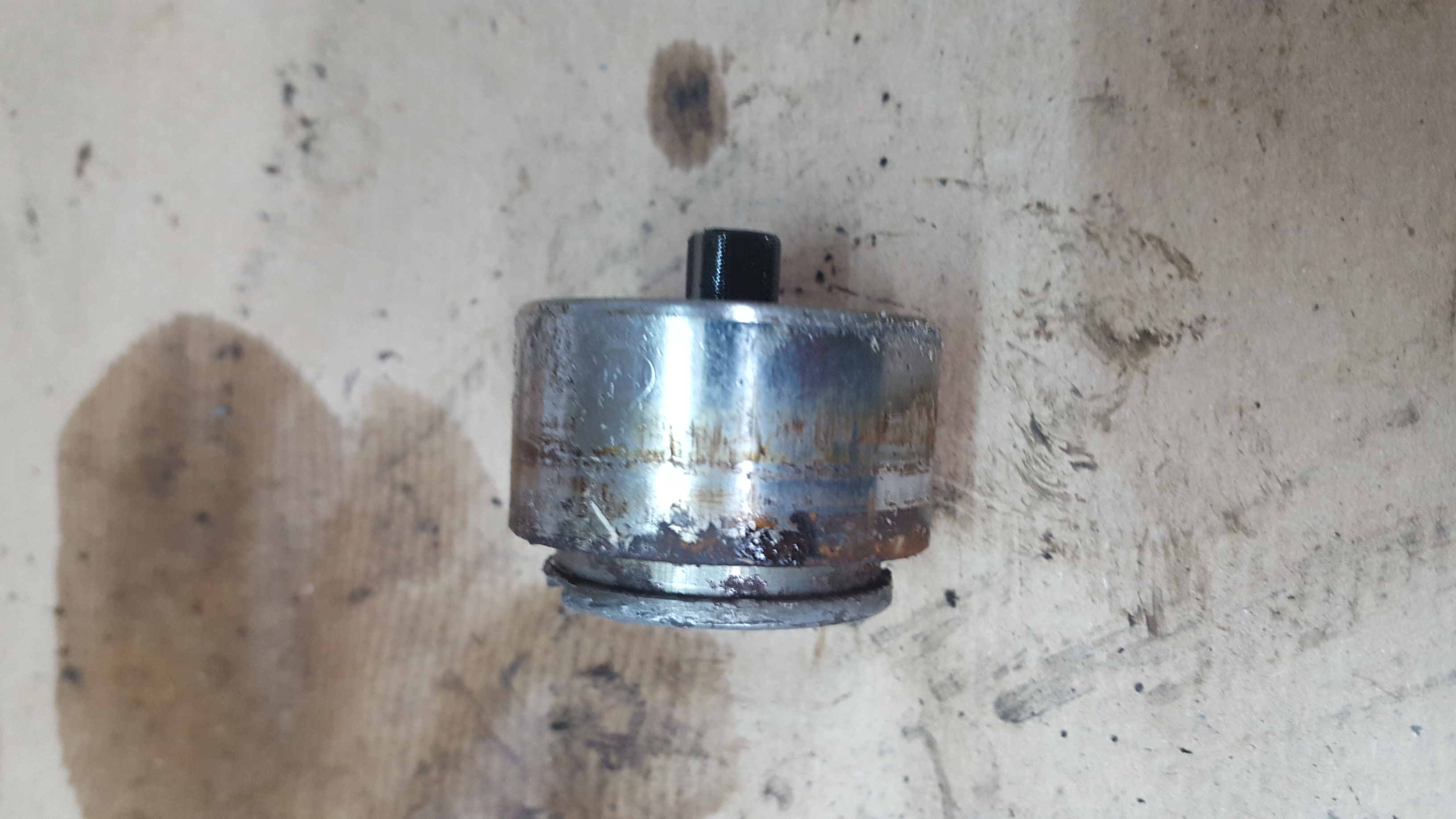

Then, you can use compressed air to push out the piston. You might be able to get it out with pliers, but be careful not to damage it. Here it is, badly scored near the rim. It did not leak, but it might be a good idea to replace it.

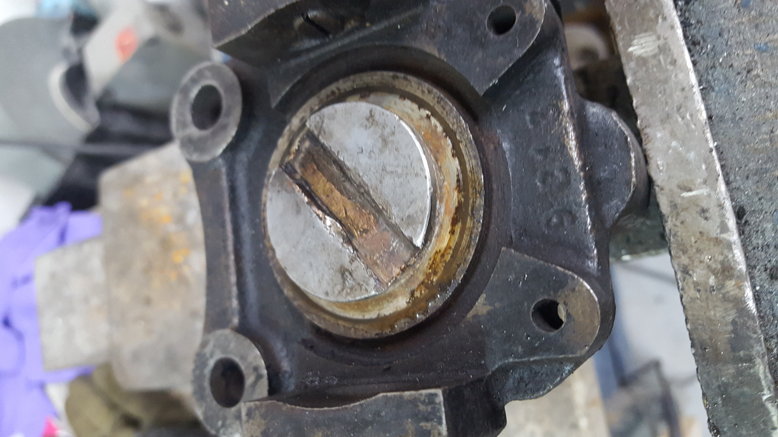

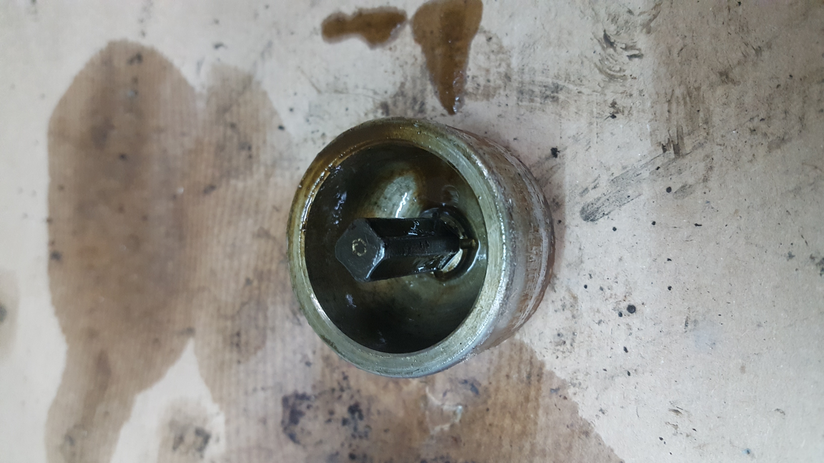

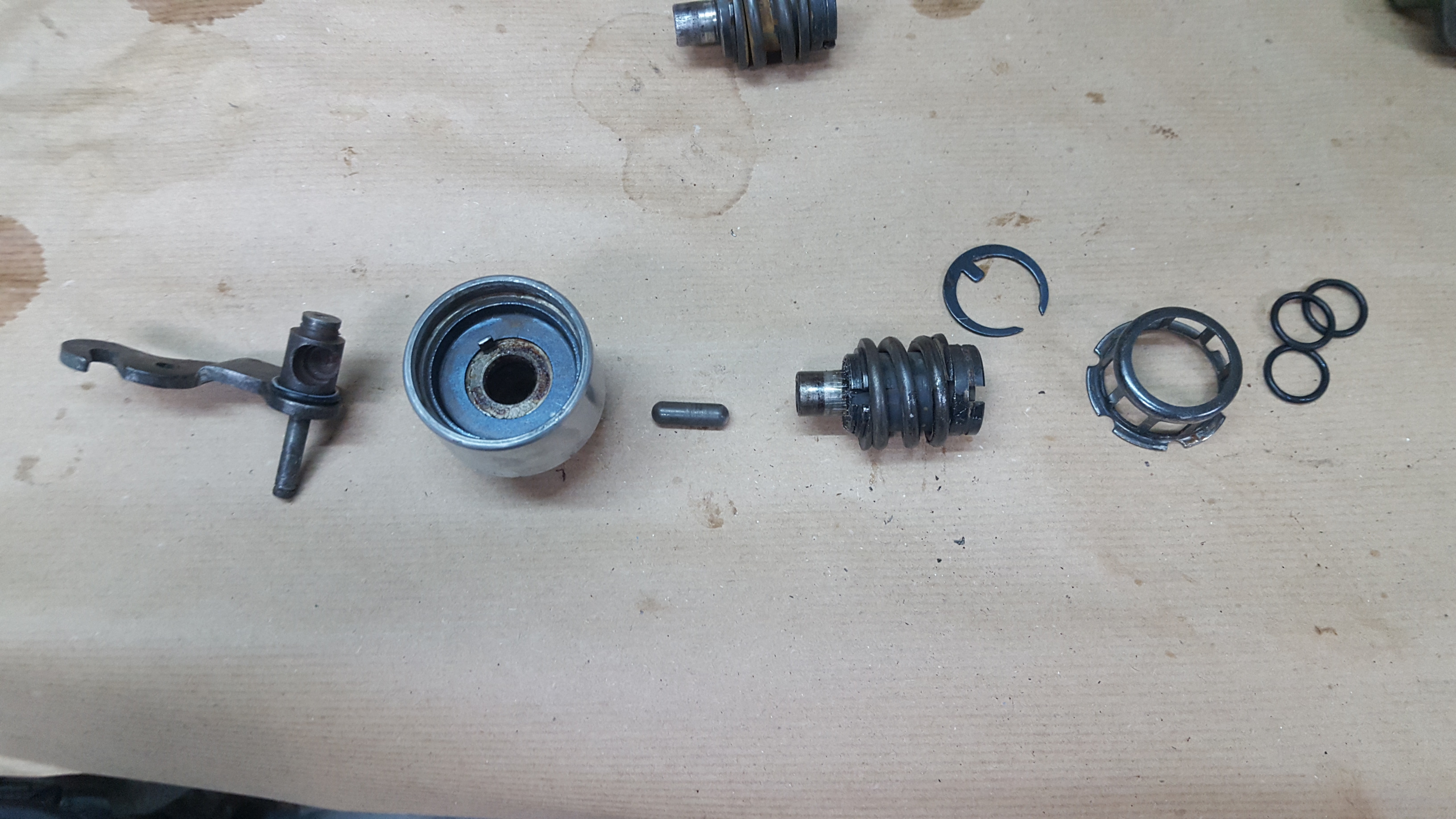

Here is the piston from behind, you can see the notched shaft that is used by the handbrake mechanism to push the piston forward when engaged. It is a ratchet mechanism, meaning that the pad wear is progressively taken up as the pedal is pressed.

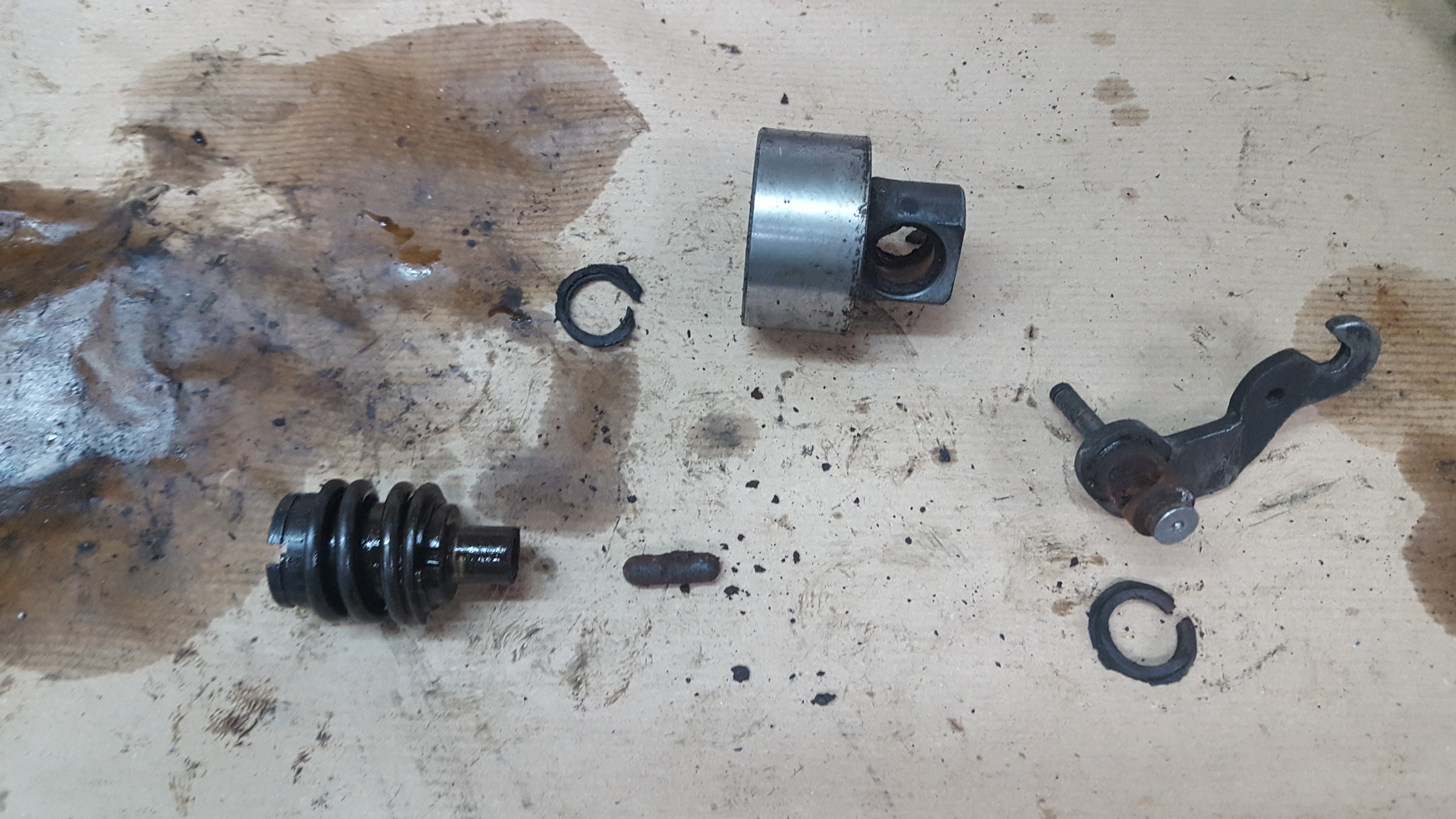

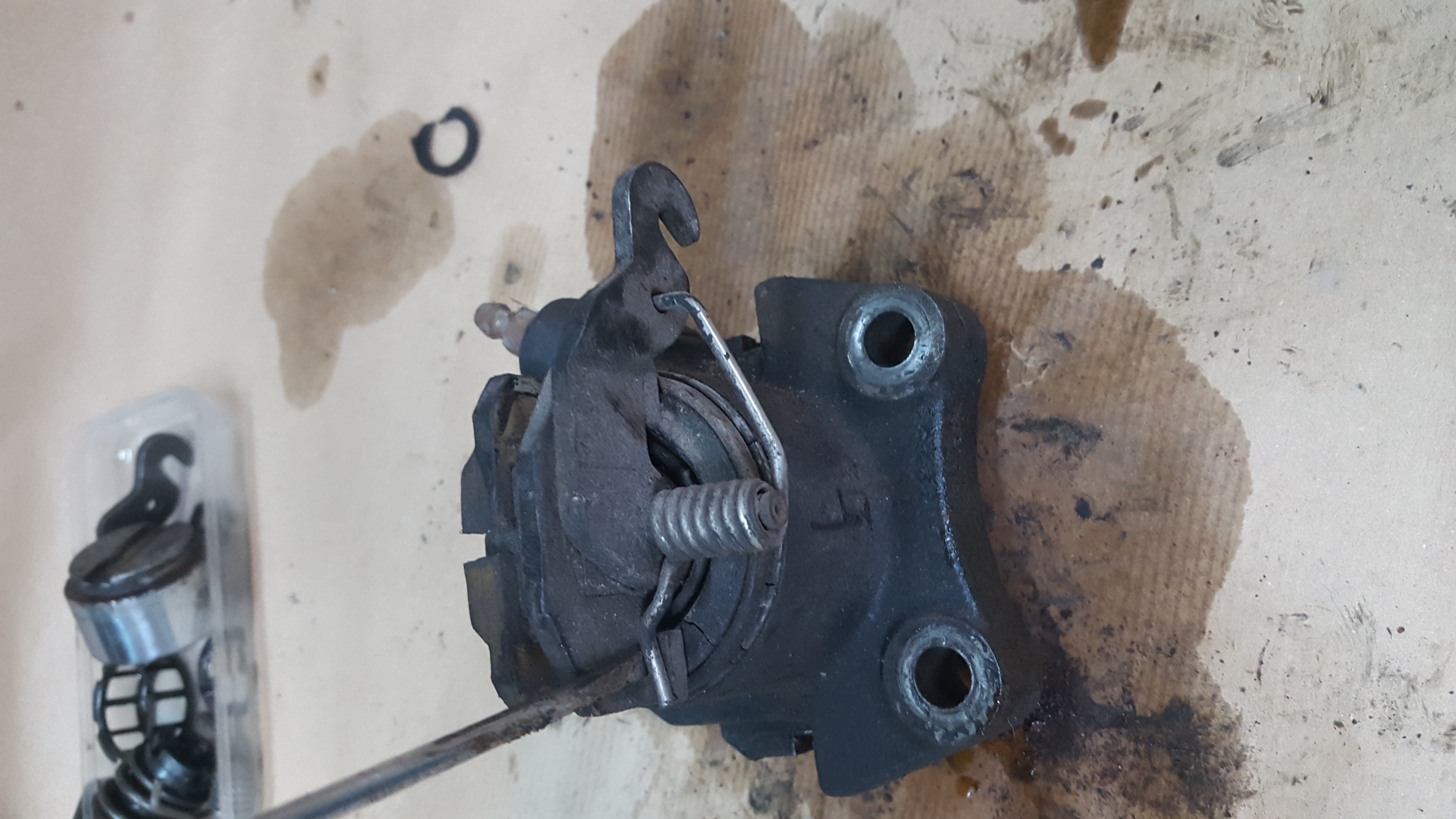

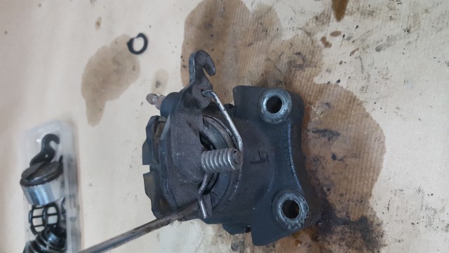

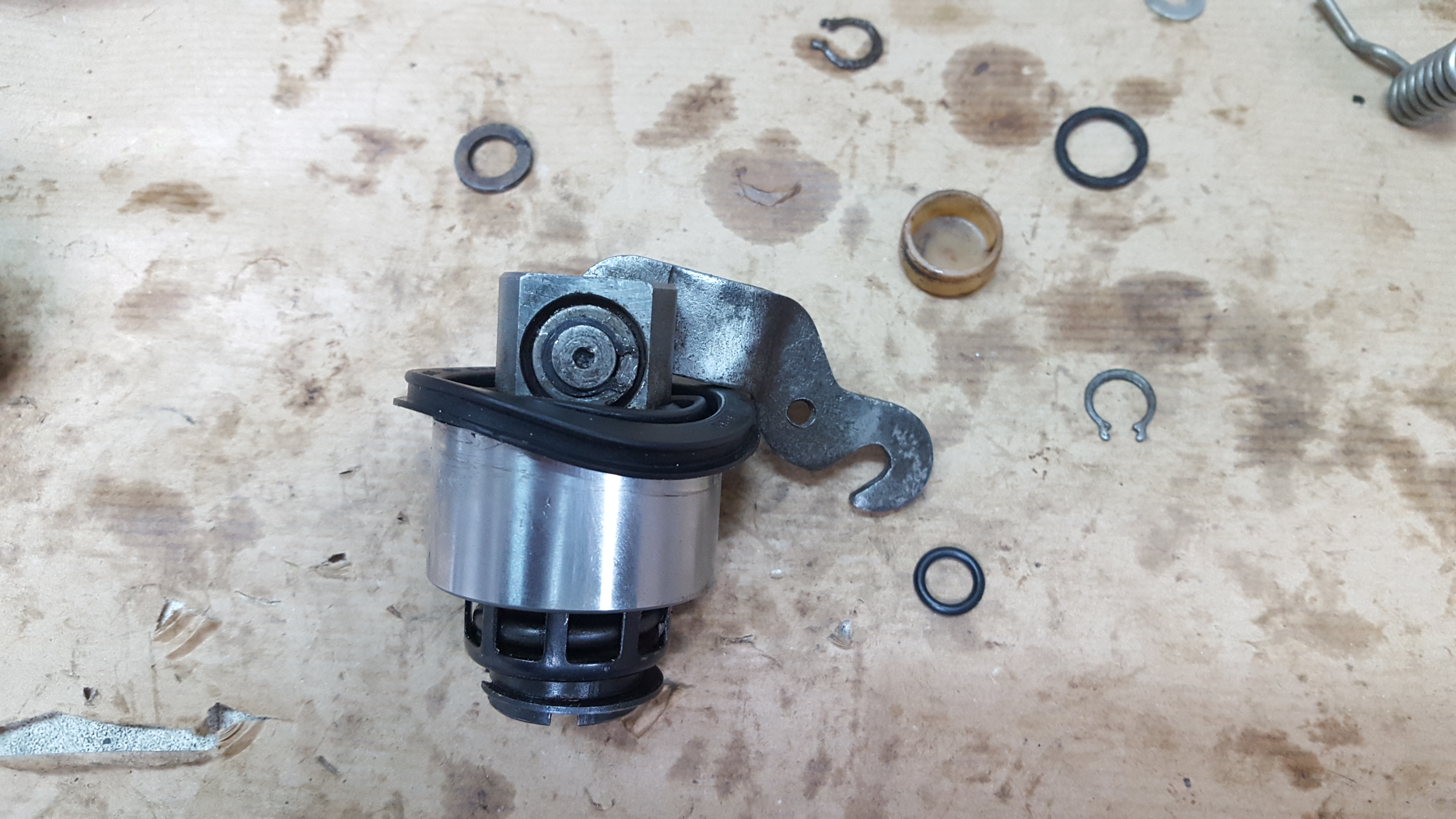

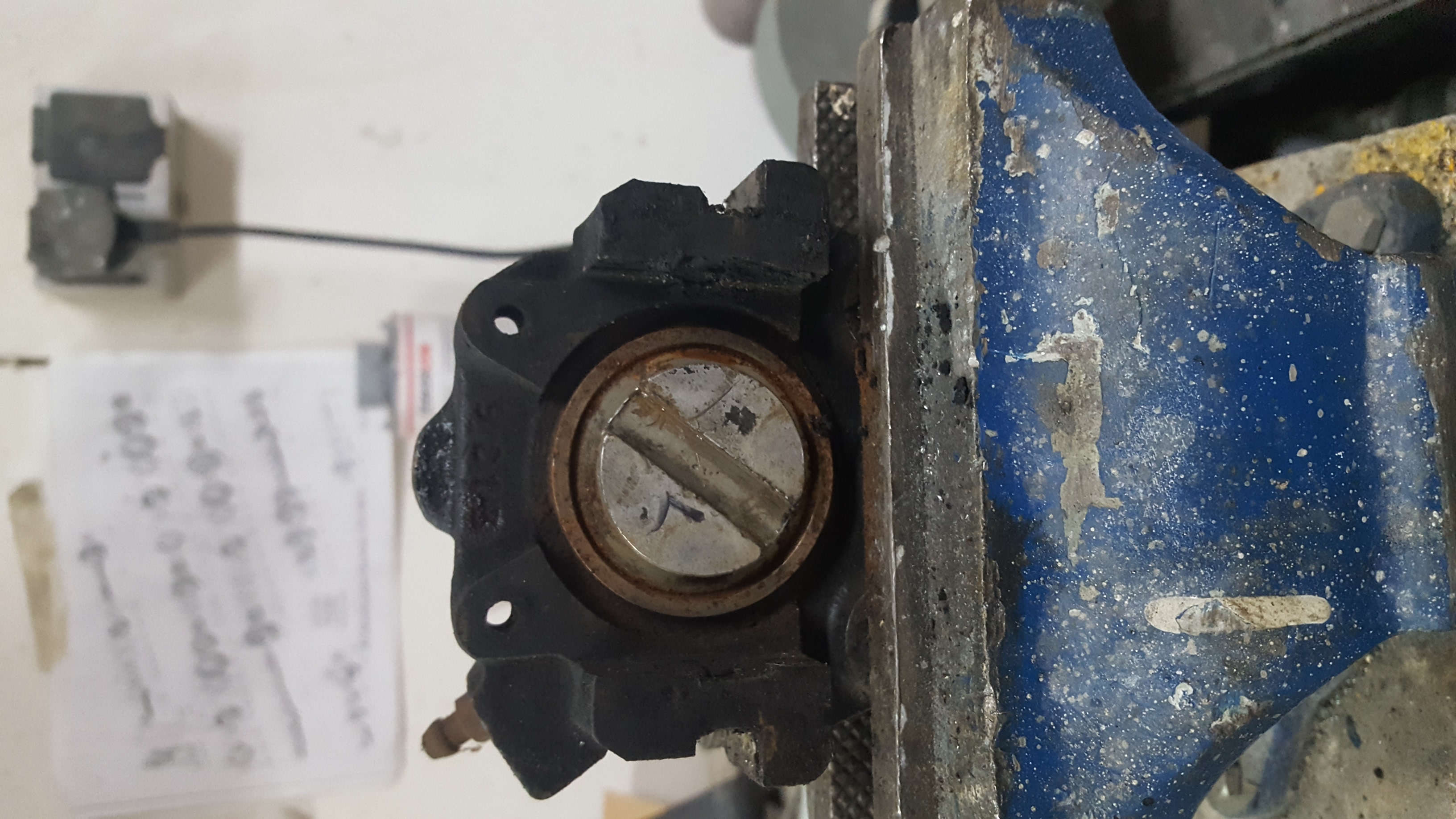

Now for the rear piston. Start by removing the circlip and return spring.
Then the nylon spacer and round plug to expose the circlip and washer that holds the lever mechanism in place. It is still held in place by a short pushrod inside the piston, so don't try to force it out. You should see what is left of the first (9mm o-ring).

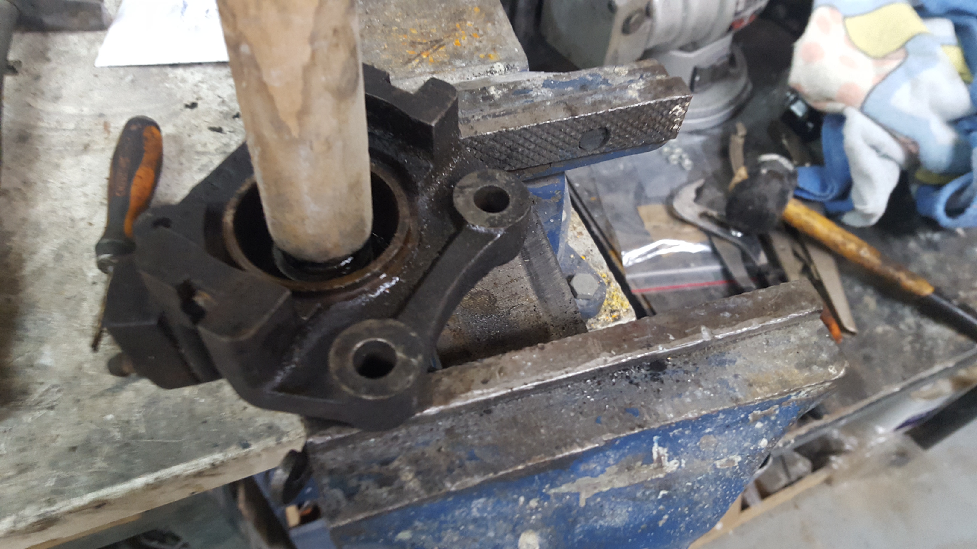

You have two possibilities: the first is that if it is not stuck, you can push it out with a wood drift which makes disassembly easier.

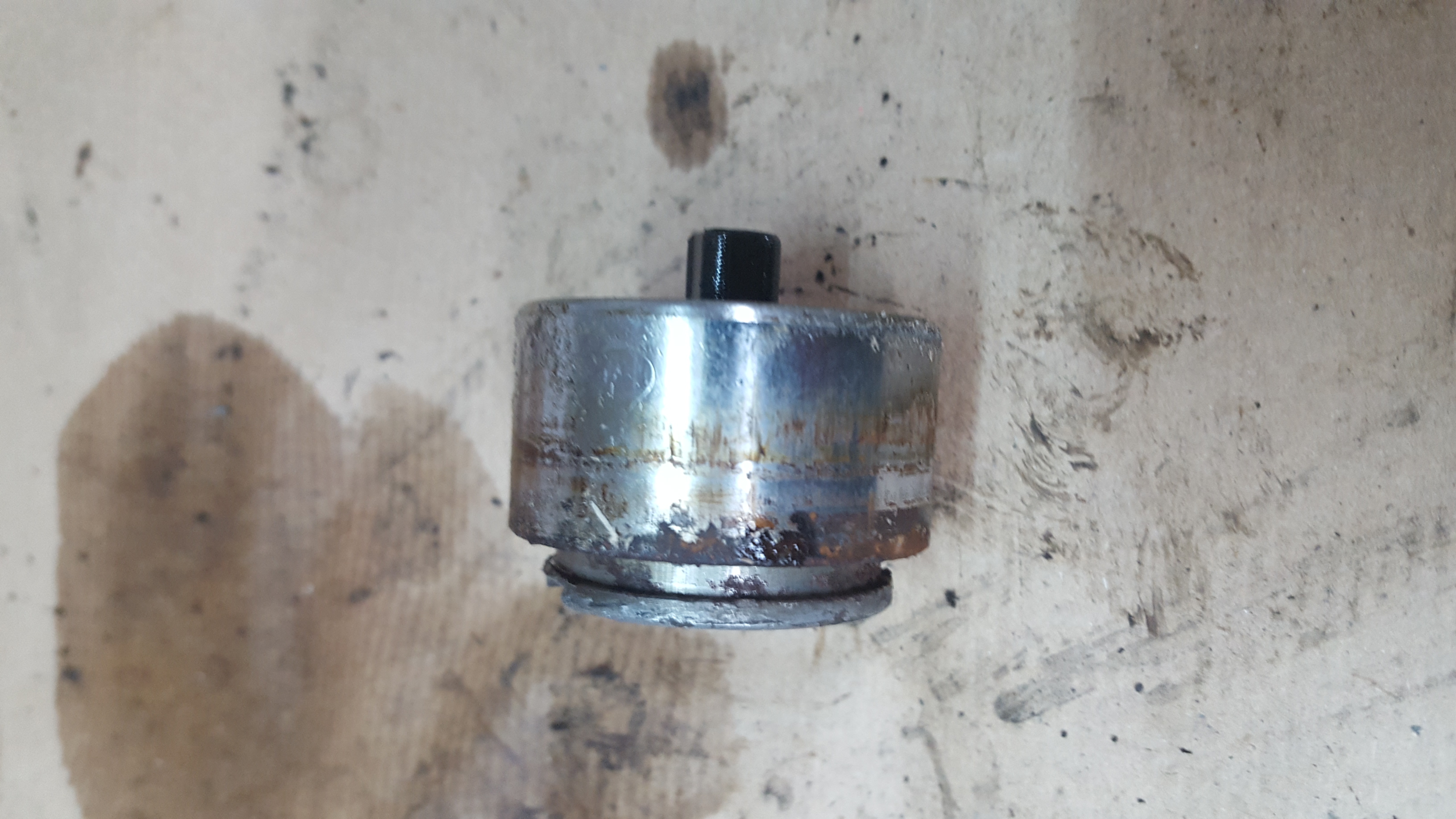

The piston will come out the back:

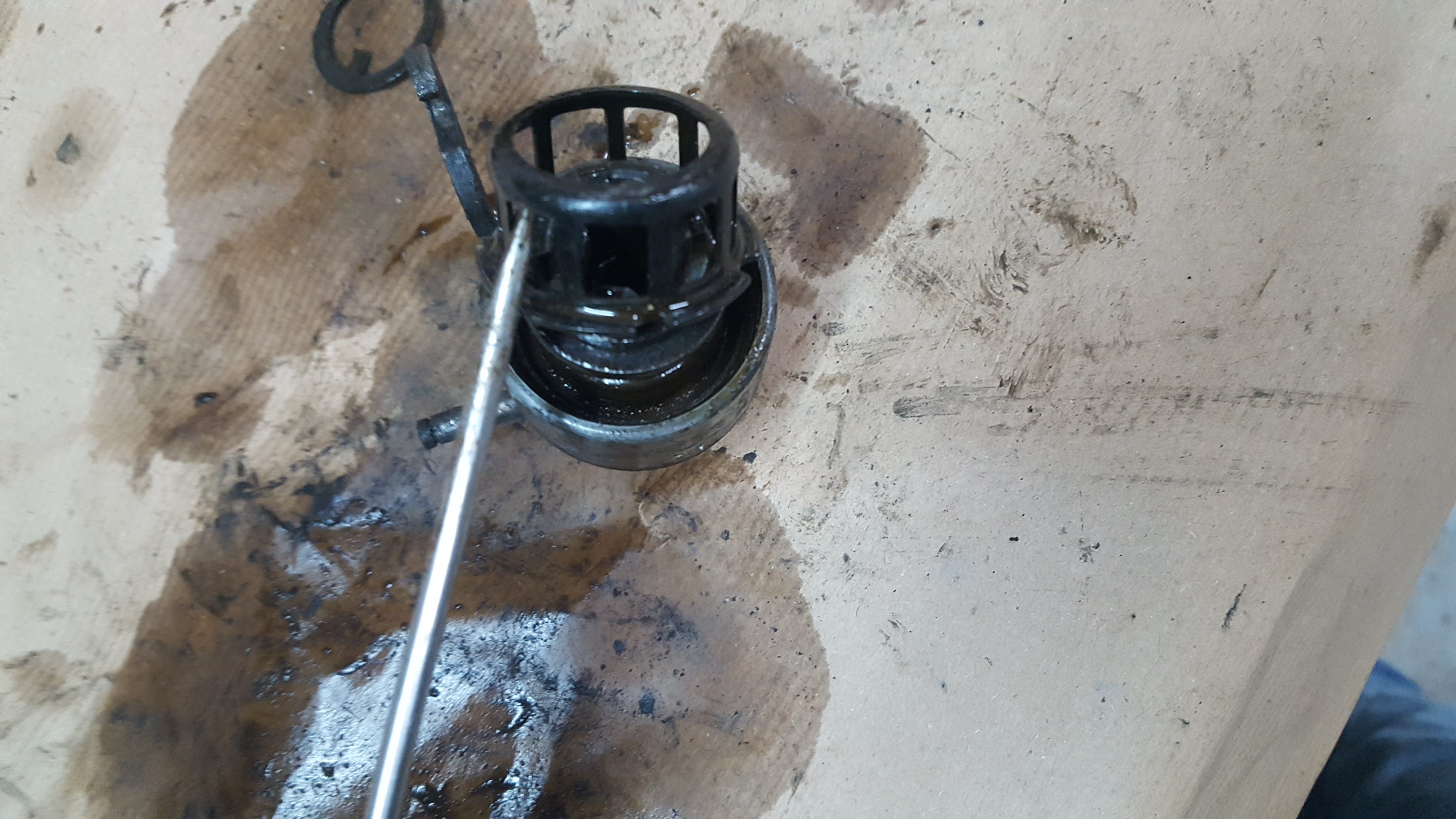

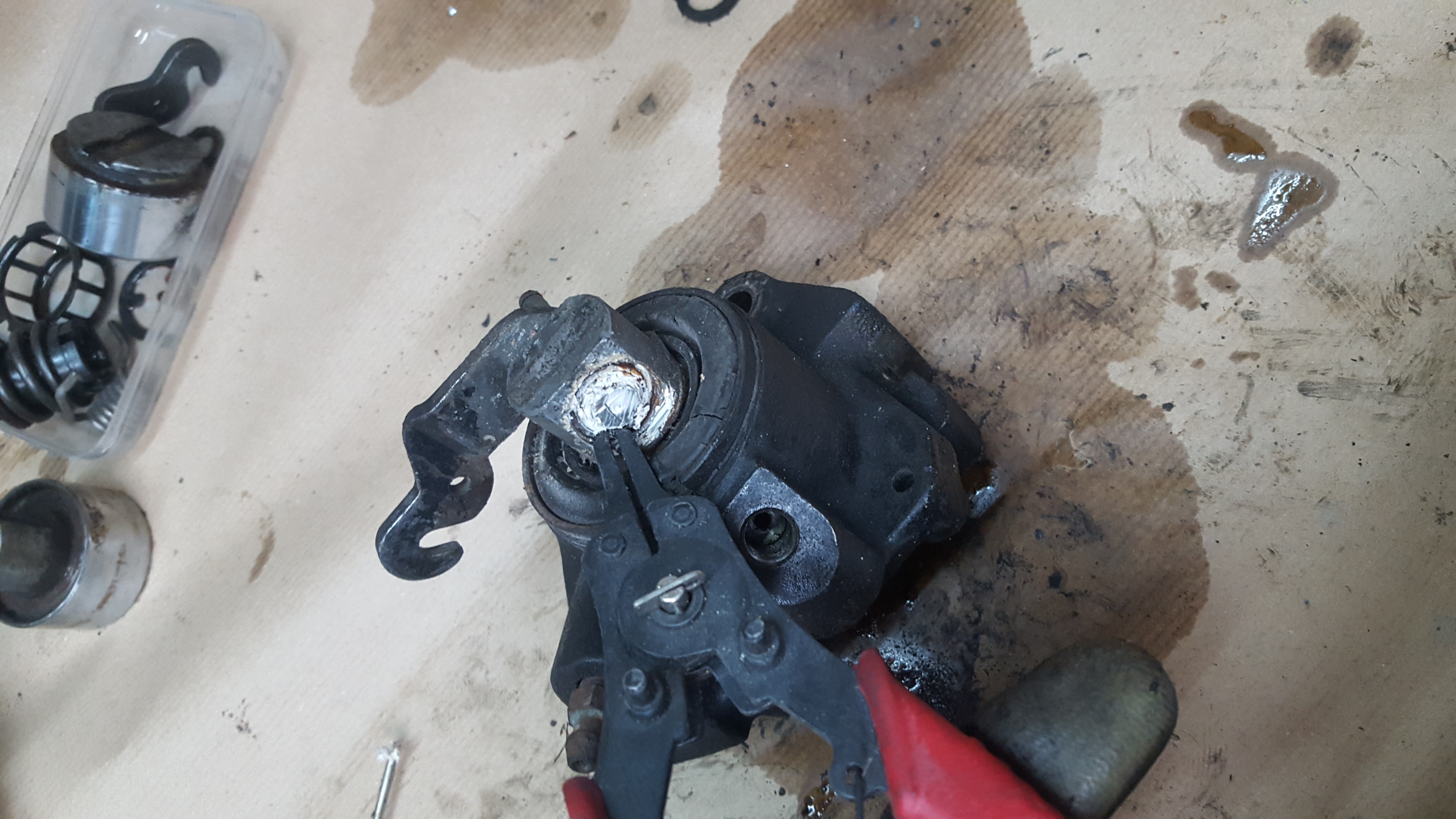

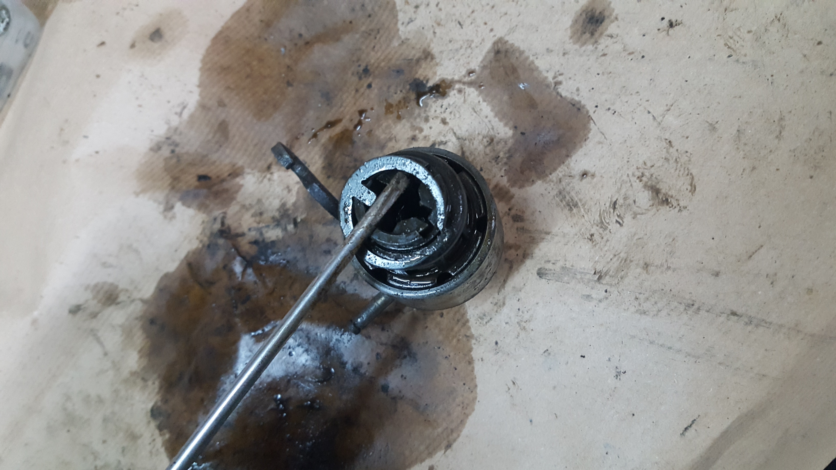

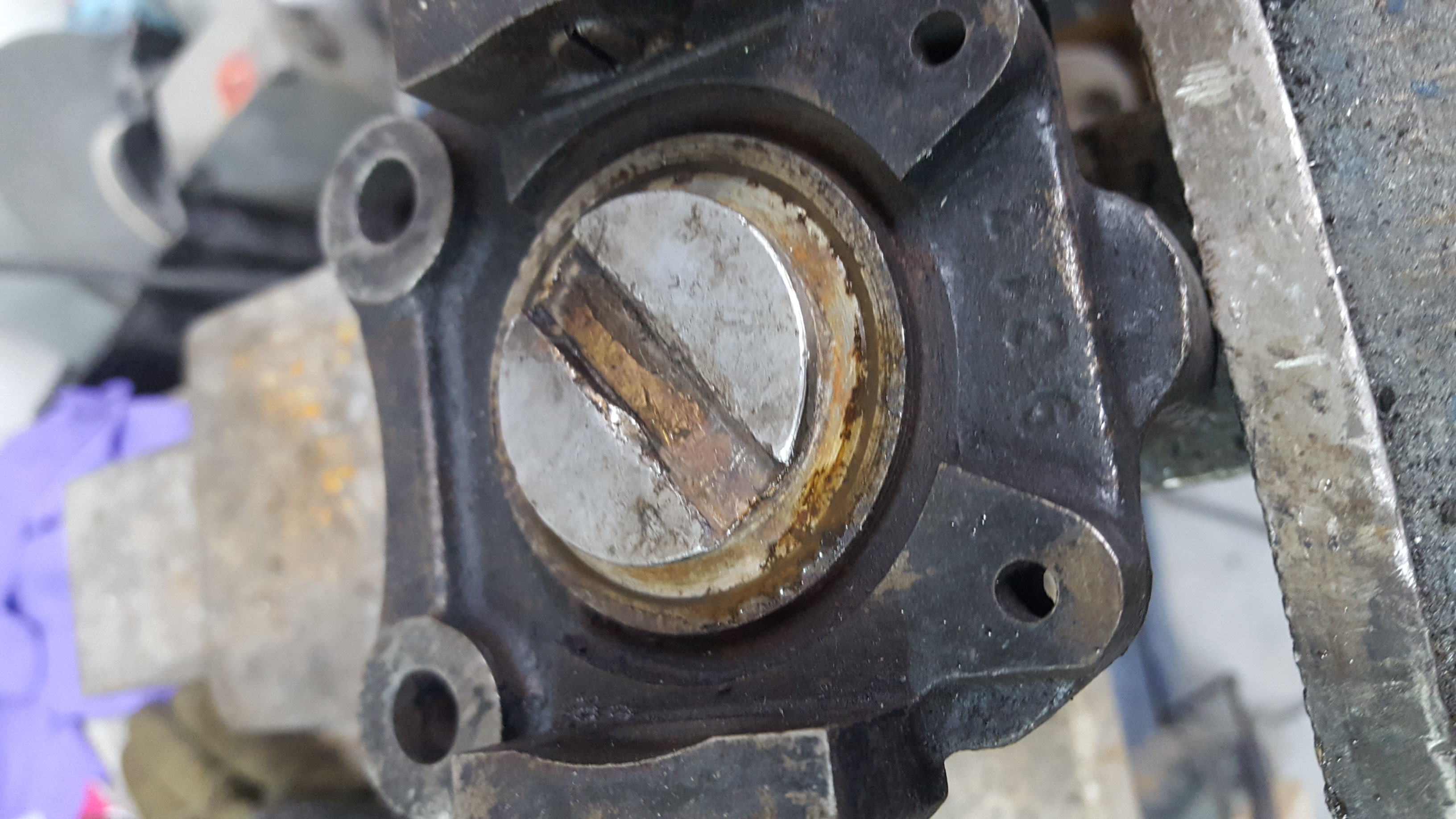

Now,,you need to remove a circlip that holds a metal cage and spring mechanism inside the rear piston. The circlip is held in by pressure and has one end beveled so that you can get a thin flat screwdriver in provided that you aligned it over one of the cutout holes. Then, remove the C-shaped clip that prevents the threaded insert from turning.
Then, remove the cage, you can see the holes I mentioned above

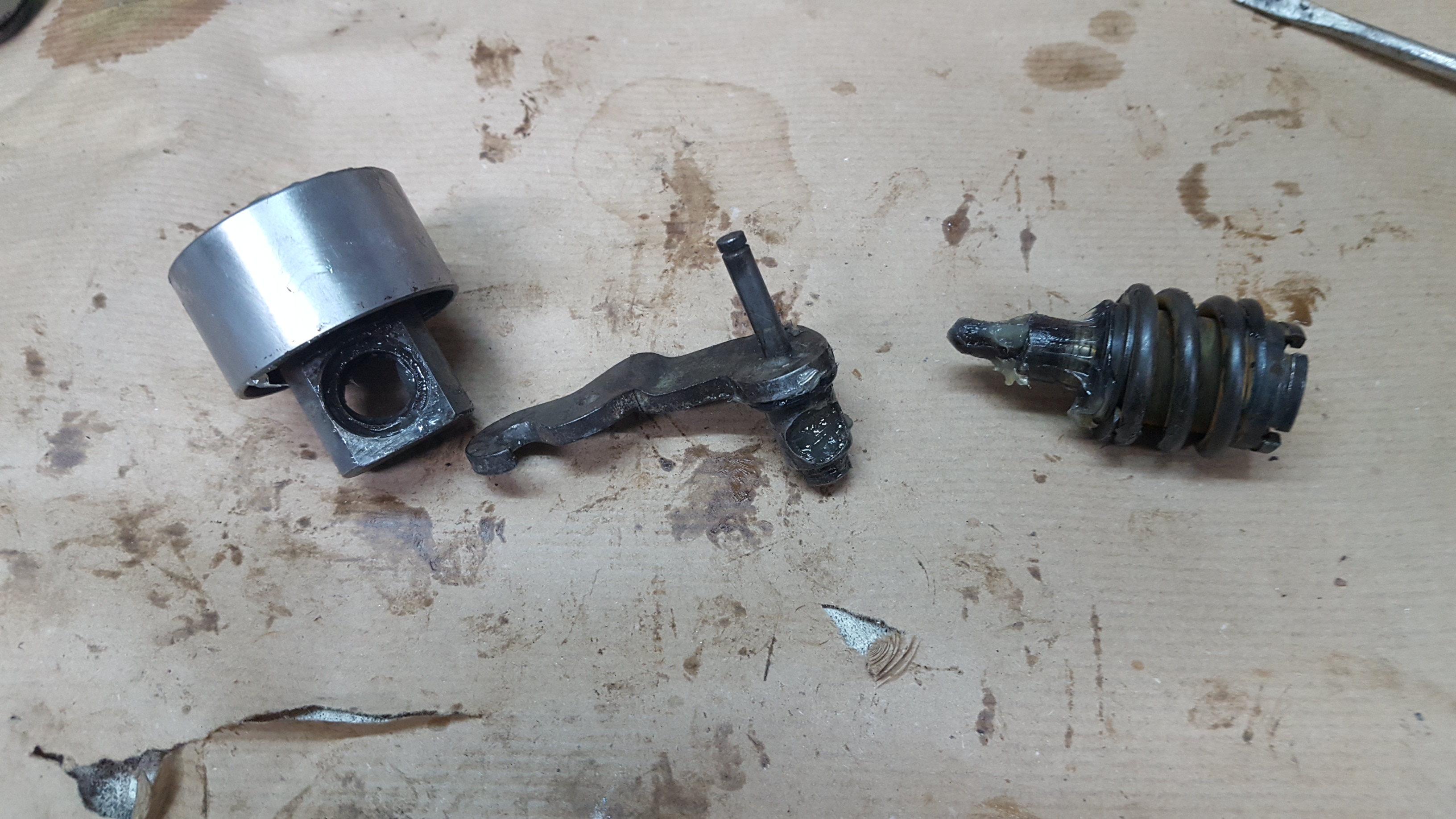

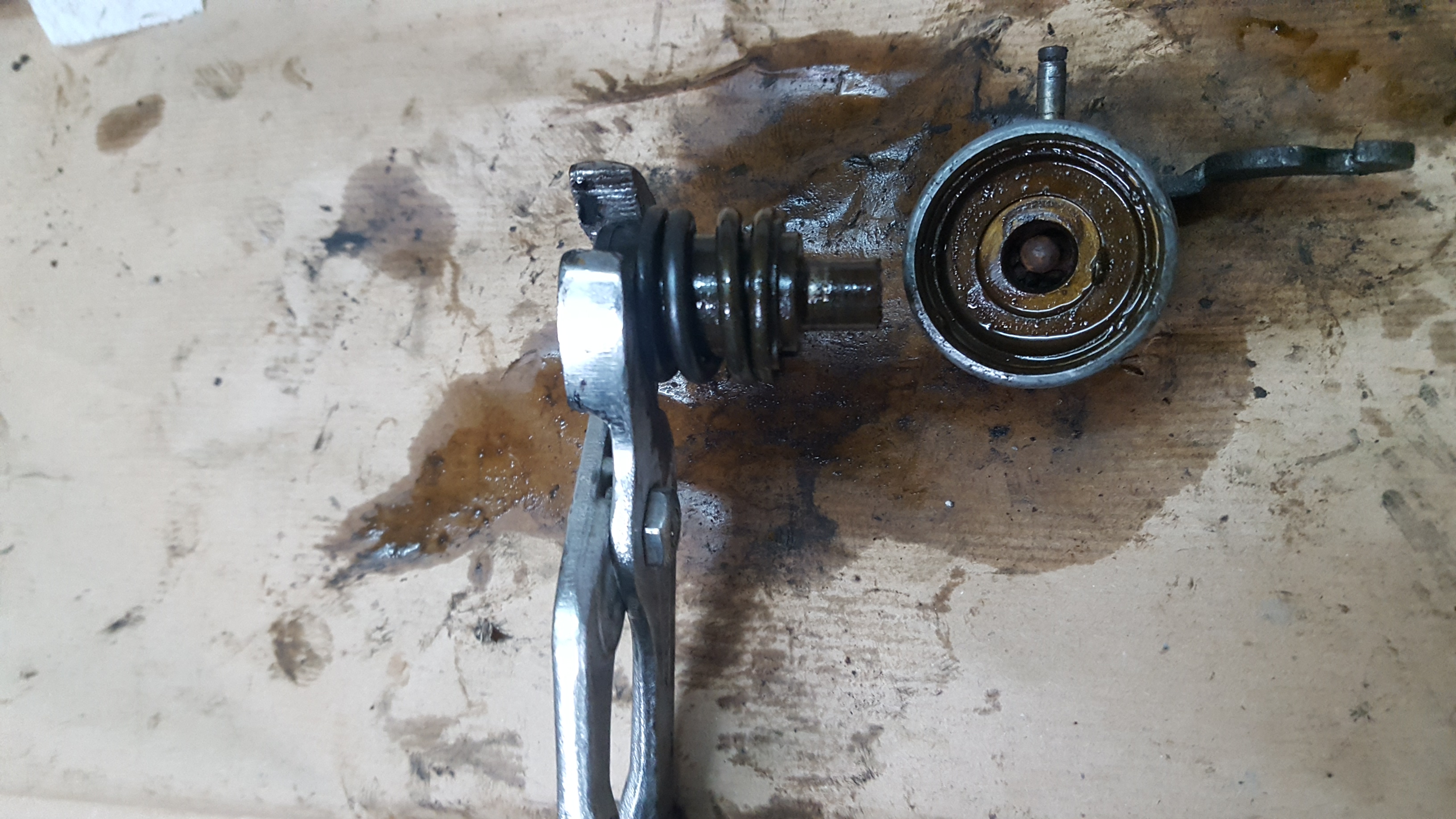

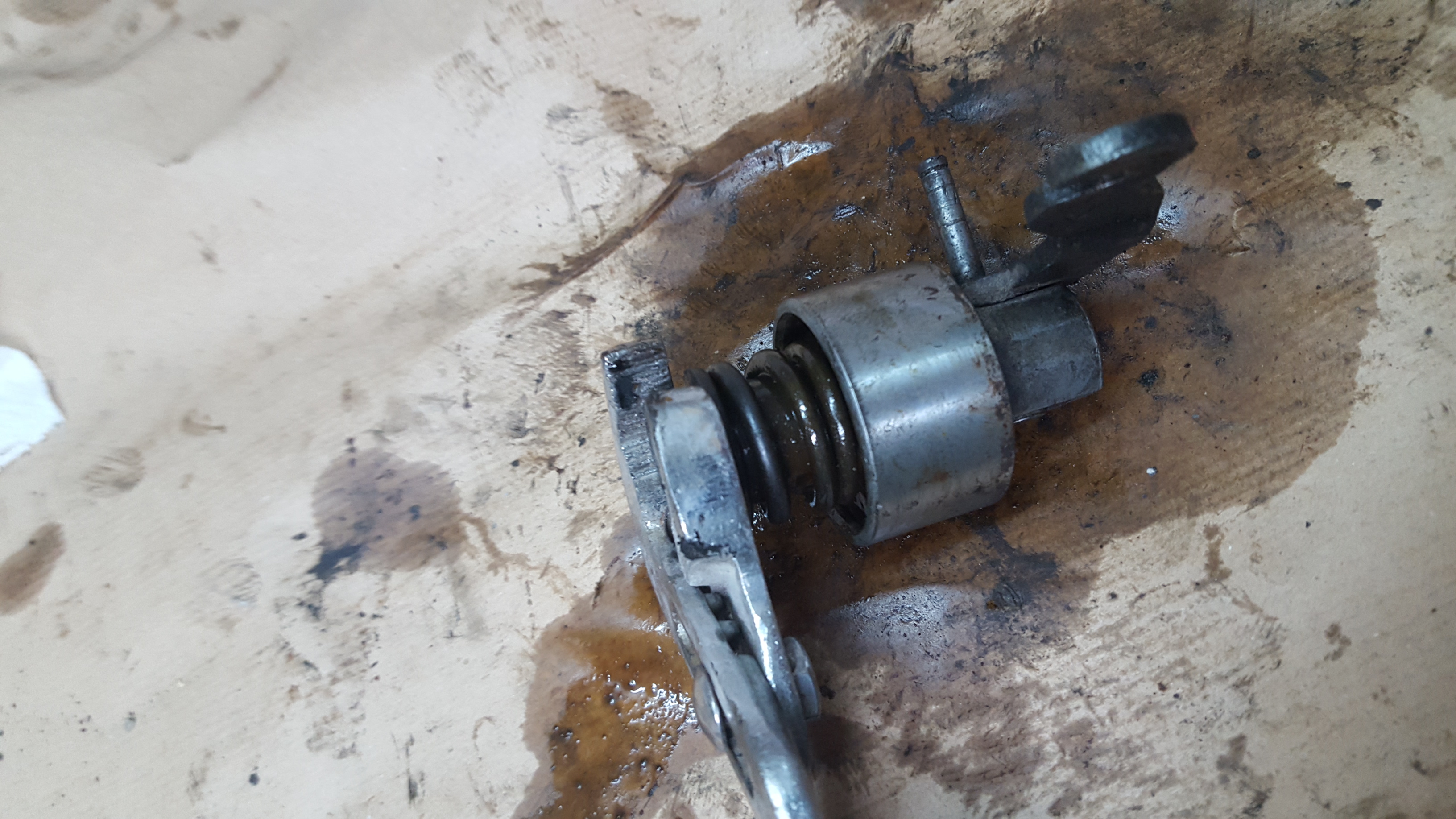

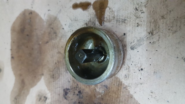

Now, you can use a pair of pliers to simply twist off the spring mechanism and expose the pushrod.
This can just get cleaned, no need for further disassembly. You can see all the grime that got in over the years, not to mention the O-rings that wear and let dirt in. No wonder these things fail!

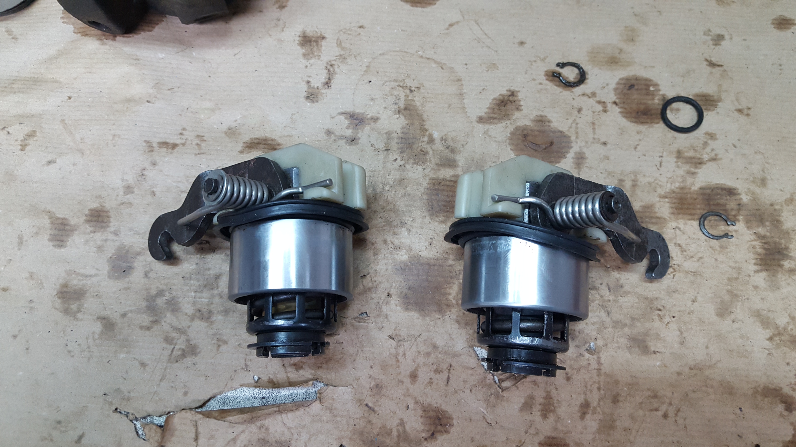

Reassembly is basically the reverse procedure. Here are the parts ready for reassembly.
I use some lithium grease to hold things in place and lubricate the mechanism. Don't forget the larger (12mm) O-ring on the lever mechanism, next to the where the lever to the cable is attached.
Don't forget the rubber boot!
Place the smaller O-ring, then the washer, and then the circlip, followed by the nylon plug, the spacer, and the spring. Then, the rear pistons are ready for assembly. The circlip will not fit right away, you need to push down hard with a flat blade screwdriver to compress the o-rings and the clip will "click" in place.
Once they are inserted all the way inside the floating body of the brake calliper, you can insert the front piston. Make sure it is aligned diagonal so that the teeth do not engage.
Push it in ALL the way, before turning it by 45° and locking it into position.
Locked:
and secured in place. Ready to mount!

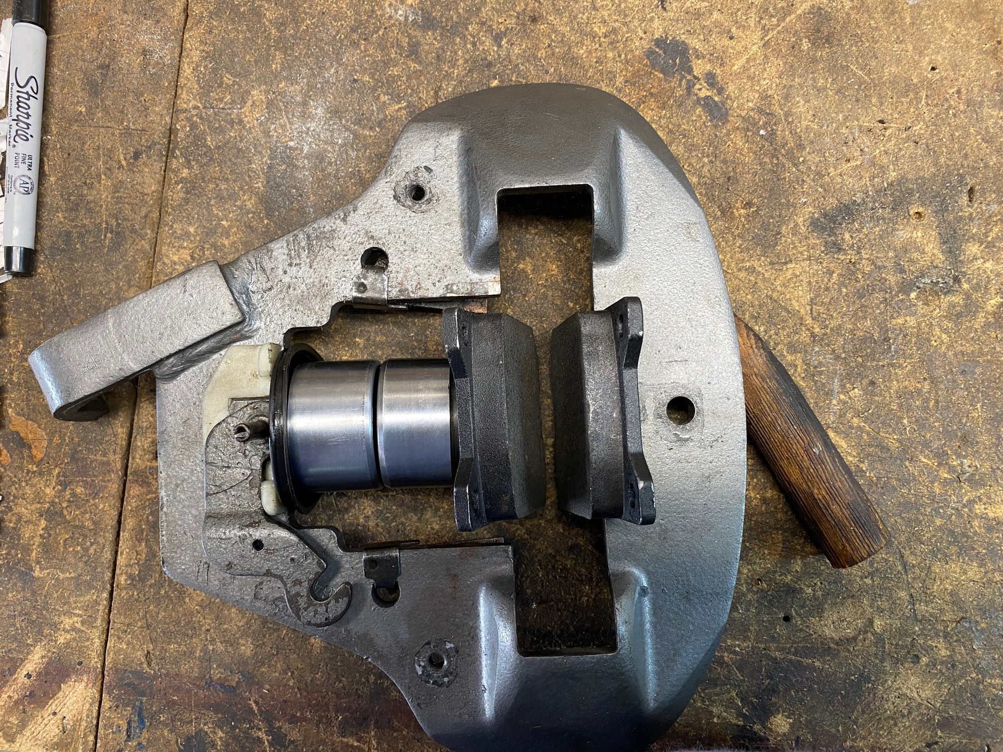

Some further work:

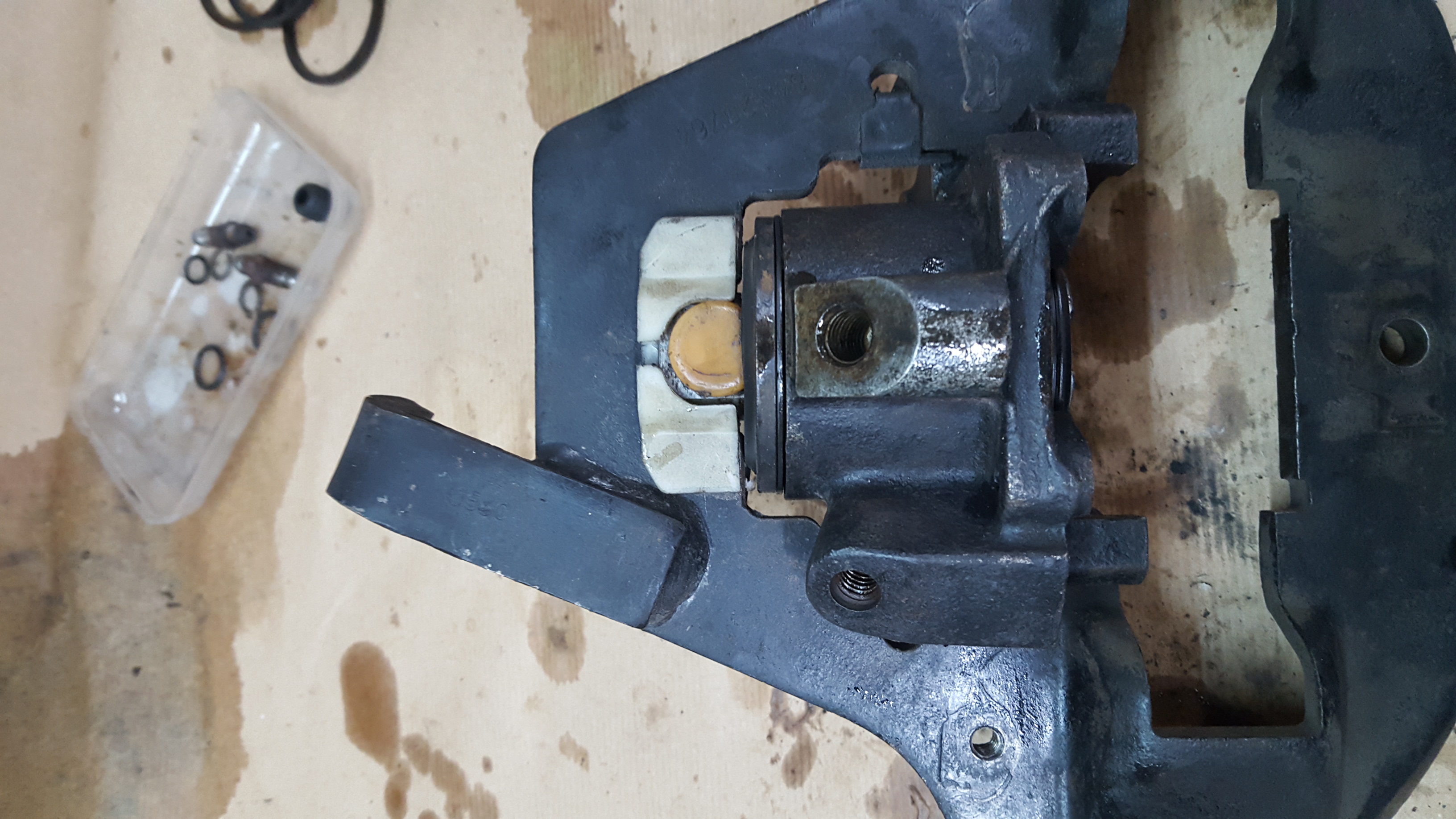

I couldn't leave it that I was forced to re-use the old pads on the right-rear caliper (because not enough clearance for the new/thicker set) - so decided to dismantle it one more time and see what was happening.
This caliper has a different internal construction to my left caliper, specifically in the way the handbrake mechanism ratchet-clamp is retained. Still i couldn't understand what made the clearance for the new pads different to the left side - this picture might help visualize the problem.
Shows the floating plate, both pistons and the pads, but with the caliper body 'removed'. The disk/rotor is 18mm thick and the remaining clearance available here between pads is about 16mm - so I had to find 2mm additional.
The obvious place for more clearance was the backstop for the outer pad (the inside of the floating plate on the right of this picture) - so I ground off the necessary 2mm of metal. Also, on the back of each pad (manufacturer Siffert, supplied by Superformance) there was a locating "pip" which was too large to fit in the groove of the inner piston, therefore wasting clearance, so I ground that off too - it doesn't serve any useful function that I could see (it might be there as a locating part for the outer pads)
That worked - there was enough clearance to reassemble with the new pads and the handbrake and hydraulic brake are working well. I never had both calipers off the car at the same time, so I couldn't measure to see where left is different from right - but my guess would be the dimensions of the floating plate.
