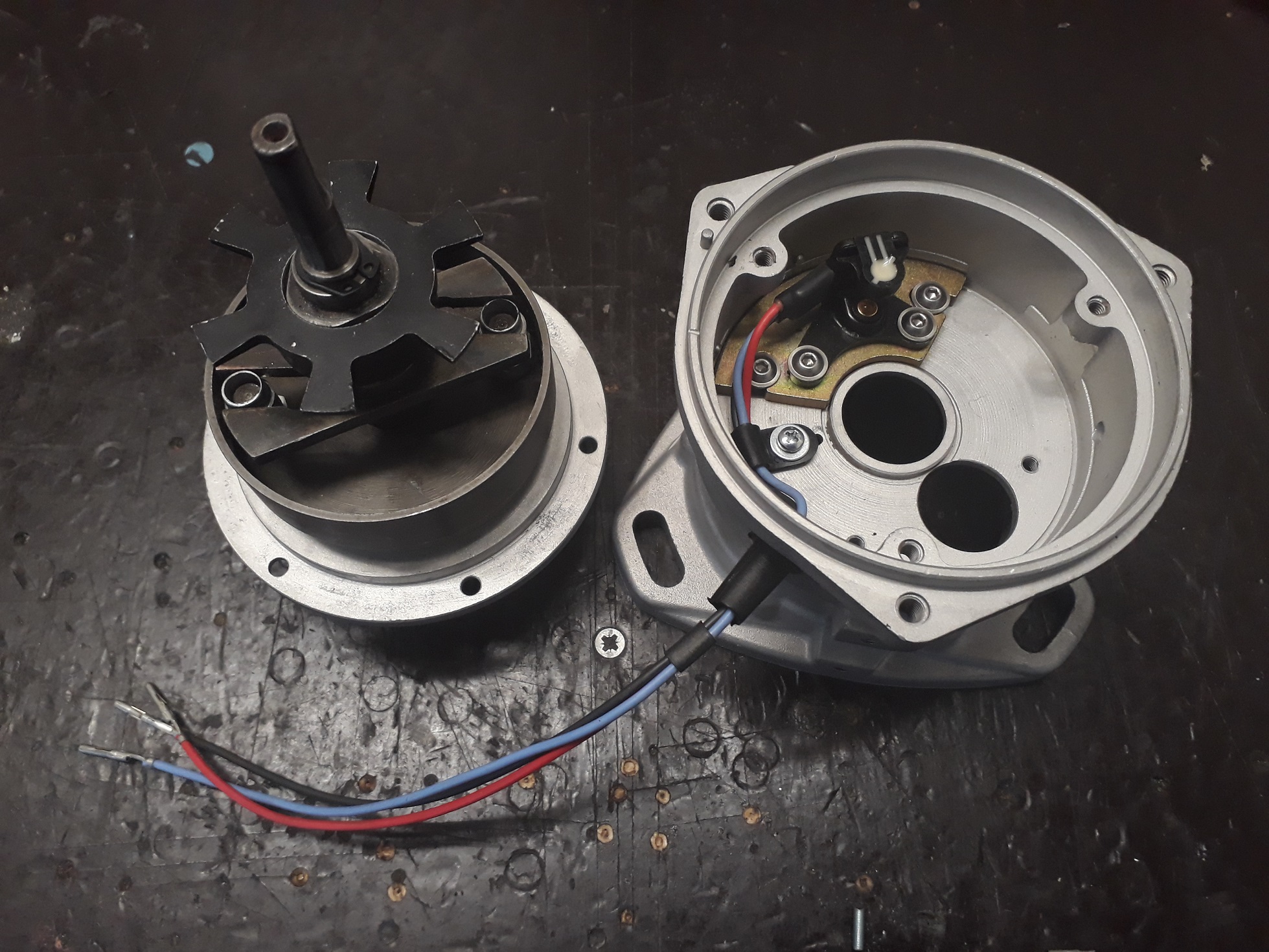

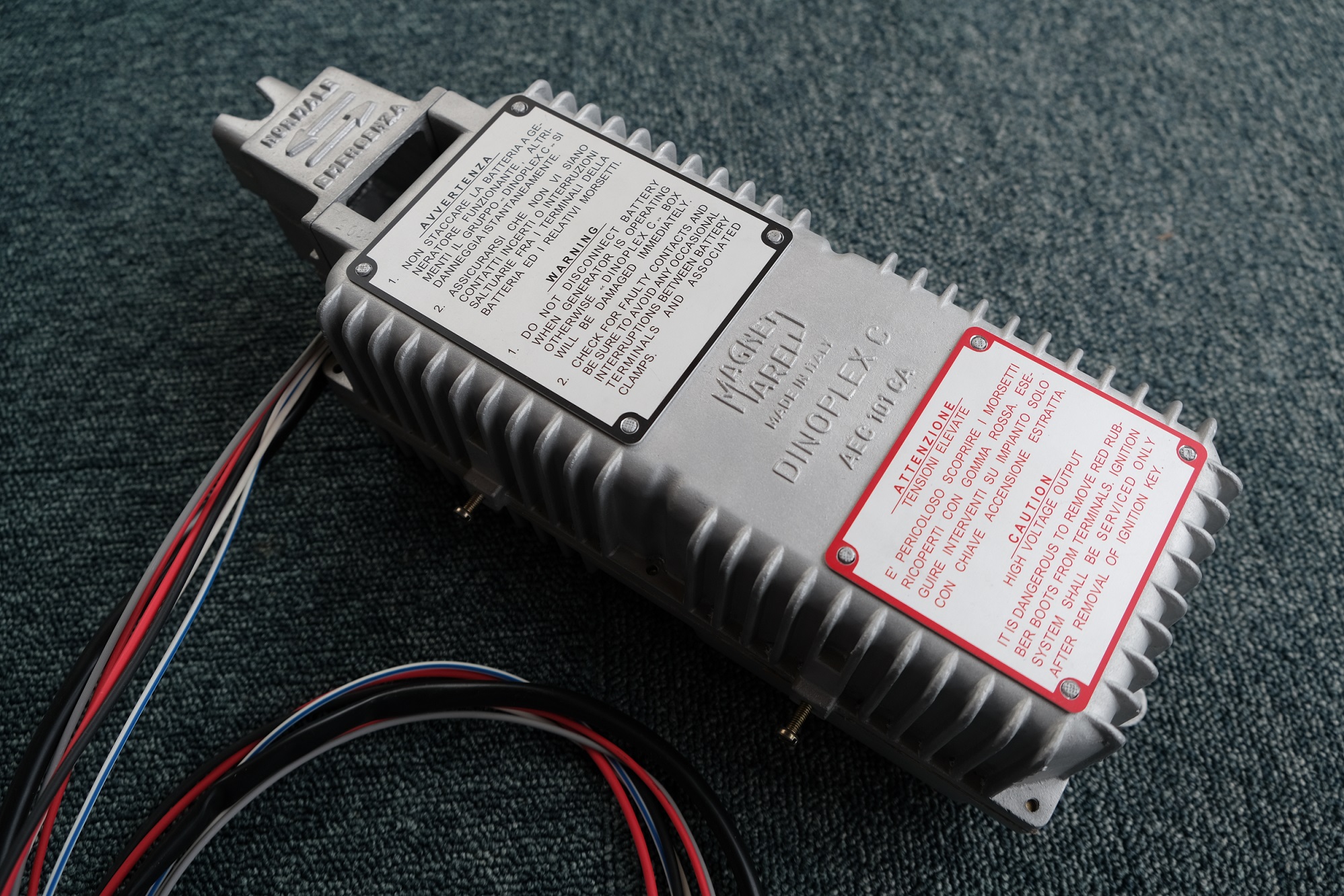

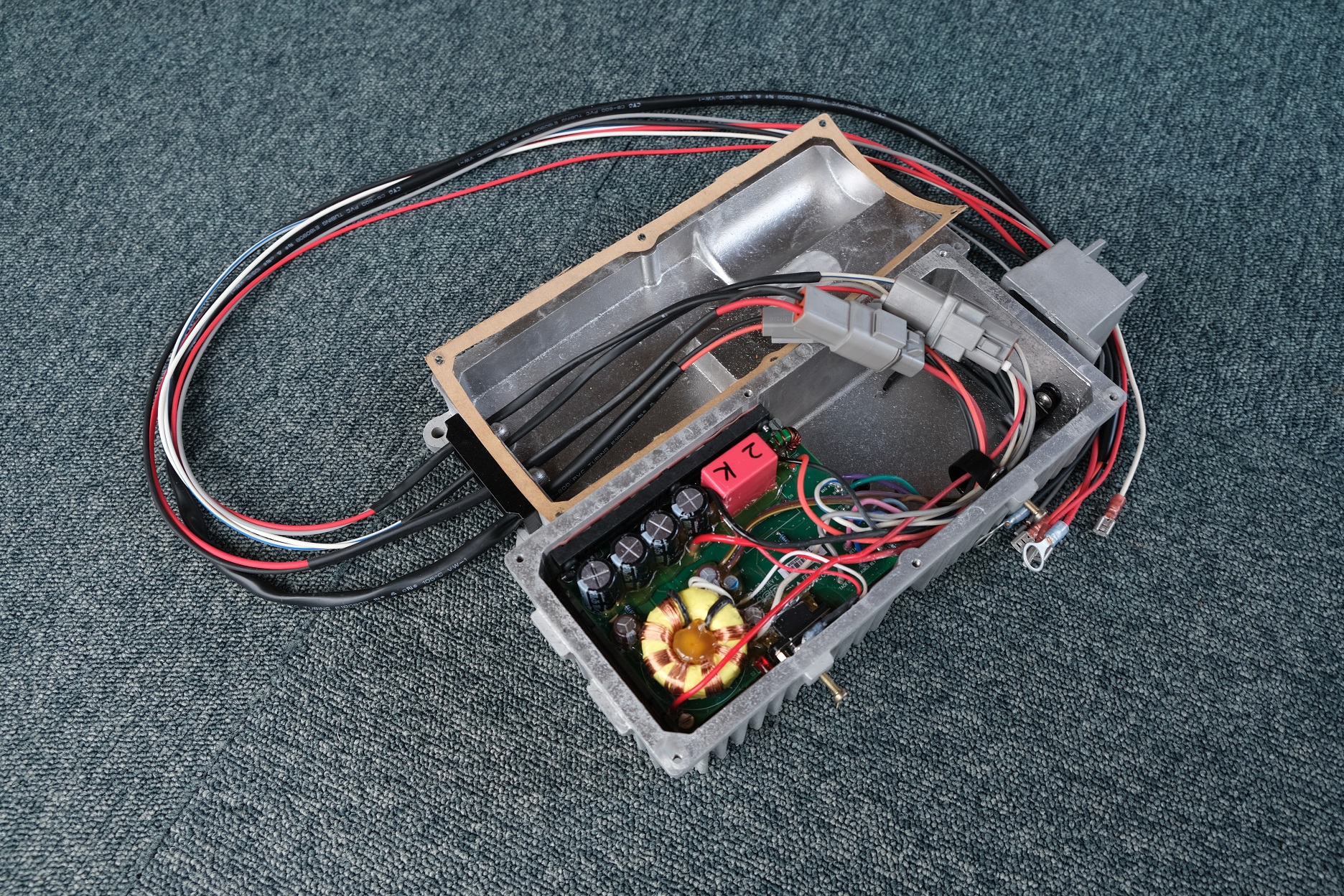

Having said that, I've been at the same point as you are now. I had a fully functional Dinoplex including coil in my Dino. I was just a bit scared that sooner or later my original coil or Dinoplex would die so i decided to remove it alltogether, put it in a box and stored it away in a safe place.
It's all together a long story, but in the end i re-manufactured new Dinoplex cases and installed a programmable MSD ignition system inside my 'repo' box.
Found a spare distributor housing, locked it out and converted it with a Luminition optical switch. Needed to make a triggerwheel etc etc but that was no big problem.
It looks 99,9% original, it has no points or mechanical advance system any more and it works flawlessly so far.
If this would be an interesting option for you just let me know and i can help you further with it.
						I think the preferable option is to keep everything original and make sure your distributor is in 100% top condition. I have never had any issues with points in my life, i did have problems with parts that caused points to wear, bad cam-profile surface, no grease on the cam what so ever, wrong condensers and most of all wrong repo parts.
I'll go of the deep end if i start about what junk parts i received for Dino distributors over the last little while, you simply have to test and measure every parts yourself and without a distributor test machine it is a no go to rebuild these distributors with the available parts.

There is an engine builder just around the block from my place and they happened to rebuild around 15 Dino Engines over the last 2 years or so. Because i have a distributor machine they asked me to do all the ignition systems. Most of them i just rebuild to stock with Dinoplex etc.etc. The thing is, from all the engines not 1 distributor was still in reasonable condition. From most of them basically every part was worn. If you need everything (this includes cup-base) it will easily be over €1000,- alone in parts to rebuild a distributor. And that is when all the parts you receive are good quality parts (not). I had to made half of the parts available myself again and than it is even more expensive because of low Qty.
From that perspective it get's quite interesting to move over to a programmable MSD. This because unregardless of the condition of your distributor you can use it anyway, you can just use all the 'worn' parts and just lock it out....no problem there.
