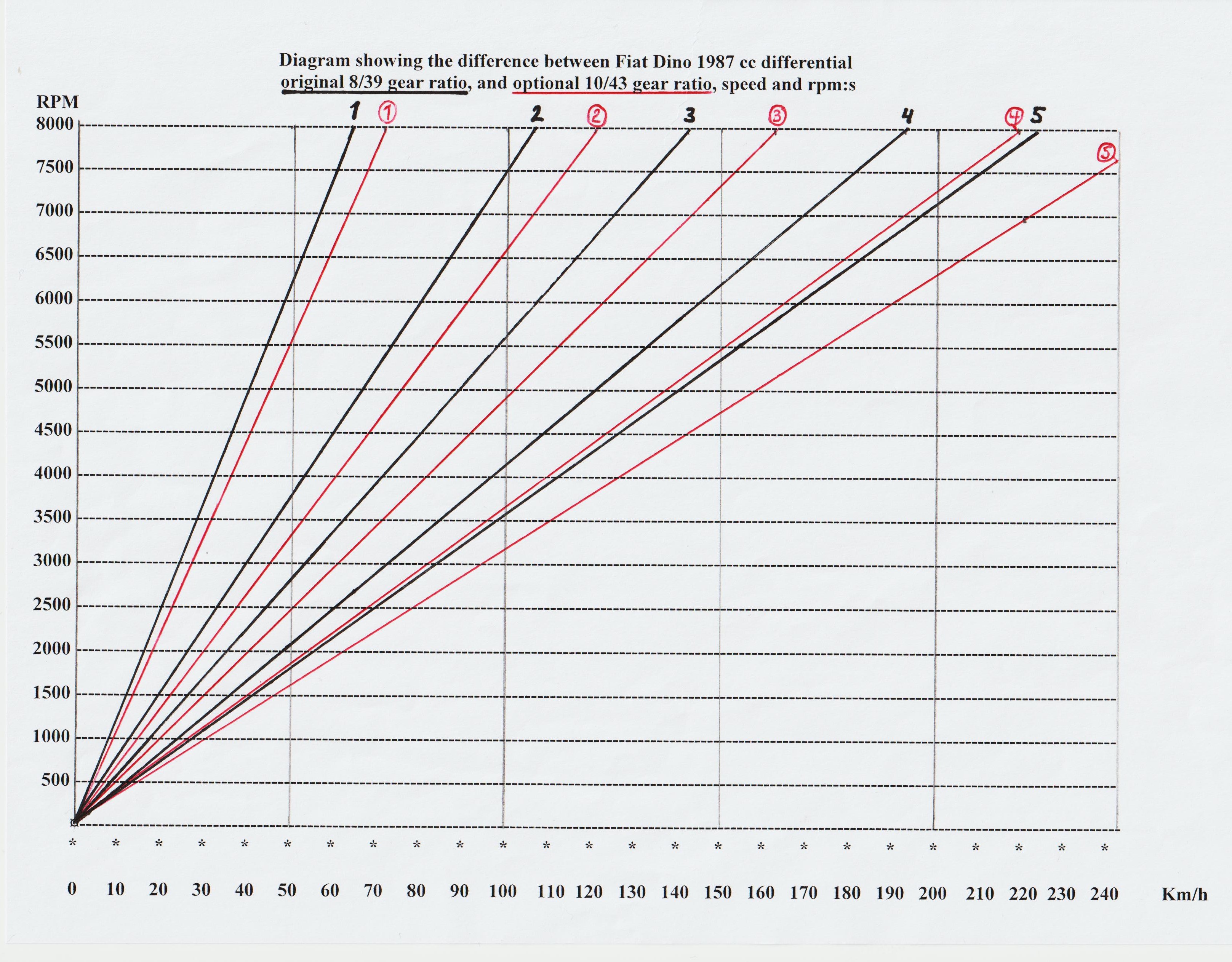

This raises the speed with around 13,3 %, at given engine rpm, in all gears. (The ZF "long 5:th gear"
raises the speed with around 9,5 %, at given engine rpm - but in 5:th gear only, of course.)
At first, I was concerned the lower gears would be all "too high" - too much affected. Fortunately, I
soon realized that the lowest gear always is the least affected, when changing the final gearing - and
vice versa. For the detailed outcome - see the diagram table below.
BLACK lines = 8:39 RED lines = 10:43
When driving in 1:st or 2:nd gear, you probably will not notice any changes at all. An up-change to 3:rd,
and you will notice it is "a little longer". 4:th gear now is very close to the original 5:th, and the 5:th
gear now has become the overdrive 5:th you always have been missing...
The engine handles all this effortless. Personally, I can´t understand why FIAT did not choose this (or a
similar) gear ratio for the Dinos. The car´s 0-100 Km/h performance seems unaltered, as you now can
reach 100 Km/h without a second gear change up to 3:rd gear. See the diagram table.
Top speed? I have not been able testing it, but it ought to be in the 210 - 220 Km/h range. The main
enemy here is the air resistance - when you double the speed, the air resistance goes up by four times!

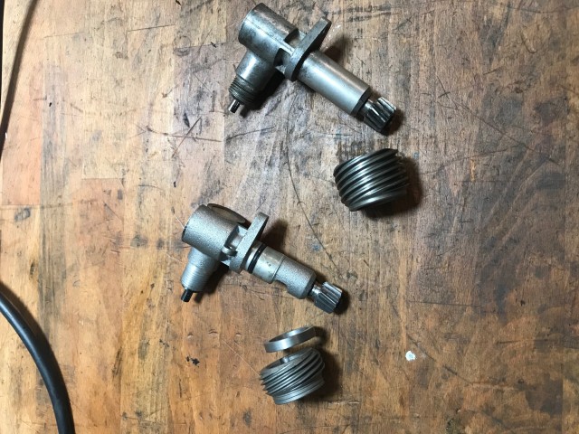

The last step in this project was a re-calibration of the speedometer. This demands some special tools,
so I turned to a local car instrument shop, to have this properly done.

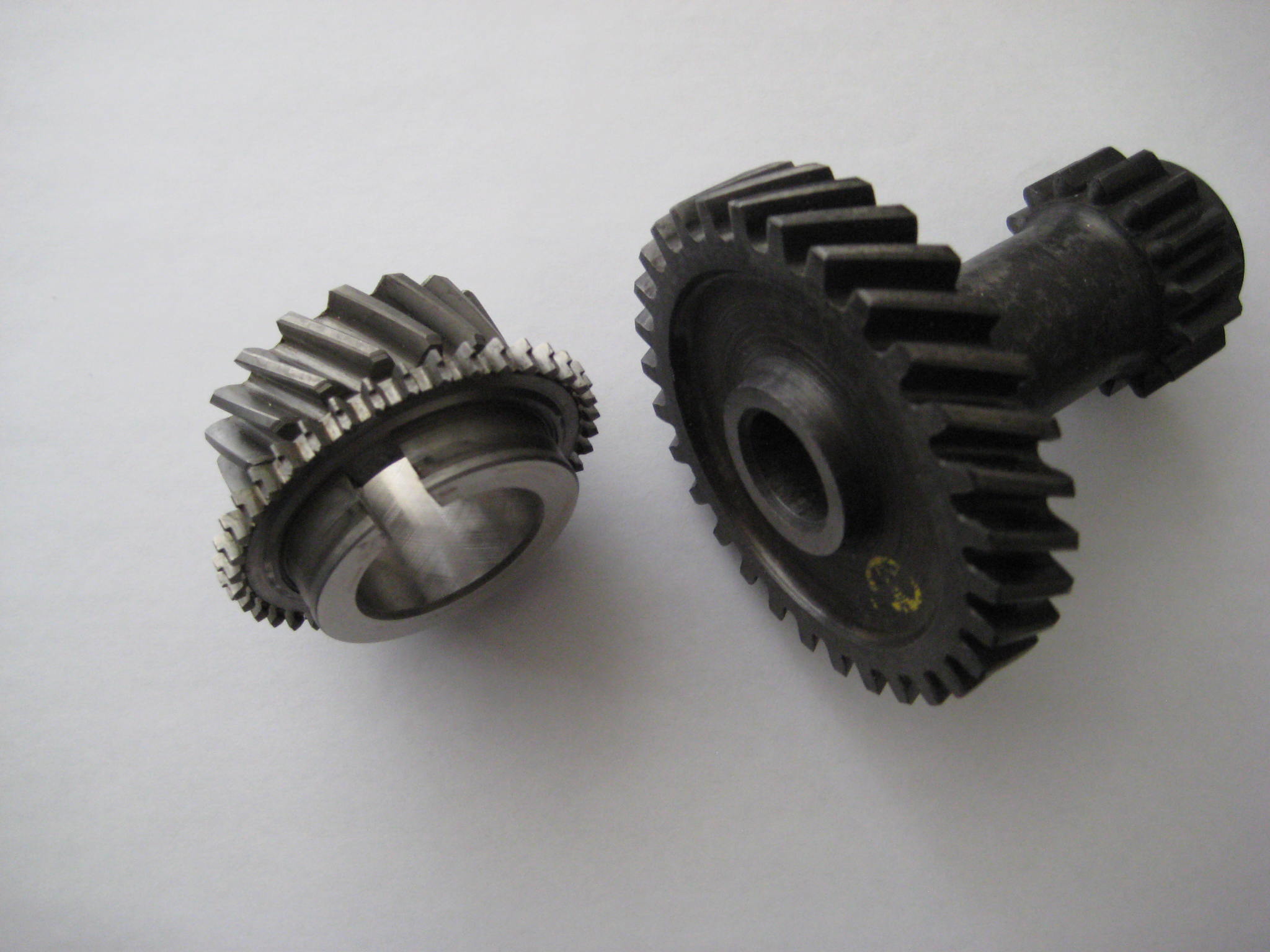

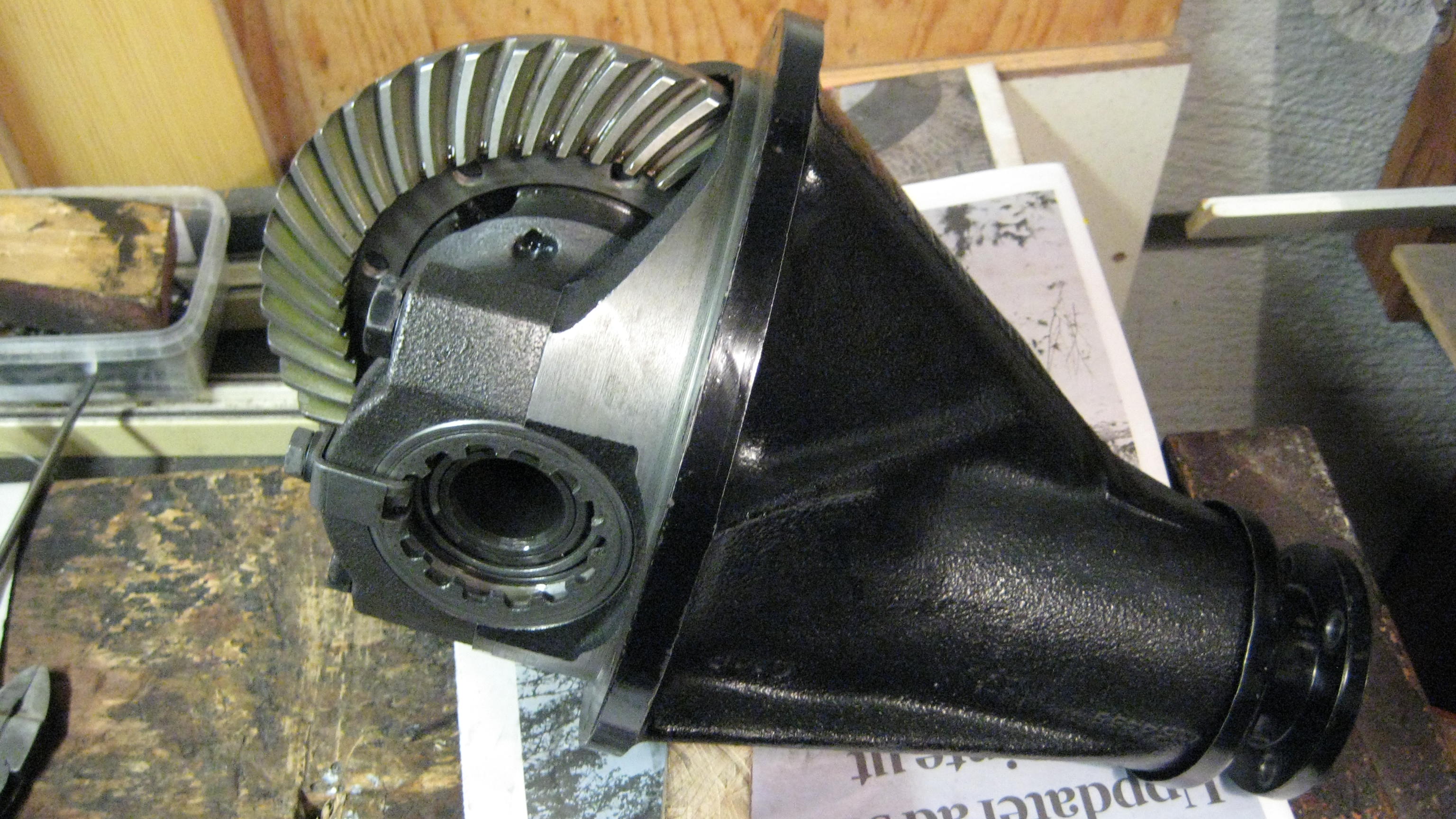

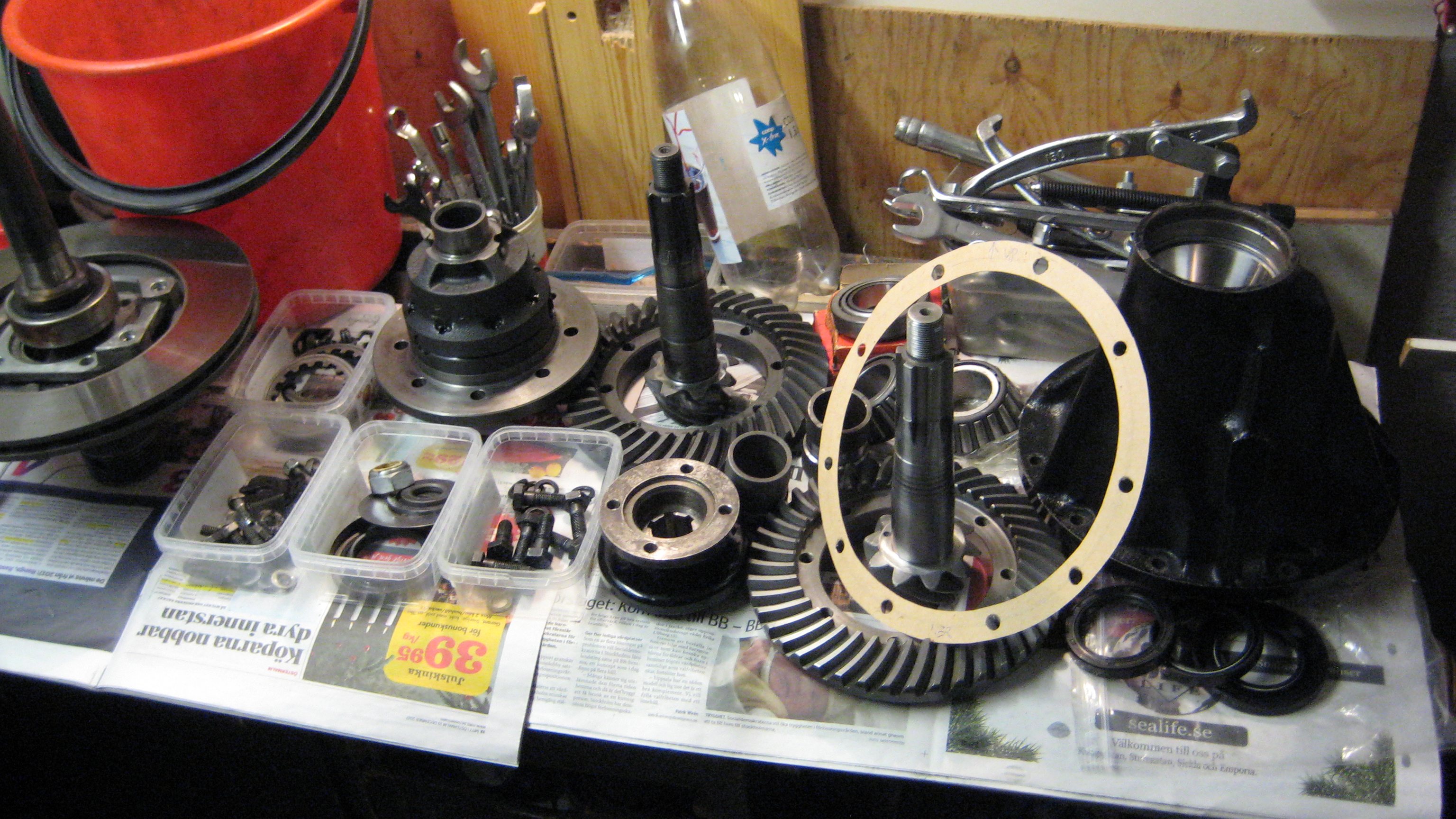

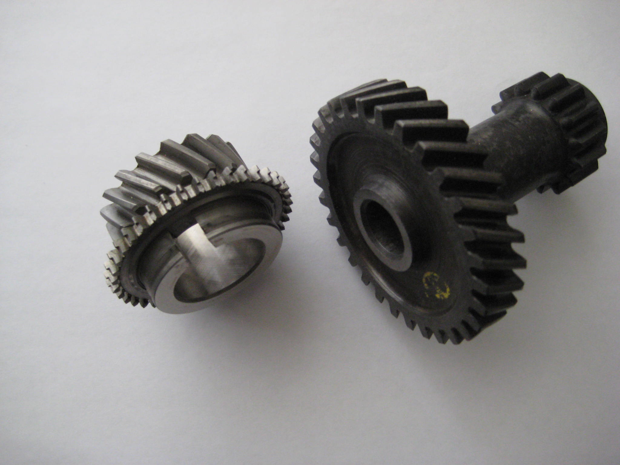

This project actually started with a search for a machining shop, competent enough to be able fabricating
new gear wheels with a higher gearing, for the 5:th gear. (It is a complicated process making new gears for
the 2 Litre Dino gearbox, as the actual gears also include many synchromesh details and reverse gear in
the same design.) See picture below.
Eventually, I found one company with the right skills and machinery, but they wanted 8000 EUR for one set...
It was then I started thinking about a change of the rear axle ratio, instead.

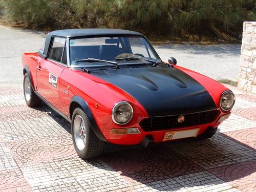

After a lot of research, I finally identified a few different old FIAT cars, using different parts from the same
"rear axle assortment" as the 2 Litre Dino. The only car using a suitible ratio (10:43), that also would fit the
rear axle of a 2 Litre Fiat Dino, is the Fiat 124 CSA.
This car has its own IRS, but the ring & pinion gears have the same dimensions as the original Dino parts.
A major problem here is, 124 CSA was built in just over 1000 units between 1972 and 1974, and after all
years, not many spare parts are availible.

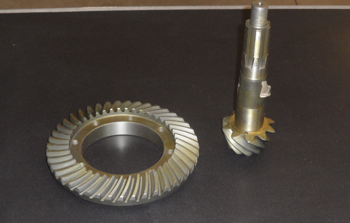

So, the challenge was finding a remaining 10:43 gear set (Fiat no 4154471). The internet sometimes is a
blessing, and I was happy to find a new gear set, after have been searching for a long time!
(For the 124 CSA racers, there were both 7:43 and 8:43 rear axle ratios availible, but these are - obviously -
of no interest for Dino owners.)
