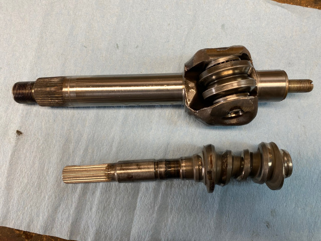

I had my 2400 Coupe raised today and decided to look into the "notchy" steering I had felt on the last drive. Turning the steering wheel there was a definite "detent" just right of center - and and another bad one to the right of that. Further away from center it felt much better.
Therefore Idisconnected the pitman-arm from the steering linkages to see how that felt and that was much worse, the mass of all the linkages etc mitigated the notches. It kind of felt like the 2 x UJs in the steering column were phased badly or something - therefore I lowered the column, removed the intermediate column with its UJs so now I can feel he raw input shaft of the steering box and...oh man, it felt really bad.
So I took the box out and put it in the vice. Pretty bad, 2 seriously bad notches/detents. But at least now I can get to the adjuster on top (it's under a sheetmetal join inside the wheelarch and hard to get at on the car). Backing off the adjuster and the notches feel much better - then tightening to just remove all play at the center and it doesn't feel great (rougher at center and slight notches, smooth at each end) but better.
It's almost as though it's tightened up over time. I've owned the car since 2011 and never touched the top adjuster. The box is full of clean looking oil and no sign of leaks at the bottom.
How to proceed? I don't know of anybody who can rebuild these or supply new parts - does anybody know? Plus I don't believe other Fiat boxes (eg 132, 125 etc) fit or have interchangeable parts. I think adjusting the box "looser" will improve the steering feel, but really I think the box needs more drastic action.

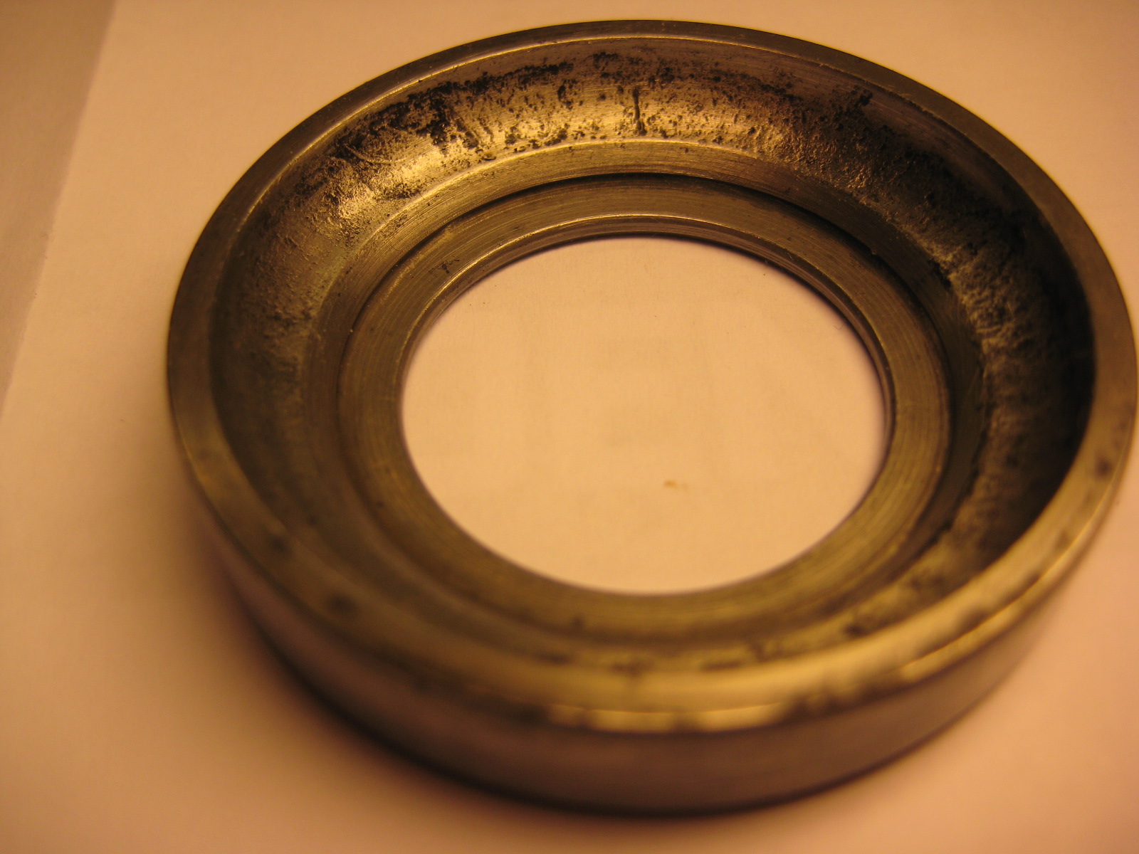

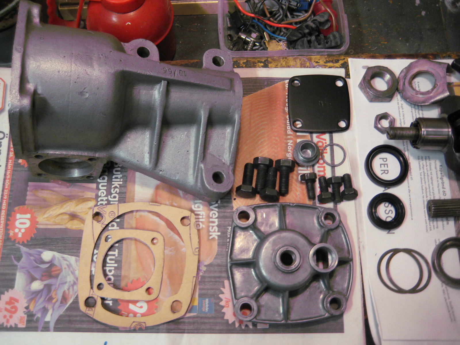

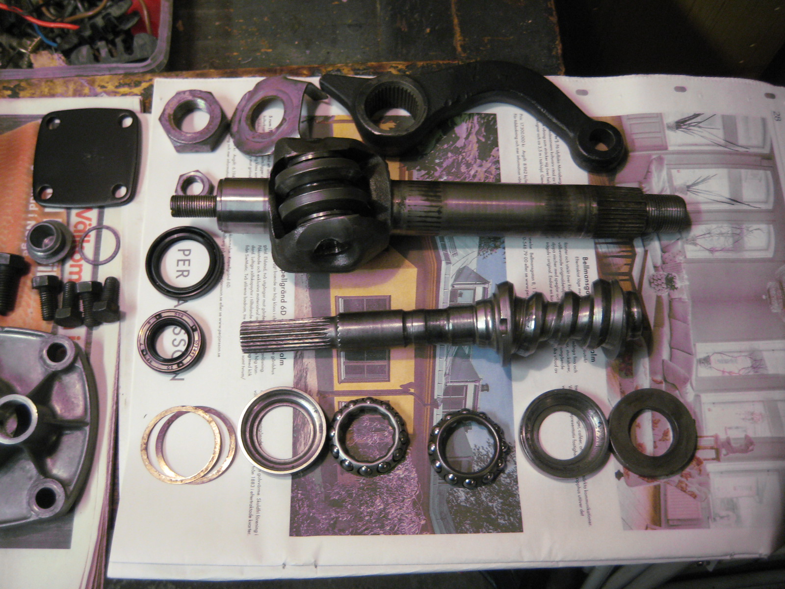

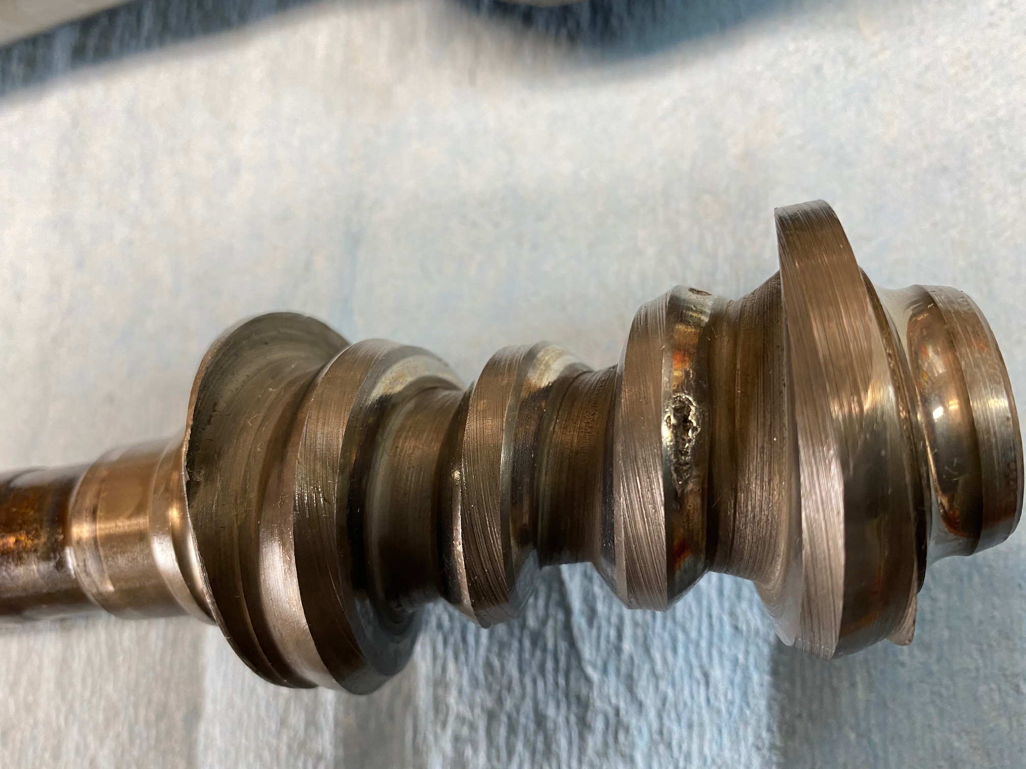

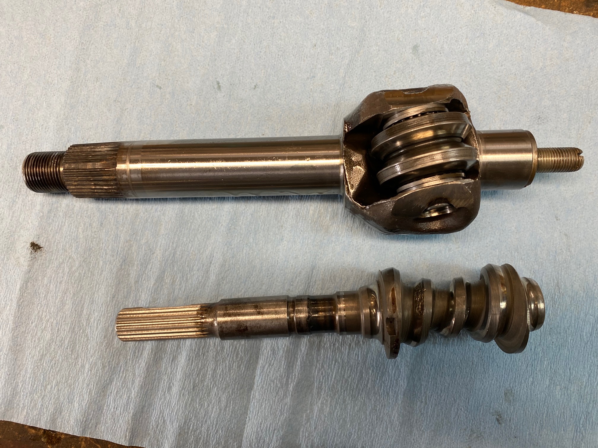

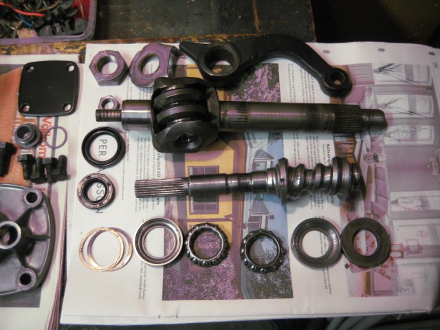

Having overhauled a Gemmer/Dino steering box last year, I can confirm it is hard finding parts for it.
The worm-shaft bearing "ball-cages" and the oil sealings are availible, but that´s it.
Concerning the corresponding "bearing outer rings", I have some indications Gemmer actually changed
dimensions slightly during the production run.
The steering box I overhauled, had different outer diameters for these two bearing outer rings -
47,3 mm and 46,2 mm. The casing was stamped "10/66" so I guess this example was a very early
one.
In the Spare parts Catalogue, page D2.02, only one of these rings is shown - no 9917590 - but I
never found it, so I had the corresponding Fiat 238 spare part no 9917603 grinded down to correct
measurements.

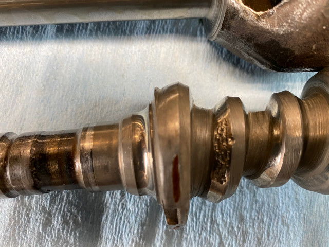

Unfortunately, it seems the worm-shaft bearings often are in bad shape, and need to be replaced.
If so, you will feel it when turning the worm-shaft by hand - it is often binding, or shows signs of side-
or end-play.

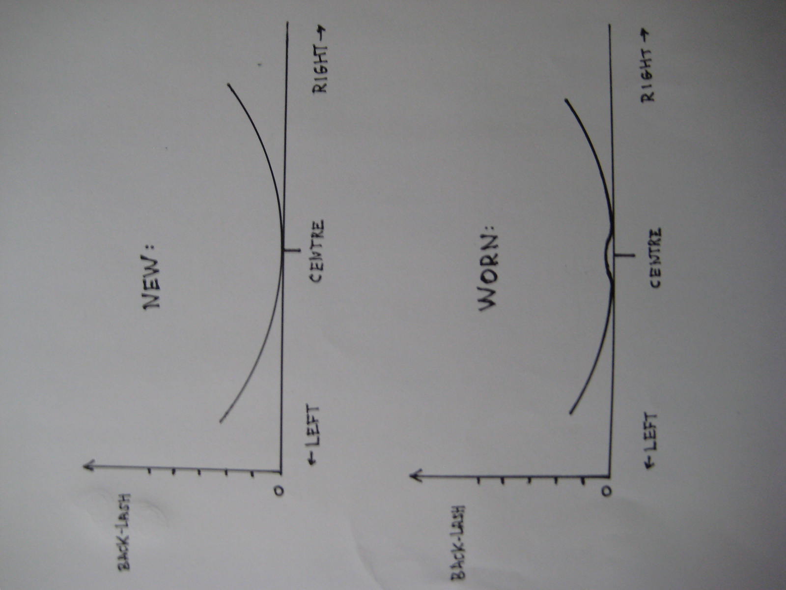

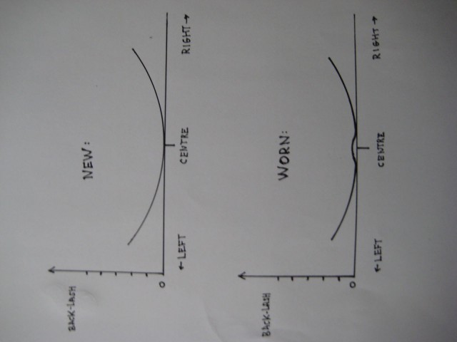

All steering boxes of the worm-and-roller type share the same main problem - the contact surfaces
at the worm-shaft and the roller slowly wears, so the adjustment possibilities slowly disappear.
Below a simple graphic illustration over the problem. By time, a "crater" develops in the centre
position, and if adjusting that, you will get a growing binding effect just "outside" this position, in
both directions.

Great pictures and explanation, that's really helpful, thanks.
It does feel as though somebody tightened it to adjust for play at the "notch", so made it stick in the notch, like your drawing suggests.
I guess now I have it on the bench, I should open it and see what I find - replace the things that are actually replaceable and see if that improves it.

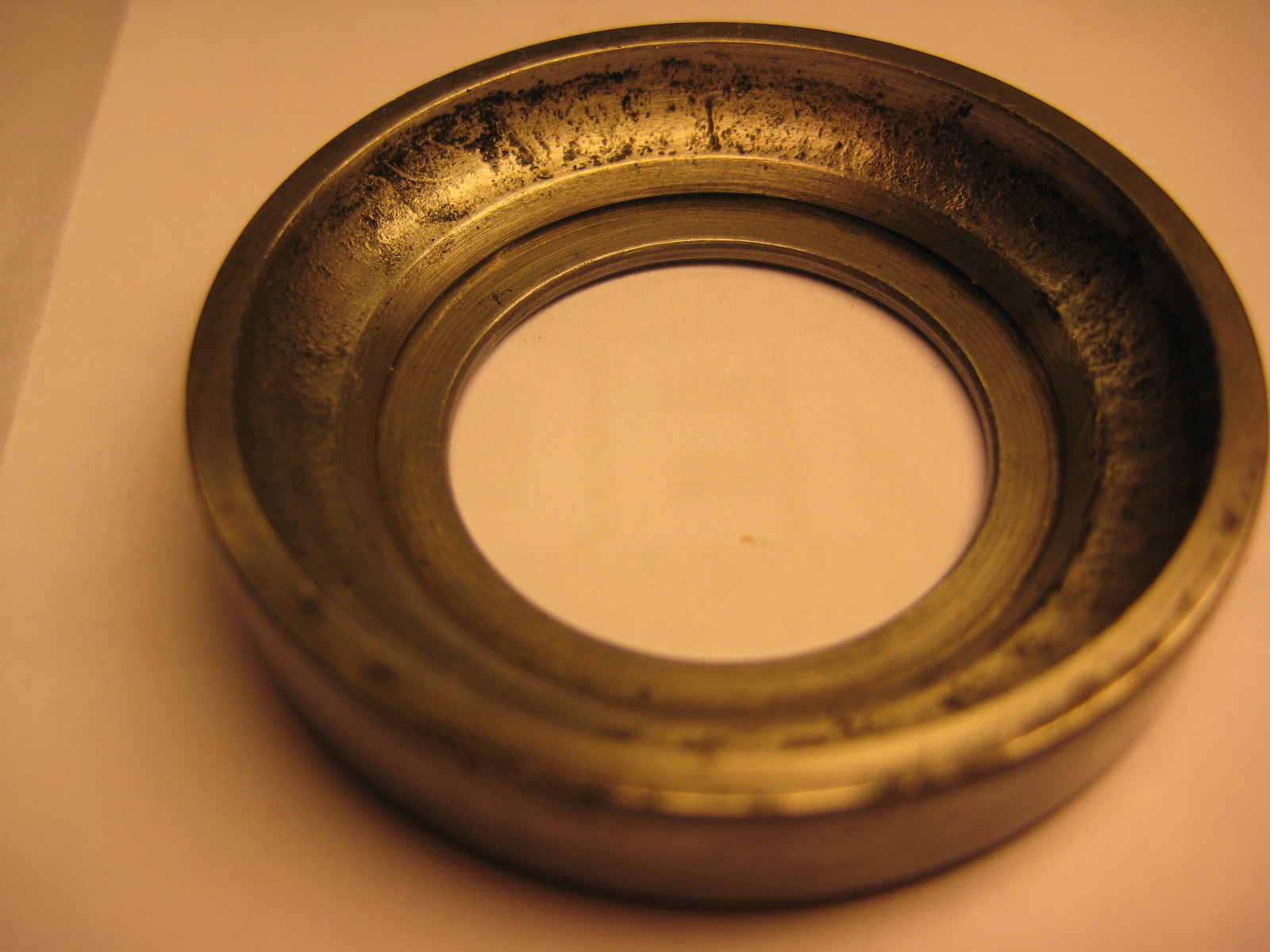

When looking at the Spare parts Catalogue page D2.02, DINOPARTS.de actually
has used wrong Fiat numbers in their parts list:
The LOWER bearing "outer race" is number 9917590, not 9916359 - which are
the two corresponding "ball-cages". It is said to measure 47 mm in outer diameter.
Probably it will fit most Dino/Gemmer steering boxes, but in the (probably) very
early steering box I overhauled recently, the lower bearing "outer race" had a
47,3 mm outer diameter! In that case, 47,0 mm would not work at all...
The HIGHER bearing "outer race" is not shown anywhere in the Spare parts Catalogues,
so it has never got a FIAT spare parts number!
I measured the outer diameter being 46,2 mm, but I am sure, the claimed 46,17 mm
outer diameter is spot on!
I wonder why Gemmer choose such odd bearing dimensions - standard bearing sizes
would have helped us a lot!
