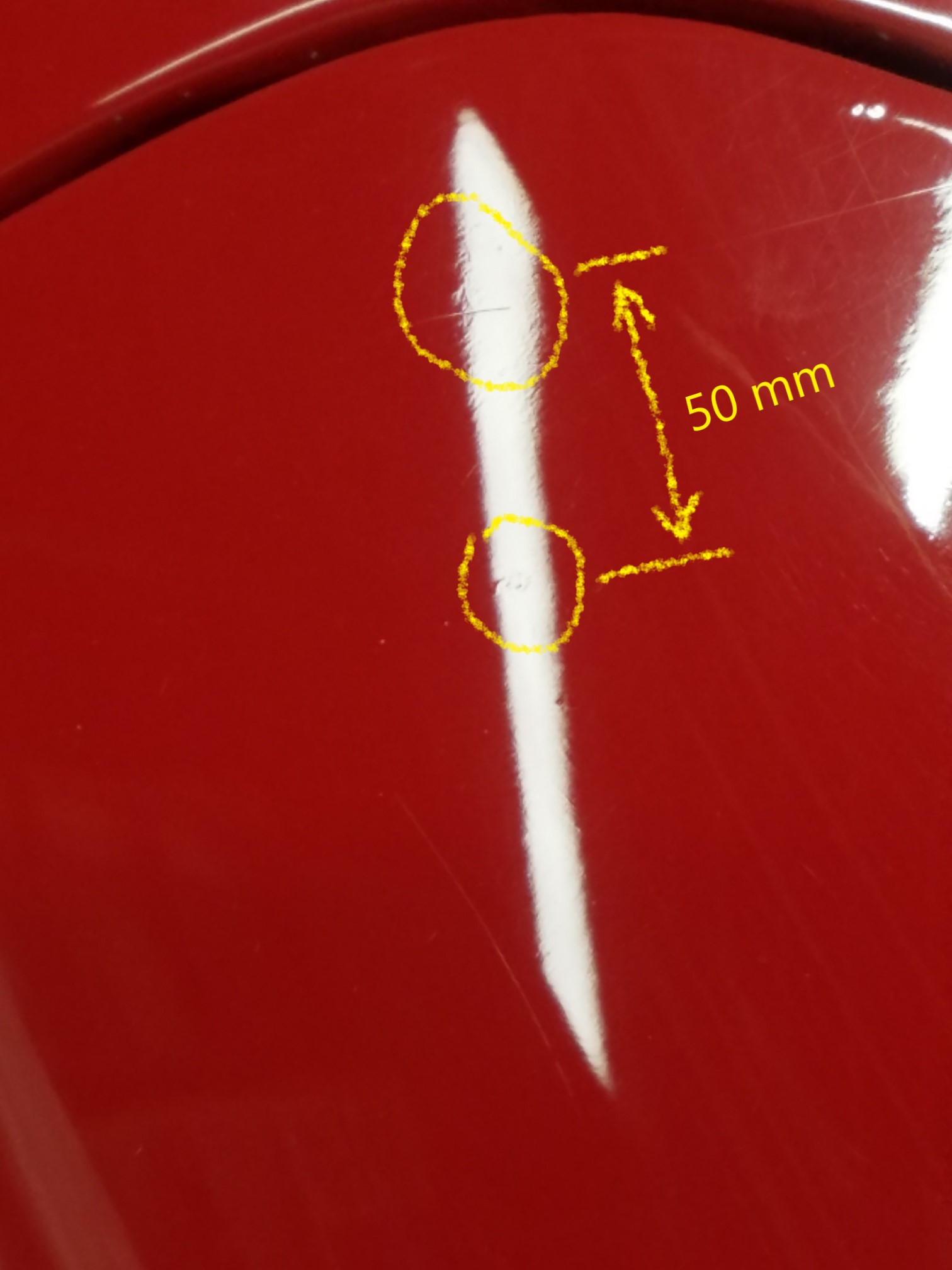

I am trying to source the correct driver side mirror for my 67 spider. As you know I just acquired the car about 2 months. It came without any side mirror. The last paint job had covered the existing holes. As I inspected the paint in the driver side door closely I can see clearly there are 2 holes about 50 mm apart. I was told Vitaloni mirror was the original equipment. I looked up Vitaloni and most come with 3 holes mirrors. Any advise? Also if anyone has some old stock mirror laying around and like to sell it I would be interested in it.

Thanks Tobi. It has a ROMA license plate so I assumed it was sold in Italy? Anyway after some research Sebring mirror has two mounting bolts. Was Sebring one of the choices besides Vitaloni?

As far as I have found out, all Fiat Dino Spiders had Sebring MK 1 rear
mirrors from factory, at the left door. And yes, it has two mounting bolts.

i cannot claim that the spiders were delivered with a side mirror(i believe they were as all brochures do show a mirror and all factory pictures do as well) . However the driver doors on the spiders had 2 nuts welded in place to receive the screws to mount the sebring mirror in the right location. The forward screw would go through the door sheet metal and come out the other side the upper left corner of the door to be secured on the other side by a nut..
Original sebring mirror were chromed steel. They are now reproduced in plastic..It is critical to get the right mirror as the base should have a slight pitch to compensate for the leaning position of the mirror ..

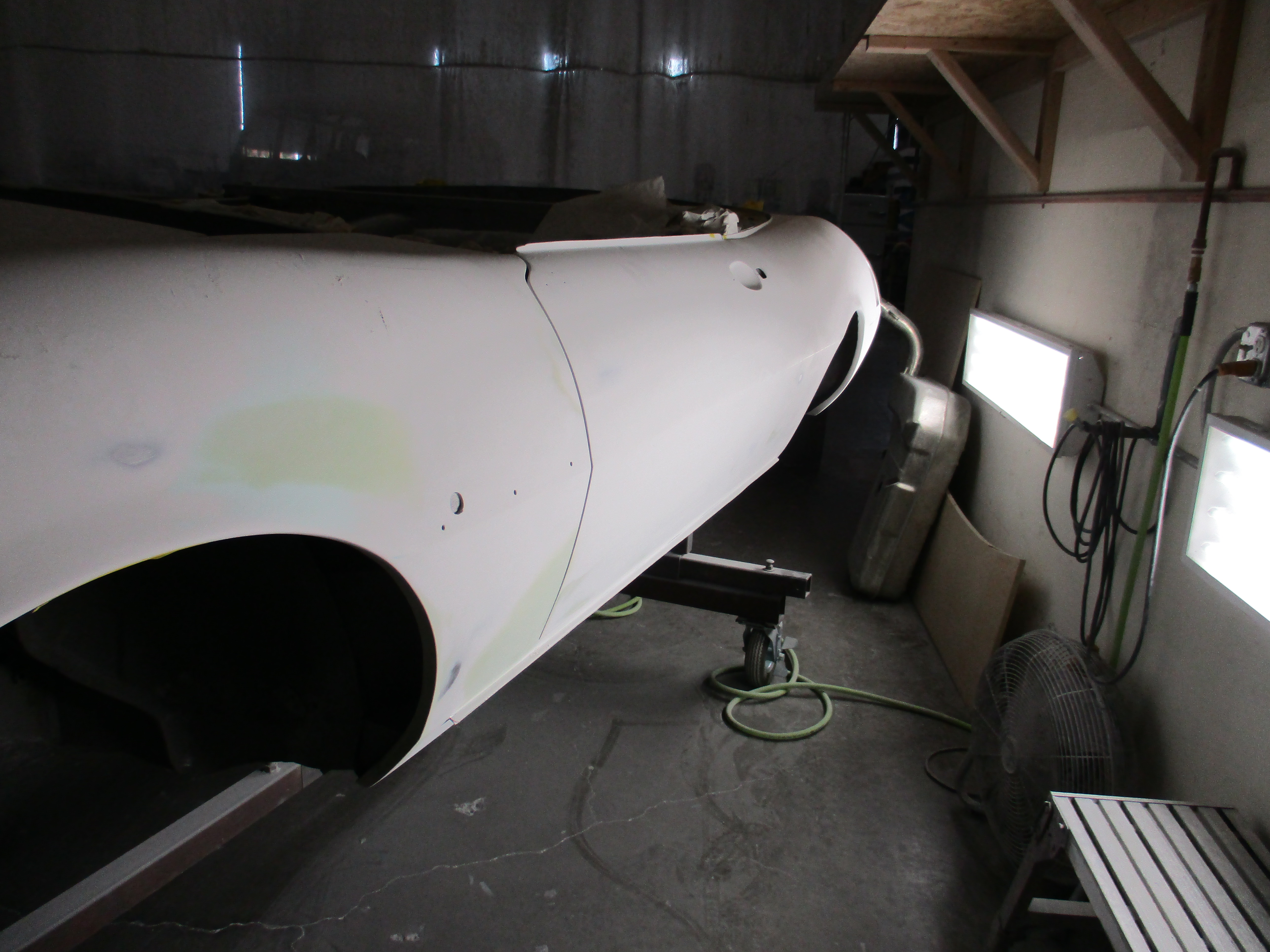

Re: Vitaloni side mirror
you can see from this picture the original mounting holes
