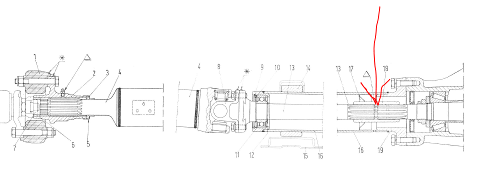

Hi guys,
I'm trying to get access to the coupler between the short driveshaft that is inside the torque tube and the differential. This:

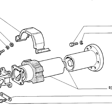

I removed all 8 bolts from where the tube attaches to the differential and disconnected it from the from driveshaft with the 4 bolts. I still can't remove the torque tube/driveshaft combination. How does one remove this to grease the splined coupler?
torque tube.PNG (19.11 KiB) Viewed 6731 times
Thanks in advance.
Luis

Post by Stefan2000 »
If the cardan shaft is removed you can remove the snap ring that secures the bearing in place. No need to remove the 8 bolts.
Than you can pull the complete shaft with bearing out using a slide hammer. Not much force is needed, it will slide out relatively easy.
When you have it out you can grease the splined shaft.
May i ask you why you want to grease it? There is no real movement between the parts there so there is hardly any reason to grease it. But that shaft is balanced so taking it out and putting it back in a different position might result in unwanted vibrations.
