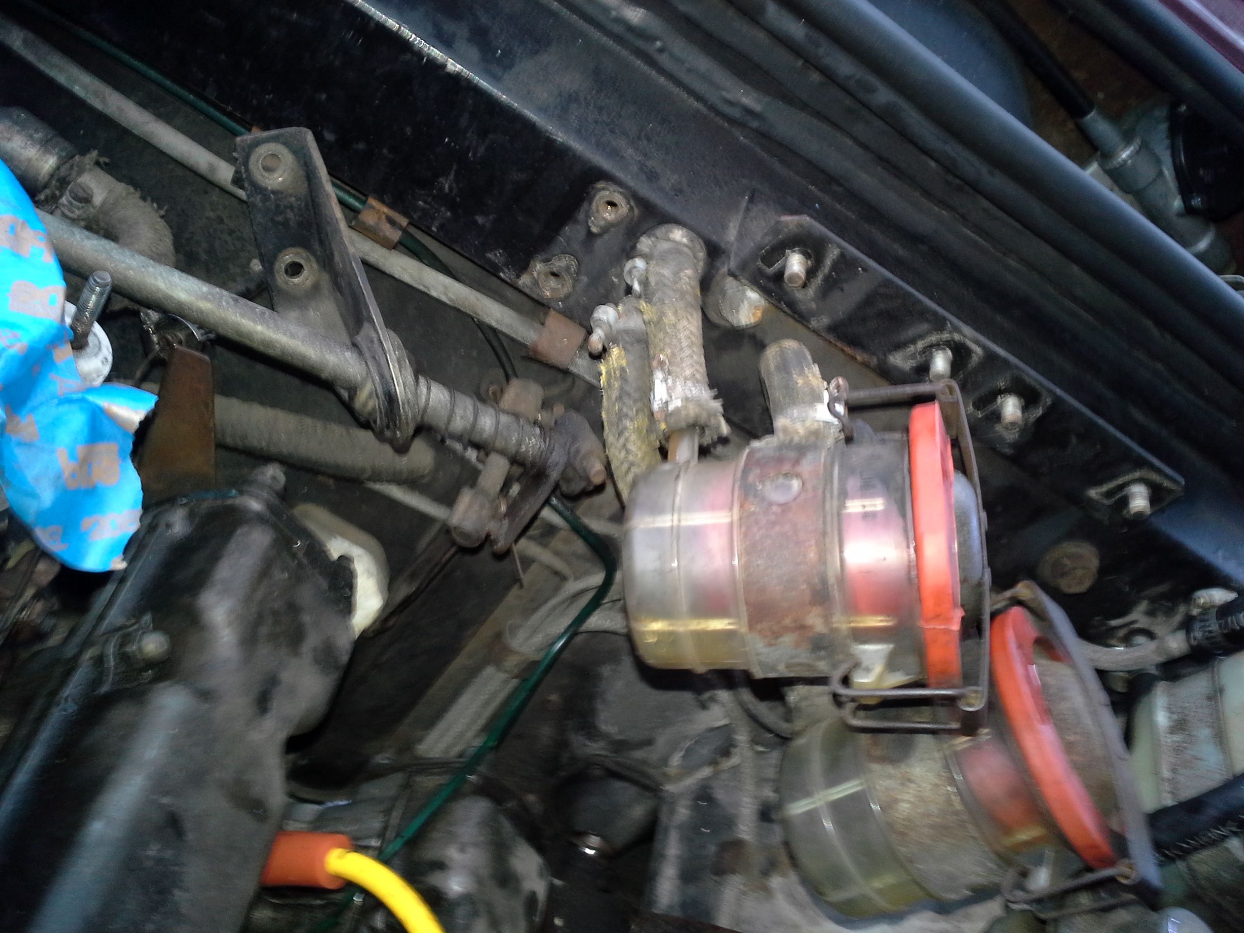

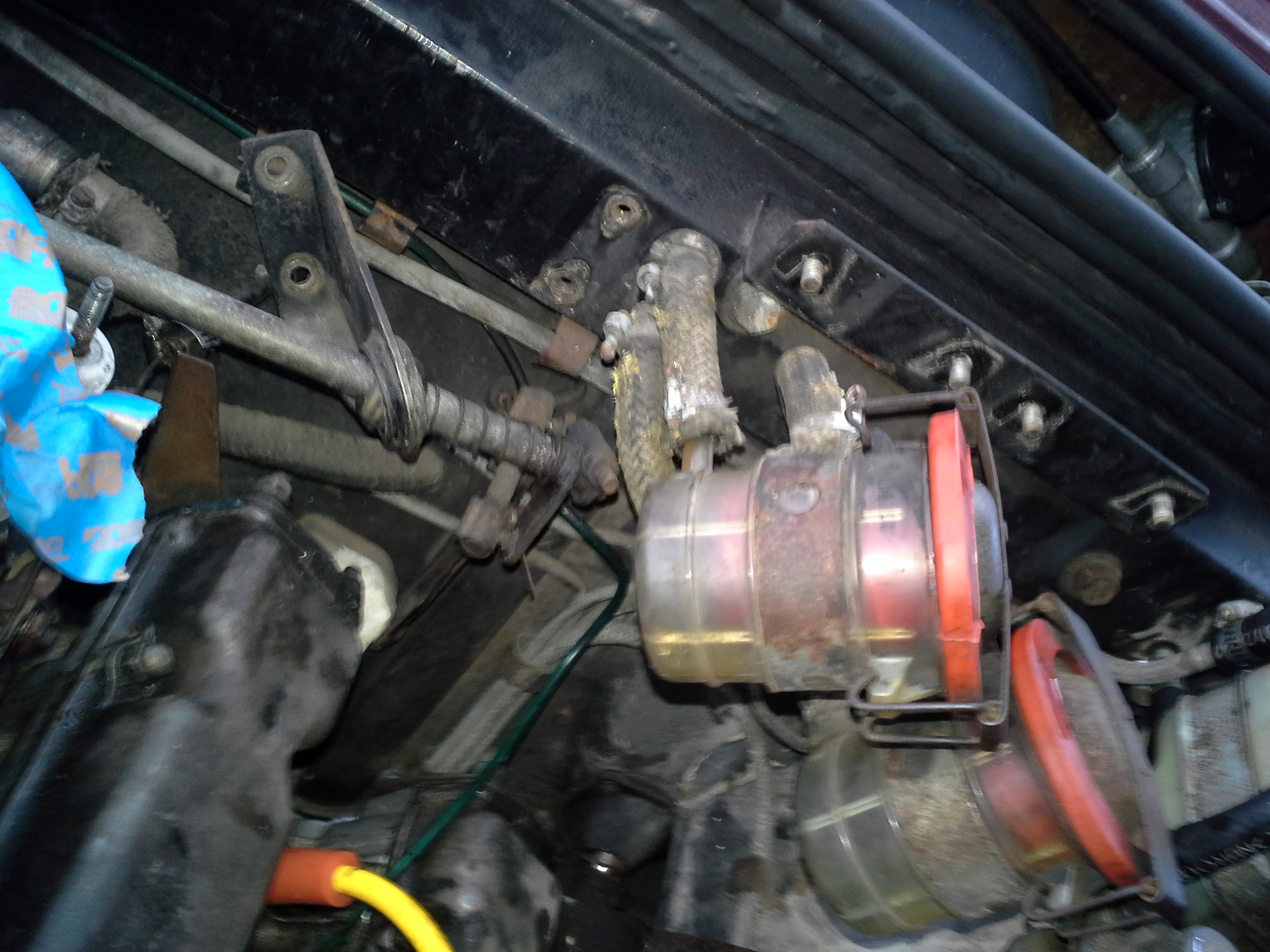

I have the round style brake master cylinder fluid reservoirs on my 1967 Dino coupe. There are some stress cracks visible in the plastic. They are not leaking, yet. I'm in the process of replacing the brake MC and hoses. I would like to replace the round plastic reservoirs but there does not appear to be any way to remove the metal bracket without cutting. Does anyone have a solution? I guess I could cut the metal bracket on the backside, slip out the old reservoir and slip in a new plastic reservoir. Has anyone successfully replaced the plastic reservoir without cutting the metal bracket?

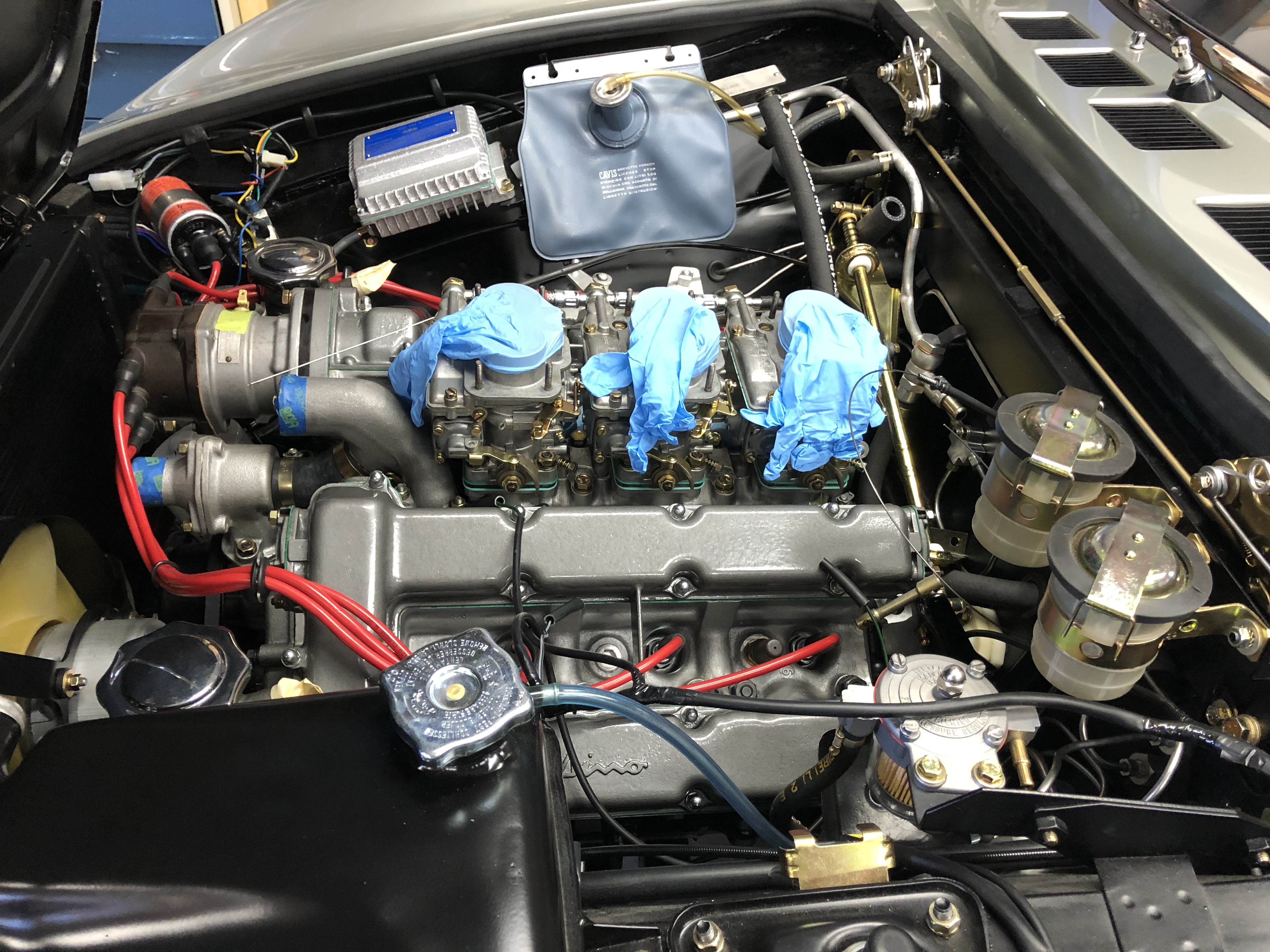

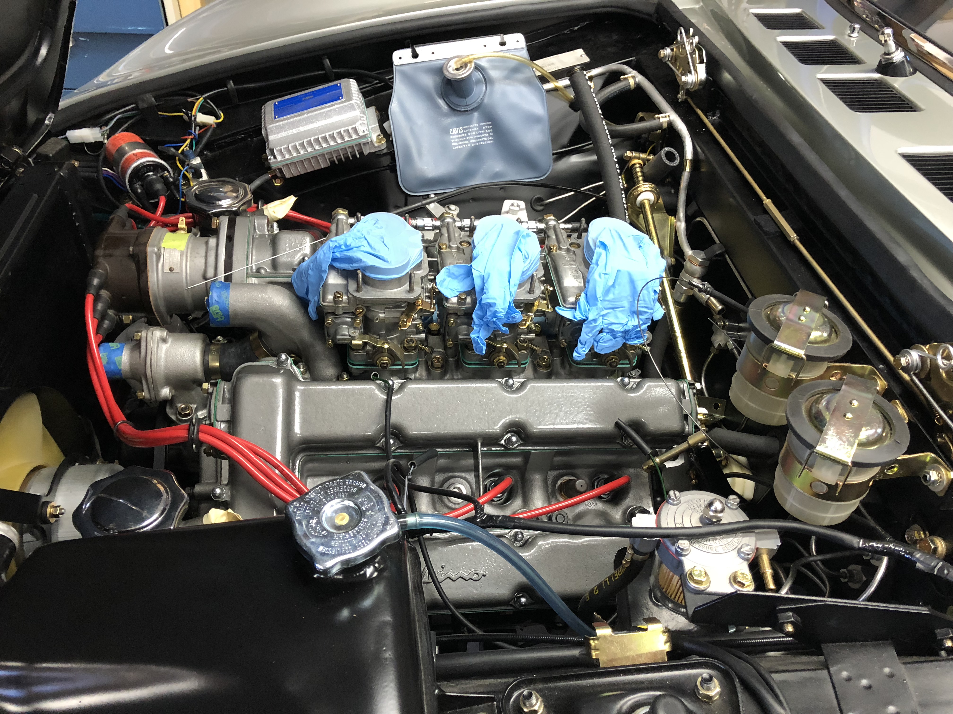

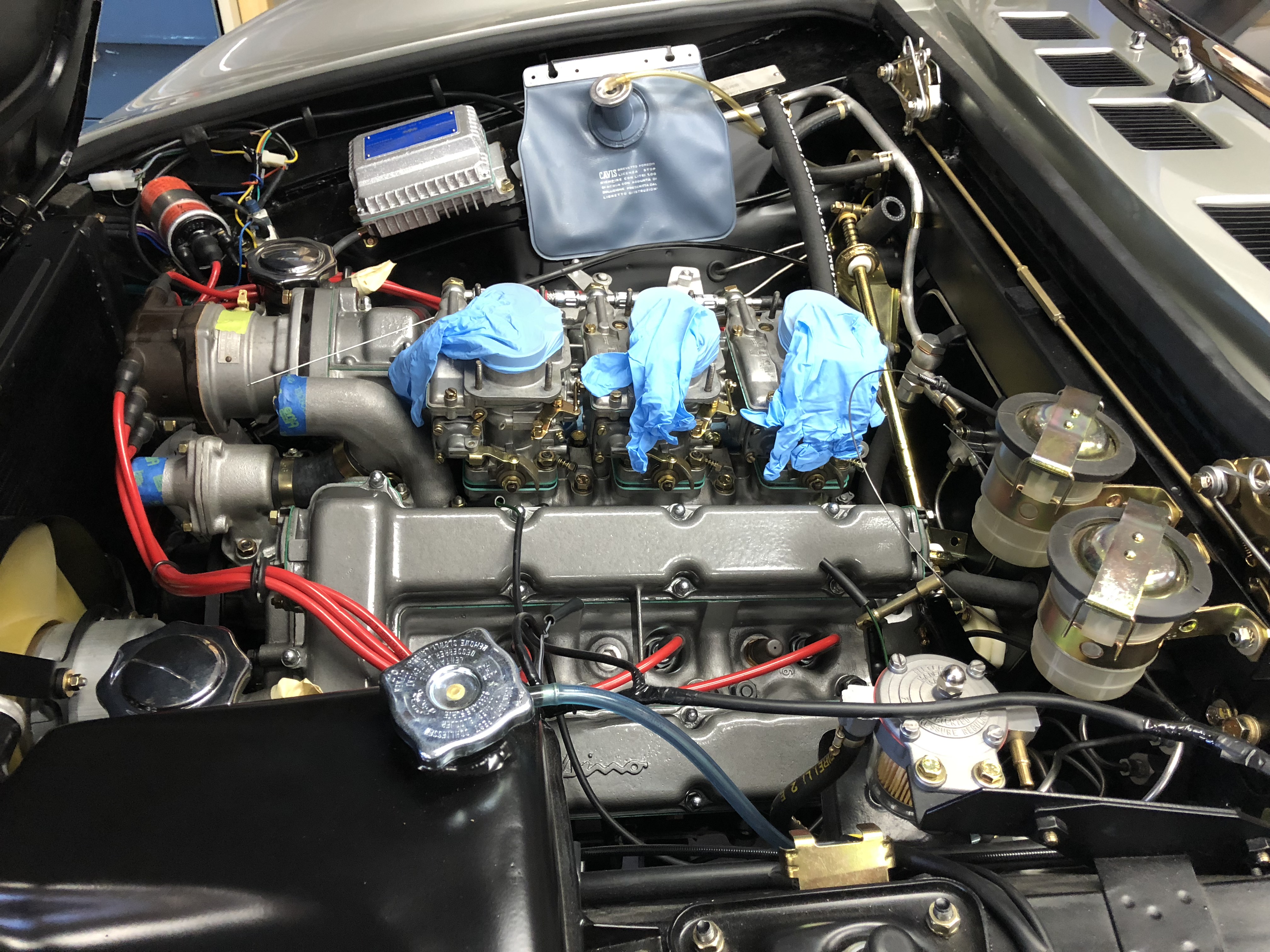

2.4 were yellow plated 2 liter were cad plated with the top plate black phosphates.. To remove the brakes from the brake fluid container you will have to
crimp one of the holes that close in the back of the outside metal circle.. Take your time and be gentle so you have metal left to crimp it back.. done it several time not a big deal..

Sure enough, the bracket holding the plastic reservoirs comes apart at the "rivet" holes on the back inside of the bracket. That is one fine looking engine compartment Herve. Thanks for the tip on separating the bracket from the plastic reservoir. Into the sandblaster they go. I see you have new plastic bushings on the throttle linkage. How did you get them into the sockets on the brackets?
