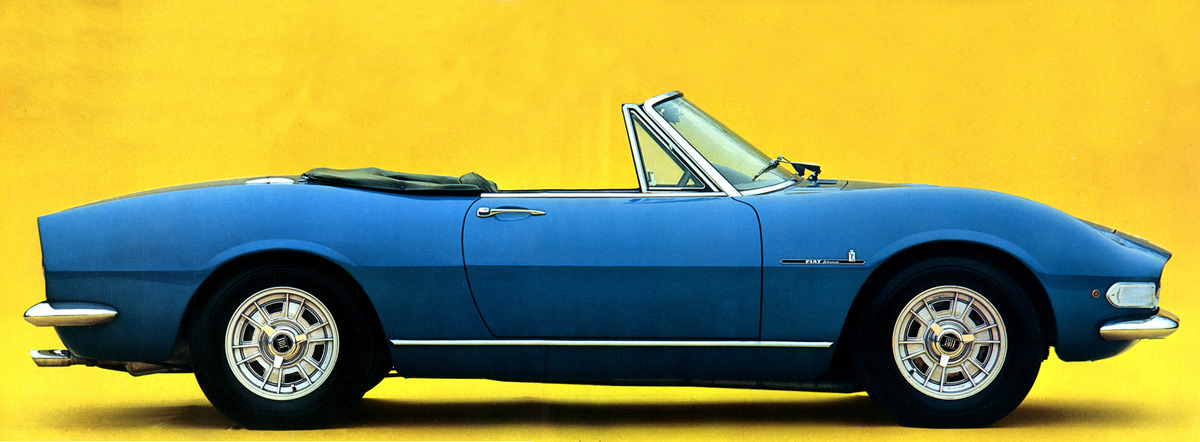

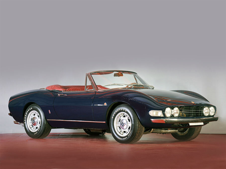

- Posts: 562
Re: ‘67 Spider build.
The direction indicators (not side markers) are different between 2000 and 2400 Spider.
The 2000 has them in front of the wheel on the fender: The 2400 has them behind the wheel on the fender intergated into the emblem:

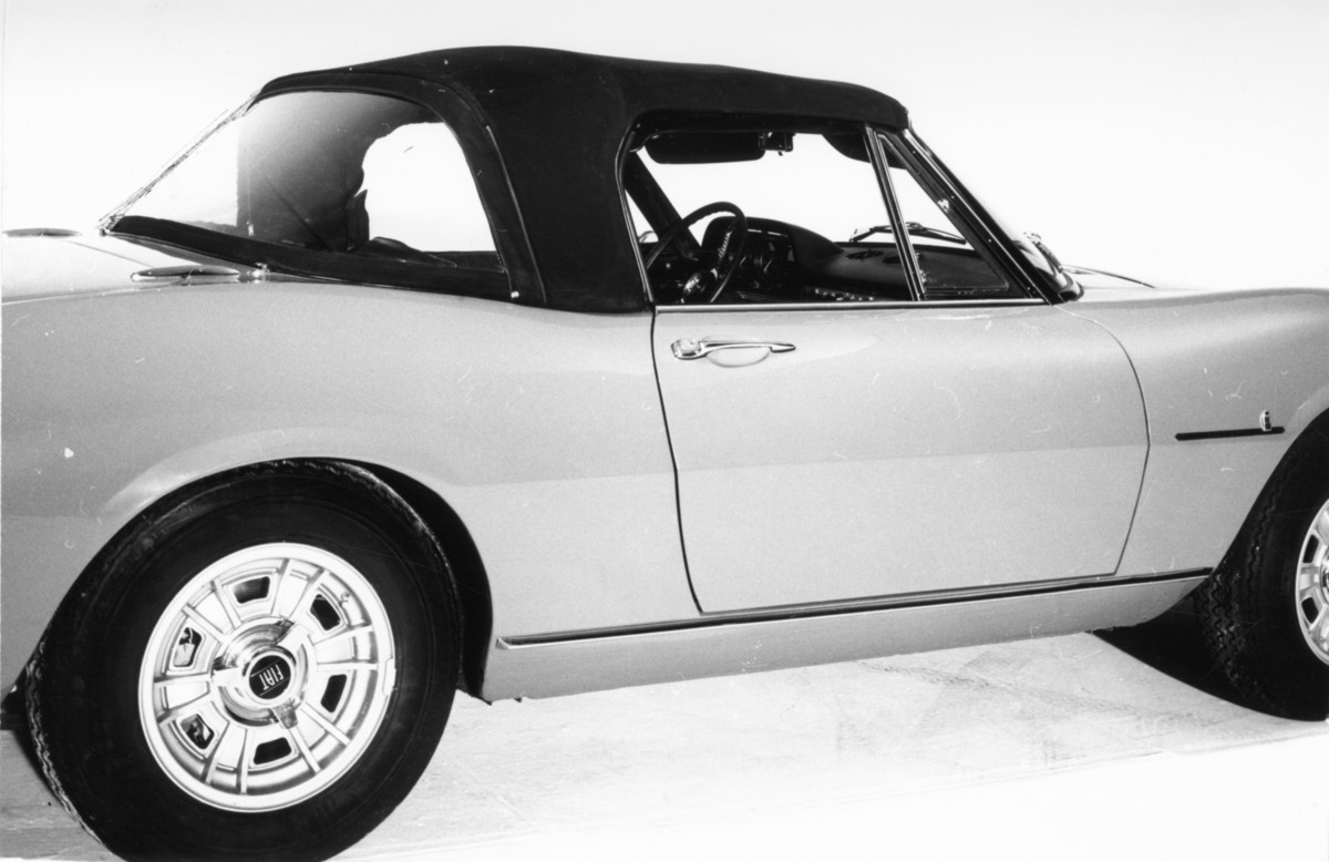

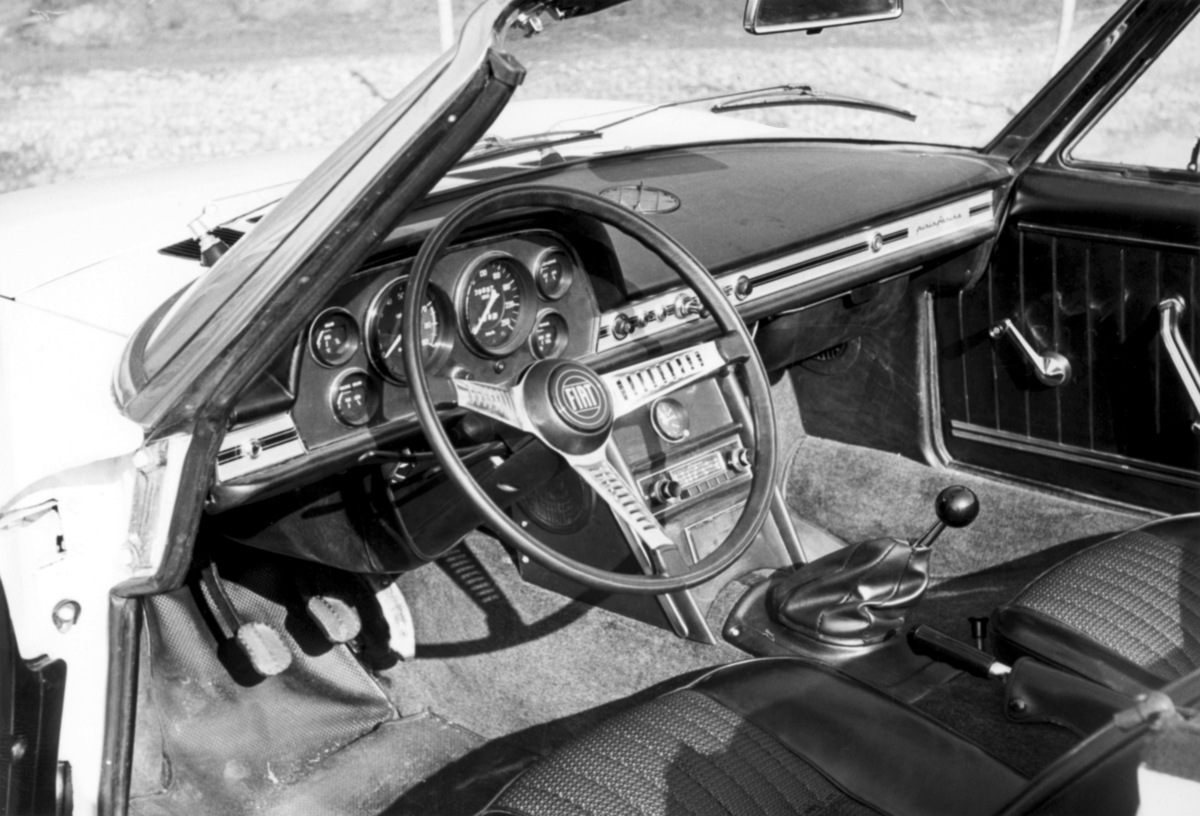

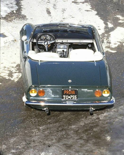

- Posts: 132

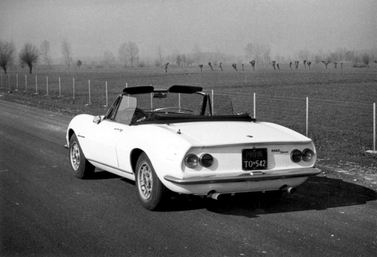

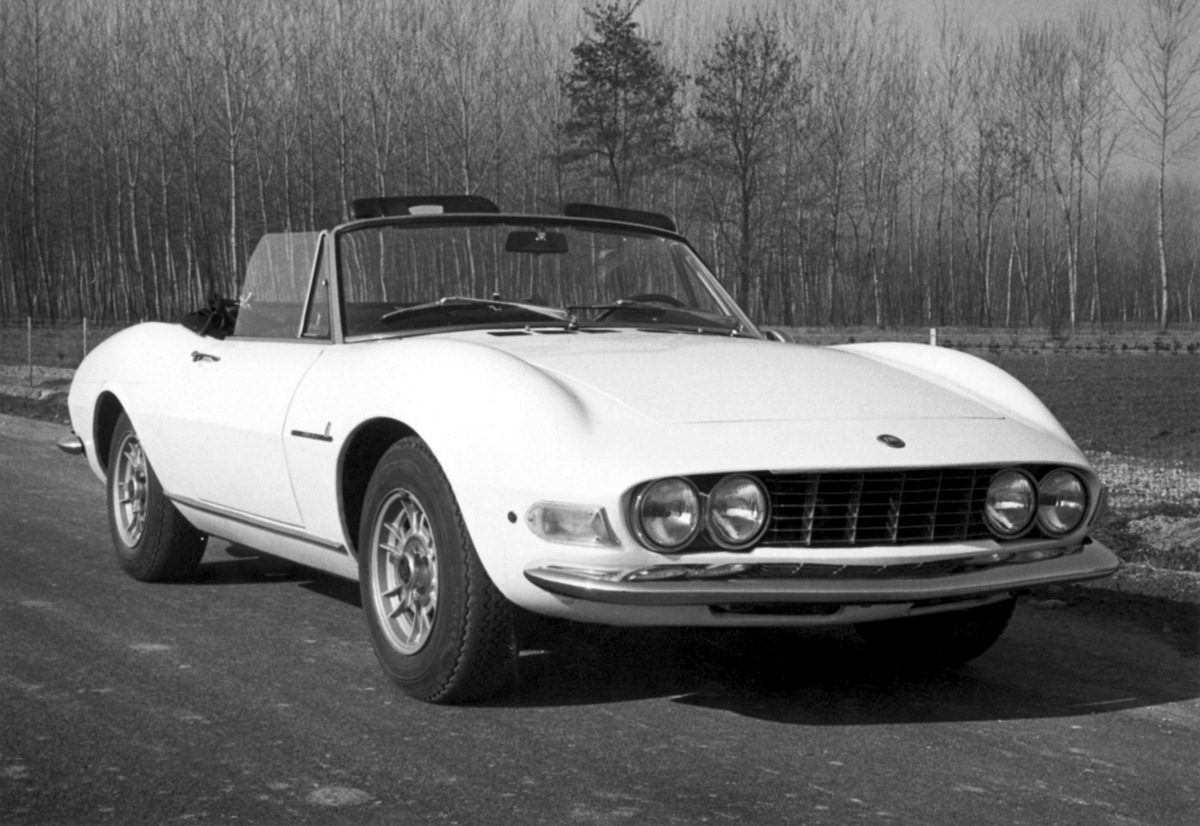

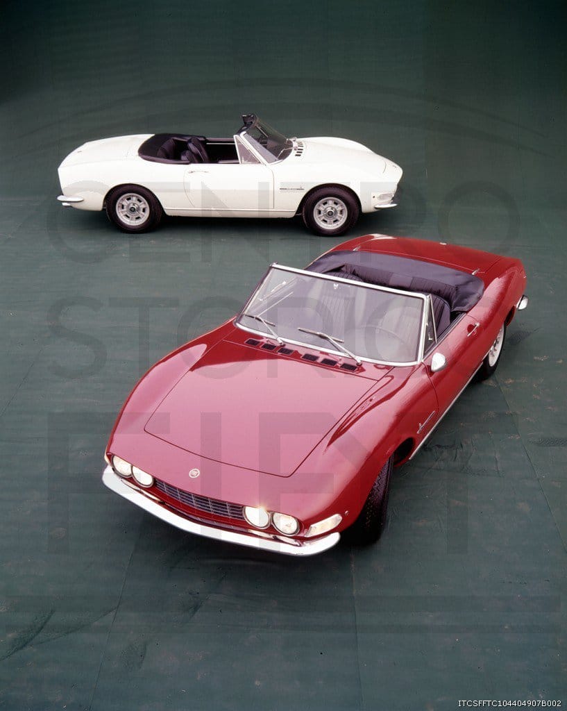

Here some more pictures of „Prima Serie“ spiders (the first 500 spiders for Formula 2 engine homologation purpose.)
Literature says that most of them were sold in northern Italy around Torino simply to keep maintenance and maturity issues under control. Regular european sales of the spider 2000 started with the series 2.
