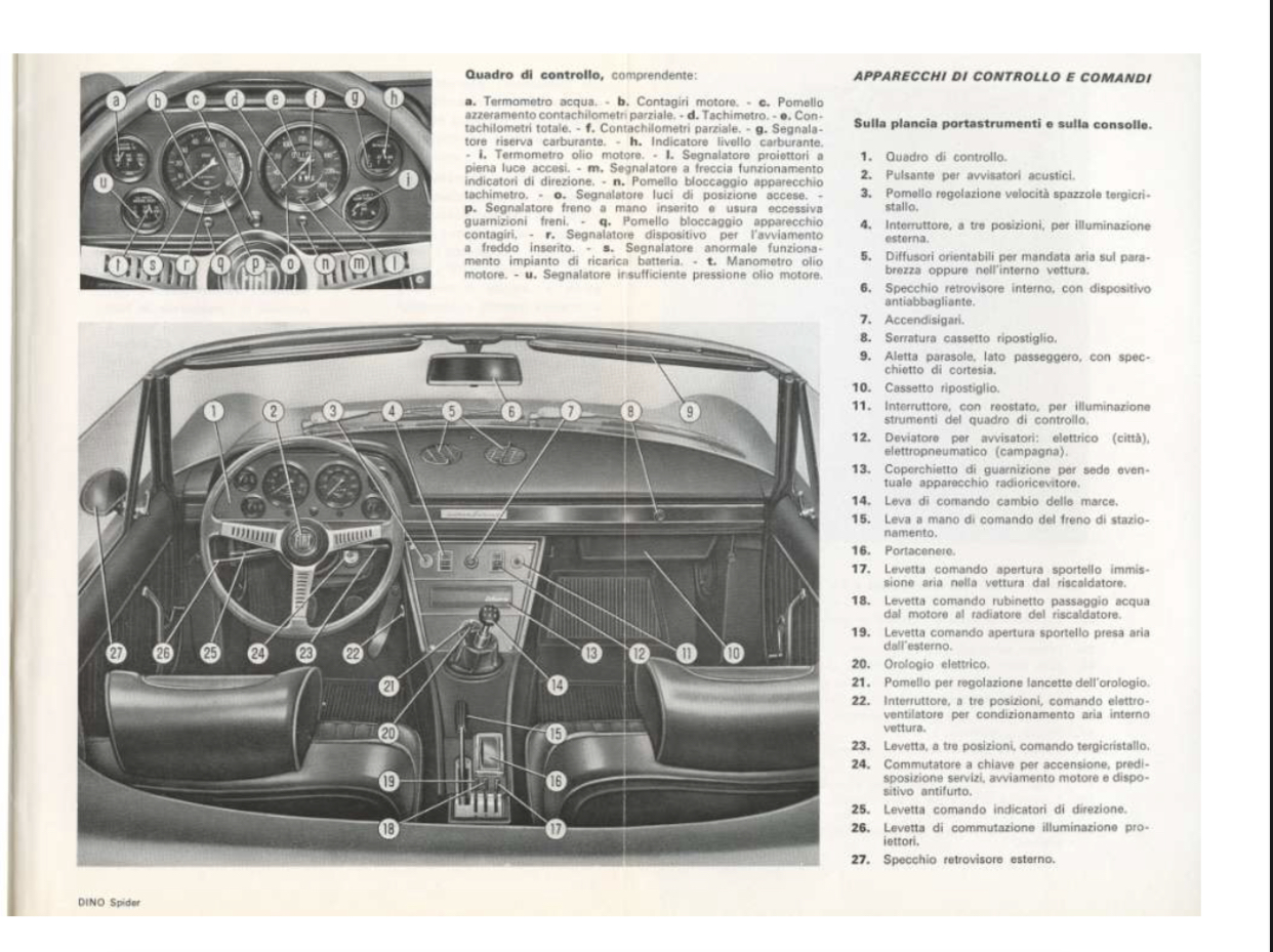

Good evening all (evening for me) finally the weather has moderated in NE Washington State so I spent time in my garage fitting the ignition switch I’ve had for about 2 months.
Amazingly the car after sitting for 35 yrs lit up.
I pulled the plugs out sprayed fogging oil in the cylinders and turned the key the last step.
The starter engaged immediately and turned the engine.
I stopped instantly, not wanting to spin dry cams.
All good news, I started going thru all the controls.
Lights all worked, signal lights worked, cigarette lighter, fuel pump tried to pump the empty tank, but The wipers didn’t work and I can’t find the switch for the heater fan!
I also have a control on the right hand side of the steering column that I don’t know what it’s for. Both the manual and parts list on our forum show the early dash models.
Any comments appreciated

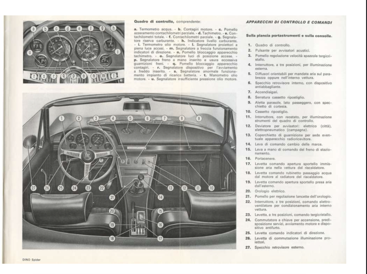

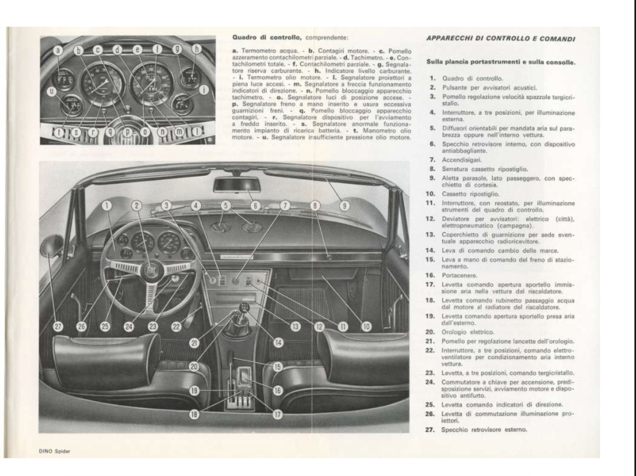

Hi, as the Serie 2 Spider models are very similar to the 2,4 spiders on the inside, you can check the 2,4 manual. See here an Italian version but should help. Look at #22 and 23.
