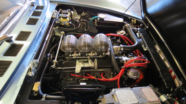

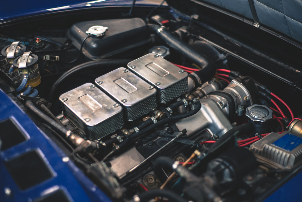

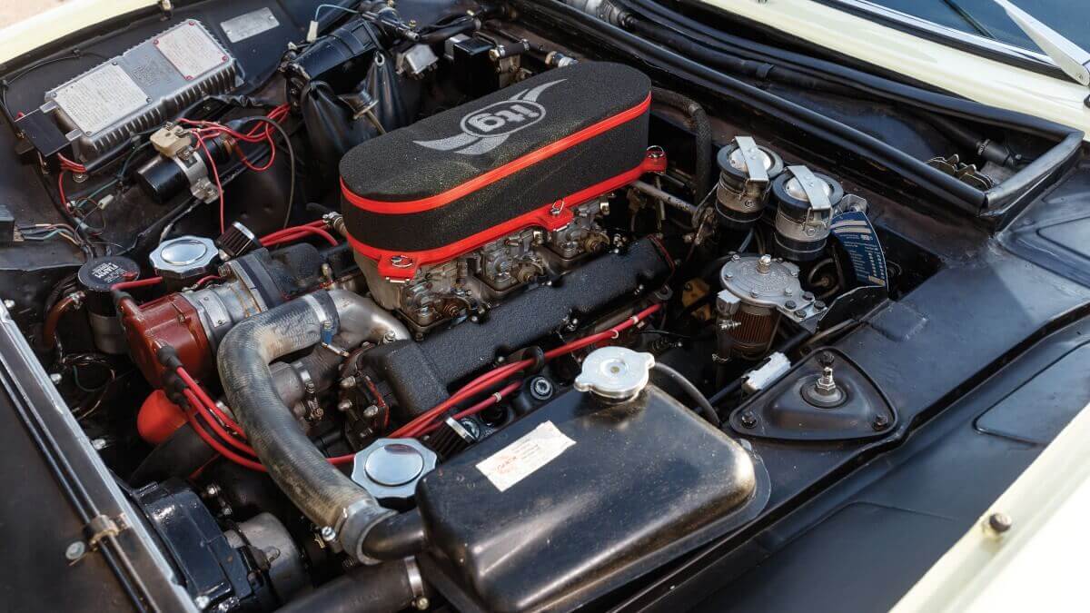

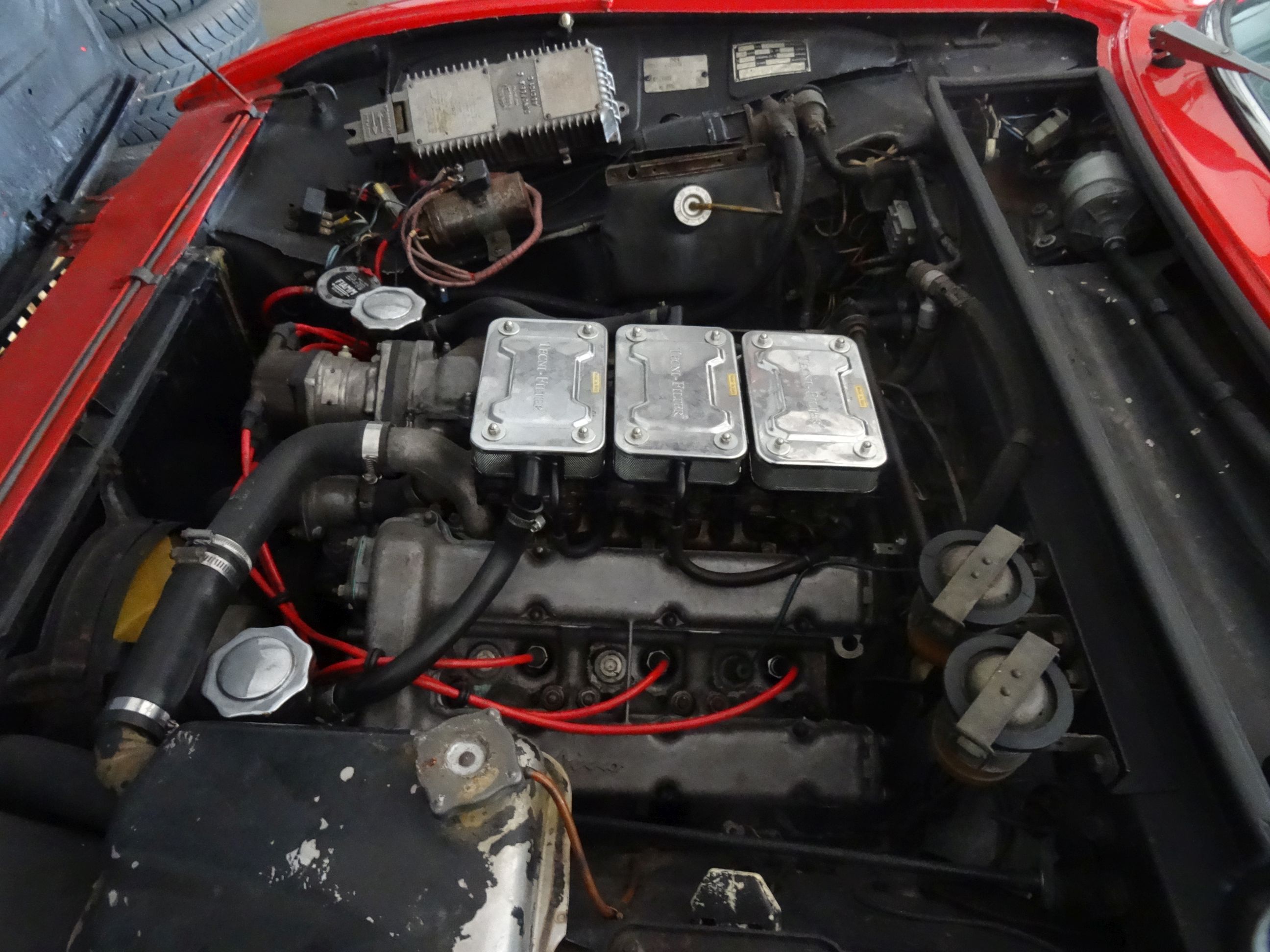

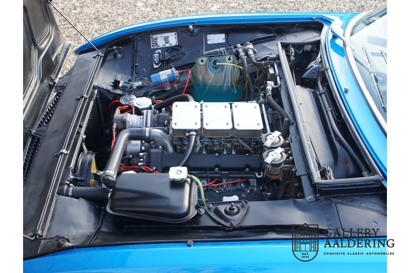

I found these options on the interwebs. Any experience with any of these much appreciated.

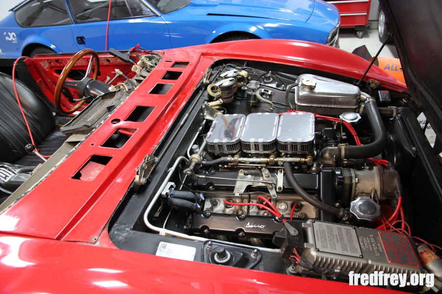

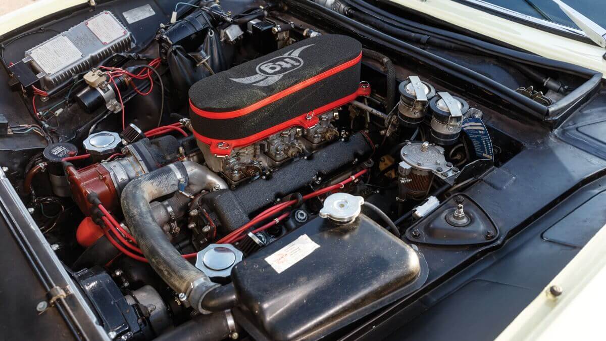

This is my engine bay. I once bought the filters cause they have been cheap and installed them after I had to remove the original filter a few times due to a leaking fuel line. This gives much more access to the engine. There was no difference except slightly more intake sound. I'm still driving it since it gives better access and looks pretty good.

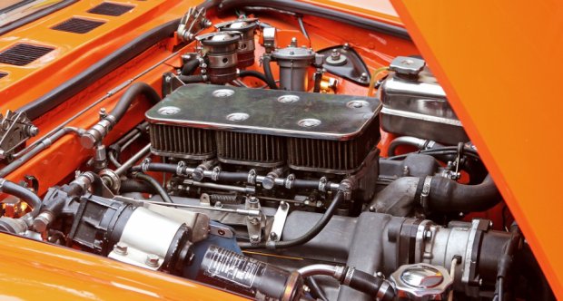

Thanks Ribolla, both good points. I wonder how material the difference in air temperature would be given that air is taken in from the engine bay in both cases - I could see the heatsoak from the factory steel air filter assembley even having some counter effect despite the forward position of the intakes.
The second point is certainly legitimate with the some aftermarket options. But potentially a non-issue with this option.

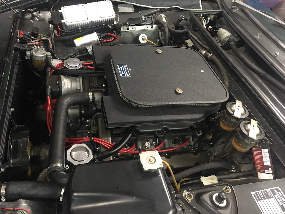

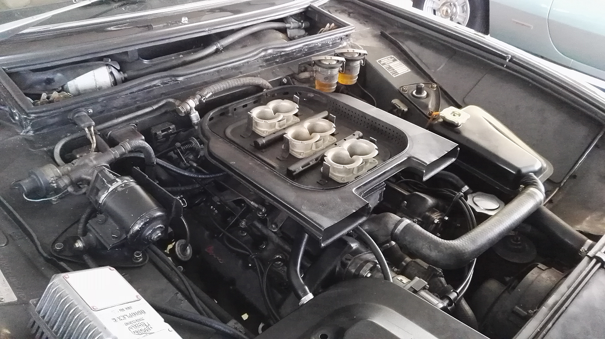

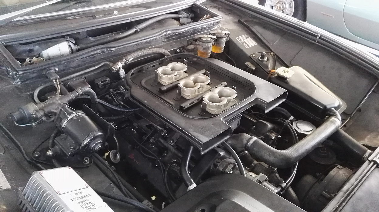

I went the opposite way - my focus was increased air flow, so I developed this solution in cooperation with Formula GT Munich on their dyno.
Fiat and Ferrari Dinos have the same design bug, a rectangular sharp edge in the plenum. Dreaming of the Stratos solution, I added some original Weber velocity stacks and raised the top cover in combination with a 308 filter.
