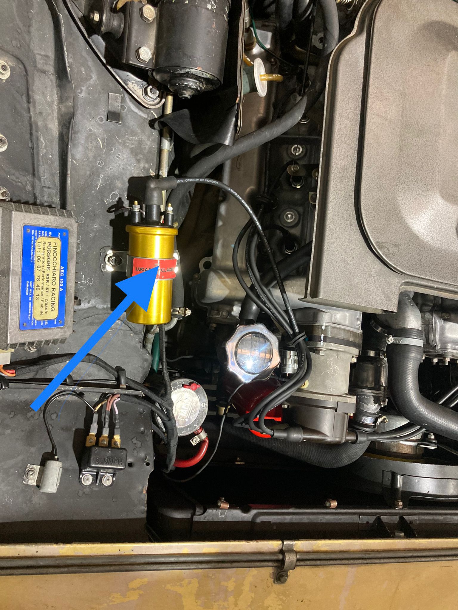

Well after investigation it is not a fuel supply problem.
It’s the coil distributor (is that the correct name?) which overheats (>95 degrees) and stop the engine.
The problem is that the old one was changed a new one more resistant (photo). The overheating might come from an electric problem from somewhere else. My mechanic thinks it might be the Dinoplex which seems to have been fixed some time ago.

As you use the original Dinoplex, at least it looks like, make sure you use the right coil for this unit. On the page Dinoplex.org you find a lot of information including the right coils and their replacement options.

A Dinoplex AEC 103 A cannot be fixed. Because all “entrails” are embedded in epoxy resin. If you open an original box you will find one resin block. No chance to replace any resistor, condensator, etc.
Either an AEC 103 works or its garbage. If yours is an original AEC 103 A, it’s mandatory that you use a coil Magneti Marelli BAE 200A, or BAE 201A, or BAE 203A.
It could be that your Dinoplex is just the original box, to make it look original, but housing some other ignition system inside. This would explain why your coil is a different make but not Marelli. Check, what is inside the box. The badge "Finocchiaro racing" on the original blue badge is not original and could be a hint that this company has implanted another system in this box.
By the way, your ignition distributor is from a Dino 2000, not for a 2400. It works on a 2400, but it is not original. Both 2000 and 2400 have different bodies.

A bit overwhelming to choose the right way forward. But clearly the system as it is now does not perform well. I will probably opt for a new electronic ignition system while preserving and restoring what can be.

Have a look inside your AEC103. If it's already stuffed with something else, get a Winterburn ignition and put it inside. This is a very good and cheap alternative. If it's still a Dinoplex, test it. If it's definitely broken, get a Winterburn ignition and put it inside.
