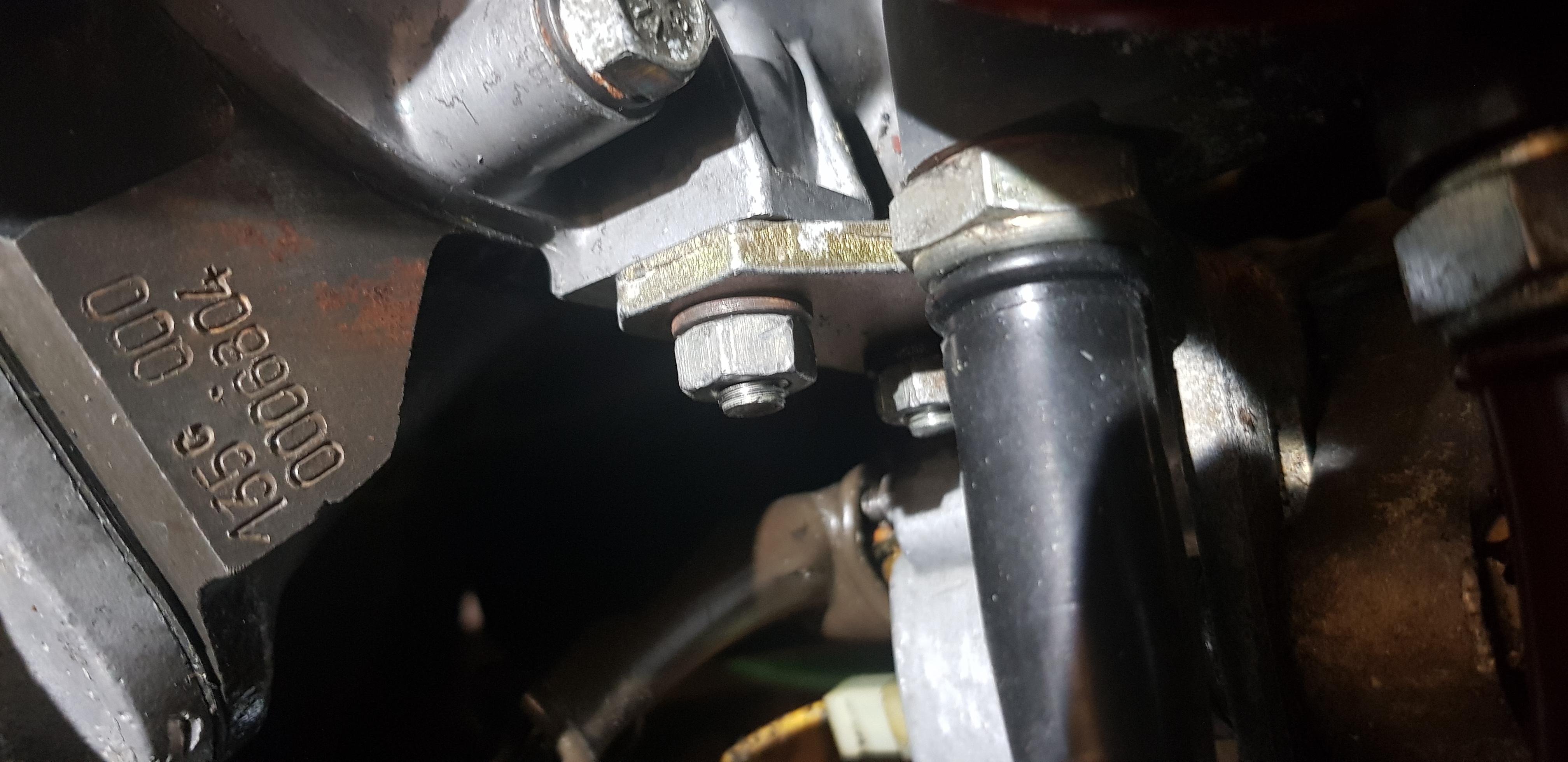

The engine No. is very easy to get, just slide your mobile phone down along the engine oilfilter, with the camera facing the cylinder block. Then you can take a picture of the front of the cylinder block, just under the cylinder head gasket, there it is. This will help me place your car even closer, because of Modifica 4245. The engine number of your car will define if it is produced before or after Modifica 4258, which was Implemented in the production 01.05.1971.
Here is a picture of the engine number of my car, and you can see a little of the orange/ red Baldwin engine oilfilter down in the right side of the picture. (if you click on the picture & open it). BR
