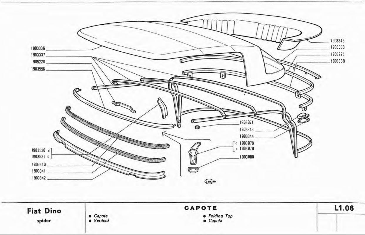

In the early '67 cars, if you look at the parts book, there was more than one top bow assy. I don't know the differences, but I suspect the top must correspond to the bow assy. When trying to source a pre-made top, this detail was not generally obvious.
The first time I replaced it, I bought a pre-made top that came with that strip. It was black, not chrome. I was unhappy with the fit (hitting the side windows, just generally lumpy, too short in spots, and the rear window fit did not match the pictures available of how that part goes together) that I had one custom-made. The trimmer sourced all of his materials, which, in my opinion, were of higher quality. Also, I recall the trimmer telling me he had multiple patterns for the Dino-Fiat Spyders, thinking they all led down a path of poor fit and encouraging custom fitting. The curved wood block in the rear bow, which is the base for tacking in the staples, was in bad shape for the level of restoration, so I opted to remake it. That was its own little project, to steam and curve the wood. I believe the wood species used was Ash.

It should be noted that there are 2 different types of top linkage on the Dino Spider 67...
