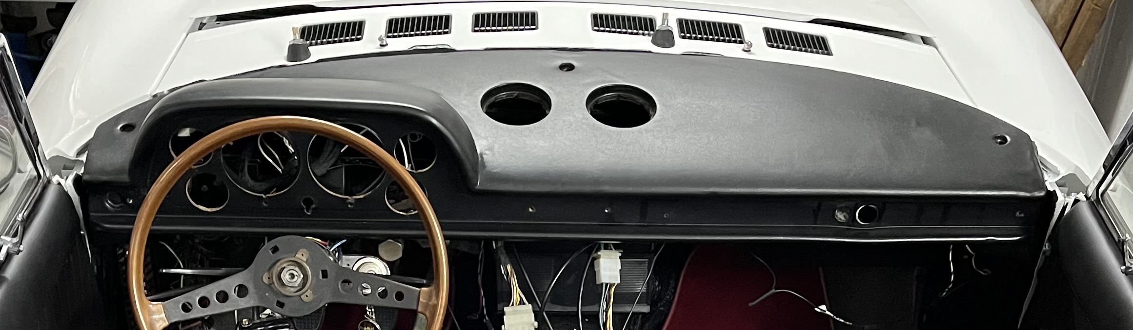

For a 2400 Spider. How do you access the drive cable on the back of the speedometer? Can the top of the dash be removed? What is the procedure?

The Dashboard is so to say one piece, see picture during restoration. You have three screws on top and 1 at each side - and the center console is attached to it. When you have removed them you should be able to move the Dashboard and have access to the Speed cable. To completely remove/reinstall the speedo cable, it’s a bit narrow behind the brake booster. I lowered the pedal block a bit to get a bit more space.

Thomas: Thank you so much for your reply. The photo helps me understand the process.
