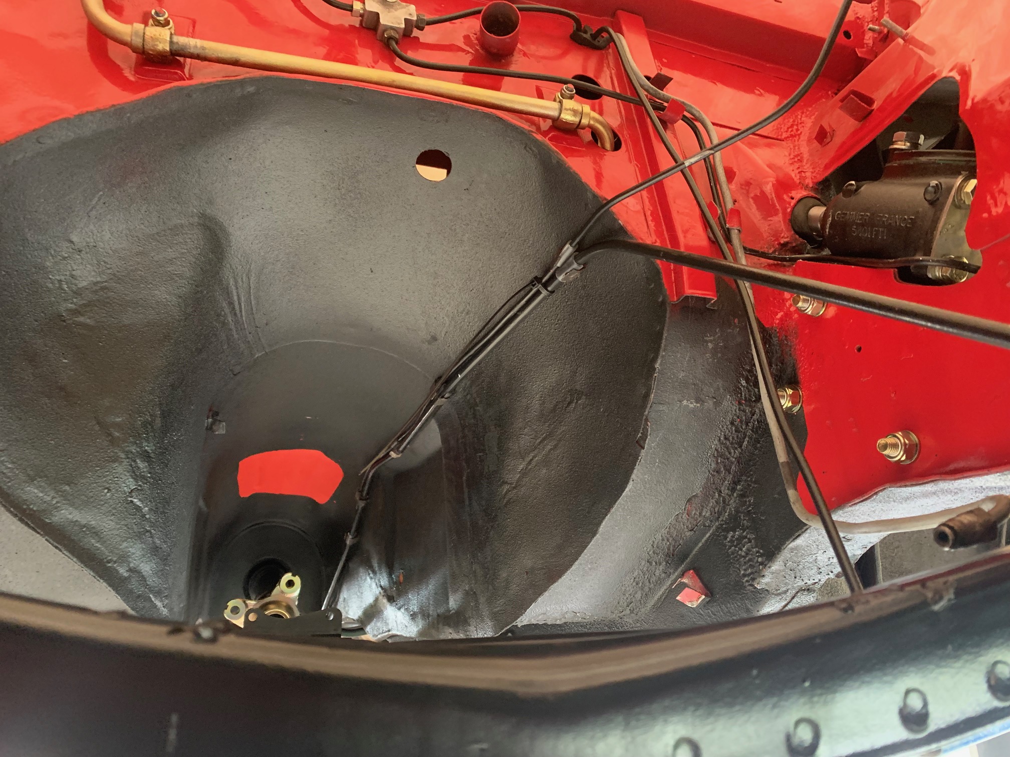

I have a Spider# 665. It’s probably one the very few unmolested cars. The inside of my boot/trunk is black over the original colour. The lid inside is body colour.
Engine compartment, firewall, inner fenders and front end are black over original paint. The underside of the bonnet is body colour.
Inside of doors is body colour, but hardly covering the steel, 1 coat my guess.
Inside the cab, rear and front bulkheads are black over original colour.
Right or wrong that’s the way mine is painted and apart from a repair behind the drivers door, its original paint.

In the Fiat Dino Spider Series 1, only the underbody and the underside of the wheel arches are originally black.
The engine compartment is painted in the color of the body.
I have Dino #0000222 and #0000259 and both of them were like that before the restoration..
I also saw some Dino Spider 2000 at Dinopoint in Bergamo (specialist for Dino - Ferrari and Fiat) from the first and second series..
Series 1 had the engine compartment in body color and Series 2 and 2400 the engine compartment was black.
The inside of the hood/bonnet is also painted in the vehicle color at the Series 1.. series 2 and 2400 are black..
The black paintwork on the underbody extends to the end of the transmission tunnel on the firewall
