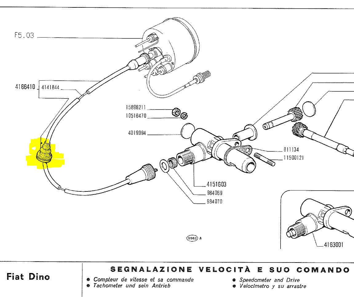

I'm working through a lot of issues ( the car was stored for 35 years) but I don't currently have the ability to drop the engine and install the speedo cable. I have the speedo out, and have one end of the speedo cable, but cant see where it goes through the bulkhead on its way to the gear box.
Can it be replaced with the engine in?
I'm also currently pulling the clutch and brake master cylinders, so I will have a little bit more room to play with.

Hello Michael,
the speedometer cable can also be installed or replaced with the engine installed.
the opening for the speedometer cable is located at the top center at the front end of the transmission tunnel inside the driver's cab (under the ventilation box)
You don't need to remove the clutch or brake cylinder.
If you remove the dashboard and the ventilation box, it will be easier for you to access it and you can simply feed the speedometer cable from bottom to top..
but it's not absolutely necessary, but easier
and the rubber seal (marked yellow in the picture) seals the opening
