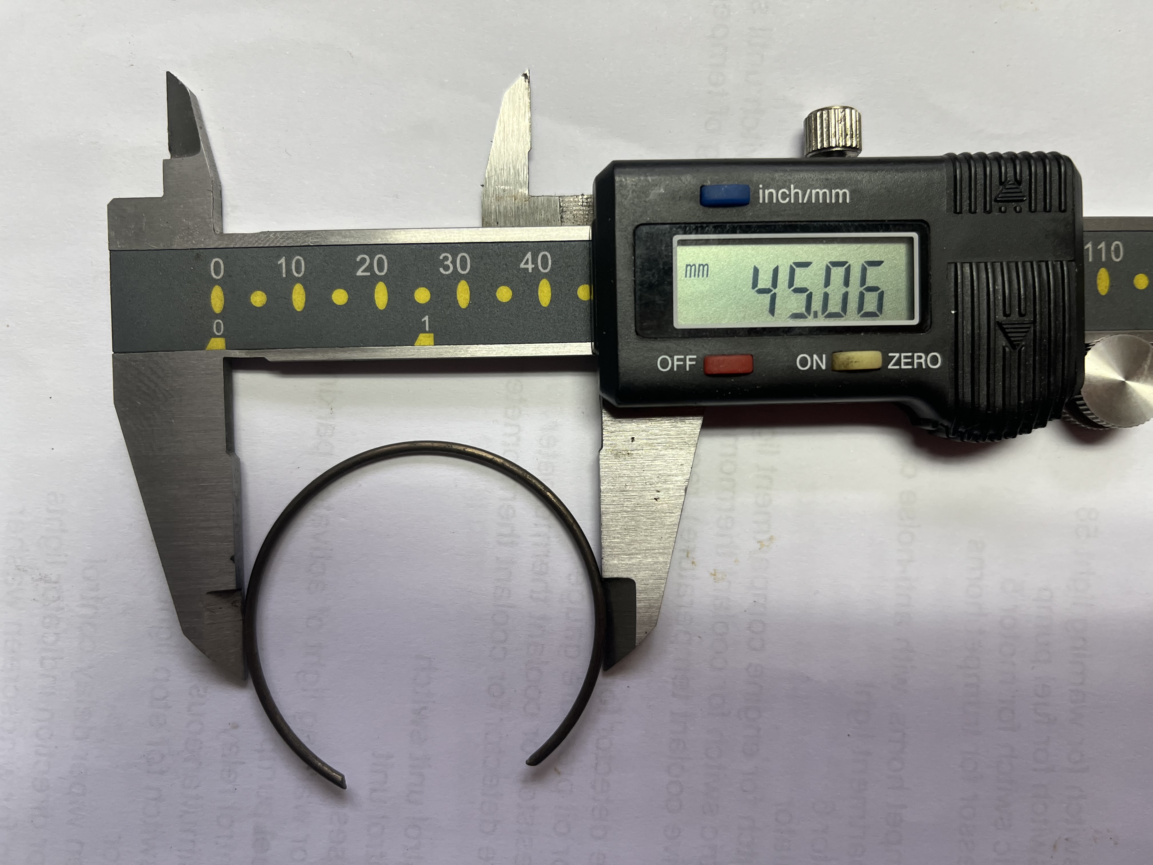

Re: Looking for ignition switch retaining ring
Here’s what you are looking for
The gap in the spring is 23mm
Diameter of the wire is 1.48mm
Hope this helps
Hope this helps

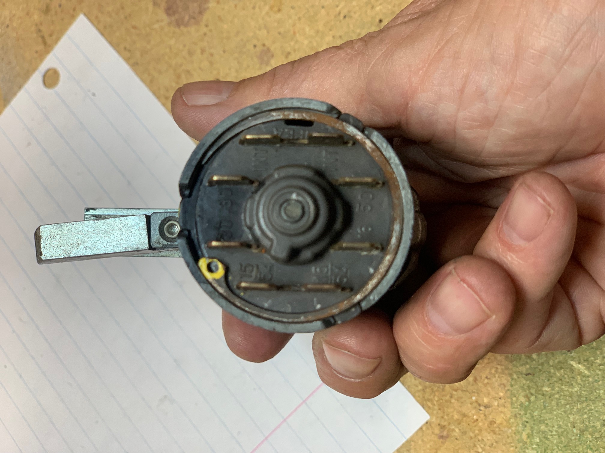

FYI
I don’t know if you know this, but the switch you have is probably the Russian made switch for the Lada.
The original switches are made by Sipea, they show up for sale now and again, they were also used on the 124’s and 130’s. But some of them don’t have a long enough steering lock for the Dino. You can tell the difference on the electrical portion, on the Sipea ignition, the the terminal at radial around the switch, except for the two blades for #30 I thinkApart from that you can’t tell the difference.
M
