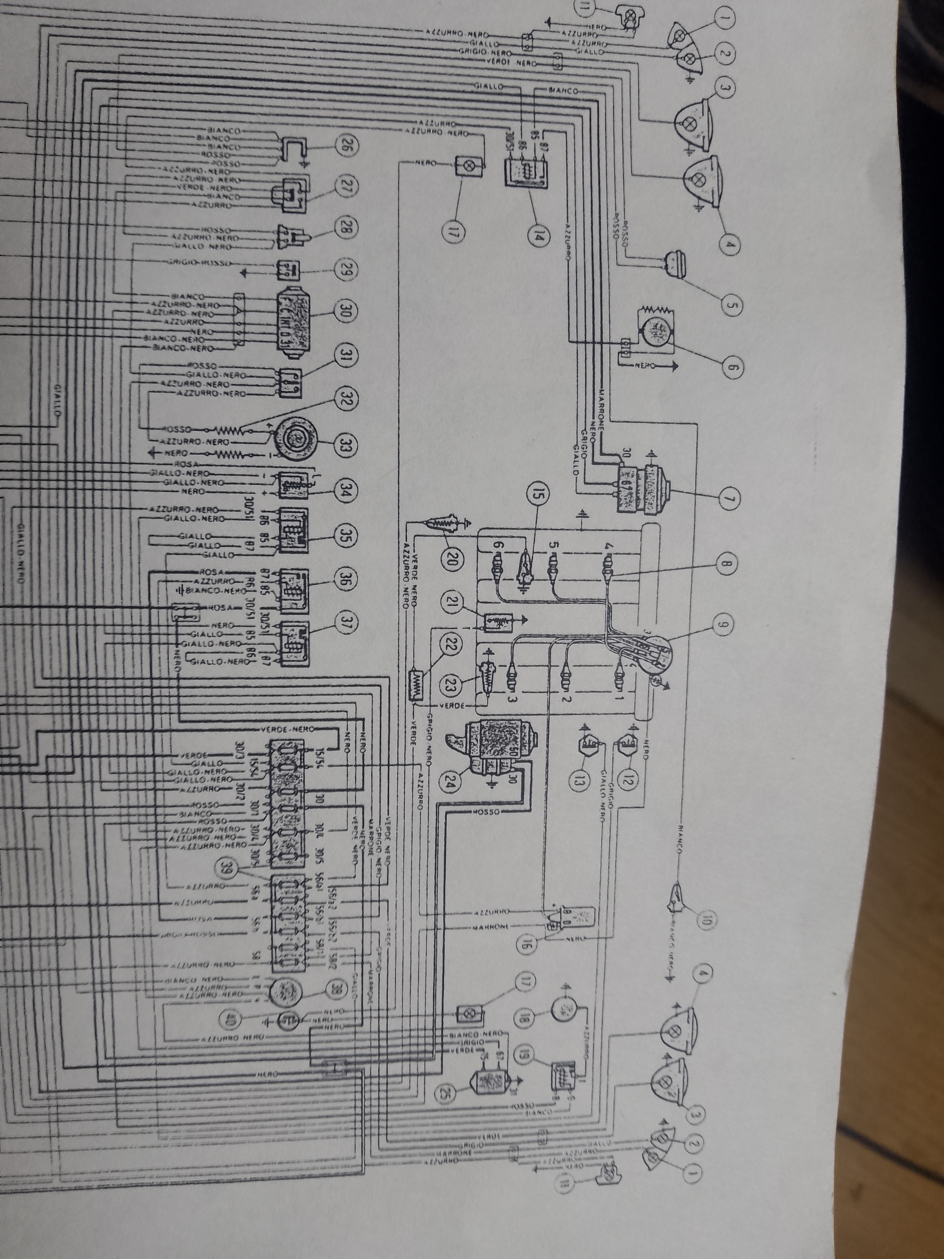

I am trying to get the two engine bay lights working in my 1967 2.0 coupe,but the wiring diagram I have is different in this regard. On the right hand bulb holder I have two blue wires going in and one black earth coming out. On the left hand bulb holder, there is one blue wire going in and one black earth coming out. I can't trace where these blue wires go. The wiring diagram shows blue/black wires which go from the bulb holders to the foot pump for the windshield washer and wiper. Are there different wiring diagrams for early and late series 2.0 litre cars.

yes, there are different diagrams and different wiring harness

In the only wiring diagram I have for the 2 Litre Coupe, the +12V for the engine
compartment lights is fed by a yellow/black wire, but this is probably the later
2 Litre Coupe wiring diagram.

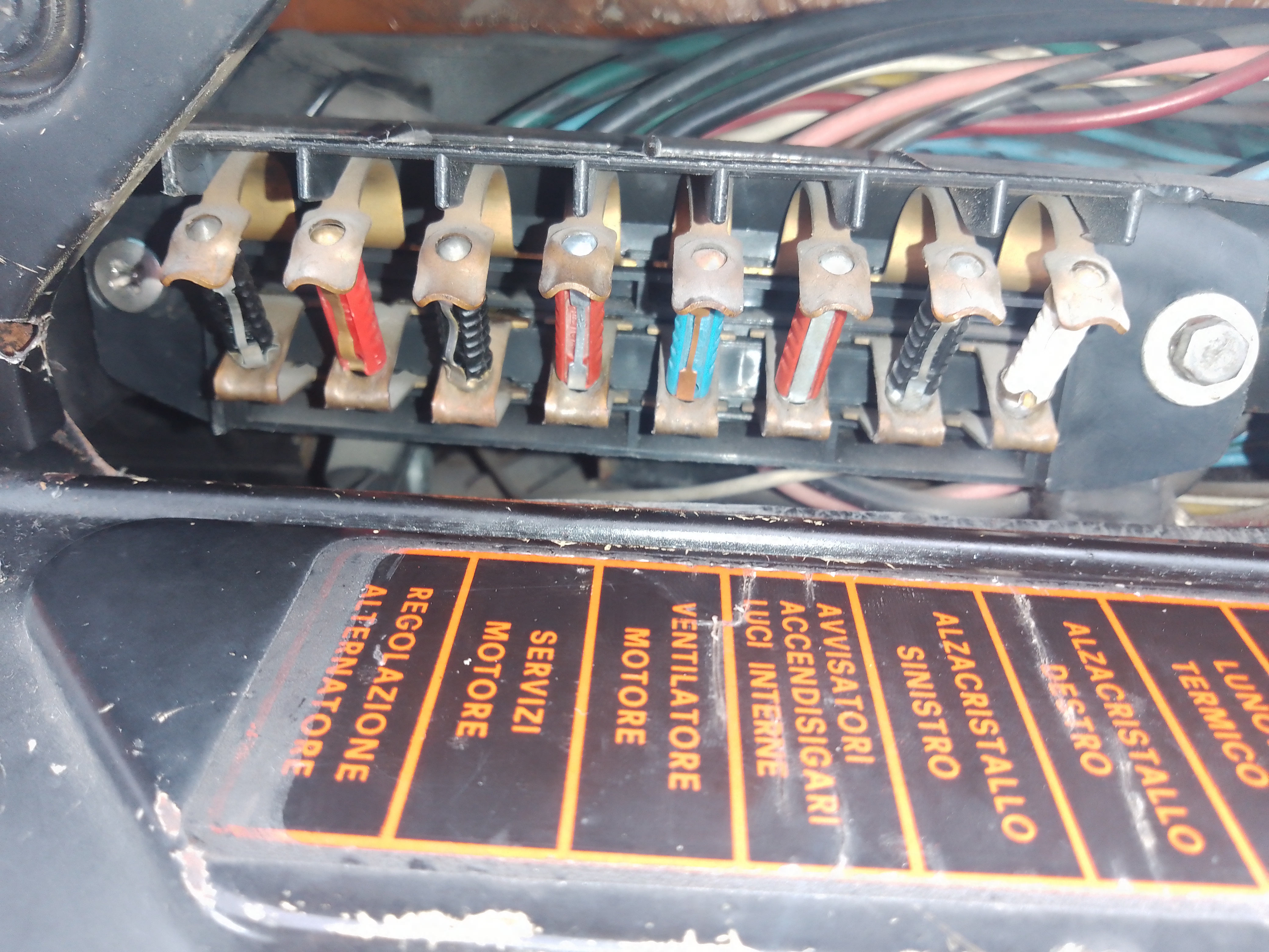

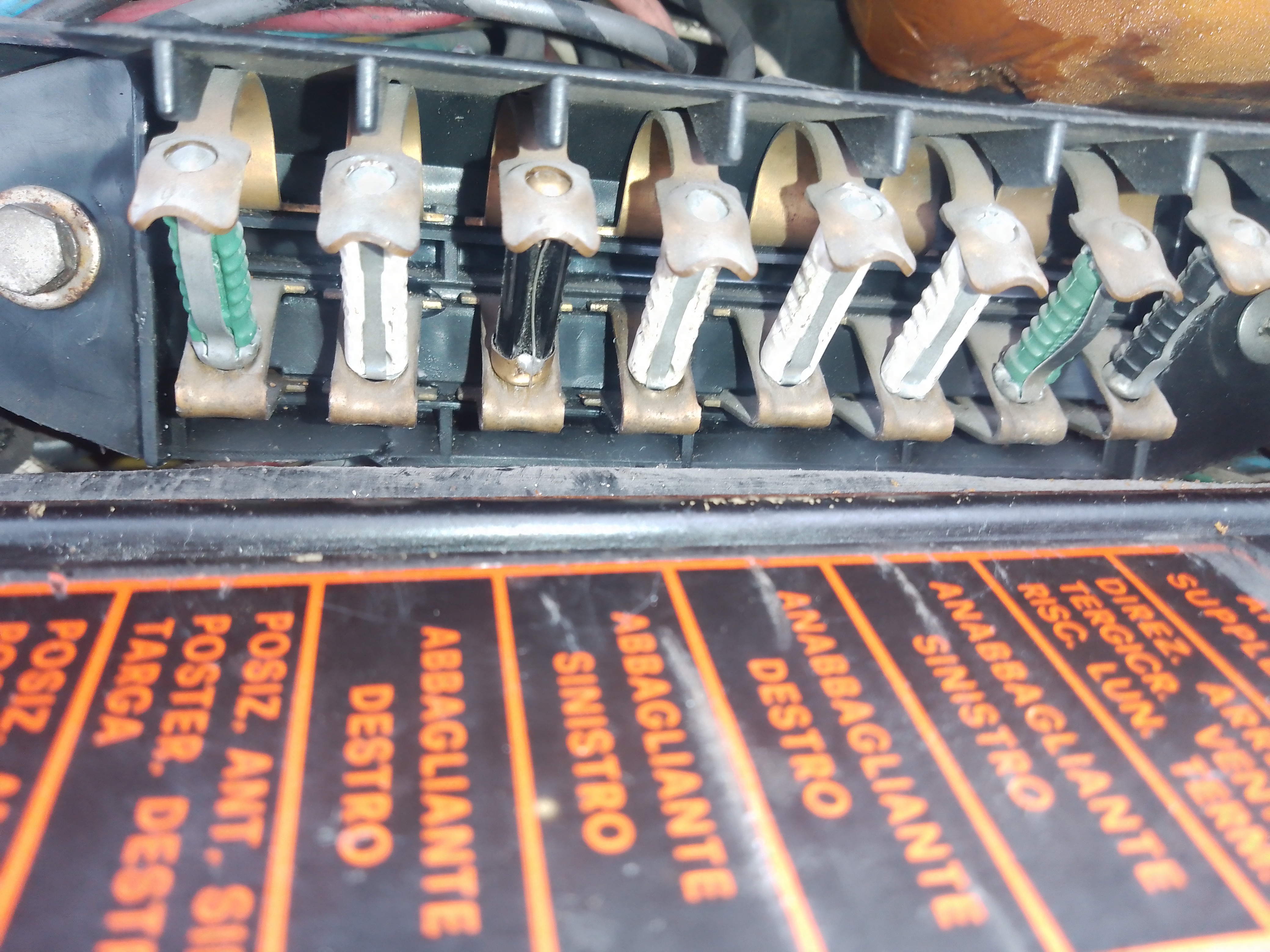

Hi, does your car have a double (two seperate) or a single fusebox in the glove compartment on the passenger side?
BR
Erik
4cambob
Posts: 129
Re: Wiring problems
Post by 4cambob »
Hi Eric,mine has 16 fuses in total which are kind of separated but also kid of joined.
